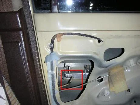

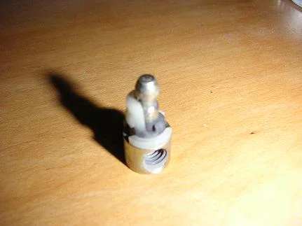

I could use some help finding a small plastic part for the linkage to the driver's side door handle. Should I just ask some of the guys who are parting out or is there another place I should look?
The part is shown in the picture below and goes on the end of the linkage.

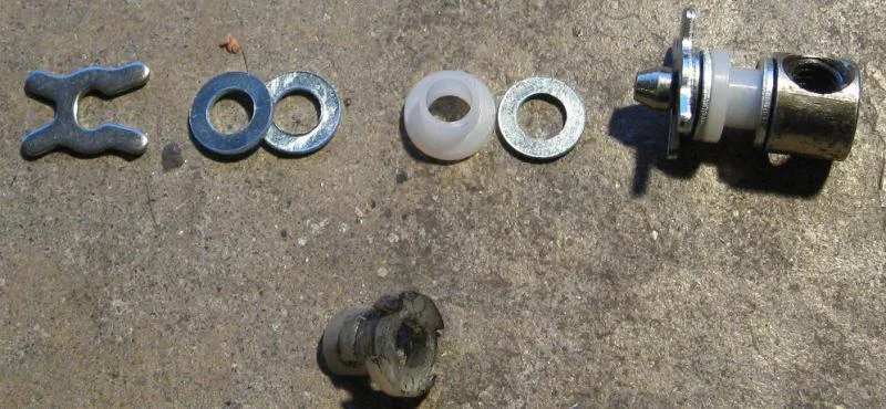

I've got parts for an awesome fix for that. And it makes the latch a little more secure. I was going to post it eventually, but I haven't gotten around to it yet. It's written down and it's somewhere in the garage...with my v8 conversion.
But the idea is this..
You'll have to go to your parts store and take that little part with you. Take off the broken plastic piece because you won't need it.
I found a pic showing the parts that fit onto the end there. Check it out...

Don't forget that when you put the x-clip on the end, you need to squeeze it with the pliers so it doesn't fall off. This fix should last you another 20 years. Good luck!

Hey that's a fantastic mod! My door handles feel like the linkage is loosening and this looks like it'd be the ticket for a permanent fix. Do you remember the dimensions of the bushing and washers, or better yet, part numbers for anything?
So here are the parts that I used. This is what was described on the receipt from Marshall's Hardware, where I got the parts from. I'll also list the Marshall's part number in case you have one locally.
501024 x washer retaining clip 1/8"
376041 #10 x 9/64" x 1/16" Nylon Flange
143007 5mm washer
Good luck!!

Just got home from work. This is great information. Thanks. Very nice mod. Definitely seems that this would last longer than the stock piece.
Also, I do have a Marshall's Hardware store pretty close by. Crazy coincidence.
