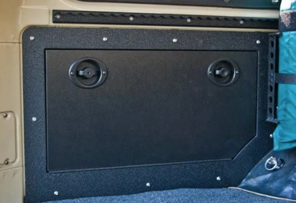

I've searched and searched the forums, I've searched Google...sorry if this has been posted and I'm overlooking. I've just finished a new interior to include new door panels. I'm searching for a way to attach the door/cargo panels by going through the panel rather than attaching with plastic fasteners on the back of the panel (i.e. the OEM set up). Looking for suggestions on a two-piece setup - a screw or bolt that goes through the panel and a nut that fits into the round body panel on the rear of the panel. Something like this....

I'd rather not use Rivet Nuts - has anyone used other nuts that fit into the body panels? I believe they're 8mm size but might be mistaken. I've looked on all sites I'm aware of but not having much luck. The pic I posted my original post is the look I'm going for.

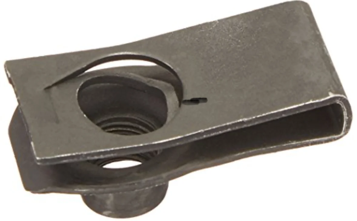

You are likely looking for something like a speed nut used for attaching body panels.
