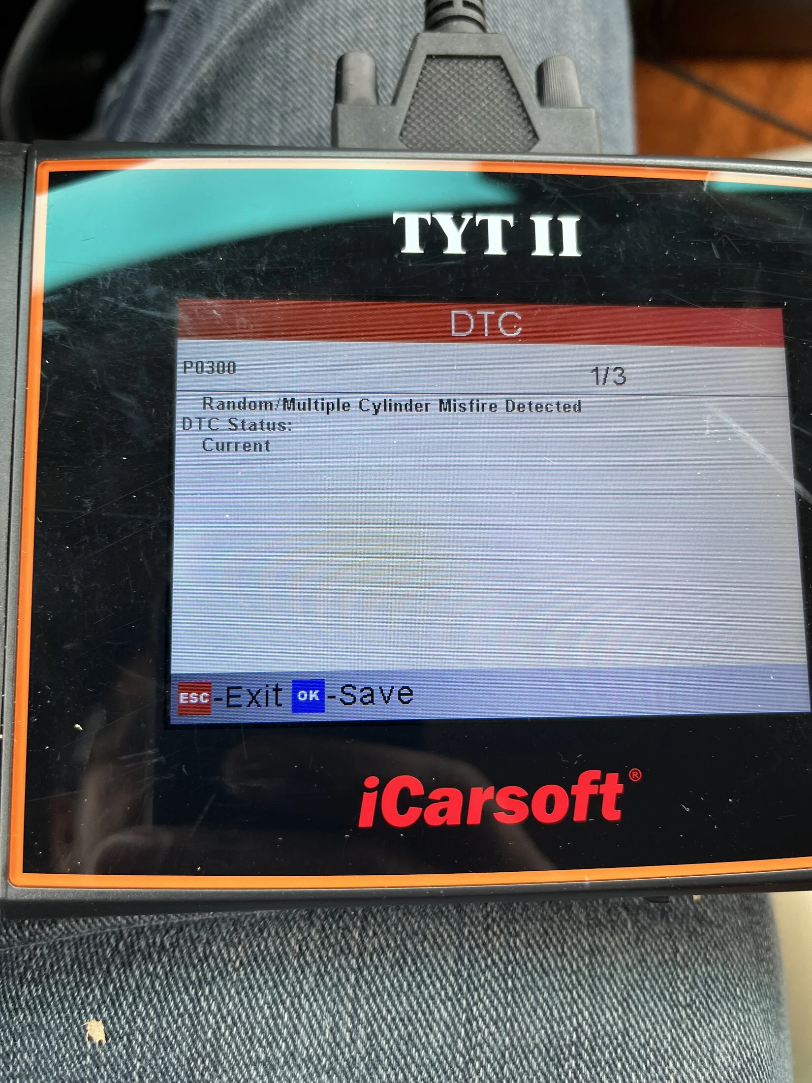

You should also see one or more cylinders misfiring DTC. P0300 is general DTC, which we get for a number of reasons. Which is often a misfiring cylinder, which will see DTC for that cylinder also. Look for pending DTC also, in tech stream. You can also look at engine data in tech stream, and watch for misfire.
The gumout has worked for all my vehicles. It does the injector cleaning really well than any other brands. I use it every 3 to 5K miles on all my vehicles. Continue to drive and add another gumout. Let it clean out the injectors.
Unfortunately, I do not have the guts to keep driving when it sounds like that. It’s $50 for a set of plugs. I’d rather just change them first and make sure that’s what the problem is. Thanks for the insight
Yes, it’s showing a misfire on cylinder three and eight
just pull a plug and clean it off, but theres no way its just that
This may or may not be a fouled plug issue of #3 & #8 cylinders. For now, I'll focus on spark plugs.

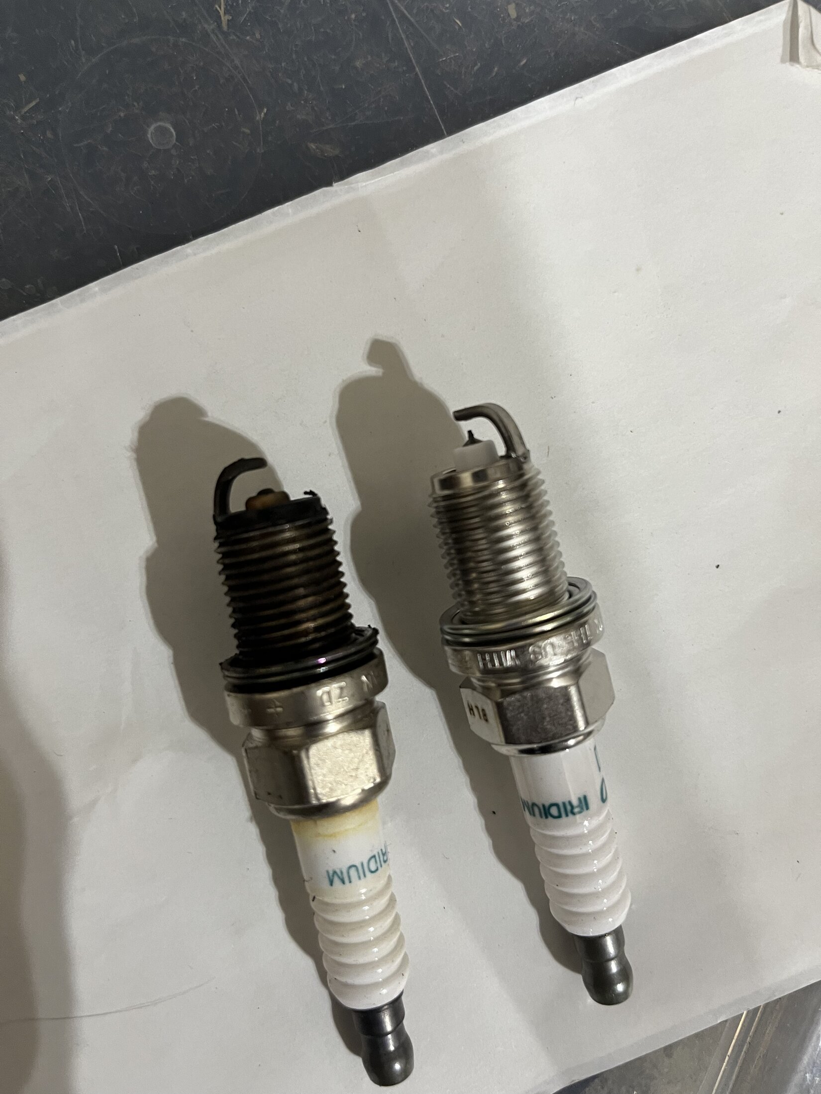

I finally had some time to take the plugs out. This is what I found. Rookie mistake… I bought the old plugs off of eBay and after 60,000 miles they look like this with no electrode left🤦🏻‍♂️. New one is there for comparison.
I’m hoping it’s just a case of plugs needing to be changed. Will change the rest button it up and post my results soon. Maybe gumout wasn’t the culprit?
Could very well be counterfit plugs. Ebay and Amazon are full of counterfit auto parts. Best to buy from Rock Auto, your local parts store, a US based dealer, or a reputable international source like Partsouq.
(I've been burned personally as well).
