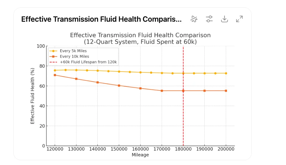

I use my rig pretty hard and its way too heavy so my oil change interval is 5k. When I got the truck at 120k it had a transmission fluid service at the Lexus dealership at 60k but I have no idea what that entailed. So I did a 4x drain and fill (62% new fluid) over about 1k miles.
Since then the plan is to continue drain and fills every 5k. I think a lot of you will think this is overkill but since the whole thing holds 12 quarts and I assume 60k is the fluid life, you only ever have about 77% new fluid even with a 5k aggressive drain and fill schedule.
Because I do them so often it only takes about 15 minutes and since I'm convinced the Valvoline is better in this application, it only adds 20 bucks to the oil change cost.
ChatGPT made this graph for me that tracks fluid health. This is after a 4x drain and fill at 120k and models out 5k and 10k drain and fill intervals (assuming 60k fluid life).

A drain and fill is more time, more money, and less effective than a fluid exchange. It's certainly better than nothing, but the best analogy is taking a shower and putting dirty/sweaty clothes back on when you hop out. You'll still be stinky.
IMO, you're better off to drop the pan, clean it out, and do a full fluid exchange ever 30-40K miles. That way, you get all of the gunk out of the transmission, which a drain and fill does not do. You'll be surprised how much crap is in the bottom of a transmission pan and stuck to the magnets. And, with a full fluid exchange, you only have to mess with topping the transmission off and setting the level every few years, instead of doing it every oil change.
A fluid exchange is quite easy with a Motive PowerFill. And, the pan is not hard to drop with a 10 mm socket, and downright easy to drop if you put a 10 mm socket on a cordless impact.
