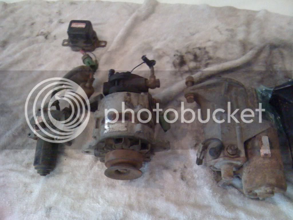

24V pieces have arrived from Canada. Does everything look ok?
24V Voltage Regulater
24V Alternator/Vacuum Pump
24V Starter
24V EDIC Motor
All came off a very low mileage 3B, but unfortunately a bit rusty. I'd much rather deal with grime.

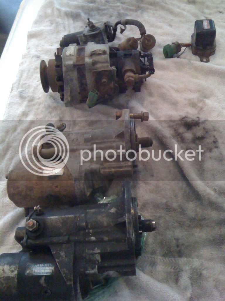

The two starters look identical. What do you guys mean I may need to "swap noses"?
The 12V is nearest:

definitely do the mechanical, then just pull it apart and clean it up. There'll be enough things you'll end up having to add or alter that you'll be much happier if you haven't painted it first...
Those bits look right to me. Looks like you got lucky on the starters, if the 24V one fits, then you should be golden and you can disregard that stuff about swapping nose cones.
