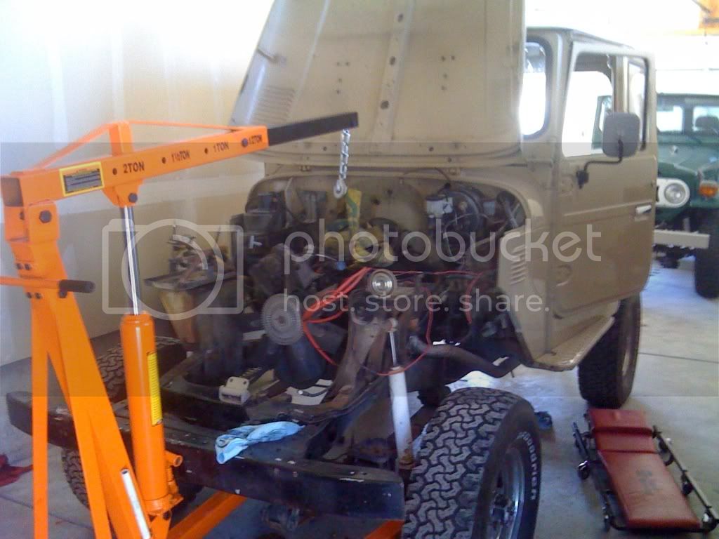

More progress as I steam through the restoration.

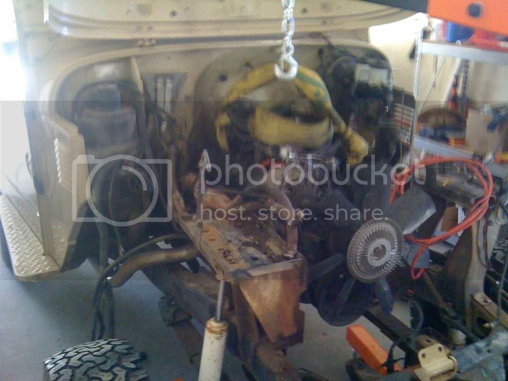

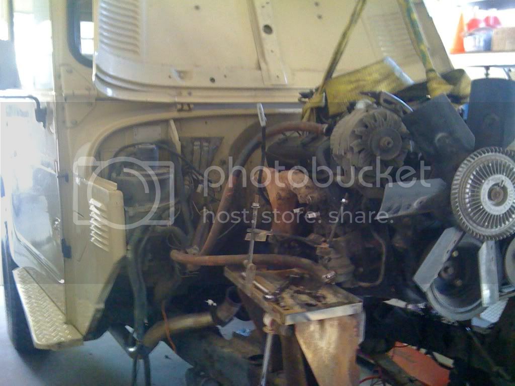

I disassembled the front body pieces, fenders, bib, etc... and in doing so snapped only two bolts off (one off each side of the 12mm's holing the fenders to the frame). That reminds me I need to find a good tap set.

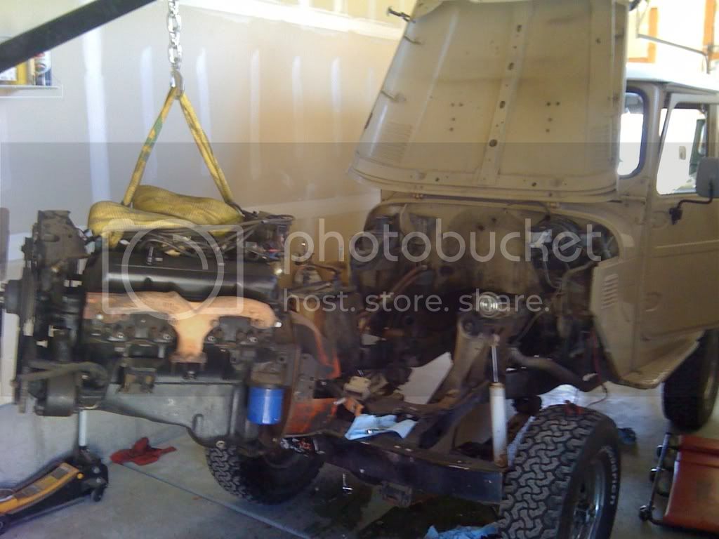

I latched onto the engine with a chunk of 3 ton strapping:
This is (for those of you that have read those redneck joke in regards to tools) that one liner that read: "What is an engine hoist for? .... To test the tensile strength of everything you forgot to disconnect!"
Sans Chevy 305 V8

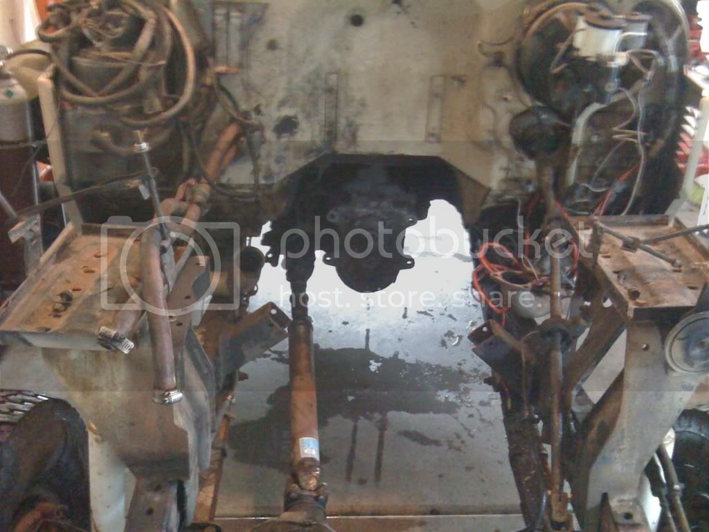

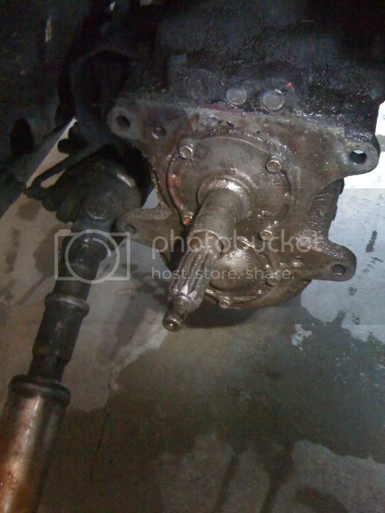

and ARGHHHHHHHHH!!!!!!!!!!!!!!! Wrong transmission??
Does this mean wrong t-case too?

Any 21 spline 4 speeds laying around? .....sigh.....

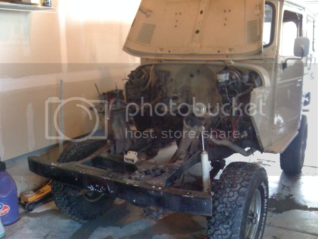

Yes....dissecting the power steering setup is going to be major surgery.
A quick note:
Maybe this is just because I love "Toyota Land Cruisers" so much, or maybe because I enjoy actual "restorations" (which it seems, the term "restore" various greatly by today's standards. When I use restore I use it in terms of returning it to the way it was when it rolled off the line), but for the sake of preserving the Toyota Land Cruiser (because my kids are already asking about the day they can drag one home to restore).
PLEASE PEOPLE, stop hacking the crap out of them! This power steering setup in the BJ42 is an absolute disaster. We need more room, NO PROBLEM (insert torch lighting sound here).
I am estimating a good 40-60 hours to fix what they did to put power steering on this rig, minimum.
