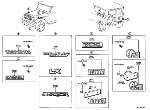

In regards to emblems and other decals on the 81 BJ42, does anyone have OLD photos of bj42's that shows where all of the various stickers and emblems went, engine bays to show colors and correct parts of various components.
You know....just some helps for me as I am collecting things to restore this bj correctly. Any pictures will help!

Does this help?
Good luck :beer::wrench:
Rudi
Emblems!

You're welcome :beer:
It's a page from a FSM parts book that was on a cd, together with a chassis/body and engine manual, that I bought last year.

Thats cool ... But I have never seen any with #4 and 5 before anyone got one with badges in these areas??? Is it a JDM area maybe

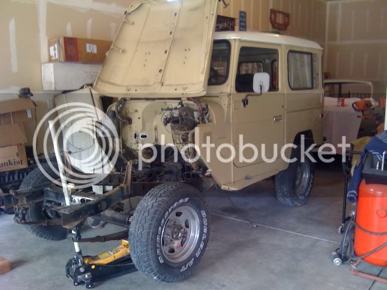

Anyhow I have been tinkering on random saturday's trying to mock everything up and get it set. I have had a few glitches and snags, but have been able to work around them.
I know a lot of you are SOA, V8 fans...but I like what came from Toyota originally (personally).

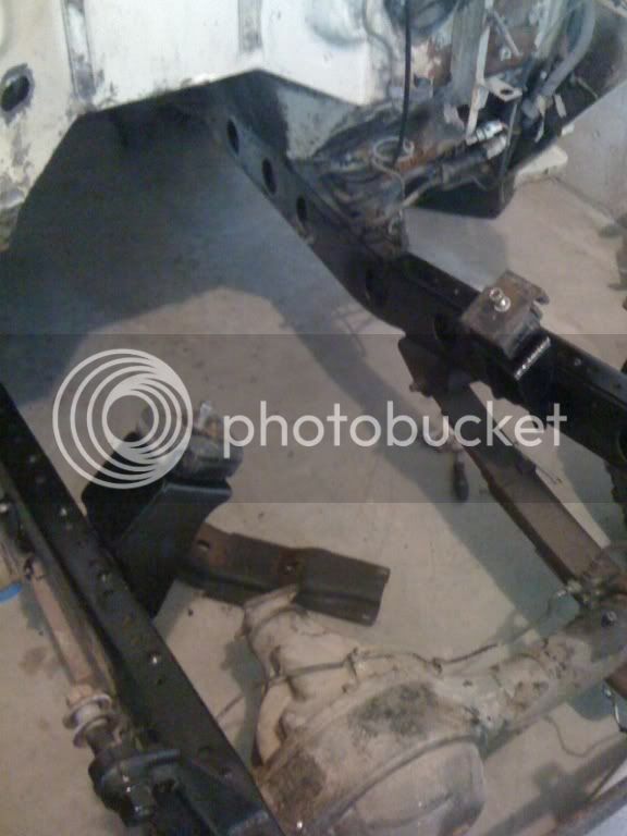

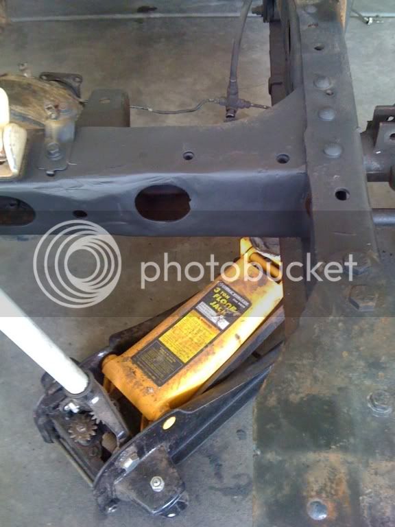

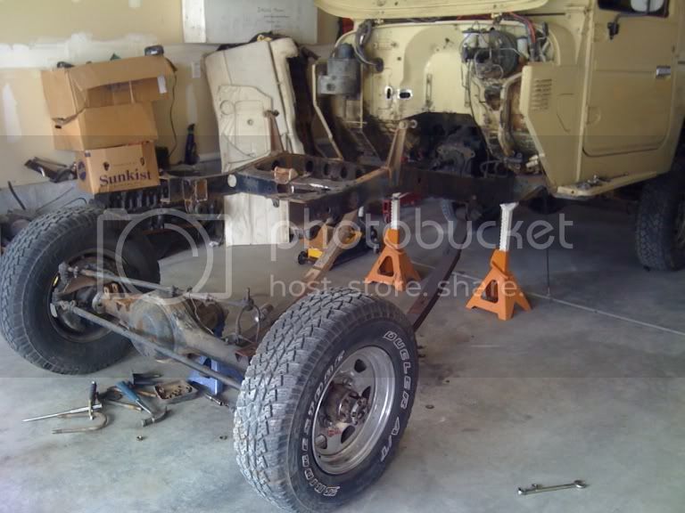

So, I started the "back to spring under" fix.
The rear was a bit easier as you all know. Luckily the front axle was NOT cut and turned. The aftermarket modifications and work that was done on this cruiser from top to bottom is horrible in about every regard.
Back to spring under:

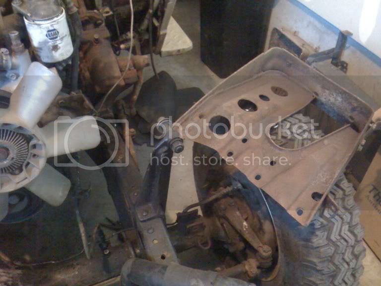

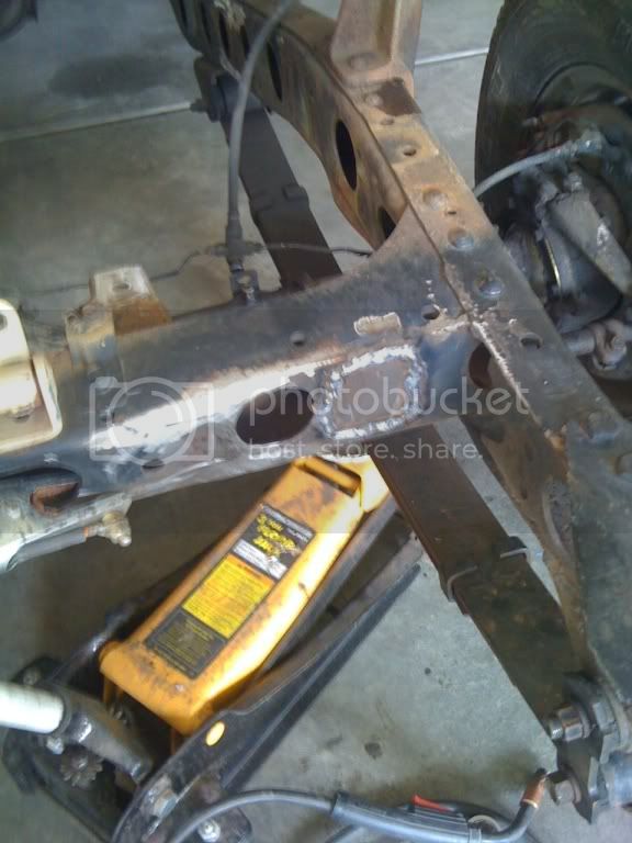

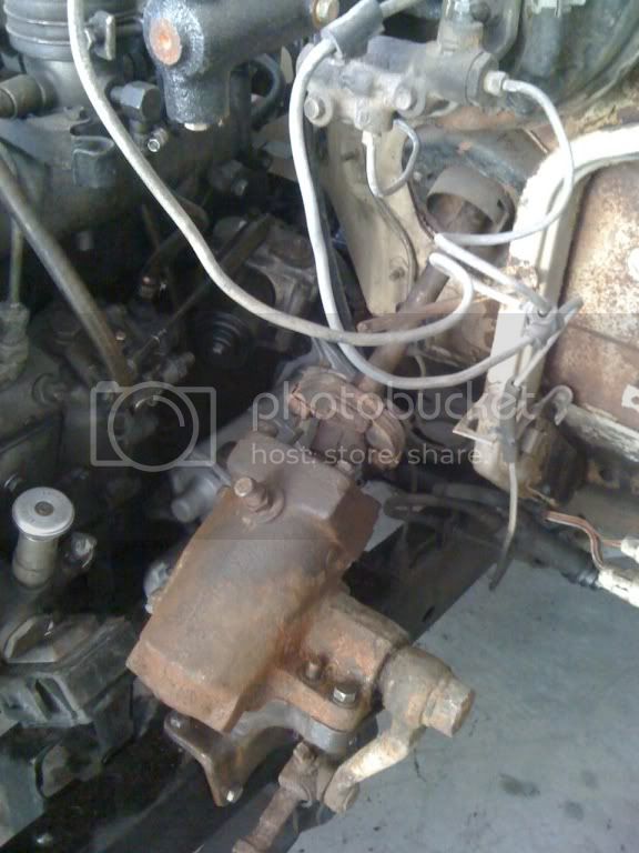

I then worked on gutting out that awful Saginaw setup. Again, why OH WHY do folks find it necessary to torch the crap out of the front of 40's to put power steering on them? There are so many options and solutions besides hanging that sloppy looking Saginaw box up there. (again just personal opinions here folks)
Gutted, and fixing the power steering.
I have a bit more touching up as you can see, but wanted to just get it setup and drilled for the OEM steering to go back in....I'm basically mocking everything up at this point.
I then cut out all of the V8 garbage fixed the frame, and have OEM mounts back in:

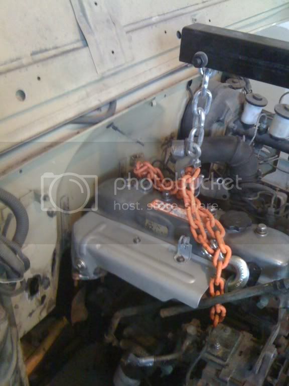

Now, lets install what was intended to be in here.....a 3B Diesel.
Measuring/adjusting/ahhhhhhh MUCH BETTER.

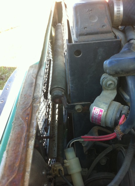

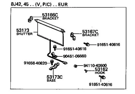

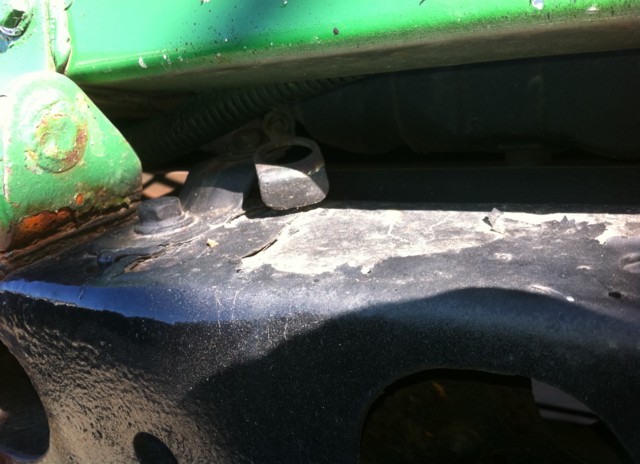

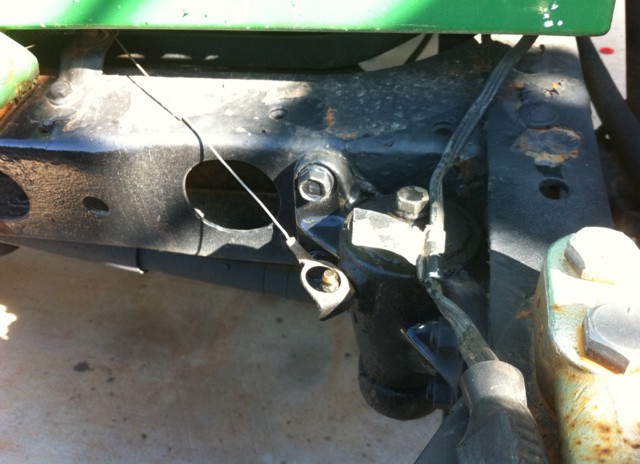

So I have a question regarding the radiator pull-down canvas thing. I see the bracket that is on the frame where that wire goes through, but how does it operate when you pull it down? What does the eyelet hook into or how does that work? Anyone have a picture of it?
Thanks.
It just pulls down like a sun shade... What do you want to see in the way of pics
Maybe this helps a little Dallas
I do see a hook there ... but you may still need a photo to determine where the hook goes exactly.

the pull mount
dont know were your suposed to hook it but I hoock it here
and the top roller.... hope these help
