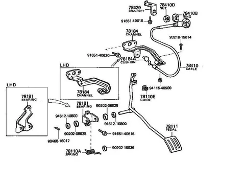

And one more pic from Toyota:
:beer:
Very nice - thanks Marbles.....that is EXACTLY what I needed to see.
In short, it looks like the pedal (78111) is still in tact and not butchered. The rest of it, including 78184 Channel, seems to be missing. Yay more parts sourcing. It also looks like that "channel" I speak of is handed LH and RH - they even look different. (grumble grumble).
Would be nice to hook up with someone in Canada that has a parts rig I can work with. I need to start making a list.
I really appreciate all the help!
dallas
