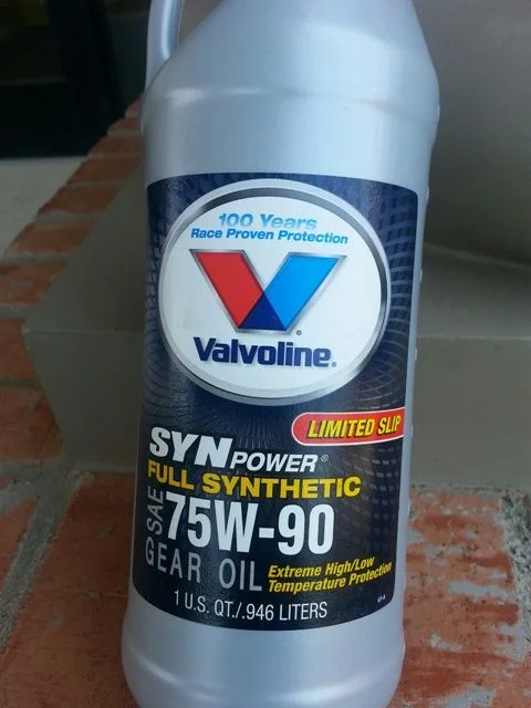

Hey Guys, would this be OK for the transfer case fluid change even if it says LSD?
Can the front diff use the same weight (80W90) oil with LSD?
It seems like, it's very hard to find the gear oil with out the LSD?
Yes on both the transfer case and diff's.
