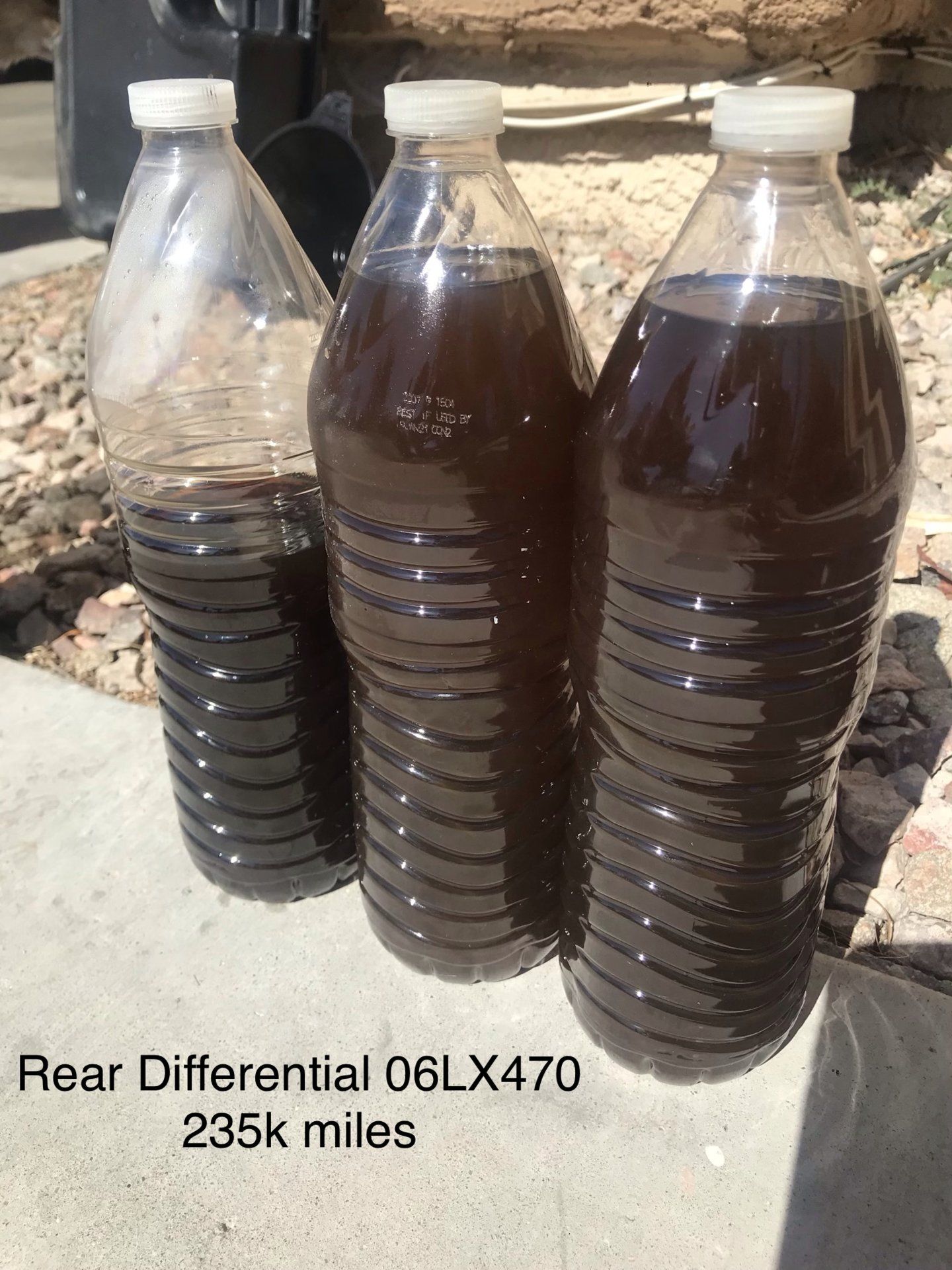

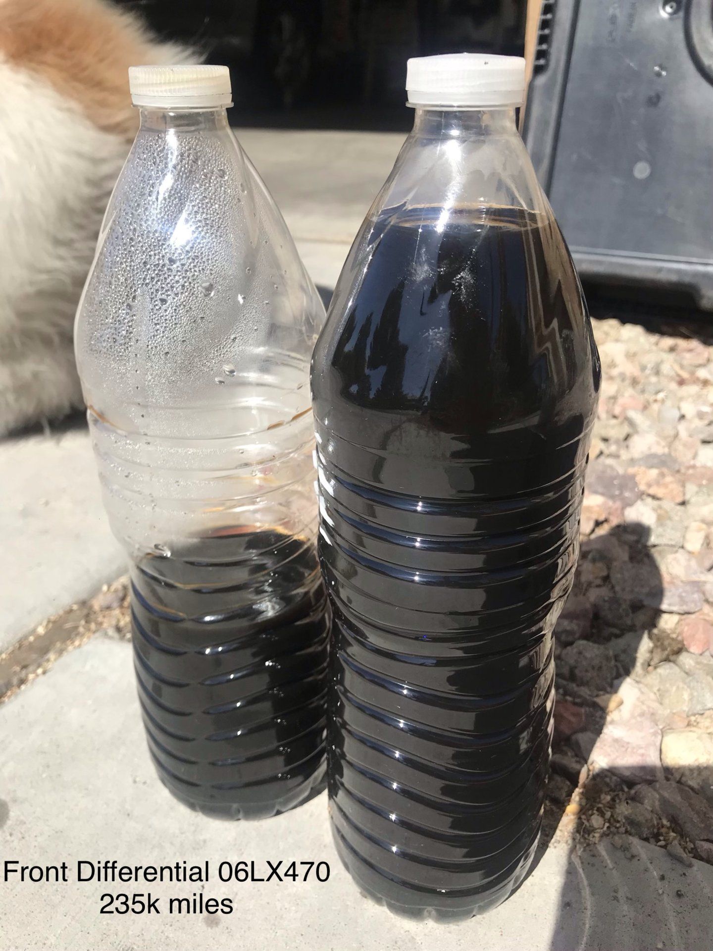

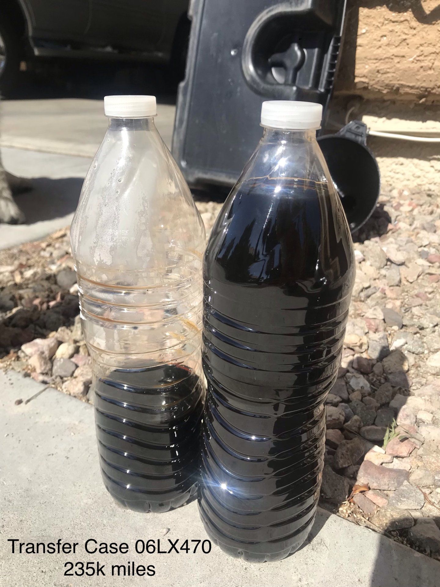

I cannot find any service records pertaining to a FD/TC/RD change fluid from the previous owners (you be the judge). I noticed the front diff oil and transfer case oil are really dark and smelled burnt, while the rear diff oil is brown in color. Also, I collected no metal shavings. Guessing I dodged a bullet here.

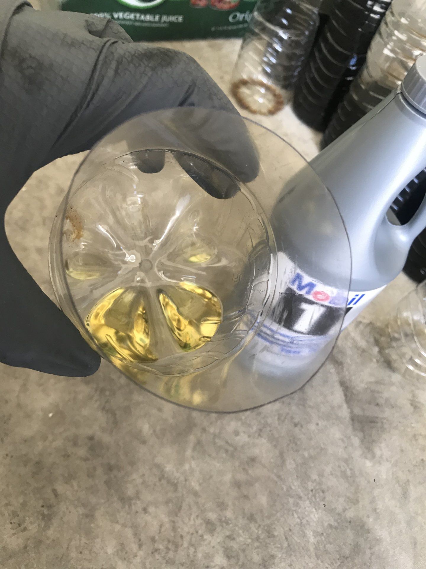

How our diff oils should be:
