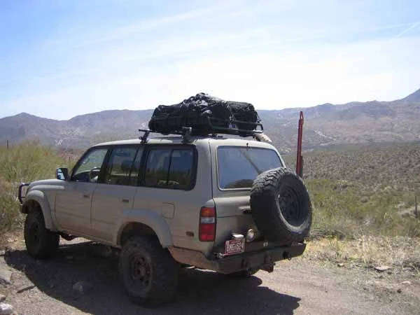

UPDATE:
Hauled a bunch of crap on the rack for 6 days in Canyonlands.
The rack itself worked flawlessly.
Couldn't be more pleased--except the Plastidip didn't hold up.
Anything hard--like a metal gas can--or sometimes even a firmly-cinched strap, abraded through the Plastidip. Once compromised, it even peels a wee bit--didn't seem to bond well to the aluminum.
Most of the paint issues are on the cargo surface, so you can't really see if unless you're looking down on the Cruiser. But over time it will look haggard. I'll repaint it with something else in a year or two.
VERDICT:
H-Moose--YES!
Plastidip--No.
Hayes
P.S. Unfortunately, my computer has proved far less reliable than my 80. It pretty much $hit the bed and died last week (sorry for the language).
As soon as I get its replacement up and working, I'll post a load of pictures and video from our Maze trip. (Next week?)
Hayes

You must have missed the update. Here ya go:
https://forum.ih8mud.com/showthread.php?t=92957&highlight=Maze
As far as the rack goes, it's been holding up great. I have loaded it up for camping trips several times since first building it, and it has worked great. I typically load bulky, low density stuff on the rack (camp chairs, PETT toilet, etc), and I have carried my 5 gallon gas can up there many times. I'm looking to get some cheap dry bags so I can carry things like sleeping bags and clothes up there and not have to worry about the weather. I've also carried a whole bunch of firewood inside a big canvas roof sack.
No wear or tear is evident on the rack. It is still rigid and strong. The only complaint I could give is that the rails are really an odd size as far as getting the standard strap-hooks to fit. No biggie.
The Plasticote paint has held up good on the outside (visible) edges, but there are several places on the actual cargo surface where it has peeled off. I think it has not held up well because I didn't prep the aluminum for paint. I'm not really worried about it because everything on the rac is either aluminum or stainless steel--and you can't see the peeling paint unless you're looking down on the rack.
bderks,
I don't think I would use the H- or J-Moose as a base for a roof-top tent. It is a sturdy design, but it is certainly limited. It would work fine if the ramp part of the rack was mounted on top of some actual steel cross-bars (Yakima, Thule, whatever).
Hayes
