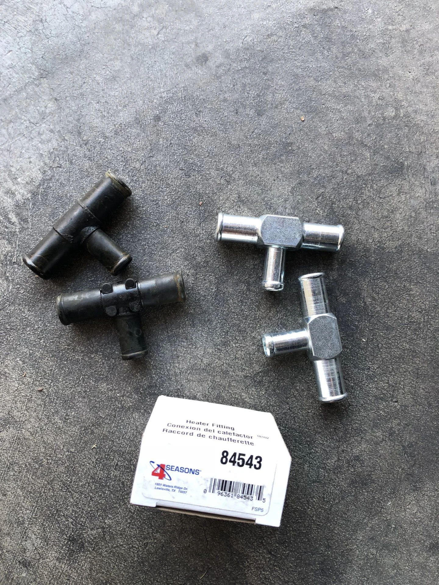

Can someone point to me which Breeze CT clamps to get if I use the 4 Season t's?

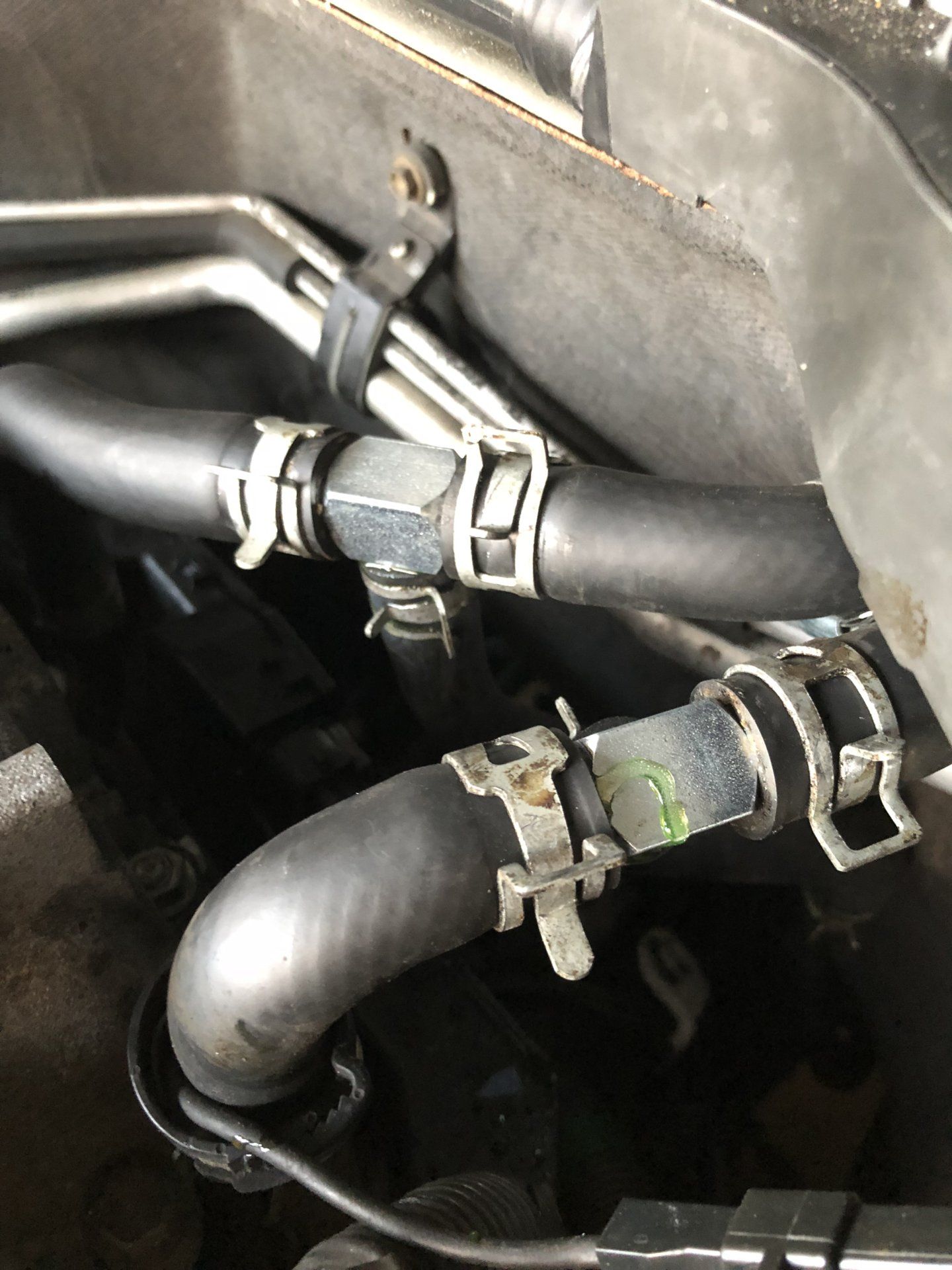

Decided to do these. Got the 4season t’s and installed them. Started the car and discovered that a lot of the coolant was leaking. Either my hoses are too big (fat) or I need new clamps. Reinstalled the Toyota ones for now as they still in decent condition.
Toyota clamps must be placed back on hose they came off in same position as they were in.
Use worm clamps instead, or orient the oem clamps in the indentation that were before, this gives them that extra compression on the fittings.

Thank You. I will get new clamps from HD and get this sorted out.

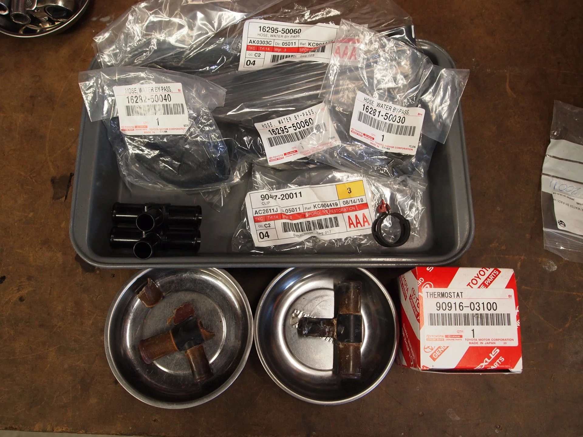

The guy doing my timing belt told me that my hose T's were "like mush" and broke apart when he removed them. Had to pull another hose just to fish some of it out. Original T's on a 17 year old LX with 170k mi.
If you haven't done this on your 100, for the love of god, do it. Total parts cost $20.

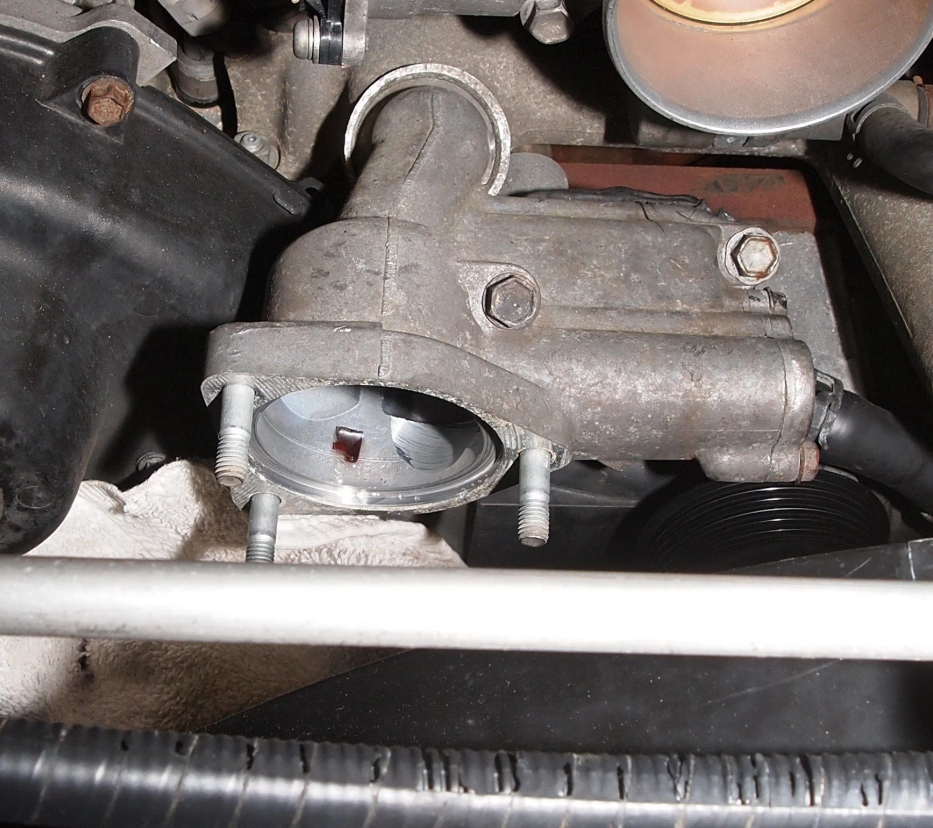

I'm careful to get every piece. Once each piece on the bench, I pieces together like a puzzle. This time I was missing a piece, which may have fallen out onto transmission. Not sure, where it fell. I back flush, the engine coolant system with a pump. Finding only a small piece in my back flush catch can. Which was not as much, as I was looking for, I just moved on with flushing entire system as planned. After running gallons of distilled water through, I move onto replacement of thermostat.
Ureeka!

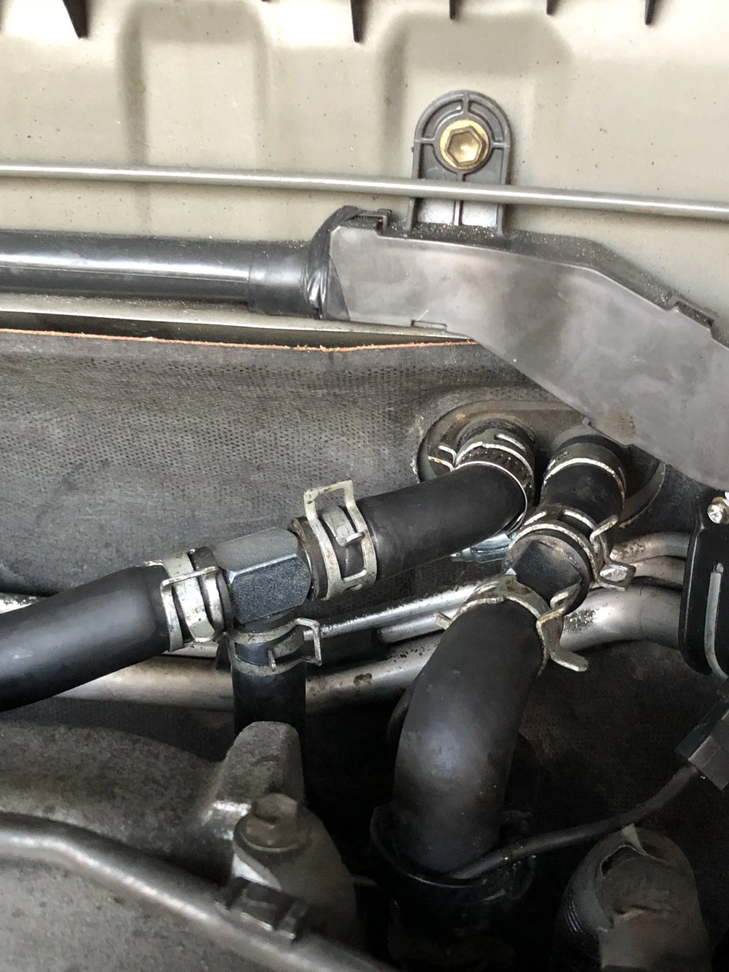

I've done enough of these to wise up and remove the hoses with the tee still on, esp the hot side. No chance of it breaking and you can easily seat them back in without them leaking.

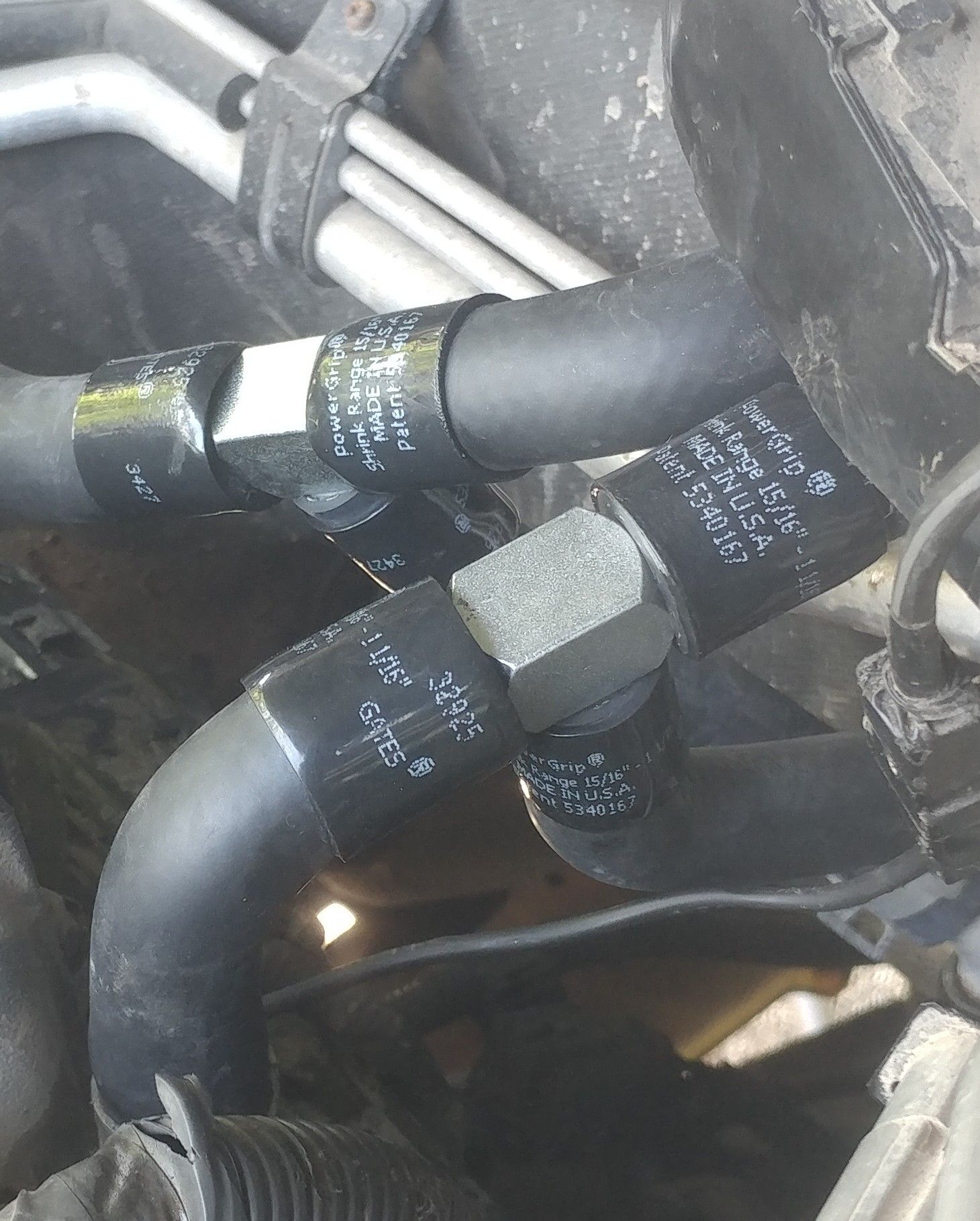

I did mine several months ago and used Gates Powerclamps. They work great, never spilled a drop even when used on the original hoses that were heavily indented from clamps (I've since replaced the hoses as well as you can see in the pic) Just returned from a trip and it handled laboring up the Colorado mountains and the ridiculous temperatures of Las Vegas without issue.
