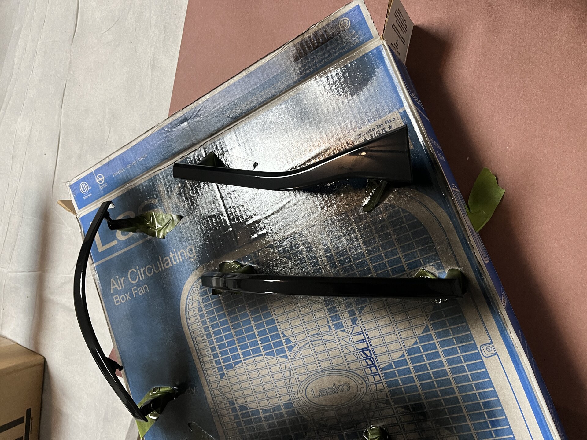

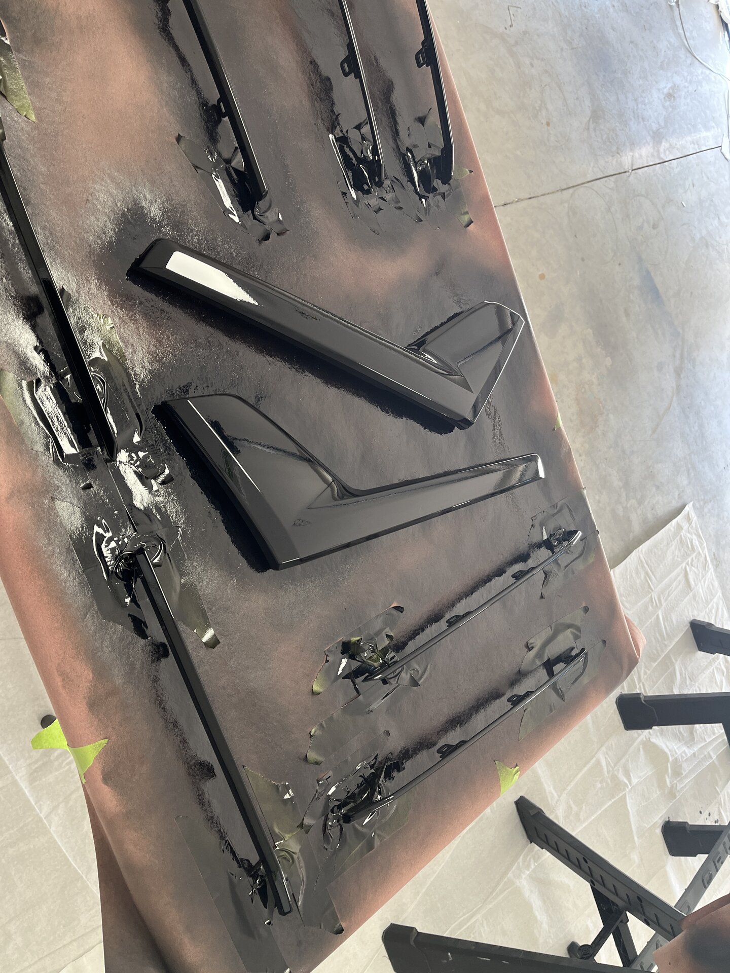

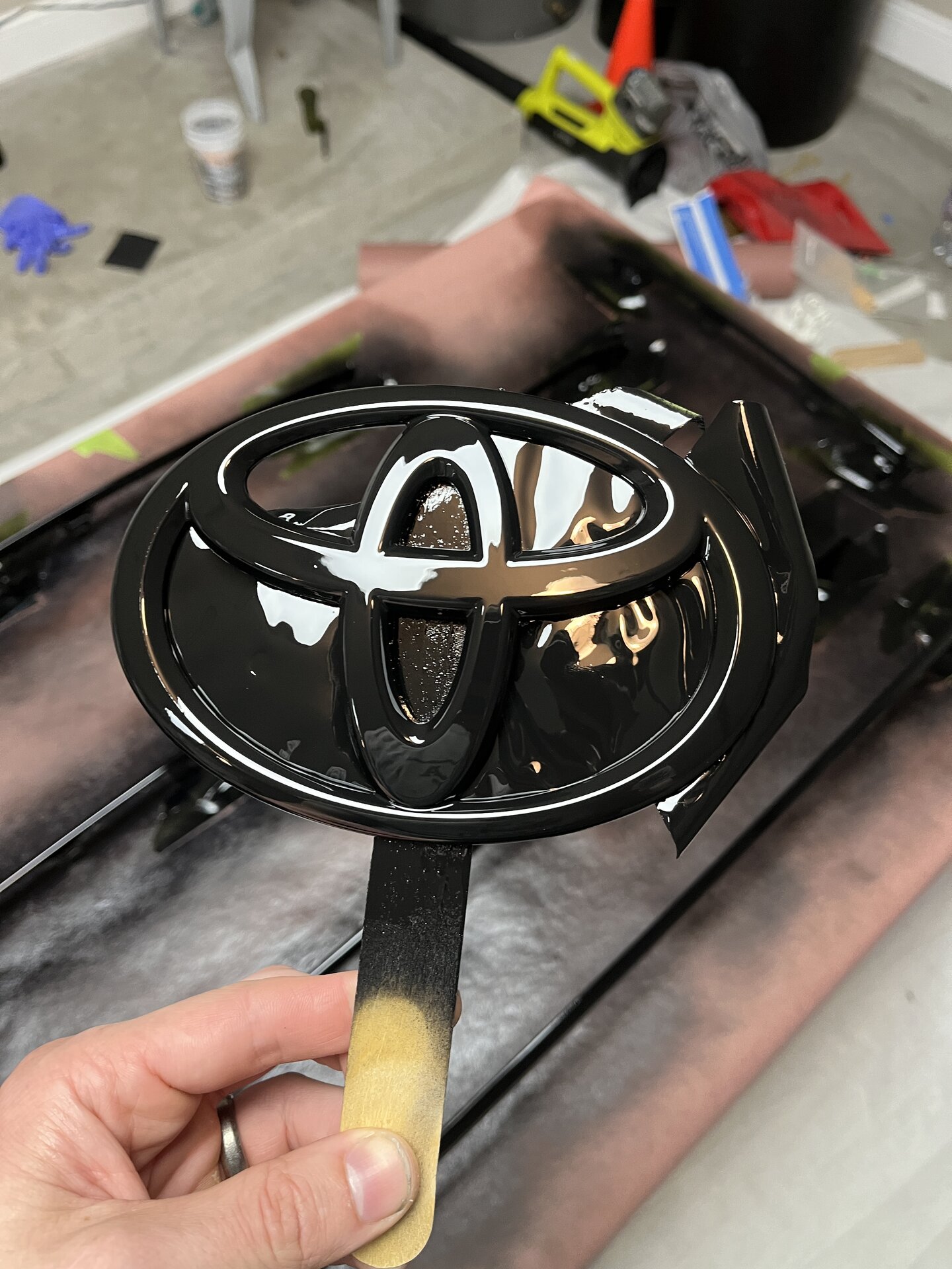

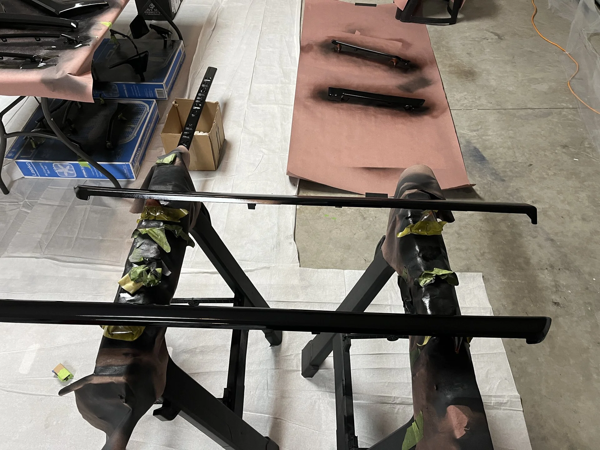

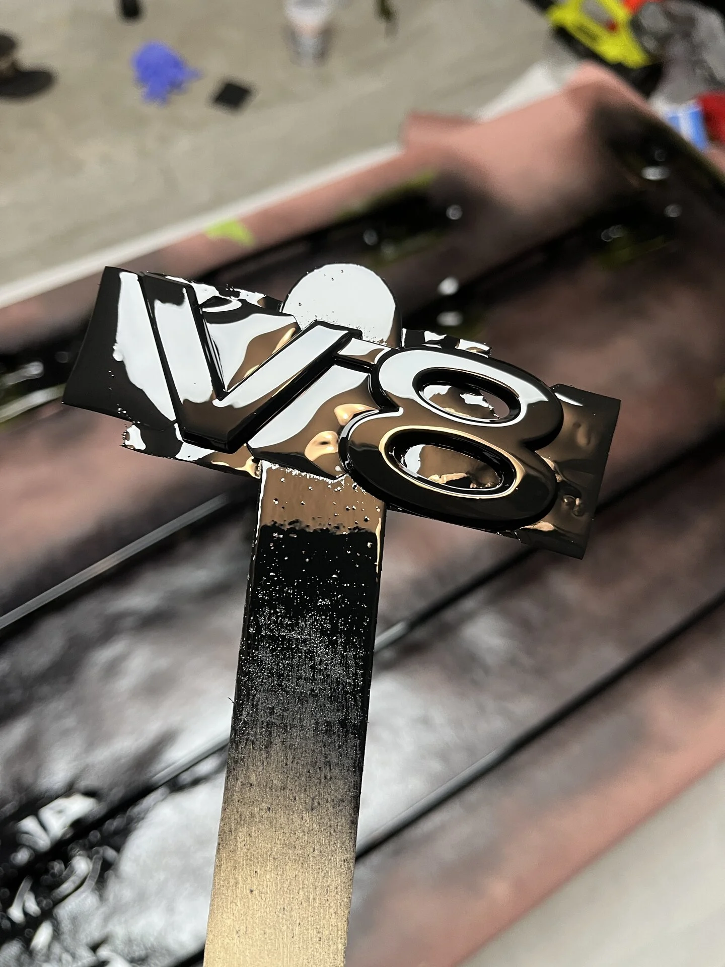

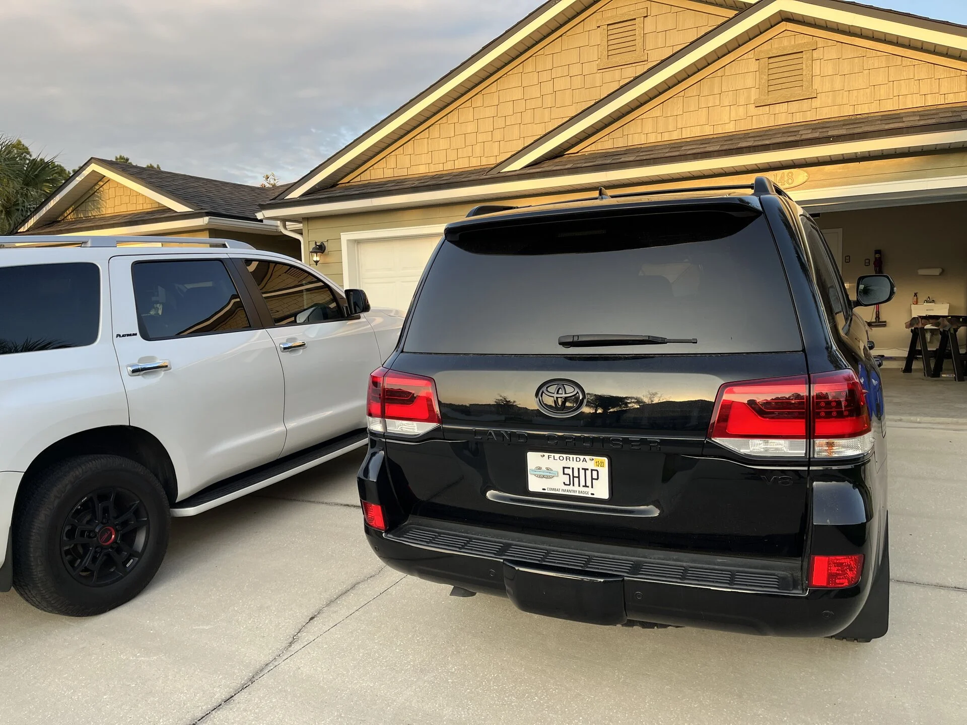

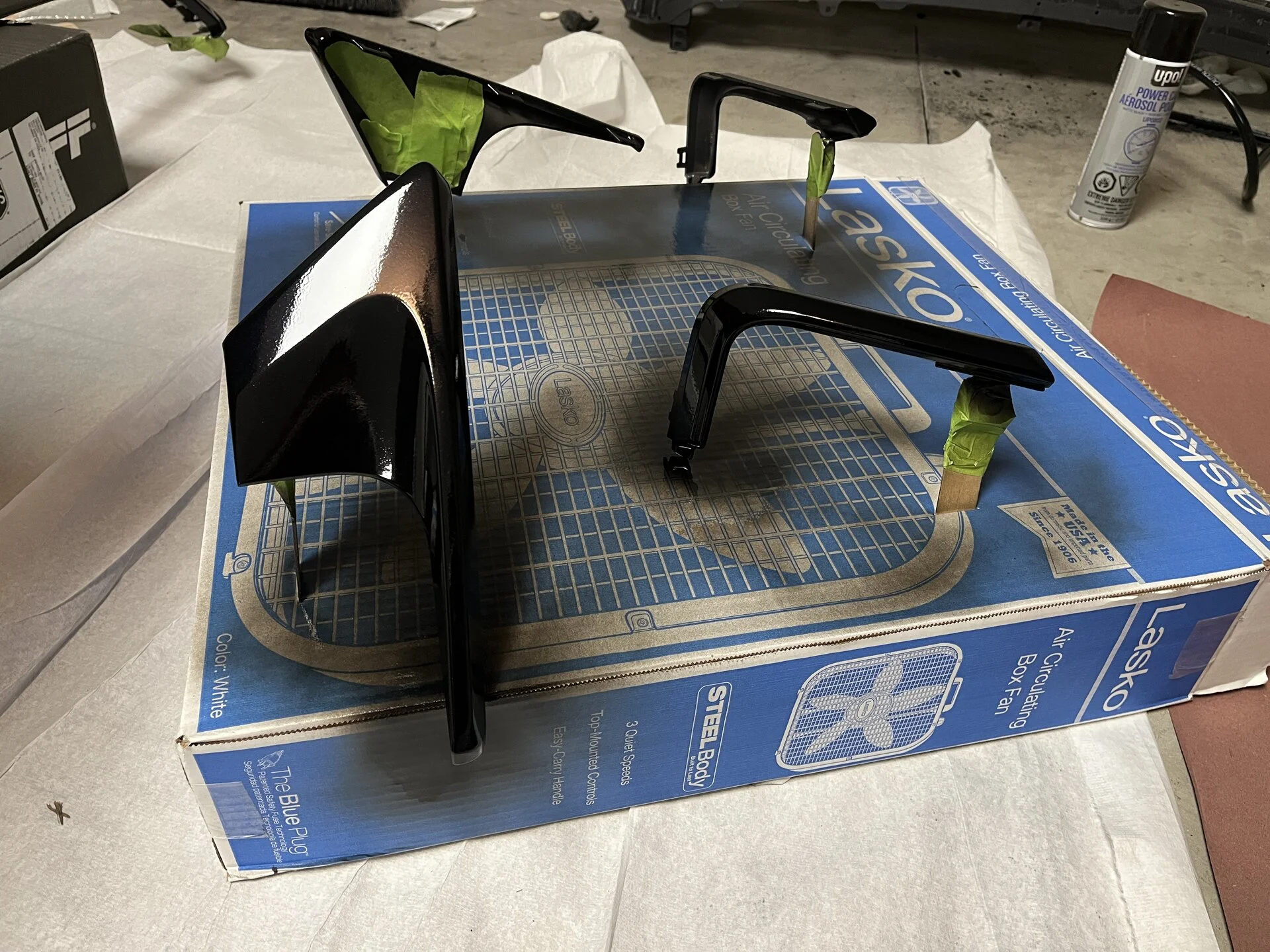

I wanted to take a moment to share my experience and pass on to others that you can totally do your own chrome delete and get professional quality results. I have never done any automotive painting other than the typical paint touch up pens. I will provide a breakdown of supplies to the best of my memory as well as the resources I relied on for painting confidence, part removal, etc.
Super important tips before proceeding with any of this work (learn from my 2 major mistakes)
  • DO NOT use the solvent-based wax and grease remover on a part after any adhesion promoter, primer, or base coat has been sprayed onto it...you will have to start over
  • DO NOT use aircraft remover on any of the ABS plastic, and quite frankly on any of the components for this process. Let's just say I made a $700 mistake and had to purchase a new Grille.
  • Be extremely careful removing the window molding to paint, the chrome will crease and look like crap (I ordered new one's for the rear of each side because they got mangled.)

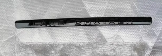

I just picked up a 2017 LC200 and have been extensively browsing how to delete all the chrome. I found this ebay listing and after contacting the seller, got actual photos of the piece. It's a direct replacement, not an overlay.

View attachment 3271191View attachment 3271093View attachment 3271095View attachment 3271186View attachment 3271187
