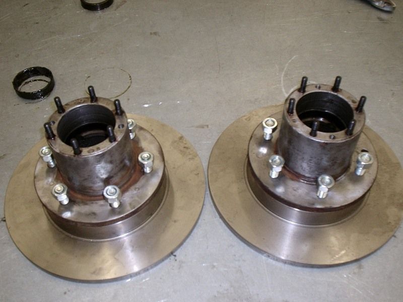

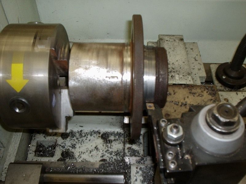

Anyone have a link to the thread mentioned with using front knuckles to make rear discs? Very interested in that and I even have parts kicking around to do it. The original link doesn't work, which is why I'm asking.
your welcome :D
