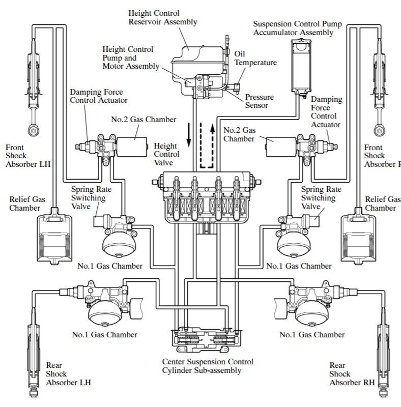

Outside the mod/equity discussion, I'll comment on a few other items
For your front end sagging in park, sounds like the system is leaking down somehow and obviously not normal. Check the struts to see if there's any external leak? Seems to me like an internal leak at the central height control valve. 165k is not really much to these AHC suspensions if they're maintained and in good working order.
If you keep the AHC sways after a spring swap, they should still be tender enough to allow full flex (so don't need a decoupling system) depending on the static spring rates you choose. That'll also decide how much cornering roll resistance you'll have in the end. Note that you'll give up some manner of brake dive and acceleration dive, as the AHC systems has active compensations for this, again depending on the aftermarket static spring rates.

Thank you so much for the feedback! The diagram is great.
Quick questions do you think there is a link between this and the front not wanting to stay in H in the display(still moved front up but not all the way).
Second, where is the height controller located? On the chassis near rear left tire?
Again thank you for the detail and diagram
