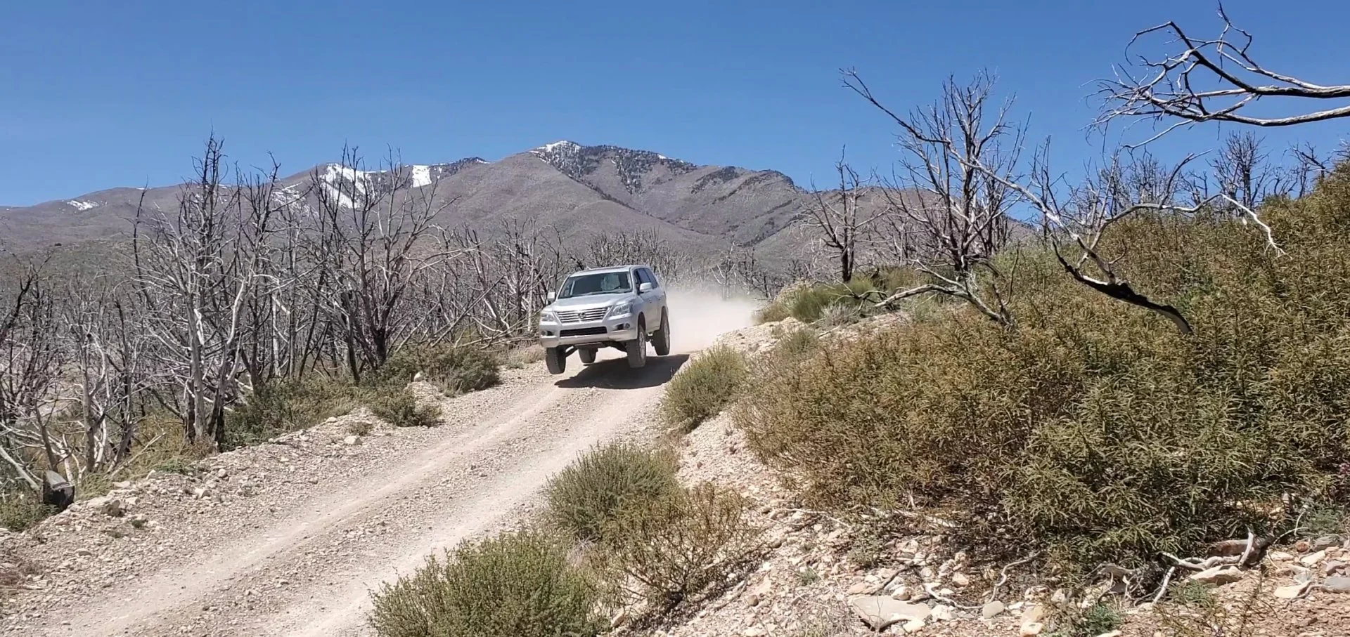

But can AHC make pigs fly? Not sure I'd try.
Can't say I don't think back to the pic of your LX catching air @turbo8
I don't think I posted this in here.
