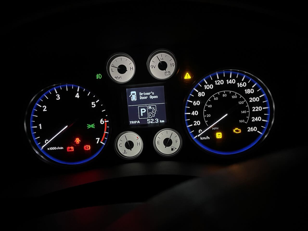

AFS is a nice luxury. I checked to see if I had photos of which connector I discoed from the suspension module but I do not. Wondering if that makes a difference.
I have a knock sensor fault, so that is lighting up my dash, no other codes. that being said, I can no tbe sure that haveing the fuse and relay in are not causing lights at this point but the codes say it is not.

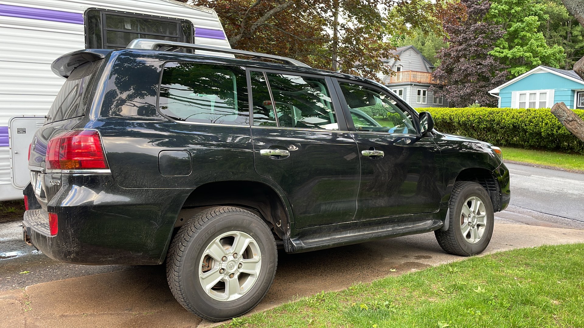

Few photos with stock diamerter 18" Michelin winters on Tundra wheels, and stock diameter Pirellis on LX570 20" summers.

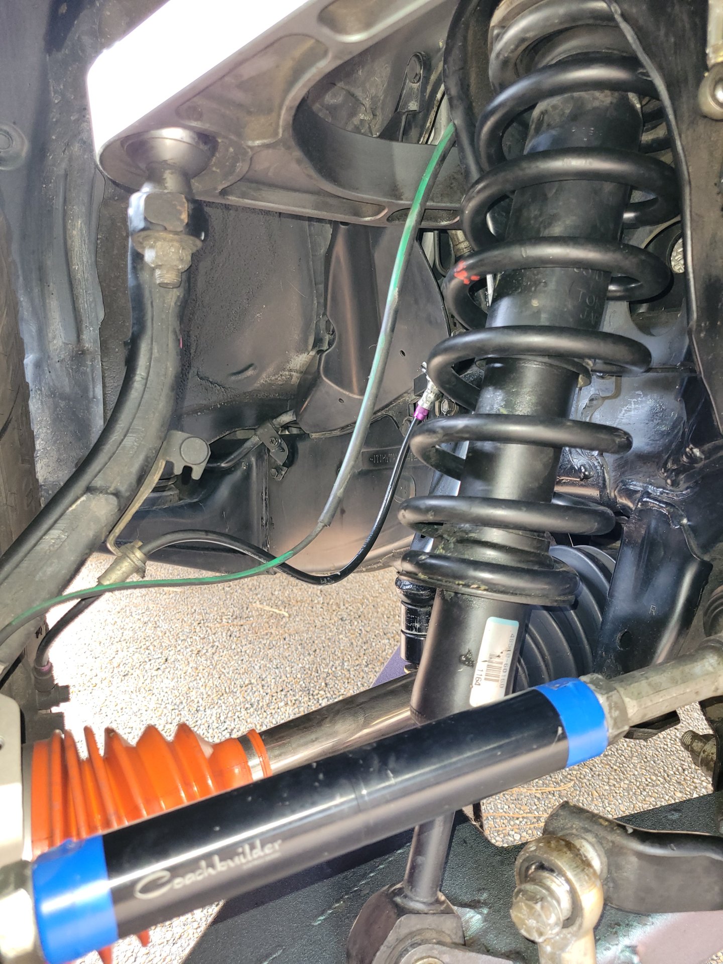

So I'm an idiot!!!.... ahc wasn't working and I was tired of messing woth it.... I ordered king 3.0's and they're scheduled for delivery yesterday... so I started pulling stuff off starting woth front shocks... wouldn't you know I found the speed sensor/ ride height sensor unpluged 🤦‍♂️... so now I'm curious if it'll work now... put everything back together and it did... SDHQ says they want 20% restocking fee... plush shipping itll cost me 1500$ to return... so I guess I'm keeping them

I had actually put in dobinsons front springs and 80 series factory rear springs but AHC didn't like it up front... drove like a boat in rough seas... went back to stock springs woth 80 seroes rears and it drives like it did factory... probably is excessive pressure on front... I'll need to get tech stream to monitor... I've been on long travel arms and factory struts for 1.5 years... its holding up... but I'll probably end up swapping these kings in here soon

The lower shock mount is the same location as stock arms..arms... so the angle didn't change... I do have +6 extended break lines
Man. Serious weapons grade hardware with those coach builder tie rods and RCV axles.
