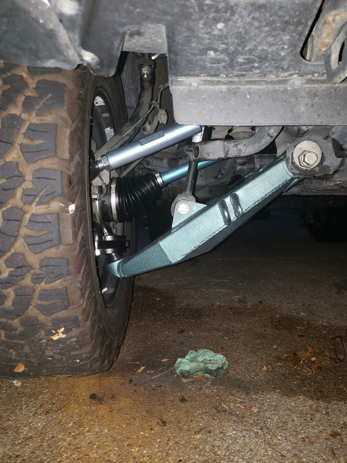

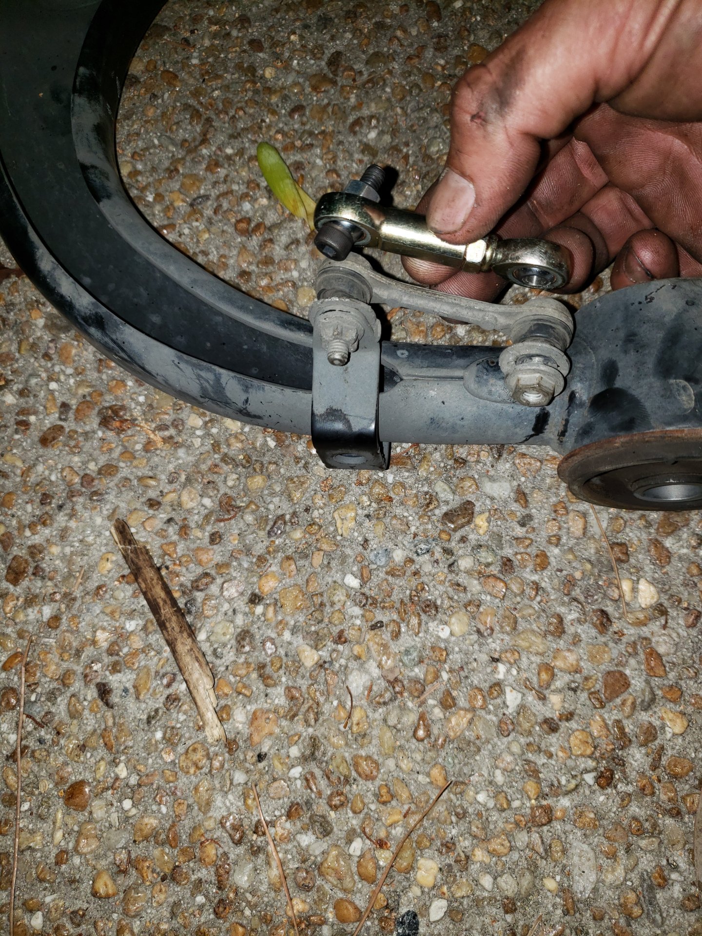

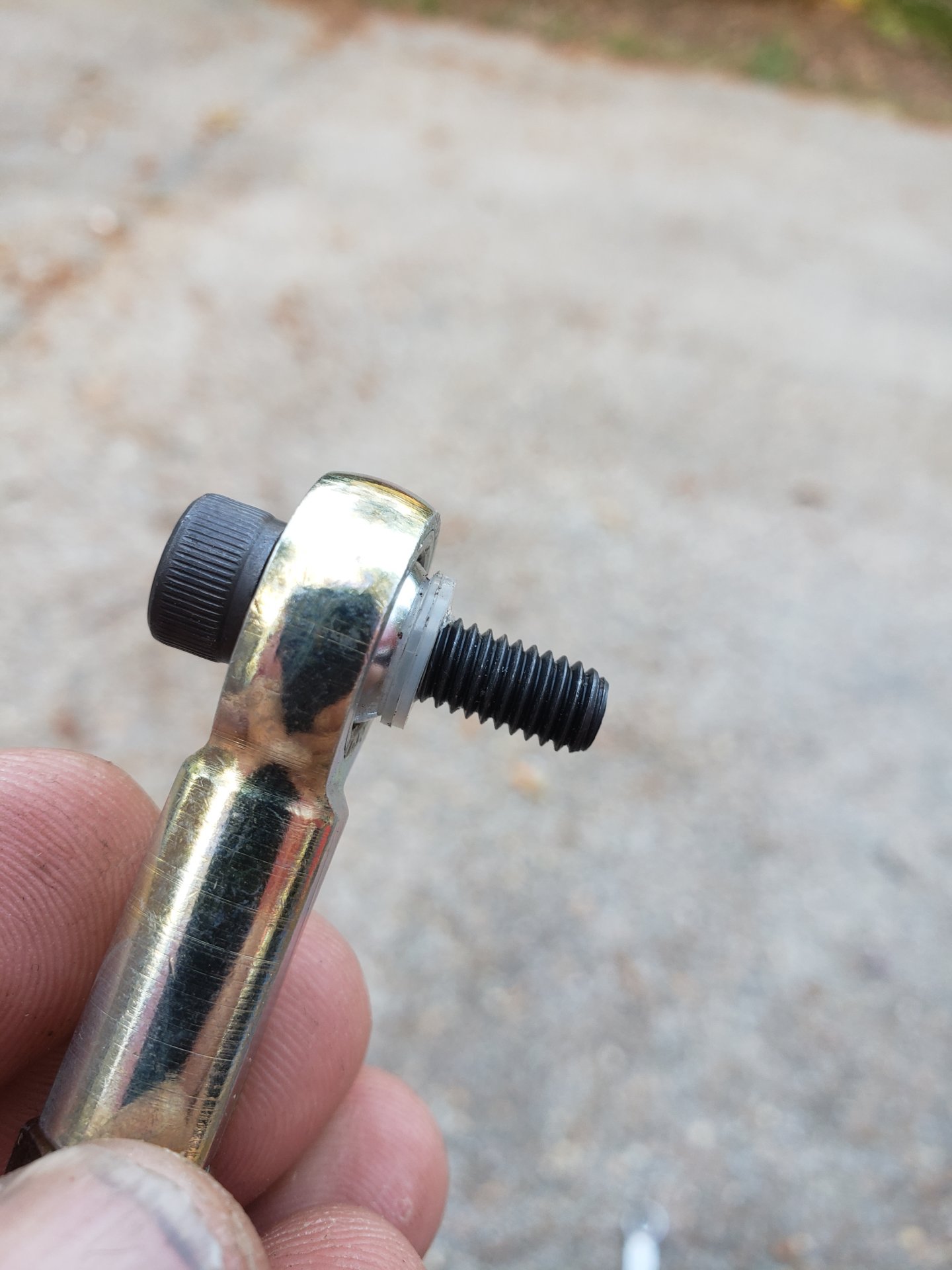

I changed the range of motion in my ahc by changing ahc connection rod length. Now the truck sits at where H was stock....and can go up and down from there.... next ill be wiring a ahc kill switch to the dash so I can lock in H or L and go over 20mph
Is there any change in the ride feel? How does it feel now when you adjust to HI mode?

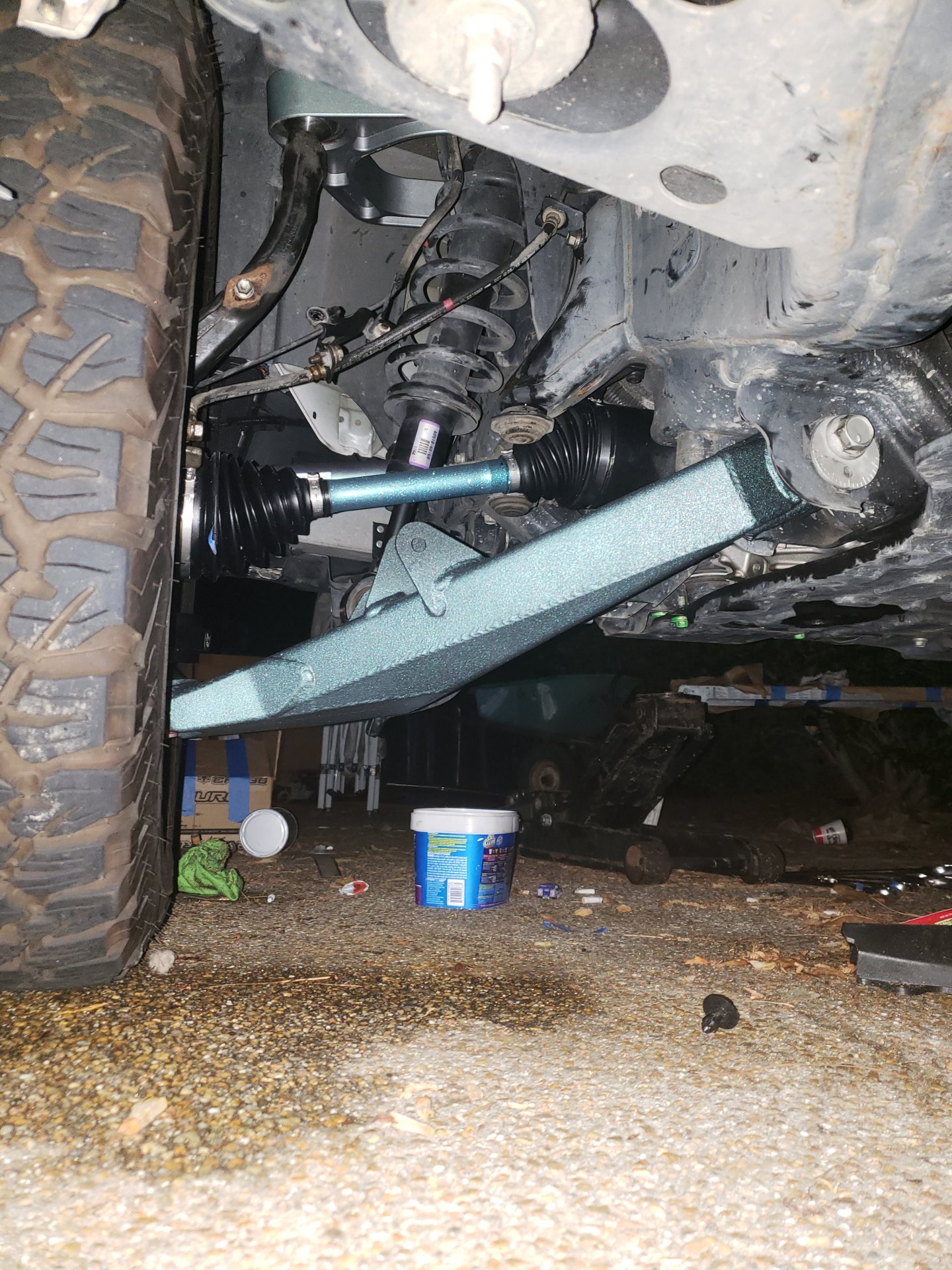

Looks like you need some longer brake lines and speed sensor wires.
Tundra parts are not necessary, LC parts will be direct replacement.

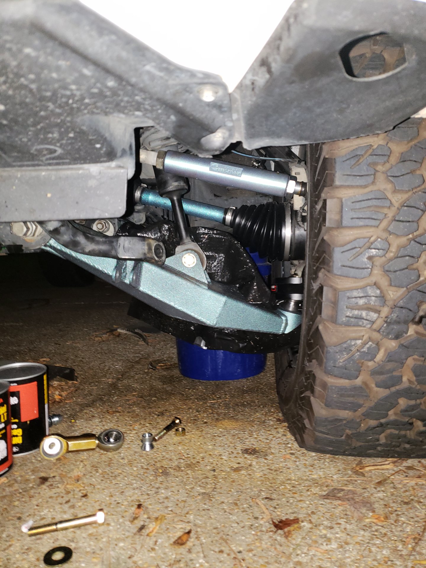

I'm using front components from a Tundra because they are wider than LC/LX parts.
Would Tundra shocks amd coils drop into the LX570 without issue, or are the LCA UCAs needed as well to fit stock Tundra shocks and coils?
Depends on the shock manufacture. The Tundra spec'd kings I have in mine required modification to the coil bucket.
Stock Tundra front shocks should bolt into place. You would need to cycle the suspension without the coil spring attached to make sure nothing creates issues. (shock bottoms out before hitting bump stops, shock allows too much droop and cv binds\pops out, etc.

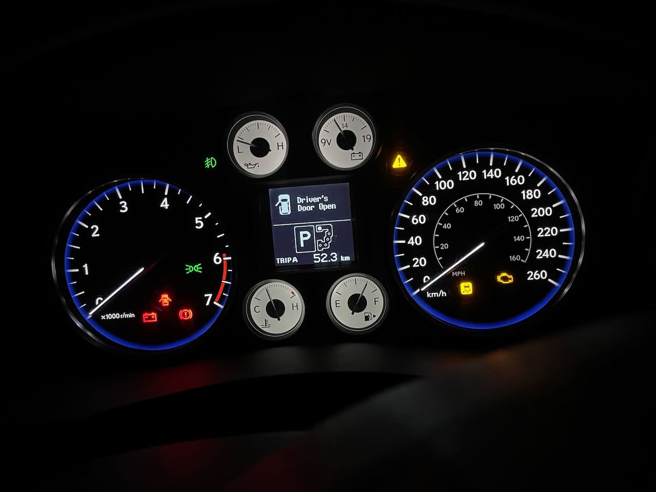

I have a knock sensor fault, so that is lighting up my dash, no other codes. that being said, I can no tbe sure that haveing the fuse and relay in are not causing lights at this point but the codes say it is not.
