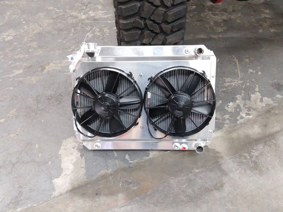

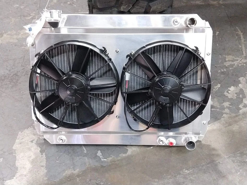

What’s a unit like that cost and is it a direct replacement for the stock 60 radiator or do modifications need to be done for it to fit?
It is a direct bolt up pattern and no mods. Ron Davis will make the in/out to your specs. This one is for the LS3 Erod.
Price........... To quote @beno.... IF YA GOTTA ASK.................. $1565.00 shipped with all the goodies.

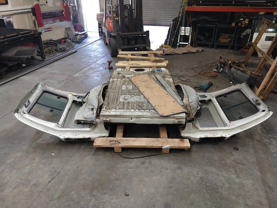

Great thread! I'm subscribed! I've been wanting to do this for a while now and you have me rethinking how to address the rear wheel arches and the wheelbase length (to fit an out of box solution for the tray). I was thinking of the below to address the wheel arches and would appreciate you thoughts on weither to go that way / or not. I did a vortec in an 80 a while back, Another Texas LS1 Swap, and ending up ditching the dual cats and did a Y pipe to a single 3" cat.
I'm at 132" wheelbase. I know it's a pic, but looks long in comparison to mine. Also, if you want to have anyone ride in the back seat DO NOT keep the angled rear glass. It is the easiest way to graft to the cut, but look at where your seat and headrest in the stock 60 are now. The head rest would be against the glass or further back. So you either have to remove leg room or have a negative angle rear seat...
I thought about a "full" rear door, but there is a lot of re-work and supporting to do it. A hybrid of the stock rear and front door merged together.
Just more work than I'm willing to do for basically the same out come; access to the rear seats.
