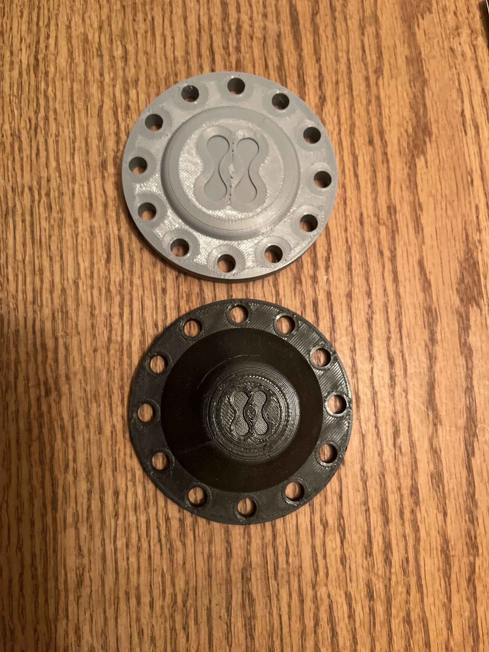

You mean I didn't have to model and 3d print my own?

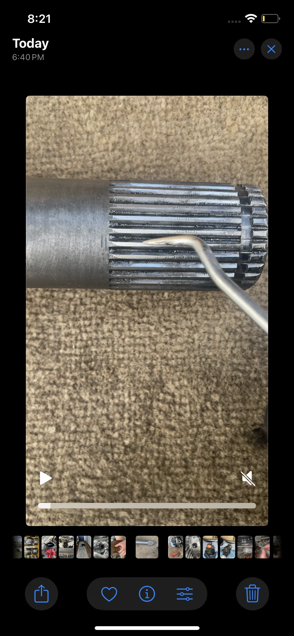

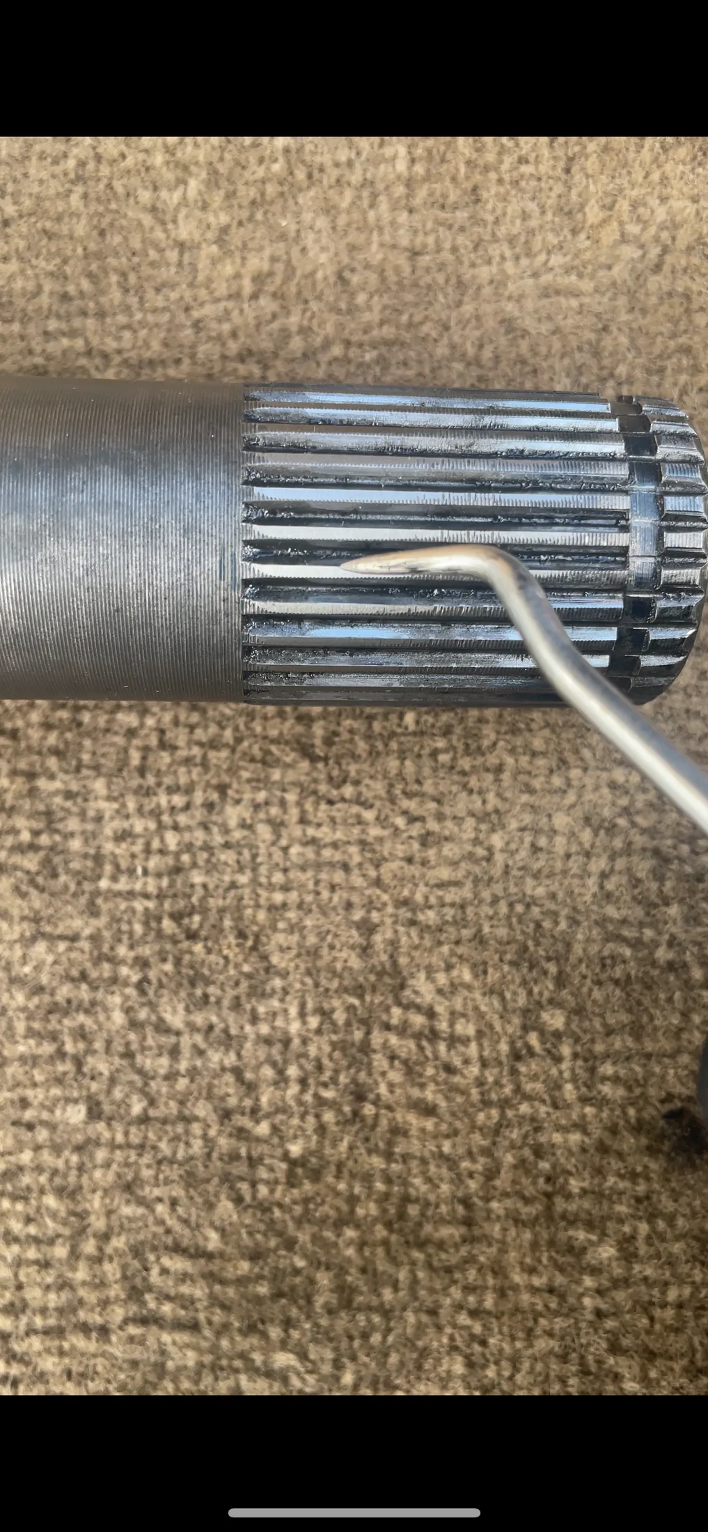

Alright guys the saga of me trying to figure this out continues. I was able to take a day off work and clean some parts. I noticed a few things and wanted to get y’all’s opinion.
Birfs:
Obviously I need a new driver side birfield. I’m unsure if I should just replace the passenger side as well, I don’t know what to look for in terms of wear and such.
Inner Axle Shafts:
There are clear signs of wear on the spline teeth on both driver and passenger sides. I will put videos below, you can see the wear on the end of the pick. Obviously in a perfect world I would just replace both complete cv axles but I am trying to do this on a budget. Buy once cry once I know.

Splines engage on the spline. That is, the face of the spline. Those OEM splines are involute and roll formed. In theory, there shouldn't be any contact between the O.D. of the spline tooth and the mating part. The involute profile centers the two members when a torque is applied. The major O.D. of the axle and the major I.D. of the mating spline are non interference. Your best bet to determine wear is to have both parts perfectly clean, and engage them. Wiggle them back and forth. From what I can tell in your pictures, there is nothing out of the ordinary.
