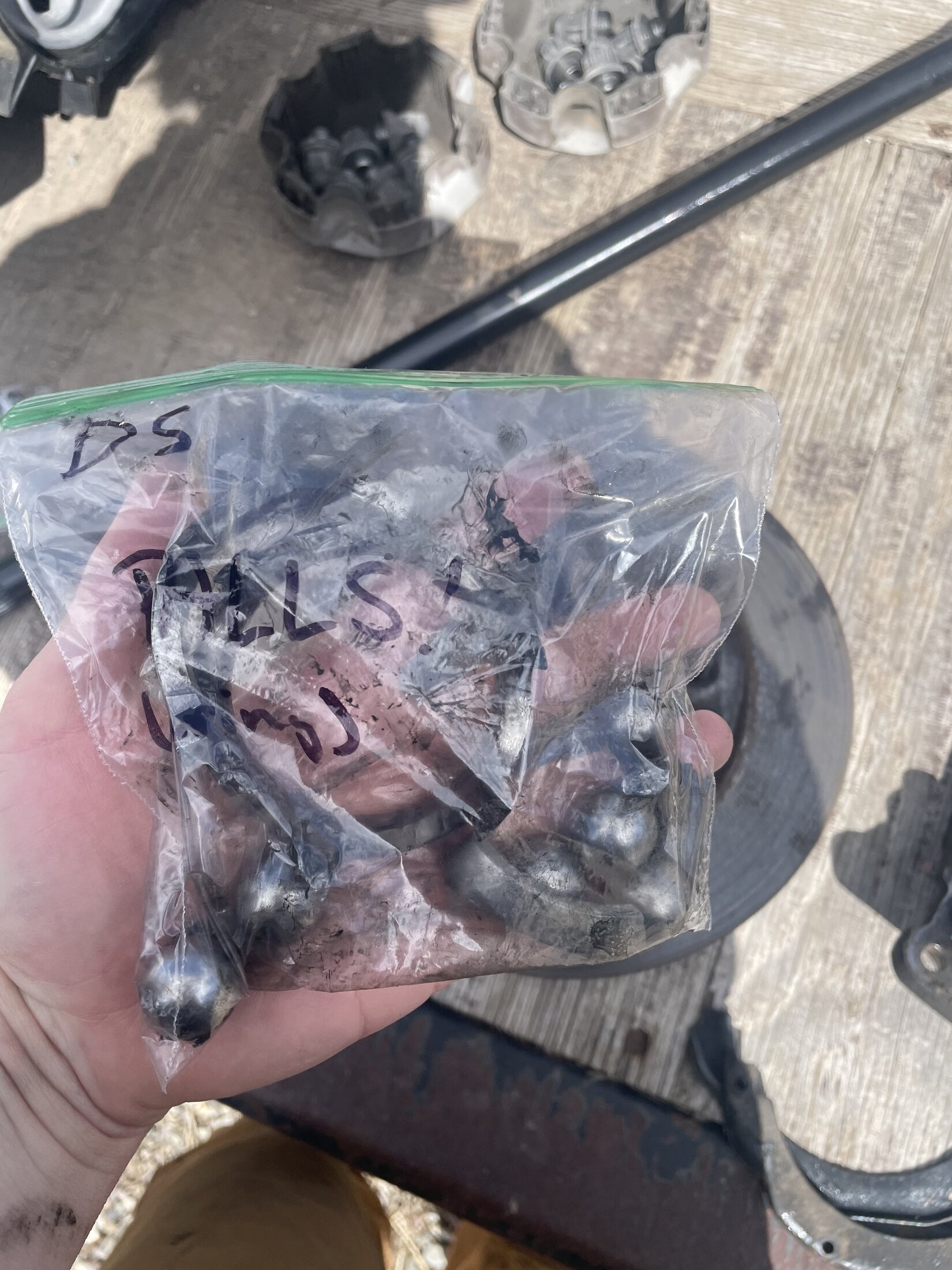

Well friends, just tore it down. It wasn’t the diff. I went to pull the driver side cv and only the end came out. In the knuckle housing was all the bearing balls and bearing keeper in pieces. New cv and I’ll be back in business🤟🏻. Thank you for all the advice.
This high lights the importance of getting it torn down to see what really wrong/broken before jumping to conclusions !
Glad you got it figured out !
