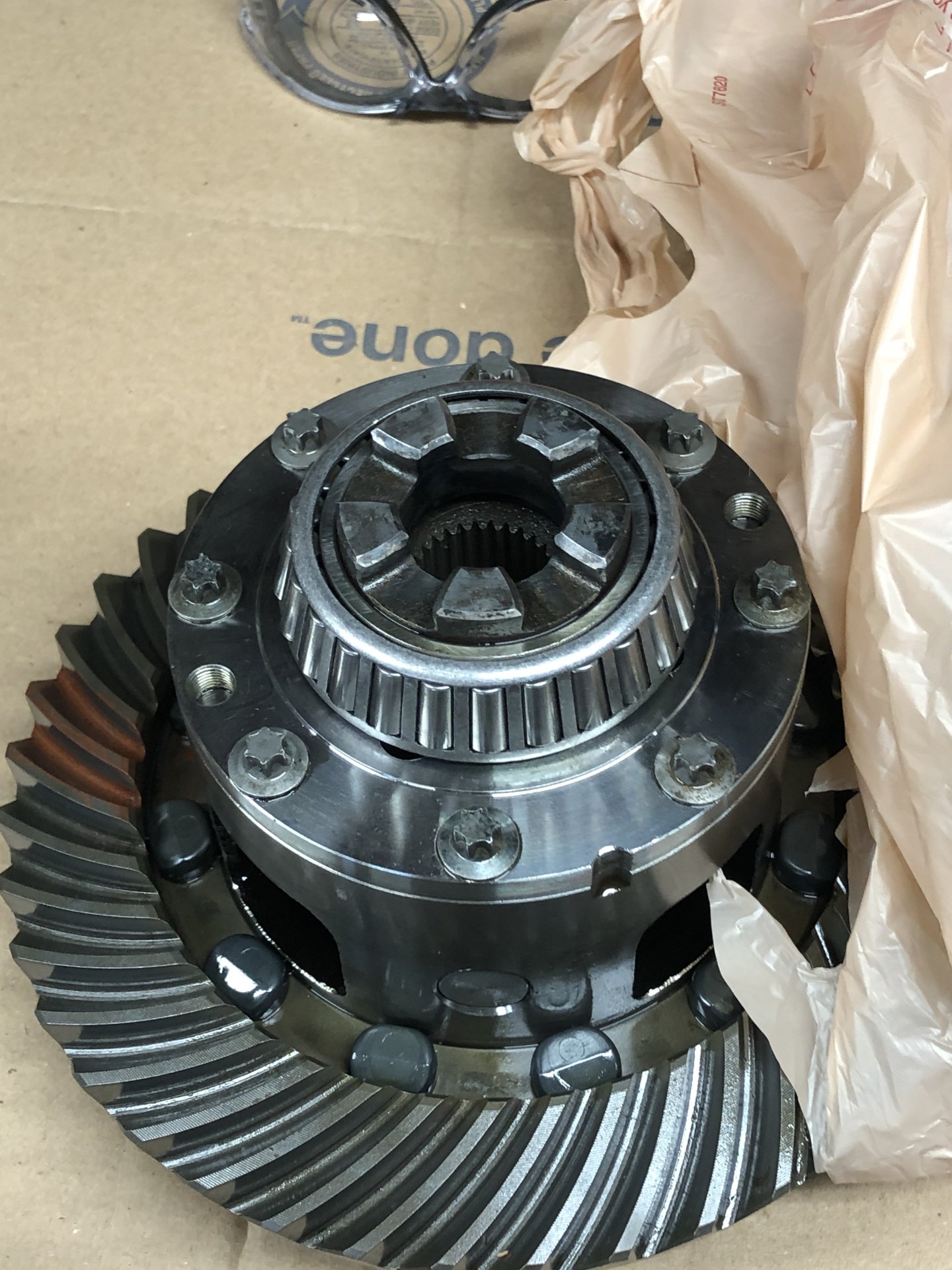

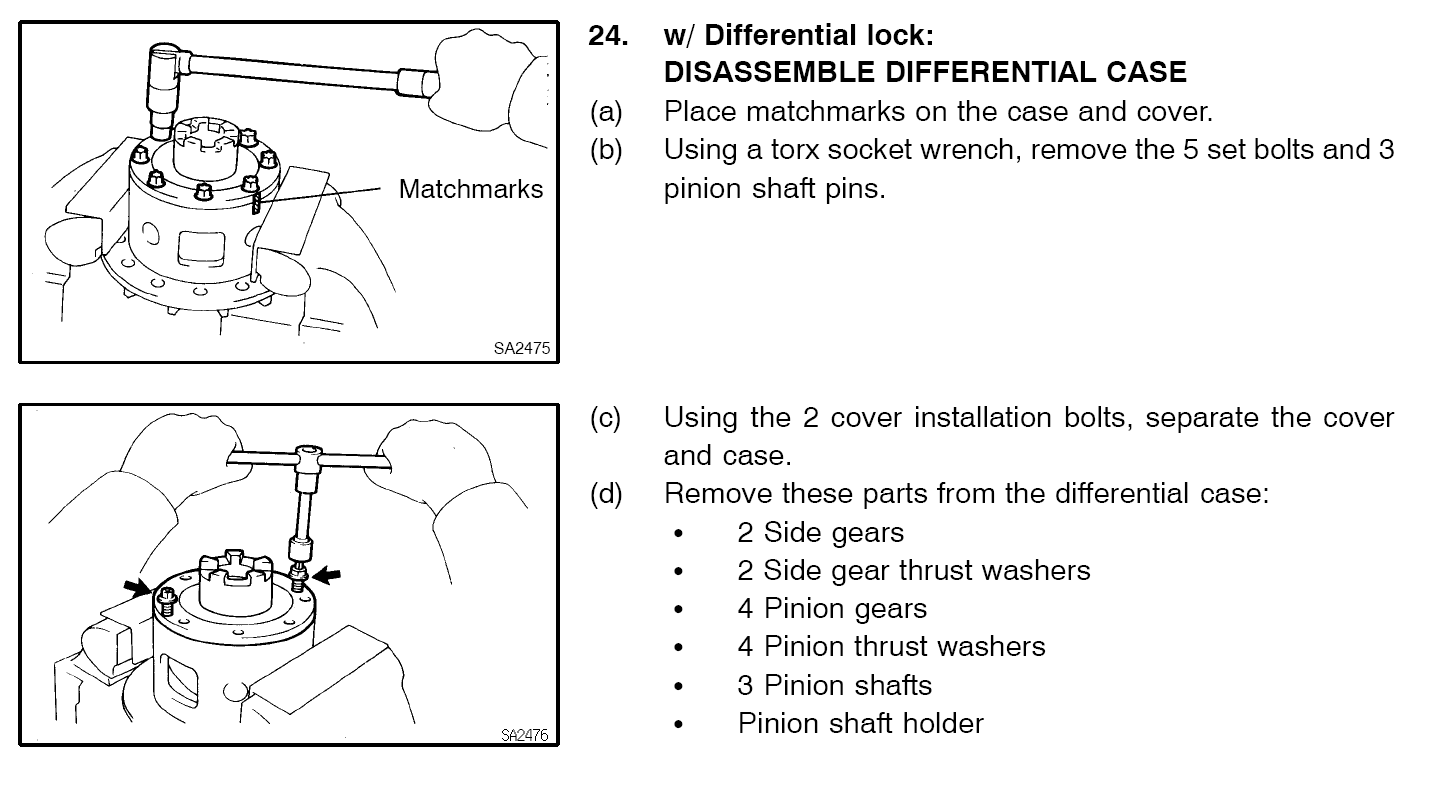

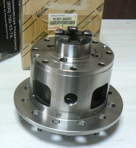

I'm looking at parts pages for my differential. Is the cogged locker toothed part a seperate piece?
Thanks. That makes sense. I just couldn't see it in the diagrams I had found at the time. I'm looking into the 32 spline axle swapI think it is the cover for the differential case, which means it can be removed from the differential case.
