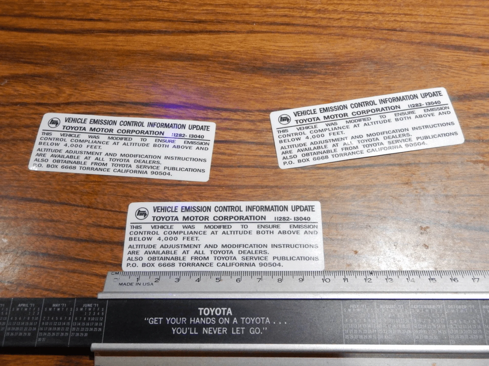

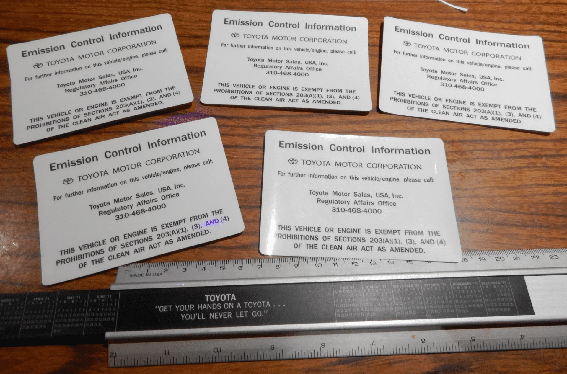

i have 2 thoughts :
i got some positive feedback recently that both of these helped 2 different folks escape the wrath of the MAN at the VIEP , MVA ? DMV what ever is called when they screw with your ability to get to work and back .......
over the total of less the 1% of drivers on the road ...........
i personally rendered the art work for both based off in my face originals in good condition
no promises , but i wonder if that phone # number is still good ?
