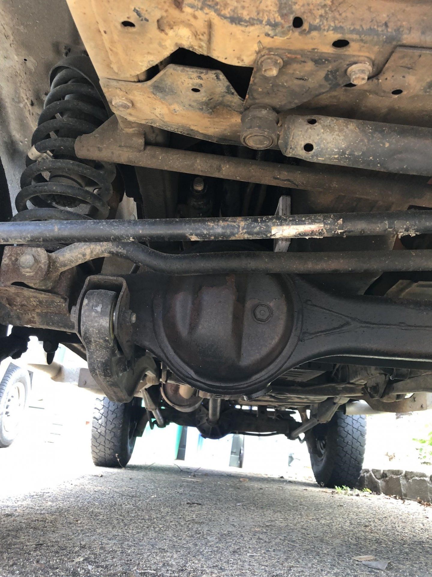

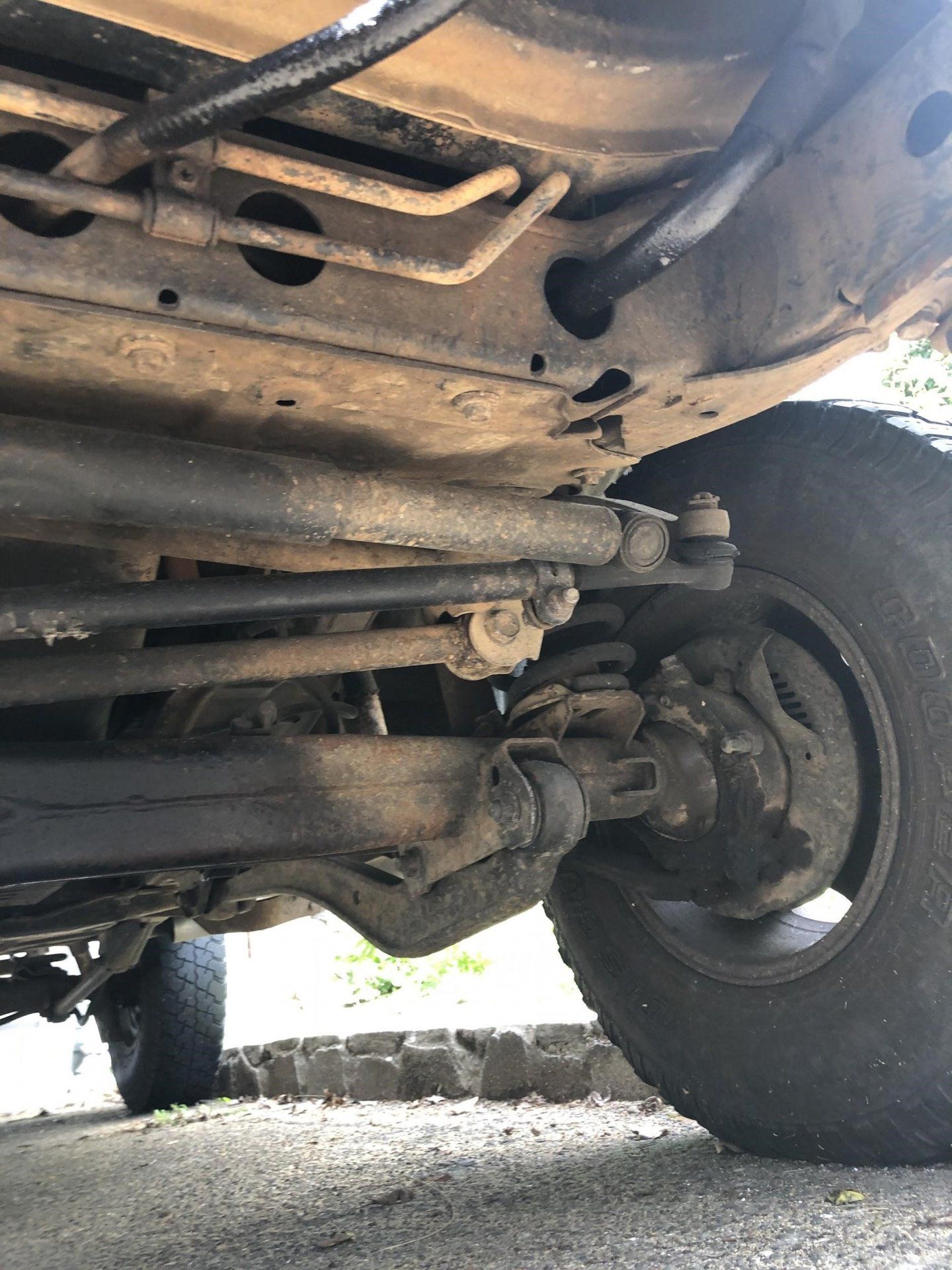

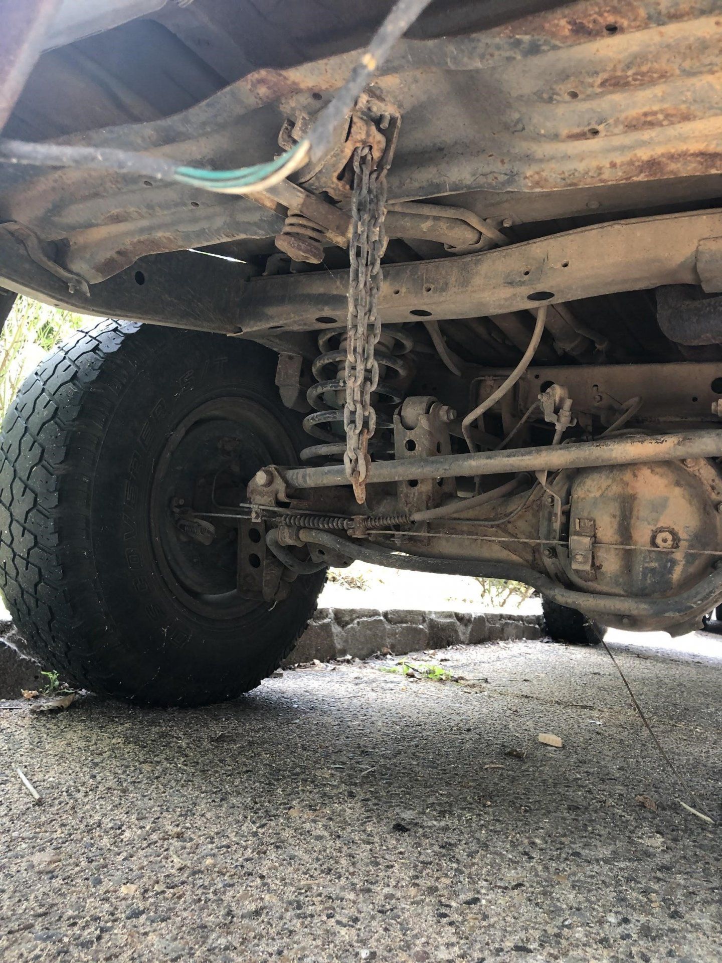

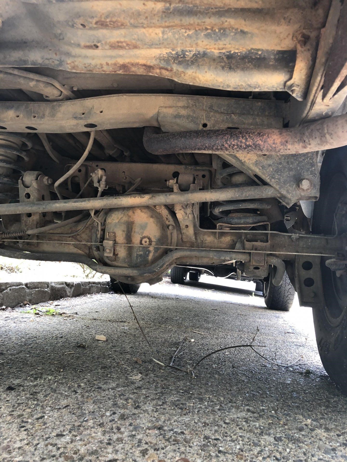

However, one of the things that I'm also looking at is the rust underneath the vehicle as well. I'm pretty sure this is surface rust and will probably treat the underside to a nice wire brush and some coating. However my concern is, there is something in the last image that looks like there a bolt that no longer is there due to it being rusted out. Is that support of concern?

Seen much worse. Some elbow grease should whip that back into shape. How is the rest of the truck?

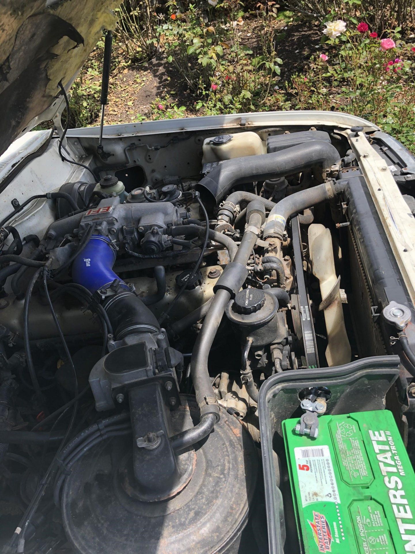

I've posted some pics of the engine bay as well and it looks like from my research that the EGR is still there which is good because I'll need that in California. I was also told that the last radiator drain flushed a lot of rusty bits out. I plan on using some thermocure to flush it out first to see if it's salvagable. However, not much else I can ascertain from the images.

That is already pretty clean. You have to have some perspective here...it's 28 years old and has 280k on it. It'll clean up fine with some elbow grease.
It looks like it may be in need of a front axle service (Knuckle rebuild) because the knuckle balls look dry.

Thanks for this, how can you tell the knuckle balls are looking dry and what are they supposed to look like?

There is a felt "wiper", if the knuckle has grease it creates a very thing film around the ball. Most scenarios for a front rebuild (messy not hard) are dry or leaking.

3rd pic down in your first post shows the inner side of the LF wheel and the knuckle. The large ball that the knuckle rotates on is dry, has some "rusty" kind of areas. That area should be slick with grease or shiny and wet. There is a square plug on the upper right of that knuckle (in that picture) that gets removed and you pump grease into that hole. It needs to be a moly grease such as Valvoline Palladium.
If there was oil dripping out of that area, we would tell you that you have "birf soup" and need new internal seals. You may still need that, there's just not enough grease or oil in there to produce either condition.
