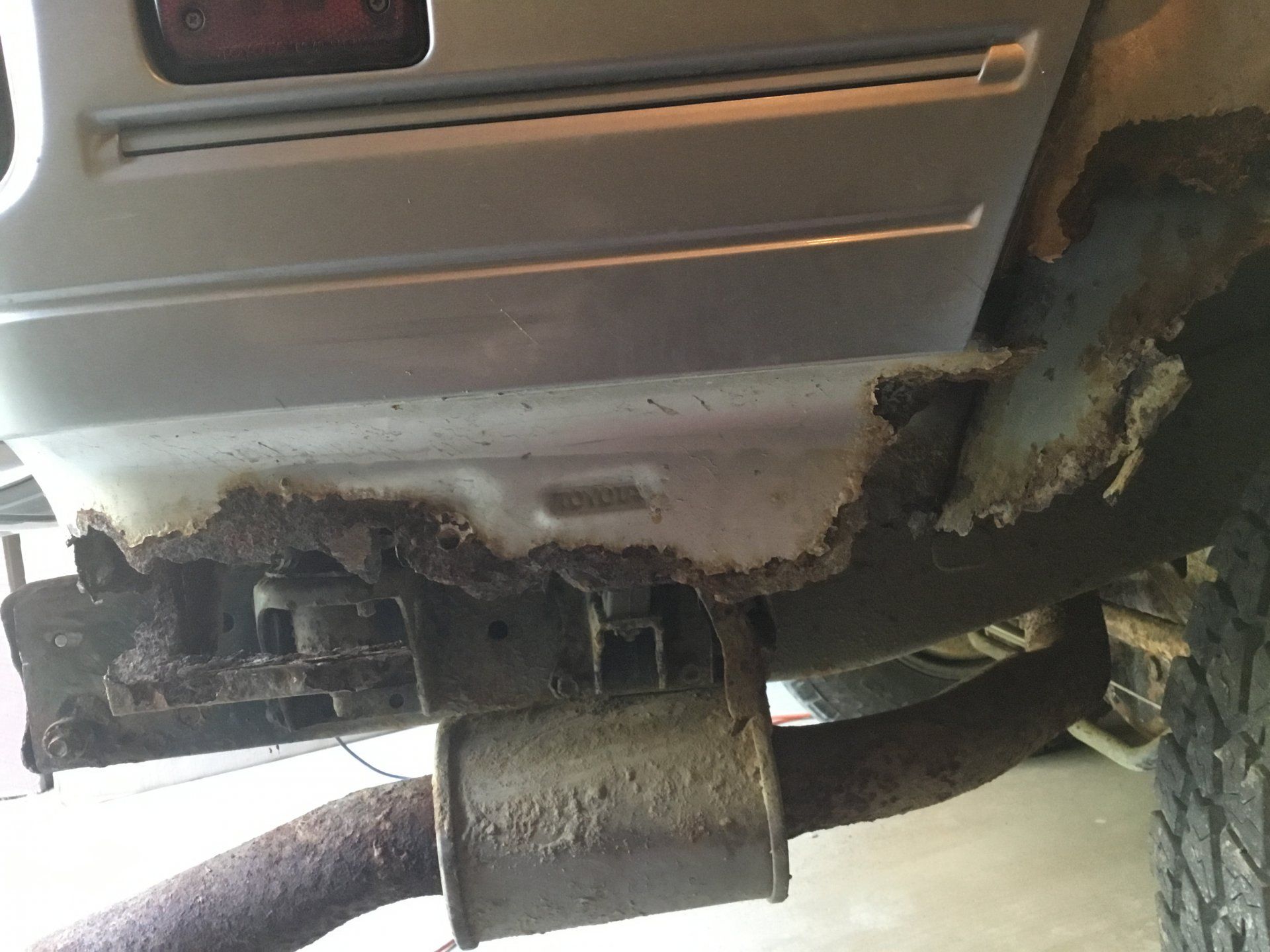

Determining if this rust will be an issue

However, one of the things that I'm also looking at is the rust underneath the vehicle as well.
3rd pic down in your first post shows the inner side of the LF wheel and the knuckle. The large ball that the knuckle rotates on is dry, has some "rusty" kind of areas. That area should be slick with grease or shiny and wet. There is a square plug on the upper right of that knuckle (in that picture) that gets removed and you pump grease into that hole. It needs to be a moly grease such as Valvoline Palladium.
If there was oil dripping out of that area, we would tell you that you have "birf soup" and need new internal seals. You may still need that, there's just not enough grease or oil in there to produce either condition.
So....Check ALL fluid levels and do a complete baseline of the truck of changing all fluids and filters to create a "new" baseline. Make sure you keep records of what you do and when you did it and what part numbers you use. And DON'T use a WIX oil filter or a NAPA Gold.
