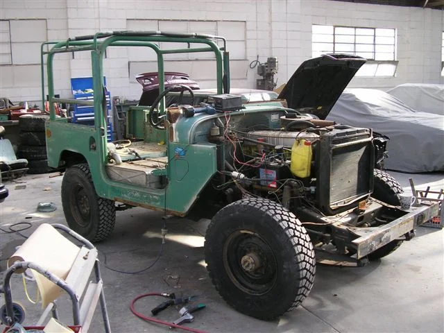

Destin I had my 65 painted at the panel shop in a full paint booth. I know and trust these guys - they had no hesitation to pull everything off including the windscreen, hinges - the lot and paint them separately. I very much left it to them to apply their expertise. In a cruiser that was reatively rust free have a look at the corner where the widscreen hinge should be in this early shot of it being stripped back.

Good point!
That settles it off it comes :D

Did you make a little mount to hold your clutch and brake masters while it was being painted?
I was thinking about using a piece of metal to bolt them too and hook it to the engine while the tub is off ( so i do not have to rebleed the brakes etc again, just redid them :)
I don't think so. We new it was going to be a long process when we started, so I'm pretty sure that anything with any fluid was drained, so the brakes will definitely be re bled. As you can see from the pics they left the tub on the chasis to paint it, and I think the motor stayed on the chasis also. All the panels were taken off and painted first.
