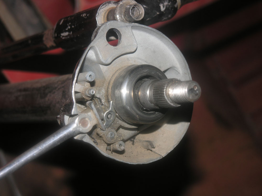

Also, how do i go about removing this the indicator column >?

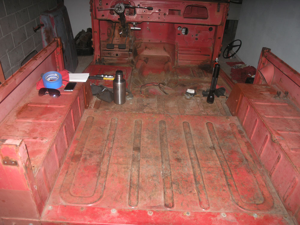

Pulled off the tailgate bits and the tire carrier today:

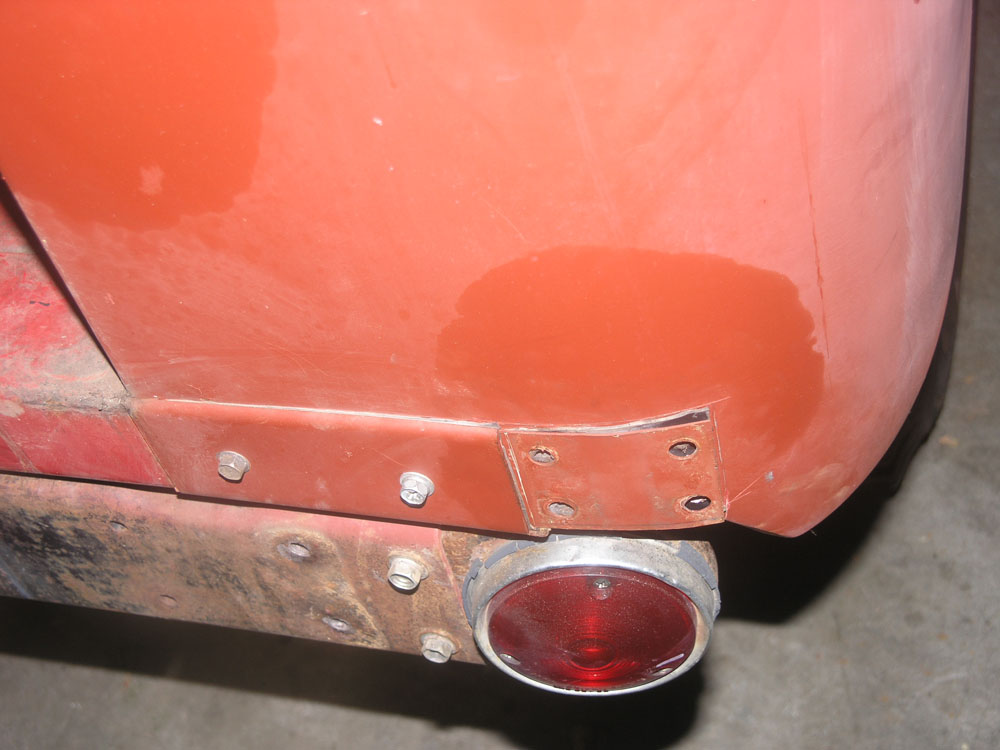

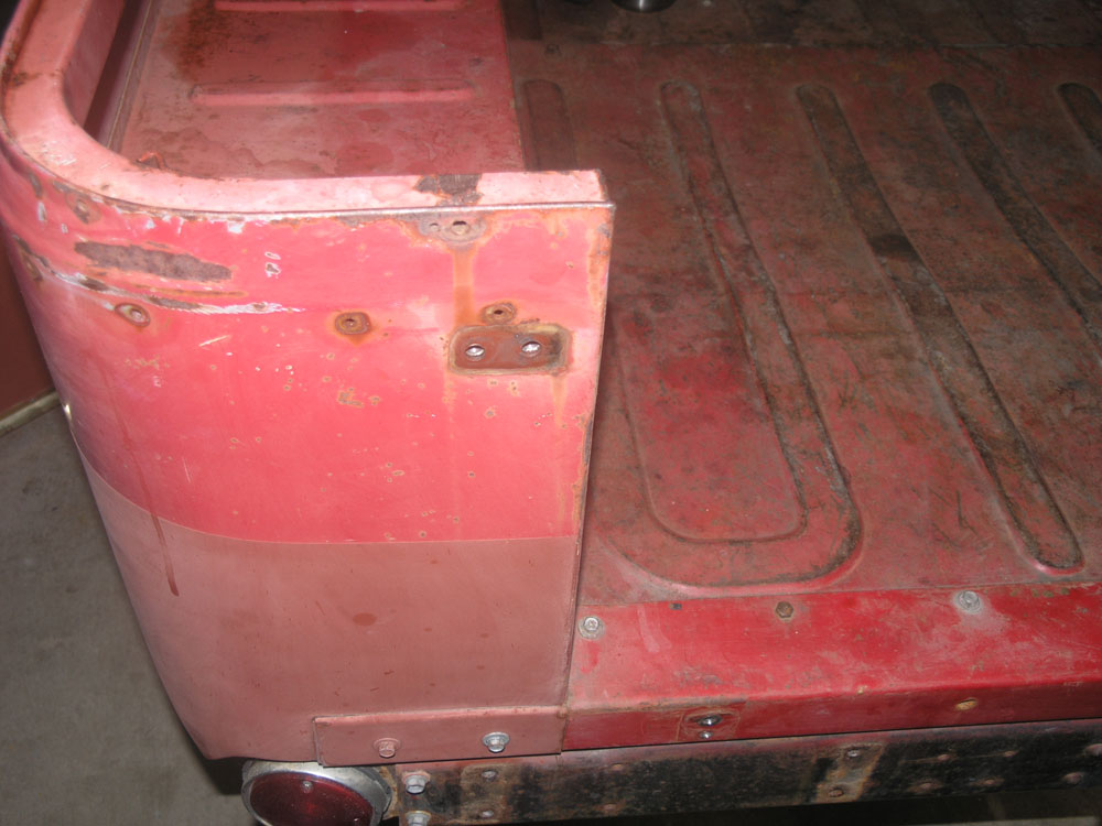

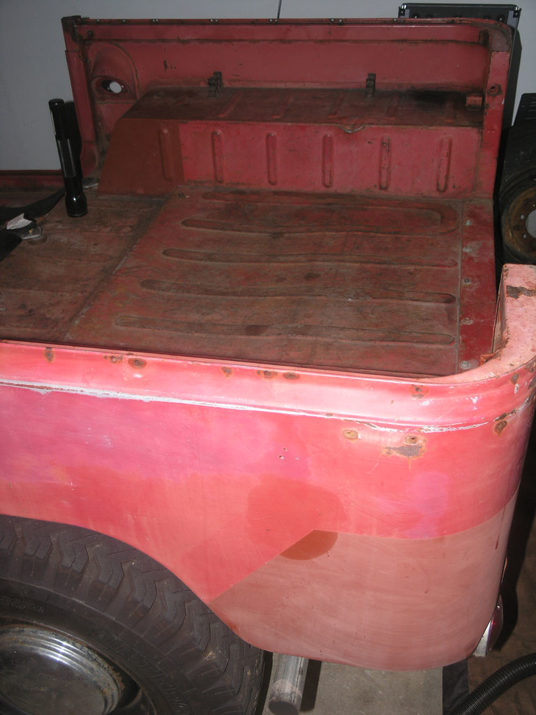

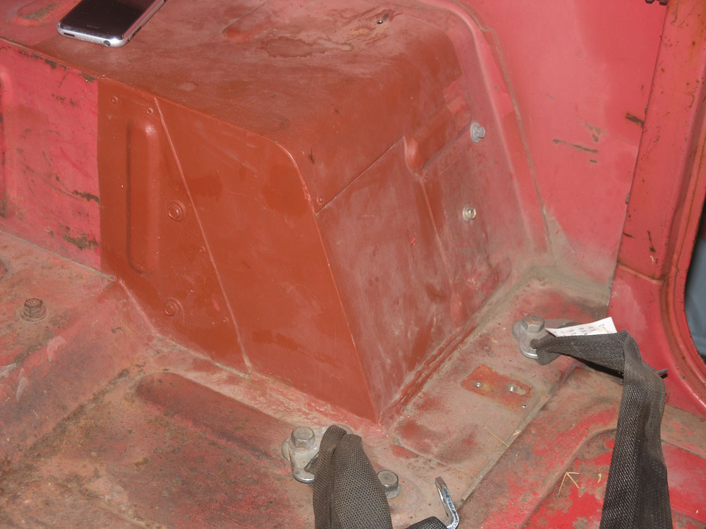

Looks like the rear sill was replaced at one time...
Wonder if i should order a replacement steel one and have the body guys pop it in before painting...
The bolts on the back seem off, and it might make sense to smooth it out.
The PO said it had some crazy beefy hunting bumper on it a long time ago, hence the bolts and reenforced bit... but who knows.
Both parts of the rear well were replaced at one time it looks like, Gonna see if the body cats can fix it up after they media blast and see what it is like

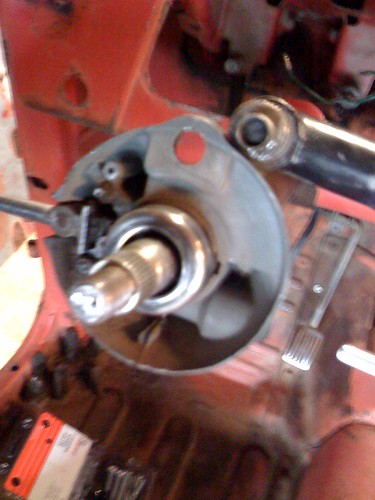

What is the trick on removing this?
Basically all i need to do now is remove pedals, kick vents, and get the windscreen hinges to come loose :D
Can't help you with getting the indicator assembly off...looking forward to an answer myself.
As for the rear sill...DO get a new one installed...would be foolish to do all of this, and skip that part. I'd also get those wheel wells looked at.
Almost there Destin :beer:
Actually hard to tell from your original picture...wait till you take the tub off, that might just be something added on that can easily be removed, and a few holes welded up :hhmm:
Destin,
Those are the cleanest looking pop riveted and bolted patches I've ever seen! :D No, seriously, they are, someone put a lot of effort into that.
That area of the wheel well is very unusual to me to be a victim of rot. Usually it's in the area of the double wall supports that it starts to go. I would not do aftermarket replacement pieces there, you can find decent used ones that you can cut to fit and weld in.
Rear channel is another story, do your homework on those before you buy. I made mine, from what Iv'e heard that's about the same as getting the replacements to work.
Turn signal switch is clamped on. you can see the slot in the bottom of the housing. There is a phillips (probably frozen) that is in the bottom, perpendicular to the shaft. Loosen the screw, open the slot a little, and it should slide over the end of the column. I believe the turn signal shaft comes with it and isn't attached at the switch. (Could be the other way around though........it's been quite a few years)
Yeah i am thinking the same thing, looked at it more last night, and it looks like a sheet of metal over the steel with a rubber seal between the metal...
Might jsut have been a weird reinforcement...
Need to undo a few body bolts from the bumper to verify.
Good eyes though man, thanks :D
