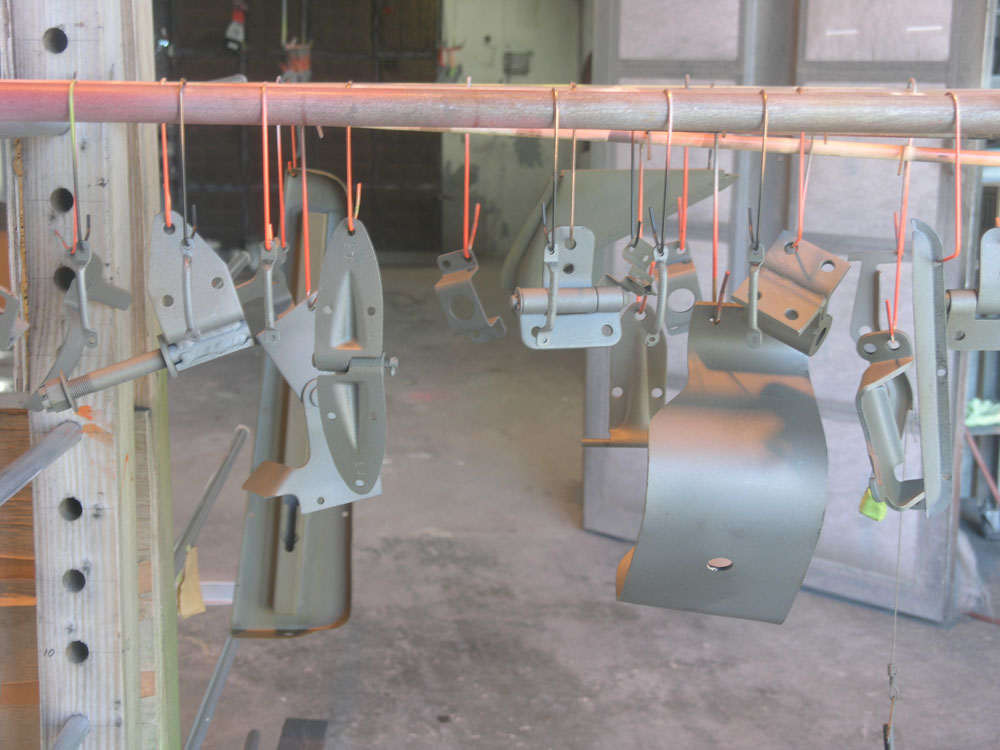

Just excited to be working with new hardware and clean/ freshly painted parts :)

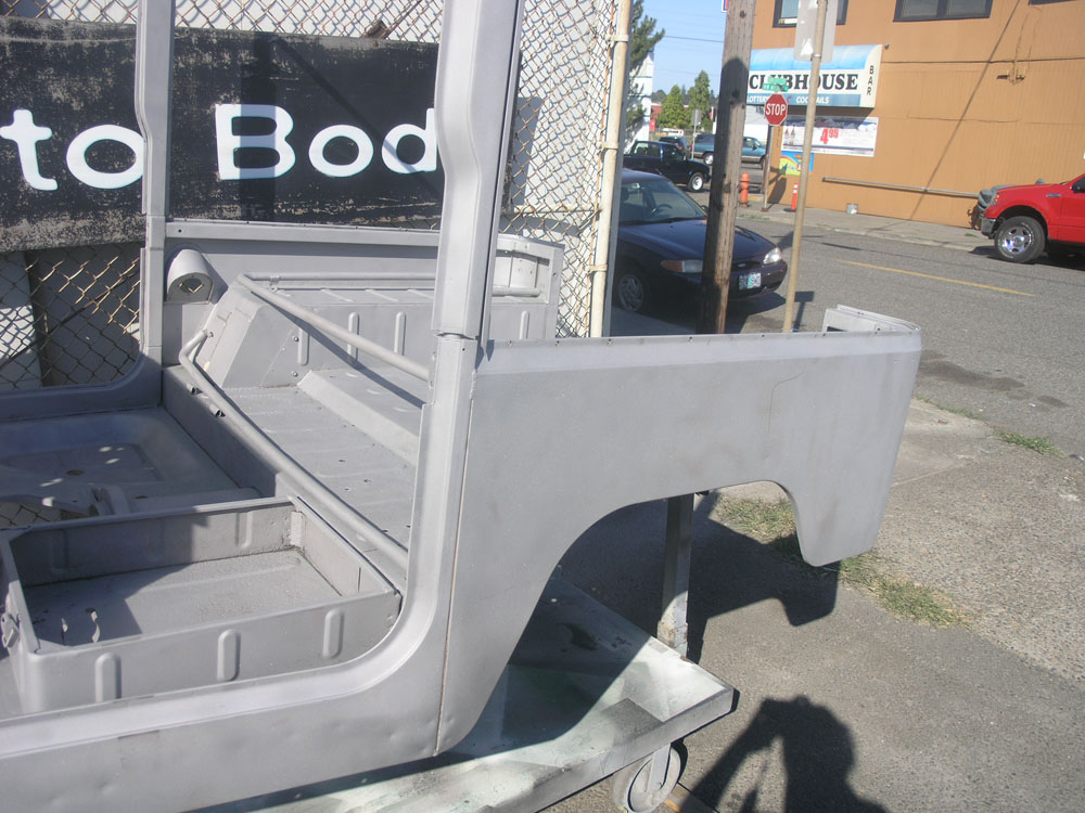

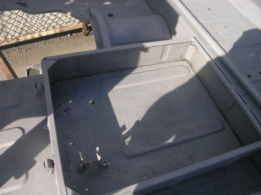

rust holes in tool box:
Maybe just patch that peice under the tool box...
Do not see any refab steel panels for 1964 years :(
Body shop said any other pits can be welded up.

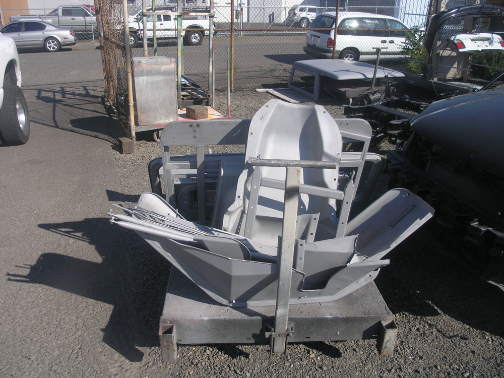

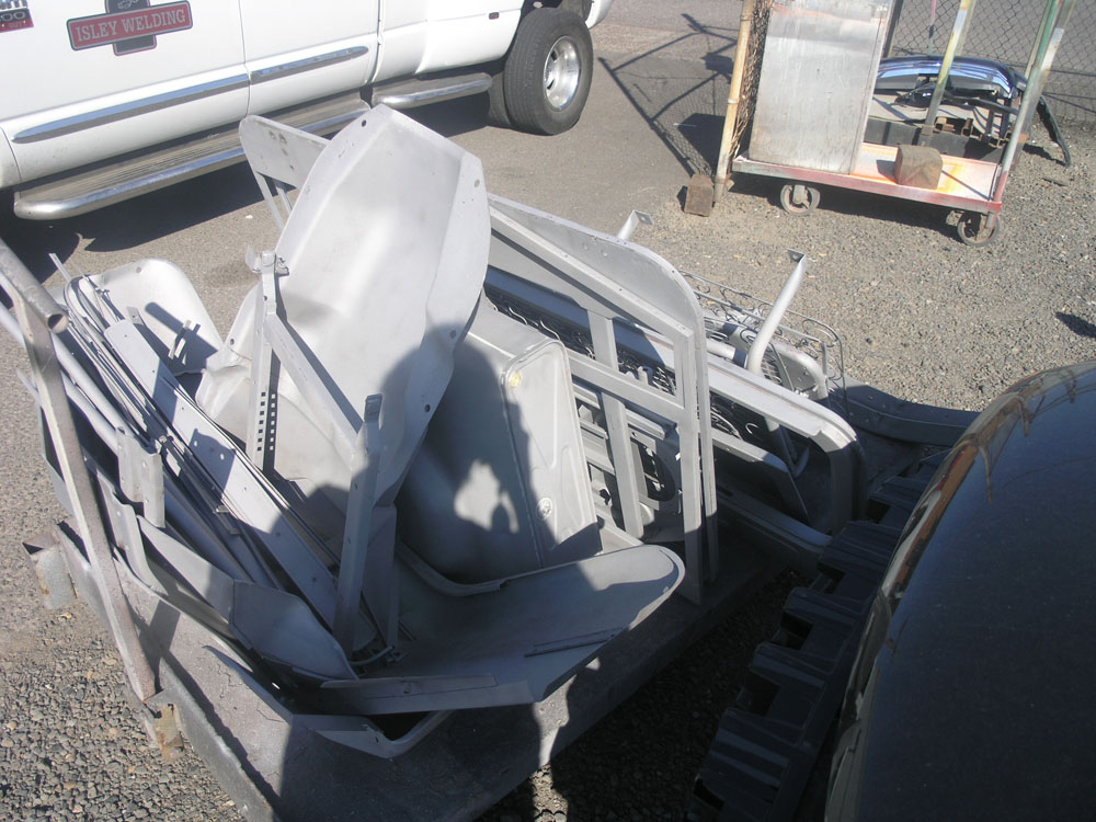

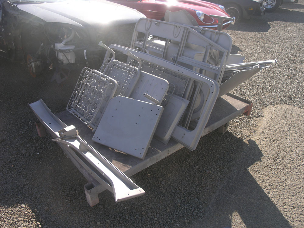

What did you pay for all that blasting? Where did you get the canvas/vinyl top? Yes, cut the metal out and weld in new. Thanks

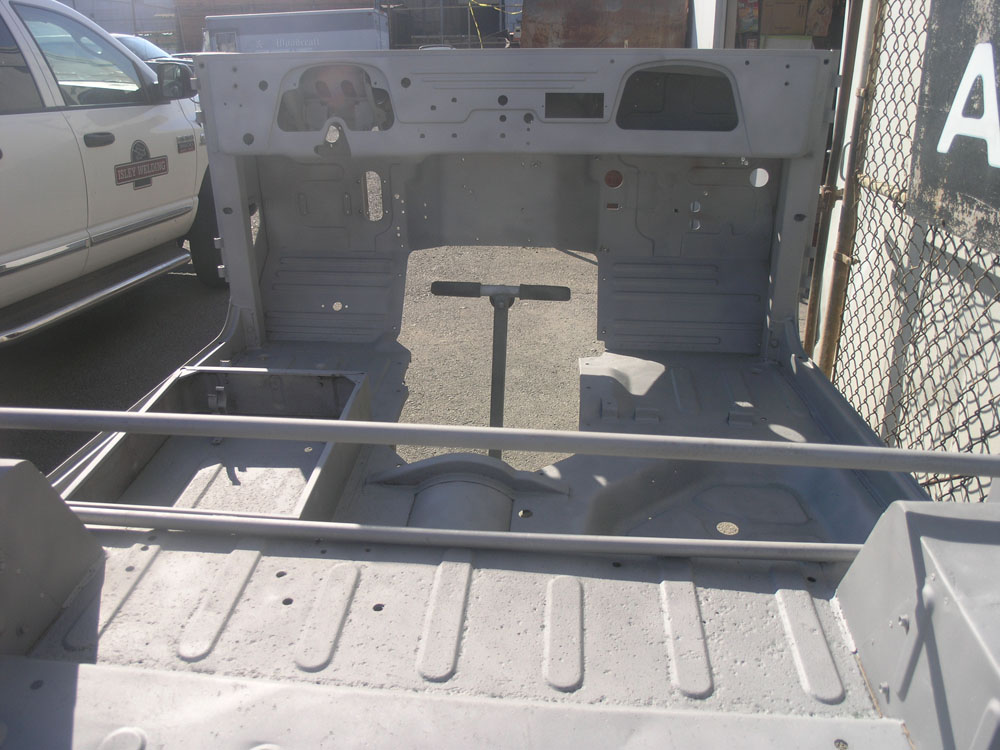

Bare metal looks pretty neat :D
Kinda bummed about the rust holes in the tool box bottom :(
Any ideas out there?
I guess cut the tool box bottom out and put a new piece of metal in>?

Yeah I thought it was a good deal considering all those bazillion small bits :D
They guy did a great job.

From the pic it looks like all the pits in the toolbox are on the flat metal, none on the ribs. If I were doing it right I would just remove it and splice in a patch, leaving the original ribs. :wrench:
An easy fix would be to refinish it, tape the holes from the bottom and do a good bedliner on the interior of the box. No one would see it there, and it would be practical. ;)
Sounds like a clever solution my friend :D
I hope you meant Jim's idea of taking the time to weld in new sheet metal...you did not come this far to start cheaping out now.
