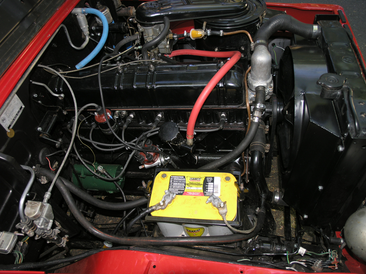

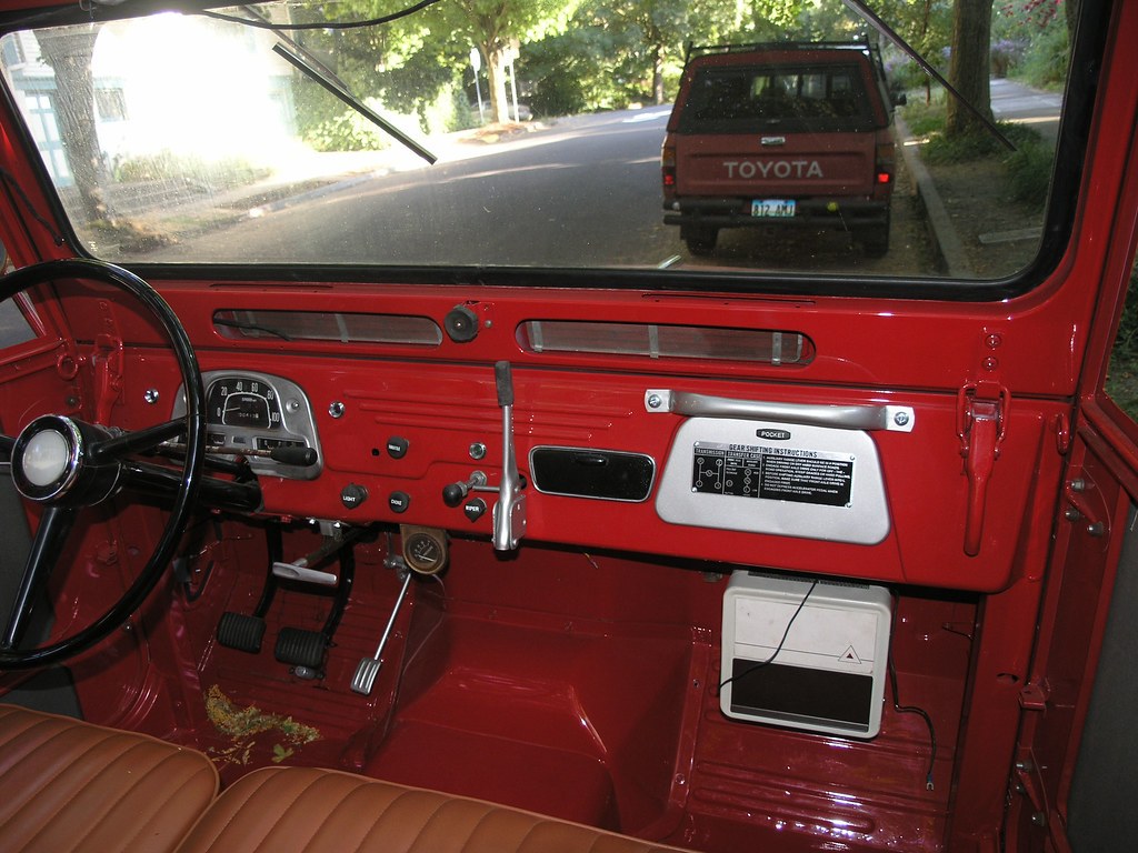

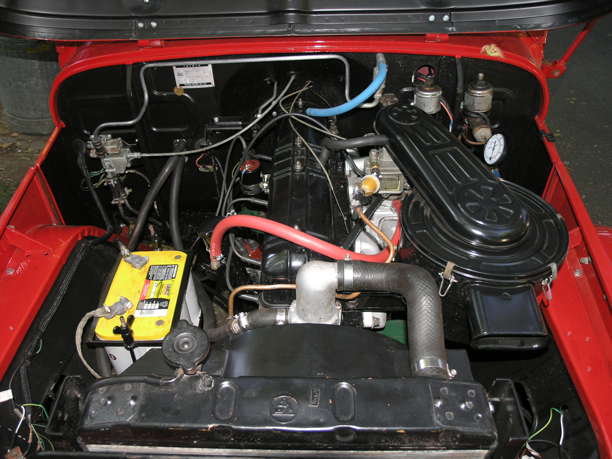

some dash shots ( I know some bits are not finished yet ;)

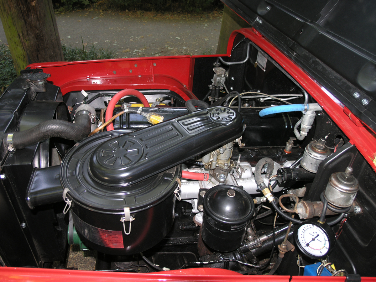

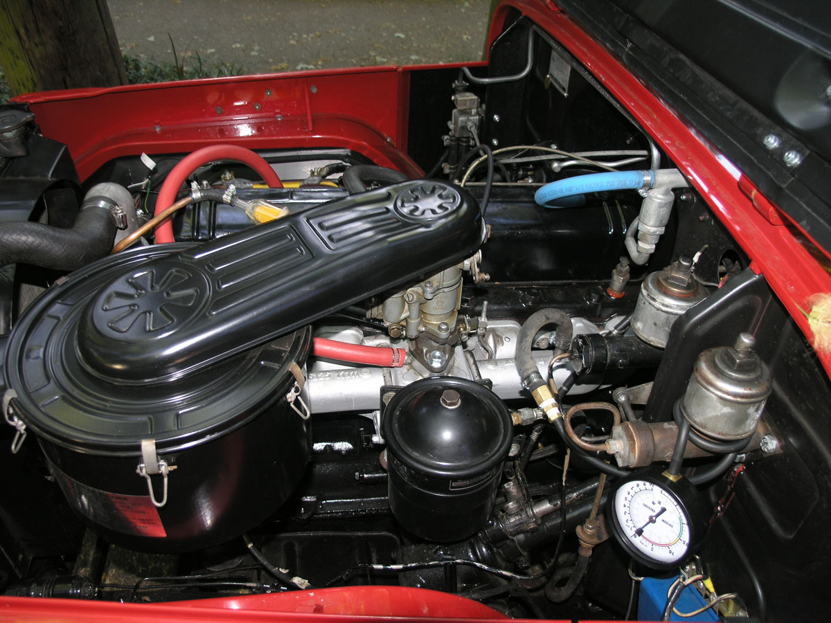

under the hood
( i know i need to clean it up, reconnect the 4wd vacuum and find some proper hoses. ) Also need to put the metal gaurd under the radiator and under the battery, i will do that when i put in the new water pump down the line :)
also notice the crappy hose plug i fashioned for the pcv that the PO drilled into the front of the throttle body below the throttle butterfly oy
clutch master is leaking abit, need to get that fixed next
