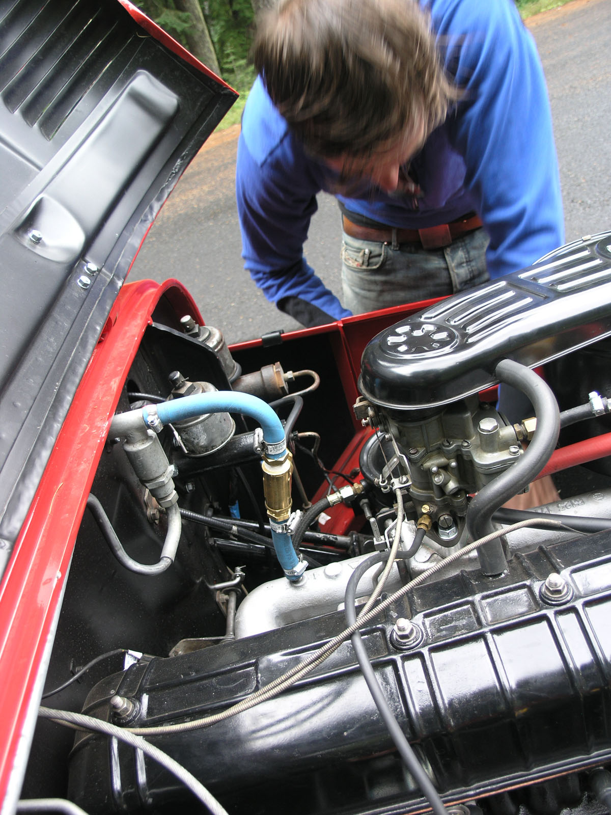

Anyone have thoughts on this?
Just want to b e sure :D
I hear some have a vacuum of 21 pounds, want o be sure i do not have a leak and will torch my exhaust valves etc :D
Hook up directly to the manifold nipple. Measure vacuum. Hook up "T" to include the vacuum shifter. Measure. Subtract.
Difference equals vacuum leak.
If you think vacuum leak is significant, track upstream by plugging off hoses at successive junctions from the "T" and see where the dropoff occurs. You could have a cracked hose/line or the valve mechanism could have an internal leak.

I have 18 pounds with the vacuum hooked directly to the nipple on the manifold.
With the "t" splitter connected to the vacuum 4wd stuff i get 19 pounds.
So I have a small vacuum leak? or did it just get better? :D
hiya Idave
Well that's better so I'd say no leak and leave it at that.

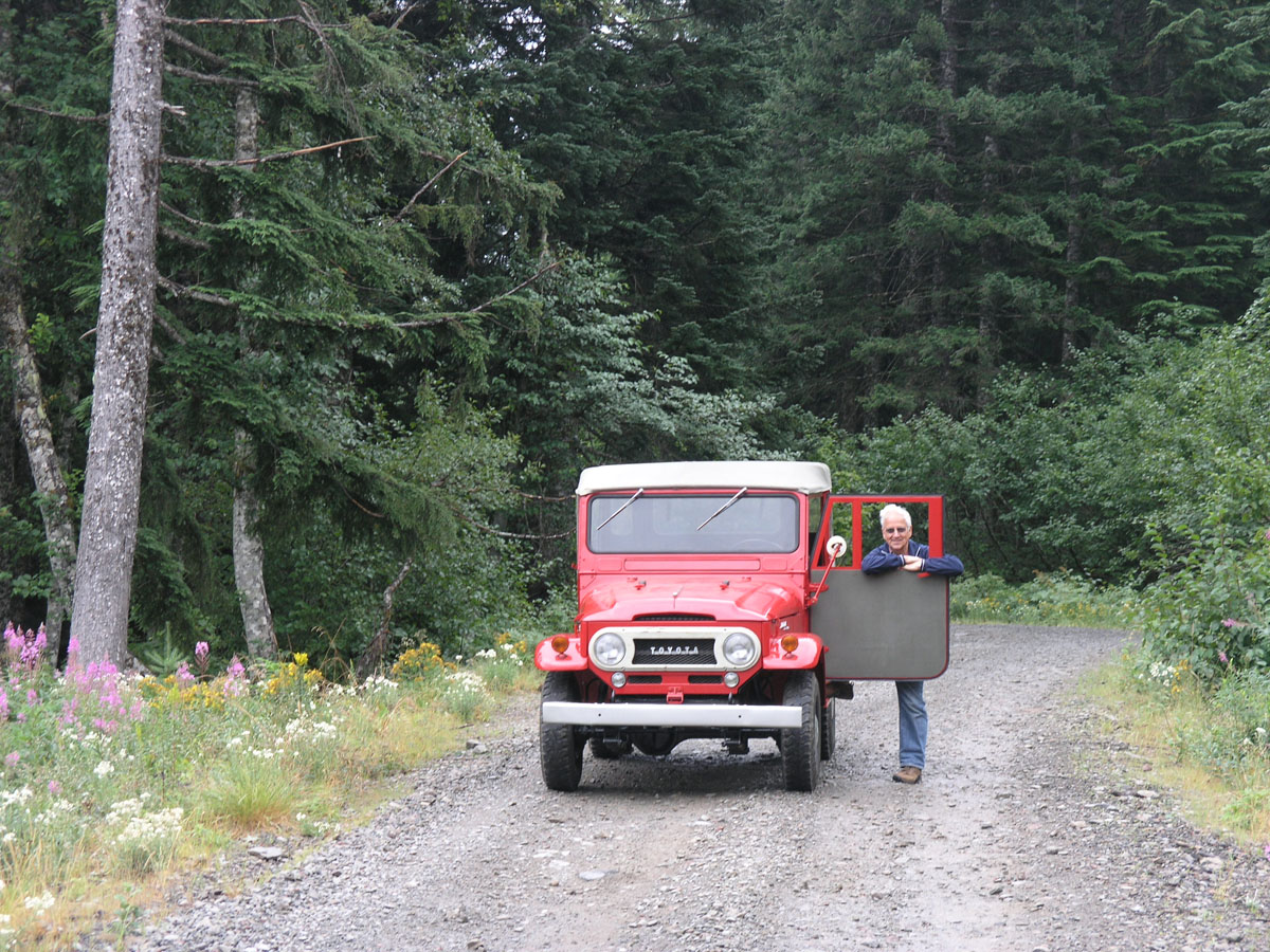

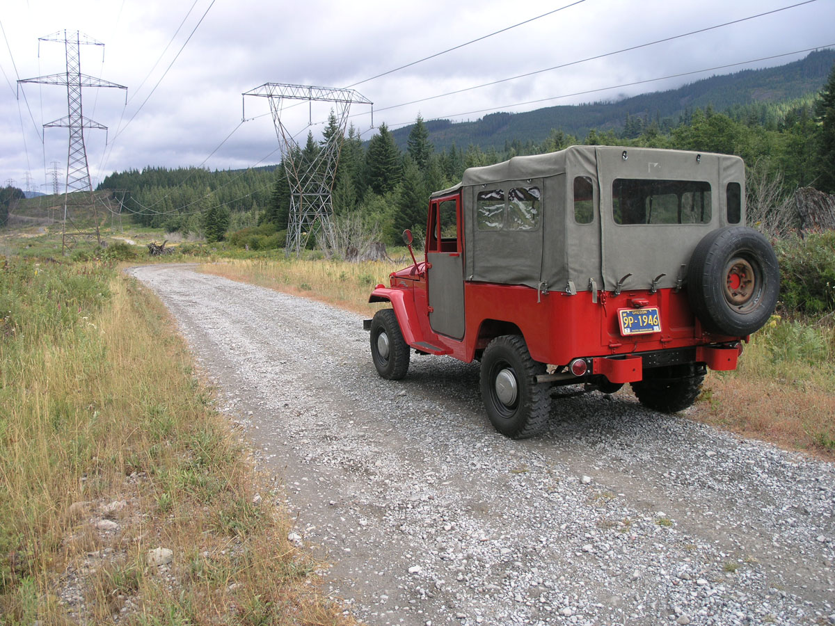

destin, awesome looking in those pictures:grinpimp:. You really did a nice job! Glad you are finally able to drive her. This has been one of my favorite build treads ever. Thanks for sharing all of the info.:steer: Brendon
thankd guys :D
I will take it out for more epic adventures with better photos later, this was jsut a quick dry run to blast in the motor and work out some bugs
I need to def do a lot of finishing details :D
Today i noticed the starter came loose haha, tightened it down and realized the ground wire to the frame was missing hehe, have to hook that up soon :)
Thing seems to have over all great power, maybe running a tad rich, but i was pushing 60 on the freeway and had more floor space to go faster ( not safe in my opinion ) Getting an alignment on wednesday as well :)
Basically need to go over every inch and check for loose bits and add the final bits with correct hardware.
All in all beast :)
