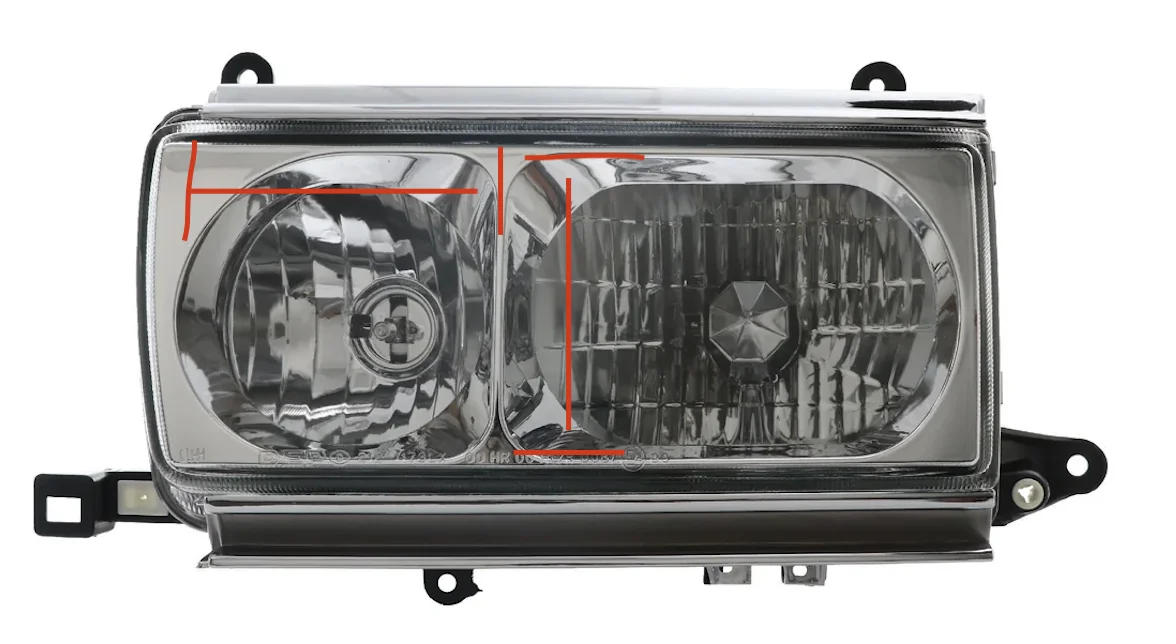

Can anyone provide the bezel dimensions listed in the photo for depo headlights?
Thanks!
Please explain exactly what you want measured. Is the leftmost line indicating the furthest-left edge of the recessed bit?
I have Depo lights but I don't know what you want.
Yes, furthest-left edge of the recessed bit. I would like the max height and width of where the bezel starts to recess for the high beam.

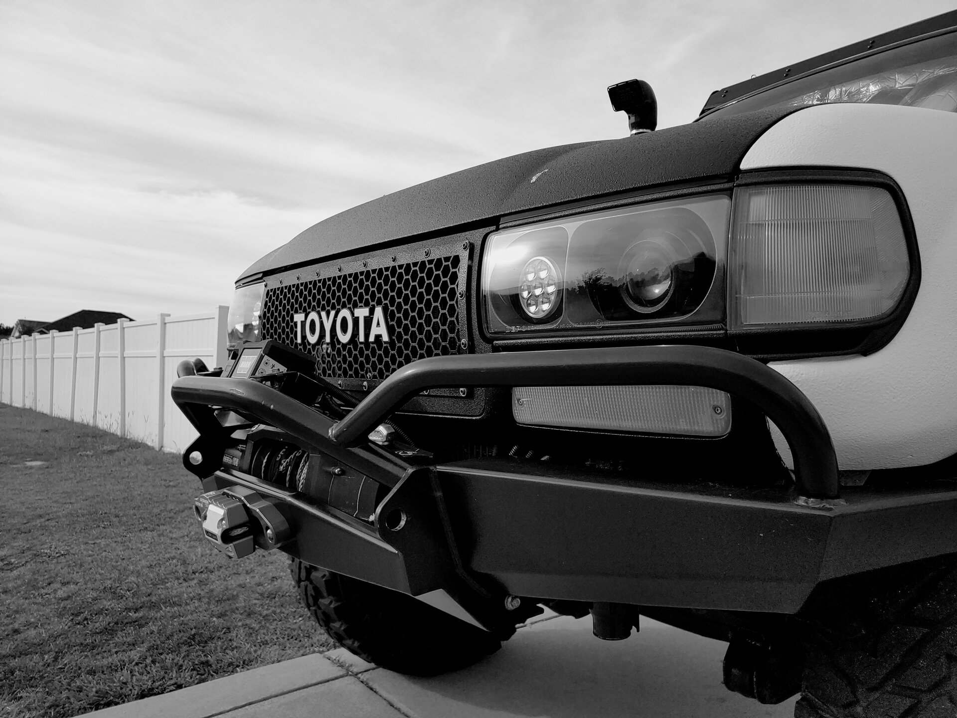

Sorry to resurrect this one (at least it's not years old!). But @White Sheep do you have a parts list on these headlights? Or are these the DEPO lights with M LED 2.0's and just painted black around the housing? It looks fantastic.
They are DEPO painted. Bi-LED: Moimoto M LED Stage III projector headlights and High Beam: Profile Headlights.
