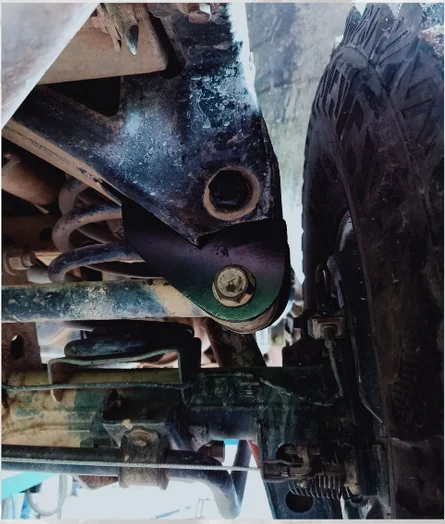

Delta Vehicle Systems Panhard Lift Bracket, 3" & 5"
Hi @FirtsToy
can you indicate which PHB has chosen for your Slee 4 "Lift ?
Tks
He must be running a 3” bracket. The 5” bracket is only for lifts of 5.5” or more.
I'm running the 3" bracket with Slee 4" springs.

I have a OEM panhard with weld in adjuster from Slee
This helped to fine tune so I don't get rubbing.
With the delta bracket, stock panhard is close to centering the rear axle.
*the delta bracket i have is the 3"
Just installed this today - huge difference in road manners on my rig.
Difference in bolt heights on the Panhard rod to ground at the start was 4" ish.
I'm running an OME 2.5" heavy setup, though the rear is lightly loaded with just a 4x4 labs bumper.
I think I need to invest in some front radius arms next.

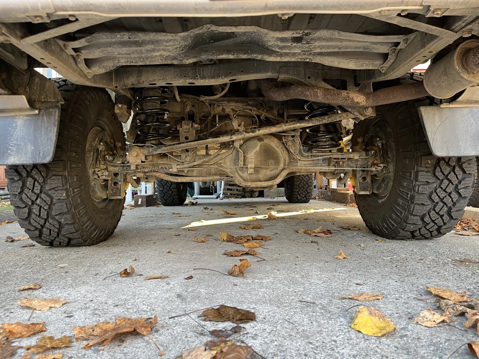

Is there any advantage of the Delta bracket that goes onto the axle itself vs brackets that are bolted to the frame? Like the one from ebay:
It won't hit the frame or interfere with the HD springs, doesn't add weight to the axle, less expensive and levels the panhard rod too. Someone mentioned the body roll but is it something real or just a theoretical disadvantage?
You’d be better off with no correction than just dropping the frame side. An angled extended panhard has a better roll center, even.
That bracket could be useful for tuning the panhard angle once the axle side has been raised - if the bar is still fairly diagonal, but you wouldn’t want to use it by itself.

sounds like the tall Delta bracket would be perfect for you ( - and then if you need additional adjustment, the part you referenced might get you to 100% horizontal, possibly)
( - also, thanks for measuring your actual height difference! you'd be surprised how many people don't)
Yes, I think that the 5" DVS brackets is what I need. I do have 2" bump stop extensions in place already.
There is a 1 or 1.5 inch spacer in the back that I'm going to remove. Just the OME J springs are more than enough for the 35" tires I plan to put on it.
The front with the J springs and 1" spacers is 1.5 inches lower than the back in my case. I had to be more careful planning the lift.
