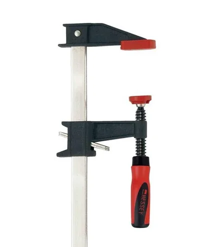

Having installed mine, when I was doing the install of the bracket, on the step that you re-install the 4link, mine was kind of springing towards the top of the vehicle, and this made it feel like I needed 4 hands to get things together.
A tip:
Hustle the 4link on to the bracket.
Then you can use a clamp like this (12" size) to adjust it into position while using an alignment bar for the bracket.
Then run a brass punch into the hole to keep position
Then use the alignment bar, and bolt to force the brass punch out, and you are done!

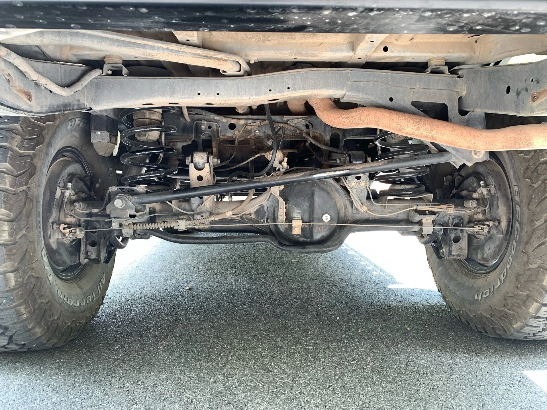

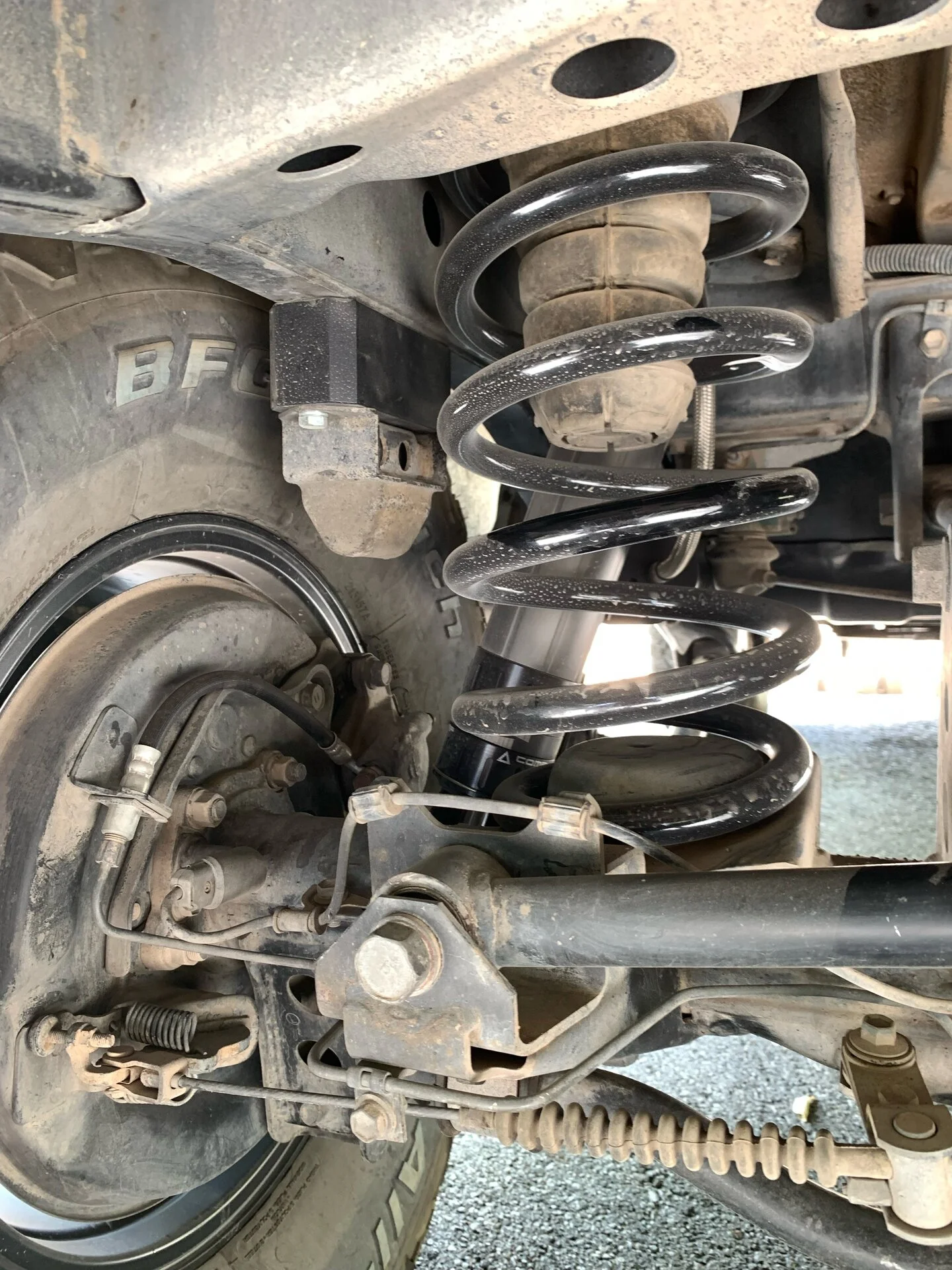

Hi y’all, I reached out via email to Delta and LCP but haven’t heard back yet. Maybe I can get some help here.
I measured from ground to axle bolt (18 inches), and ground to frame bolt (23.5 inches) to find a difference of 5.5 inches. The truck is not loaded up but is equipped with long bp-51s, ome 2864 rear springs, slee swing out, skid, sliders, arb bumper and a winch. Tires are 315s, and has slee 2 inch bump stop extensions installed. The suspension has roughly 700 miles on it so it may settle a but more.
considering all this, Would it be better to go with the 3 or 5 inch variant? Photos below.
Thanks!

My bet would be on the 3 inch. Going from memory, the 5 inch isn't for most and is ment for the really tall springs.

Hi,
Does this angle seem ok on a 3" Dobinson lift?
It may be slightly more since the springs are new and have settled yet.
The rear axle is shifted to the passenger side.

It's certainly better than no bracket. Letting the springs settle over about 500 miles is a great idea before getting too worried about anything. If you want to revisit at that point, you would just need to measure between the top of the bracket/bushing retainer on axle side and the chassis cross member above it, as well as how much up travel you have between tire and wheelwell and the bumpstops and their lands. Then you can decide if you want to use a bigger bracket (if it's needed).
