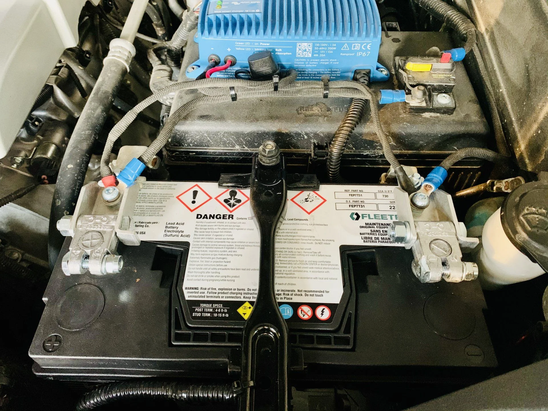

@raincityrider I was able to get the Fleetrite version of the Deka battery I was after and install yesterday. I also found the Slee extensions to be uncomfortably short and didn't like the way I had to stretch everything to its limit to make it work so I flipped the extension only (not the post connection) upside down which gained at least 3/4" and it all sits really comfortably now. Prior to that the pos cable was pulling the extension down at an angle into the top of the battery but once flipped it brings the connection point down lower where the cable wants to be.
You might try the same if you are feeling like that extension isn't comfortably long enough for those center post locations. I still mounted the battery cables to the same location on the extension it just screws in from below now instead of from the top.

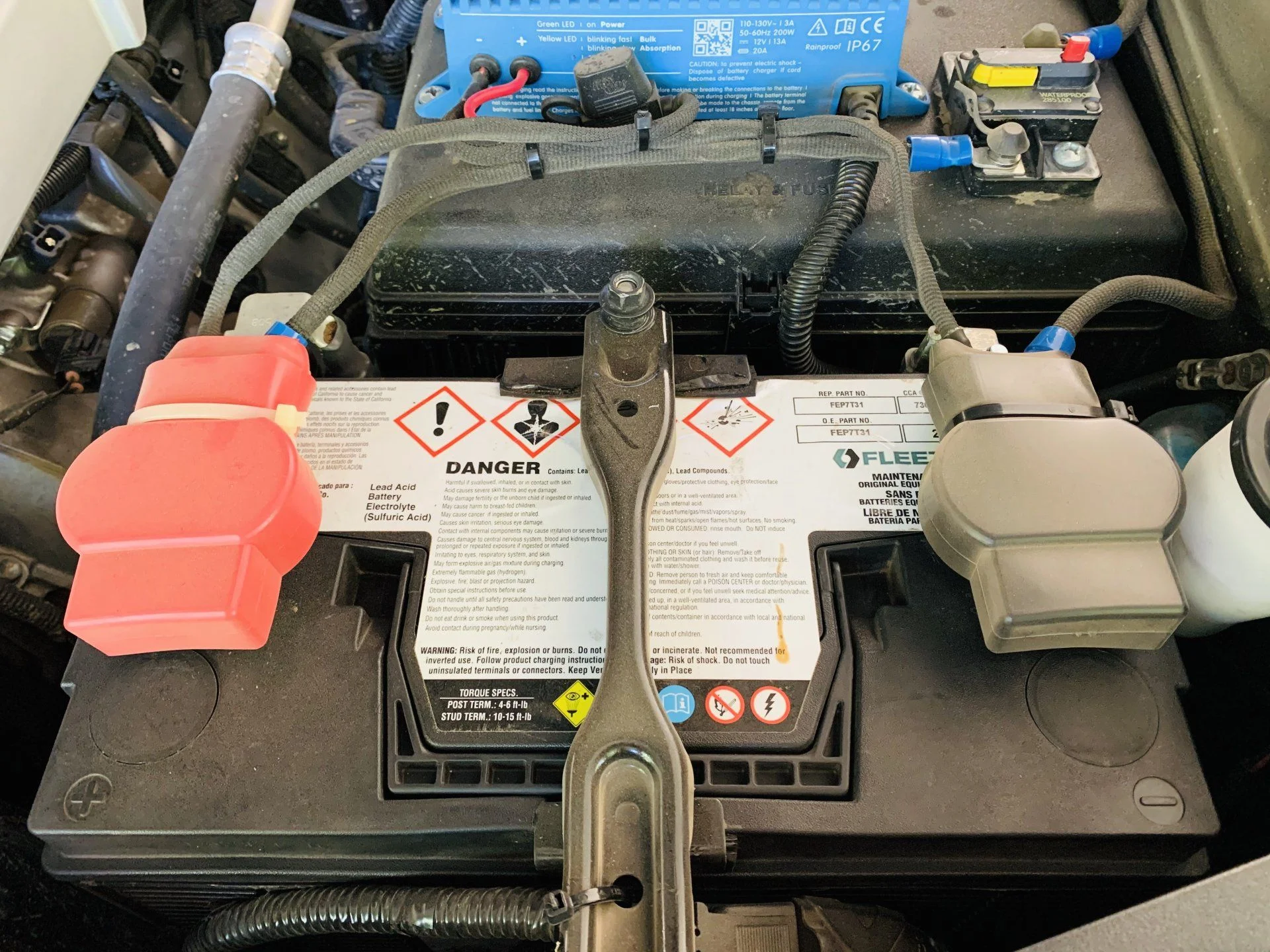

Got back last night from 9 days in NM doing that part of the Enchanted Rockies Trail. The dual-purpose Fleetrite rebranded Deka 7T31 worked like a champ and easily kept the dual-zone 75 liter Dometic at 0 and 36 for over 12 hours with no problem. So far I don't see dual batteries as necessary for my needs, the fridge is by far the most critical of my electrical draws. Shout out to @fireball who first suggested a single battery solution to me back when I first got the truck.
I made my own tray and re-curved the OEM top retaining bar with a torch and vice. If you look closely you can see I flipped the Slee extension part but not the mil-spec post connector to make the connection more comfortable. I wish the Slee extensions were longer but this hack works well and I'm pleased.

Very neat, what piece of Victron kit are you using in the photos, thoughts?
That is a Blue Smart IP67 Charger Waterproof - Victron Energy and it works great. I have it wired to a NOCO shore power plug in the front bumper (check my build thread for pics). I really like that I can plug the truck in if I'm visiting friends for days at a time and don't want to deal with moving the solar panel around to keep the fridge going. Also great back up if you get stuck in cloudy weather all you have to do is find an outlet and you can stay parked indefinitely. It was also really pretty cheap for the convenience it brings me, great mod.

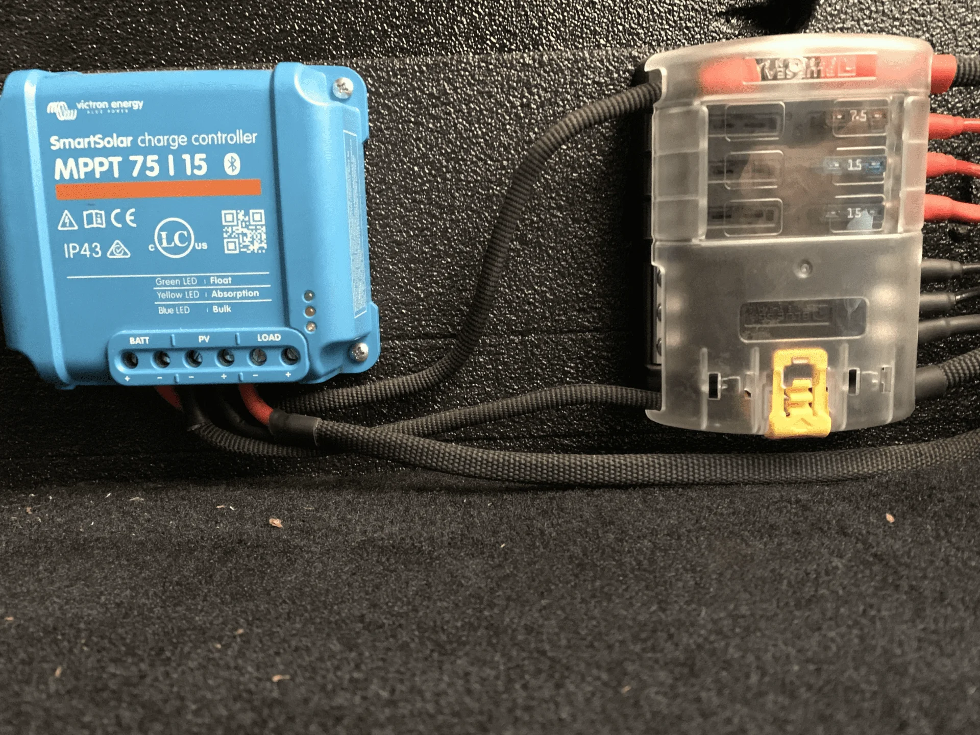

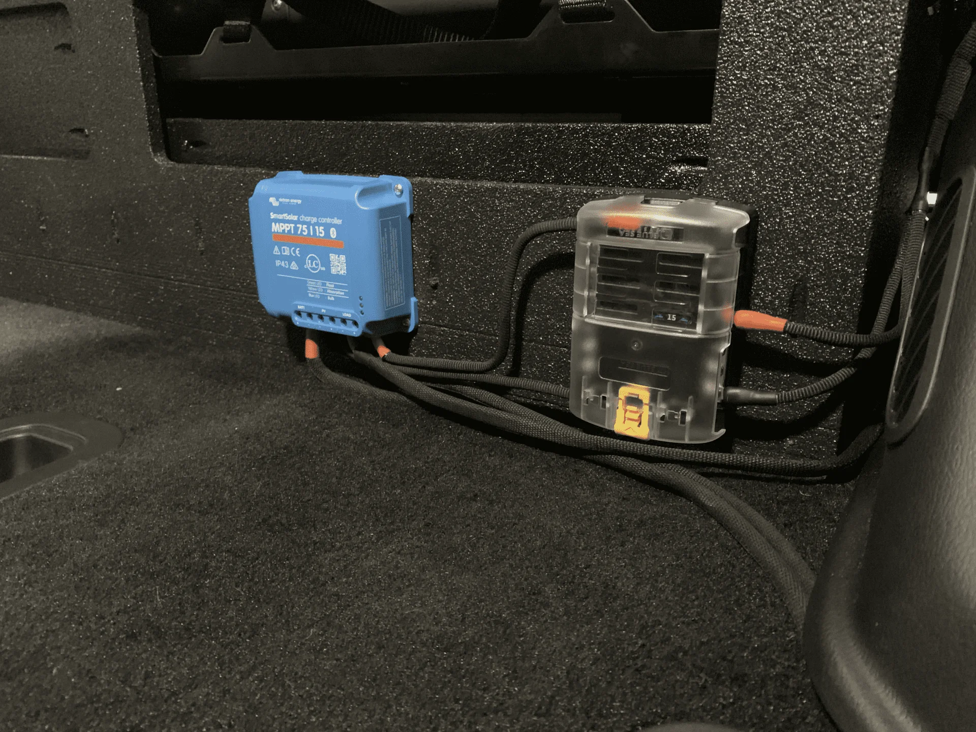

First, you should know I'm no expert on this stuff and probably started from a similar place as you are when I put my system together so I would encourage others who might see this to lend their observations if they disagree with any of my explanations below.
So I think you have it laid out pretty accurately. Have a look at these two photos - the first one is how I wired it initially and utilized the load feature on the solar controller, basically the batt to SC then to Blue Sea fuse box to the loads distributed from the fuse box. This was great because I could really see what my usage was from all my added devices, the problem was it only worked for a month or so and then nothing. I troubleshot everything I could think of and decided (after reading that others had had trouble with this set up) to wire it as you see in the second picture. Now I cannot track my load usage over time using the Victron app but it has worked flawlessly otherwise. You can see the batt feed goes to the input power lugs on the fuse box and the solar controller is hard wired to those same lugs. In both these set ups the solar charges the battery when deployed and both accomplish the same ends but the way I had it wired initially and the way you describe it in your question gives you information on how much power you are using because all power is routed through the solar controller first. I wish I could say that setup was reliable but in my case and others, it didn't prove to be.
TLDR; the way I've wired it in the second photo while less informative allows for the same result power-wise and works great.
I might go the Redarc DCDC charger route were I to do it a second time, because you get all you see in my system + in one package. When I did this I also wanted to learn a little about how all this works and save a few bucks at the same time. I'm glad I did because I learned a good deal from the exercise but I see the value of the single engineered solution and don't think it's a high premium to pay. I do miss the geek factor of looking at historical power usage and presumably, that would work flawlessly with the Redarc. I would have to do some more reading up on it but these are my impressions.
Best of luck on the build👍
