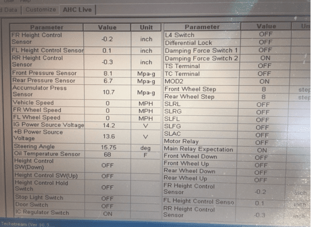

I connected techstream to check the front and rear pressure this morning. I'm fairly certain the rear springs have never been replaced by the previous owner. This is for a 2005 with 62k miles. The AHC fluid was flushed about 8 or 9k miles ago and I'm seeing about 11 graduations between L and H. Based on these figures, should I adjust the front torsion bars and call it a day? Or should I consider replacing the rear springs too?

Thanks @PADDO , with the temp sensor disconnected I show 6.7 for the front and 6.0 for the rear with new Toyota AHC springs and a Slee 30mm spacer, thanks! When I get more funds i'll replace the globes, i'm at 5 grads even after a flush and adjusting the tb's and the new rear springs and spacer.
