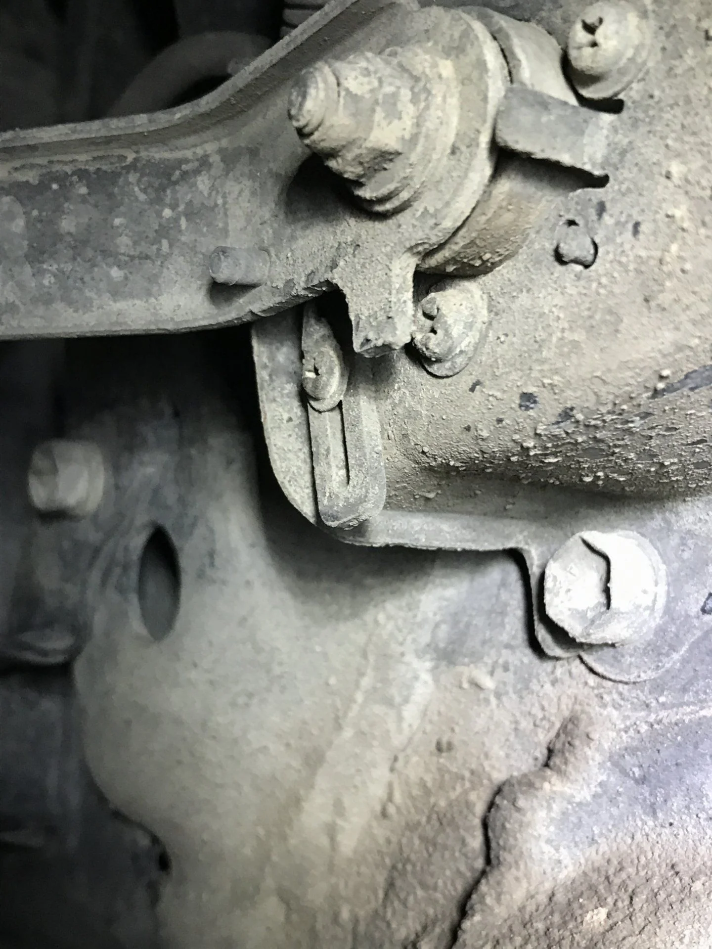

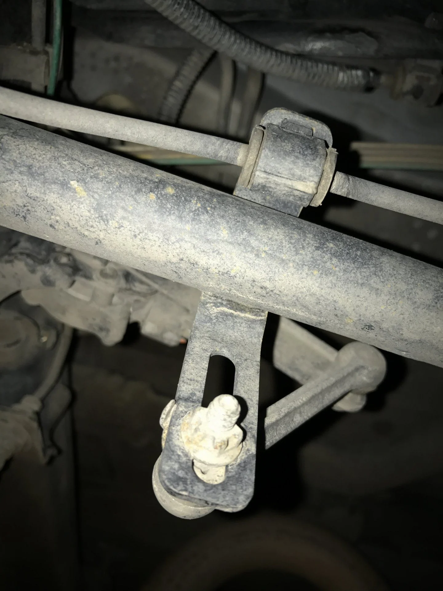

So I am happy that my heights are adjusted, and pressures are now w/in spec for F & R, but still want to know about adjusting the height sensors. For the rear, it looks like only one adjustment at the slider. For the front, it looks there are 3 different opportunities to adjust - the big slider, the threaded portion (is that a locknut that is loose?) and the little slider by the actual sensor. I would love to 0 these puppies out, but would like to know what I am doing...

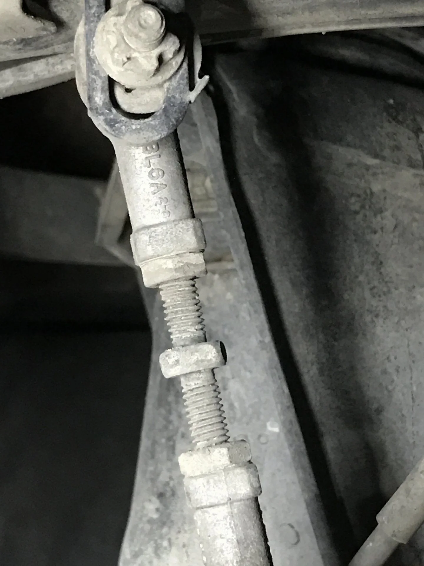

Its pretty straight forward my man: you can adjust the fronts using the adjustment slot or the threaded link. The threaded portion is opposing threads on either side, so you can loosen both lock nuts and adjust on the vehicle. I use the slot to make my large adjustments, and the threaded portion for fine tuning. The rear is only adjusted using the slot.
Shorten the linkage in the front to raise it, lengthen to lower.
You got most of your answers. What you call "the little slider by the sensor" i guess is the shipping support for the sensor arm. Supposed to be removed when installed, or just broken like here.

Ah, probably not a loose lock nut, but how you adjust the threaded rod portion...

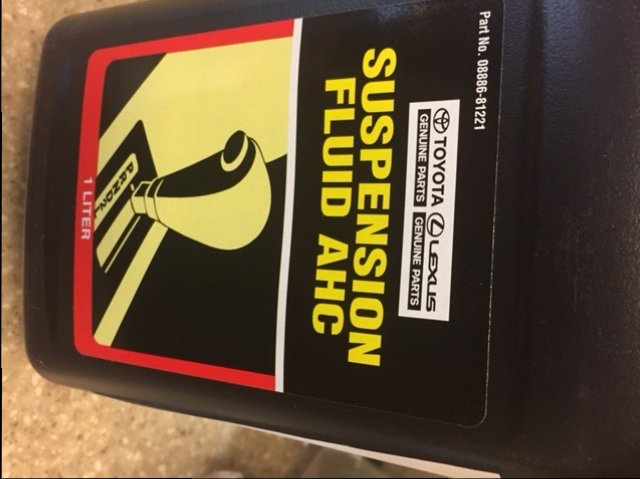

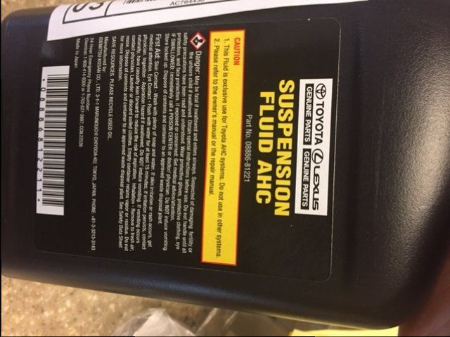

I went to a Toyota dealer to buy AHC fluid to flush out the system. According to the parts guy, the 2.5 L metal can ahc fluid (08886-01805) has been replaced with a one-liter plastic bottle version (08886-81221). The last thing I want to do is put in the wrong stuff. Any experience with the plastic bottle version?
Never saw the plastic bottle version, but after a beer or three, I would use that stuff as an ATF, according to the picture. Bad t0yota.
There is some indication on guugle that the part# corresponds to the right stuff tho'
View attachment 1435142 View attachment 1435143
What was the 1L price?
