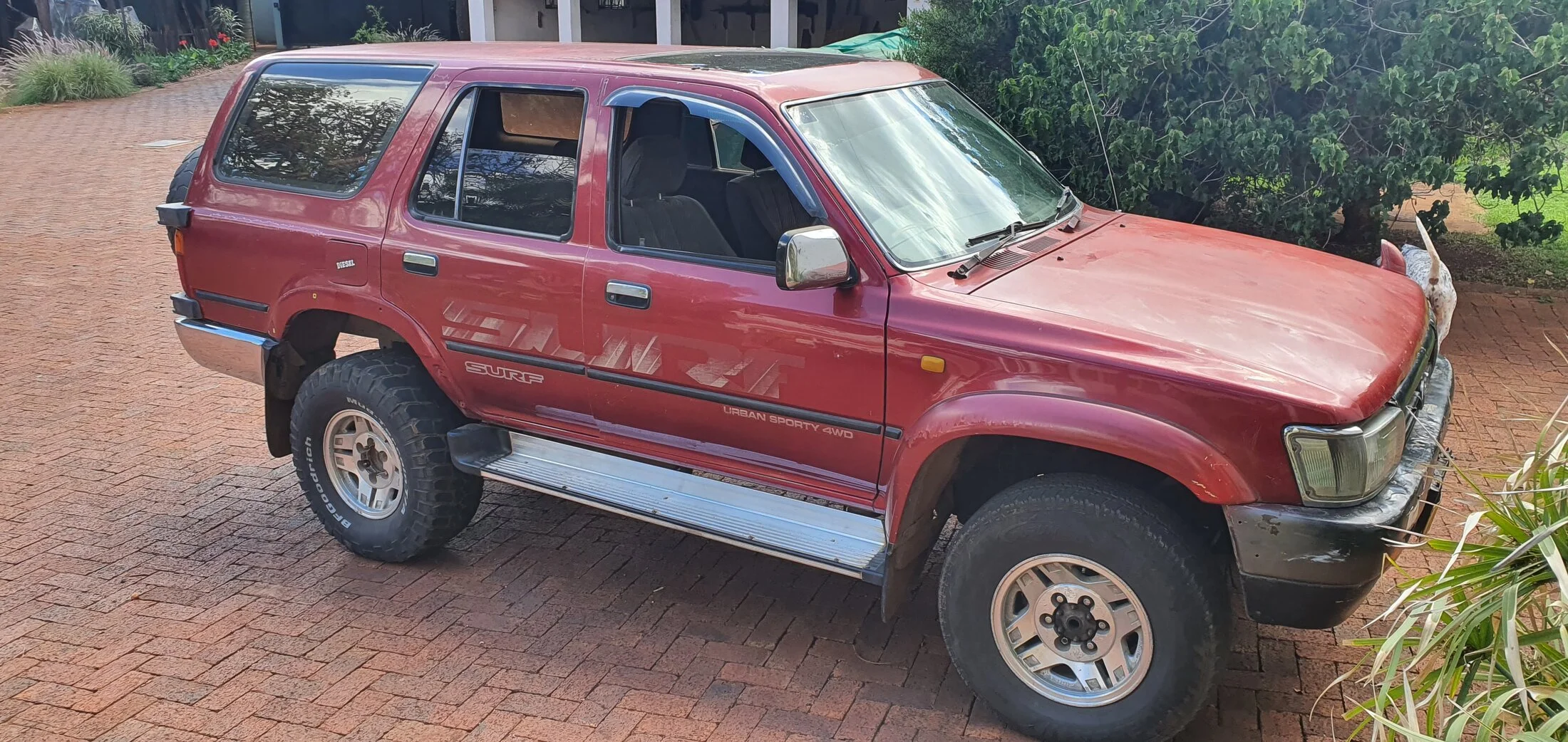

Not long afterwards I came into possession of a 2nd gen Hilux Surf (4runner to my friends in the Americas). It was in pretty poor shape to be honest, but the frame was good and so was the running gear and suspension.
Cue the next diabolical thought.... 'the Lexus body looks like it would just about fit pretty well on the surf chassis....'

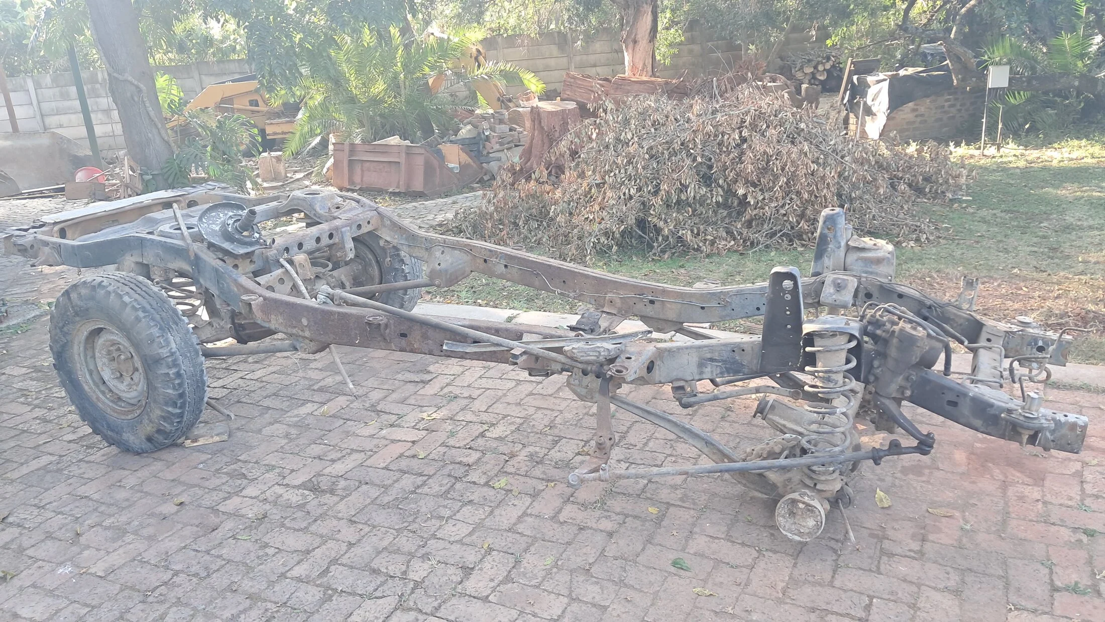

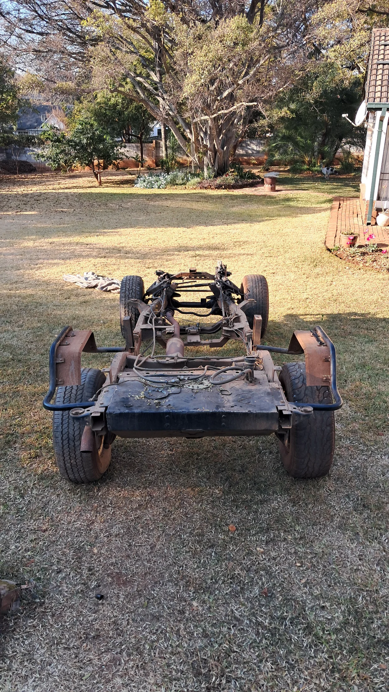

The 80 chassis he had was already with me, sitting just outside my workshop, mocking me for the better part of a year. Then he finally delivered the body and engine to me.

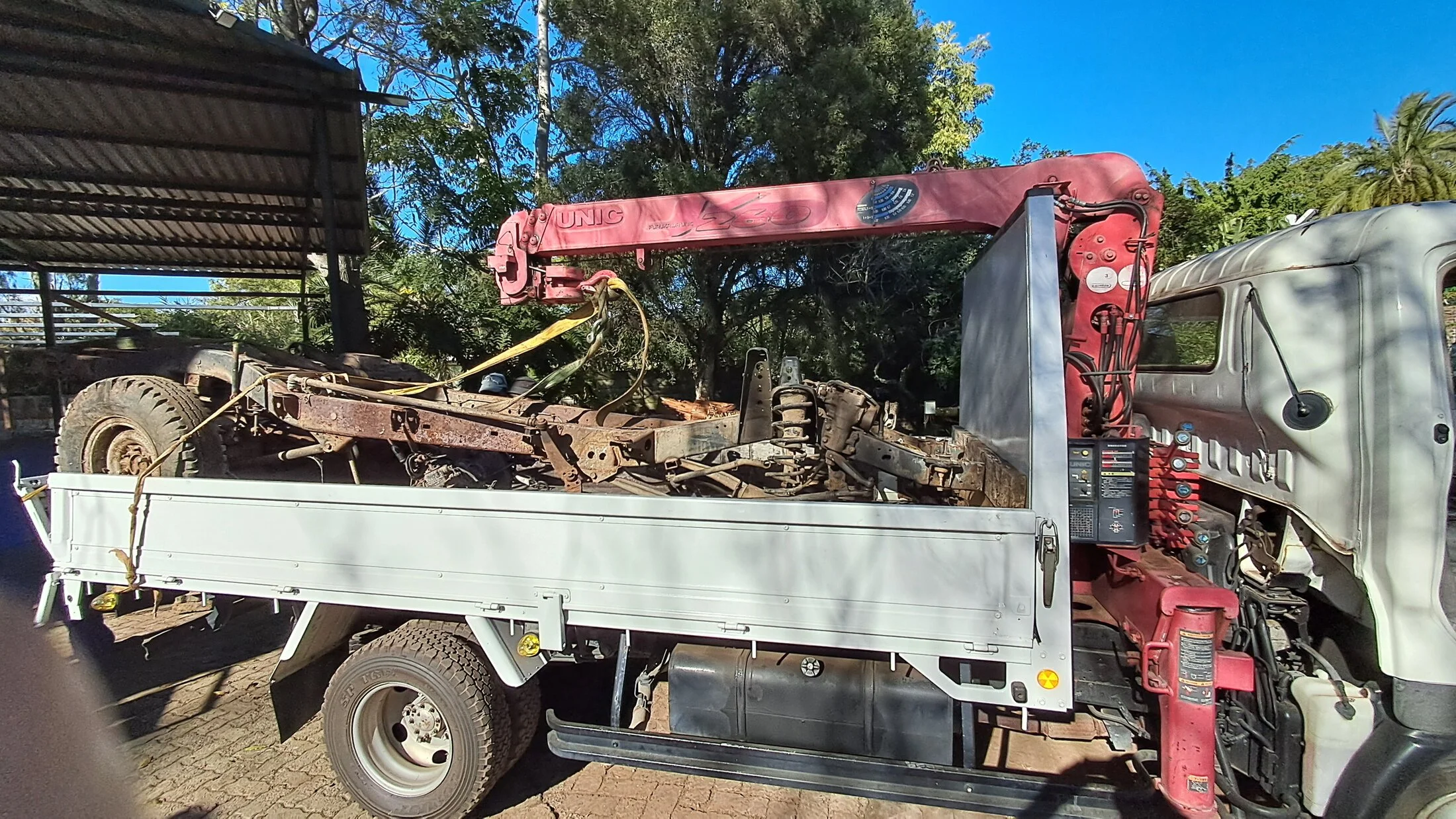

Whilst all this is going on, another friend asks if I can help him out with some engine mounts for his 45. Hes dropping a 2H and H55 in and can't find genuine mounts anywhere, so I said I would fab some up for him.
And it was while walking around this friends workshop, (his father is into earth moving) that i found an old 80 series chassis, with 1hz and h150, half buried in the ground round back.

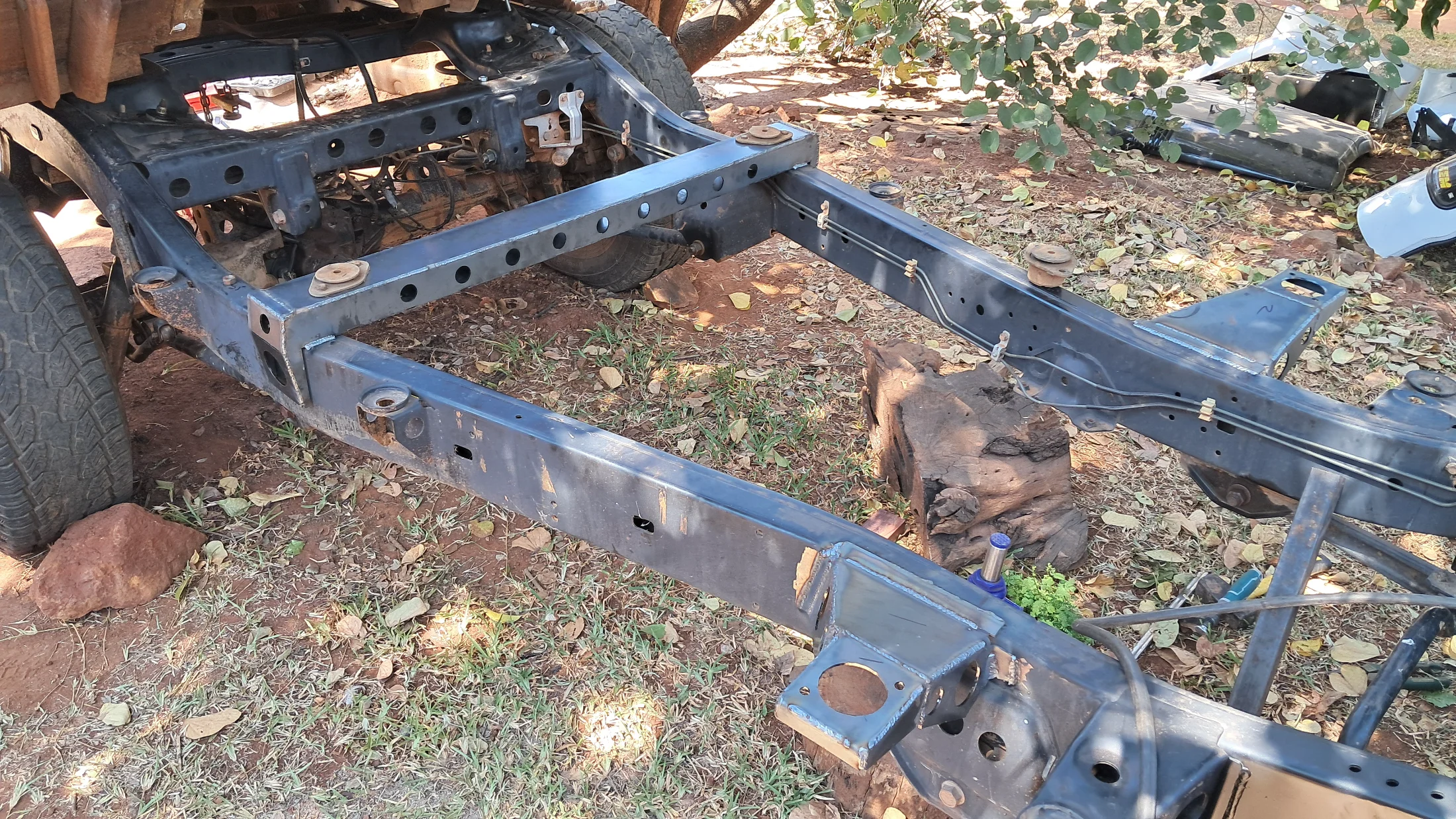

A friendly conversation and a bit of concerted digging later, I have the chassis engine and gearbox, and he has me finishing out his build for him.
A truck borrowed from another friend and a days worth of work and it's all home.

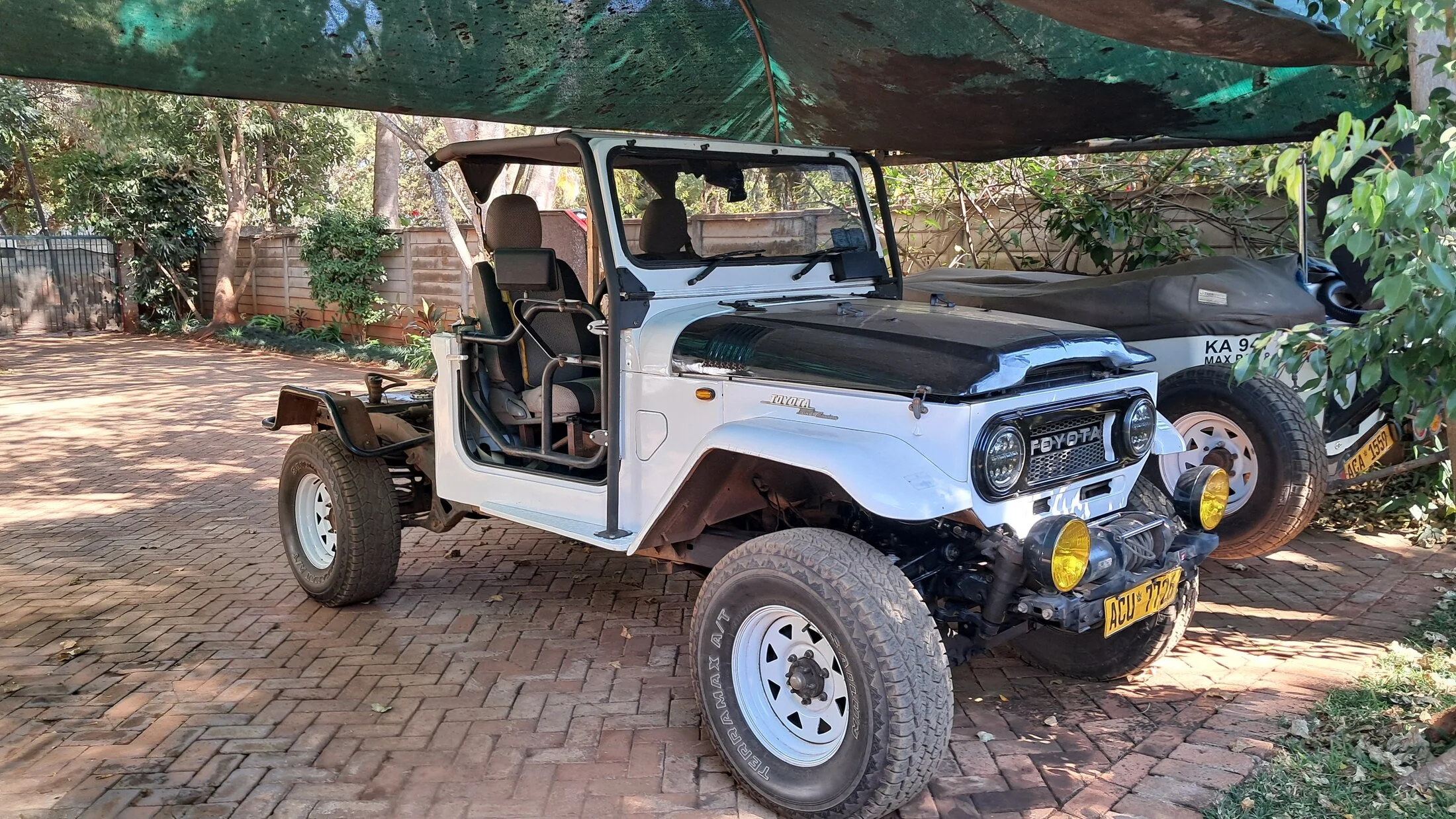

So now I have 2x 80 chassis in my yard, 1 shorty 40 body and my head starts turning... again.
I ask my first friend with the shorty, "you still have the 40 series chassis and axles, right?"
"Yes, why?"
"Because i think I figured out how to give it 80 series suspension and keep it looking stock"
So here's the plan. We are going to cut all the 80 series suspension parts, the coil hats, the radius arms, etc, out of my rusted chassis, graft them into his 40 chassis and axles. Then I will take his 80 series chassis, and build out my 45 onto that.
So now, my mate is happy that he is getting a stock looking 40 with modern suspension. My other friend is happy that I'm helping out to rebuild his 45 and all it cost him was an old chassis he never had plans for, and I'm happy because I now can finally get a lamdcruiser chassis back under my 45.

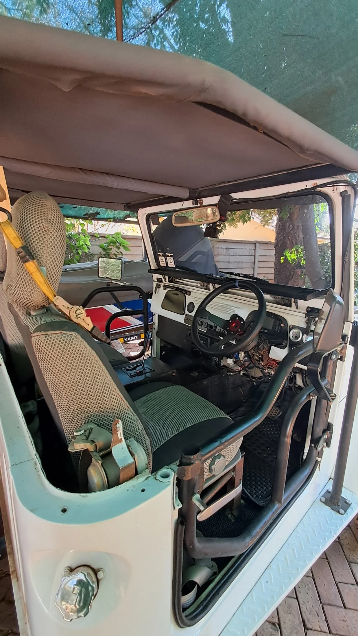

So the first step is to strip down my 45 as it stands now.
tray off
Started to strip interior
Hood off
And then seats out and windshield off too
Is it just me or is there something cool about just a tub on a rolling chassis? Brings out the inner made max :grinpimp:

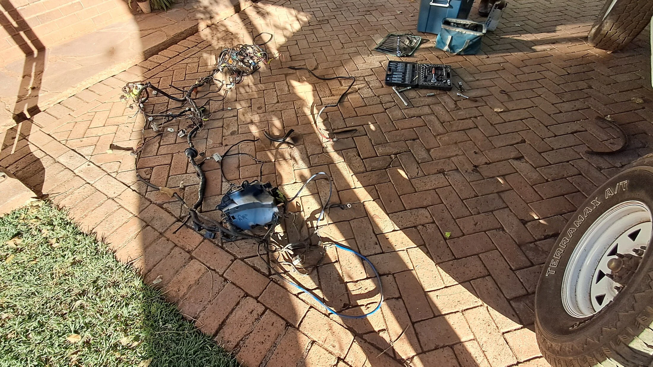

Tomorrow I will pull the wiring loom, carpet and insulation out the tub.

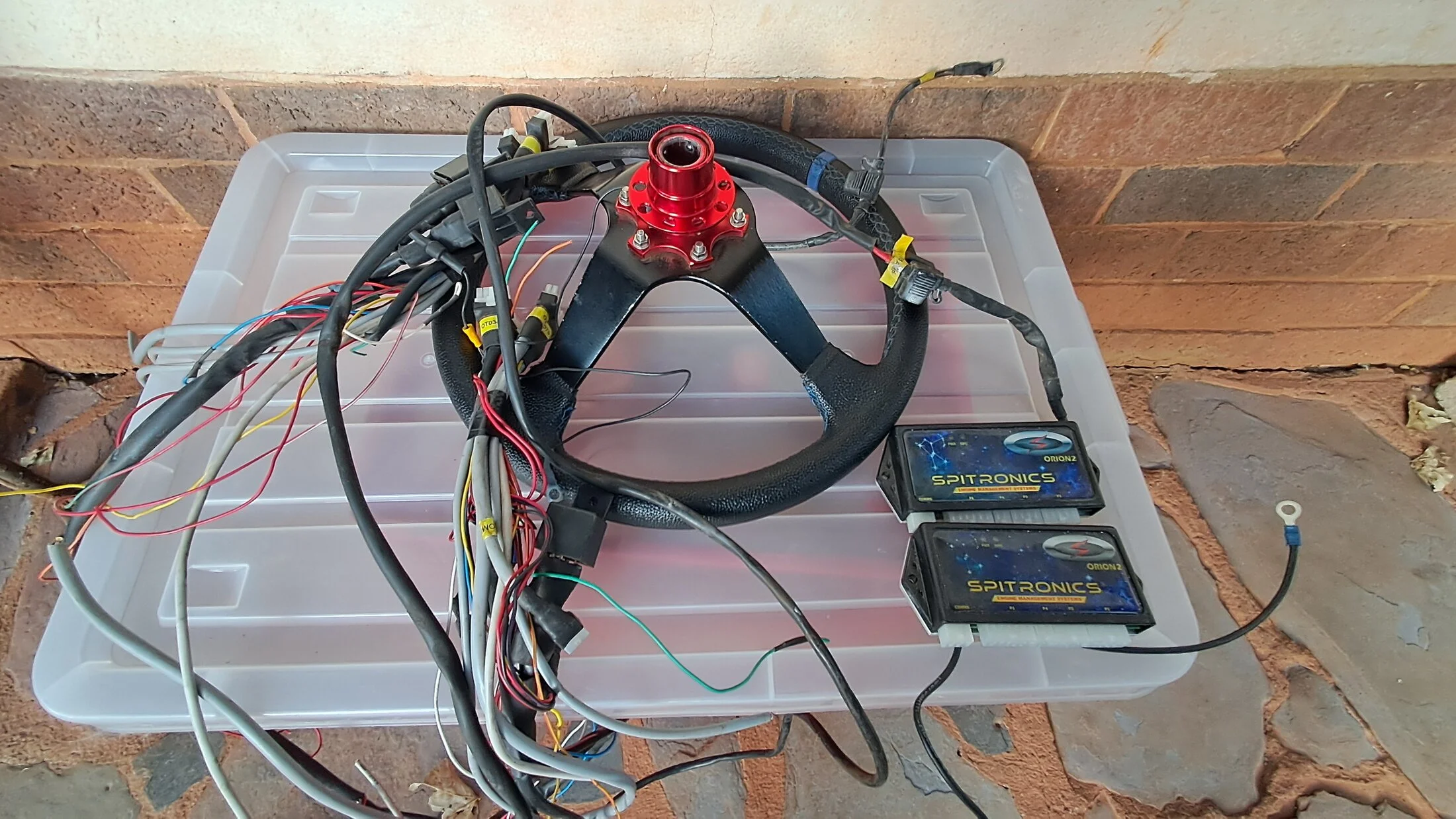

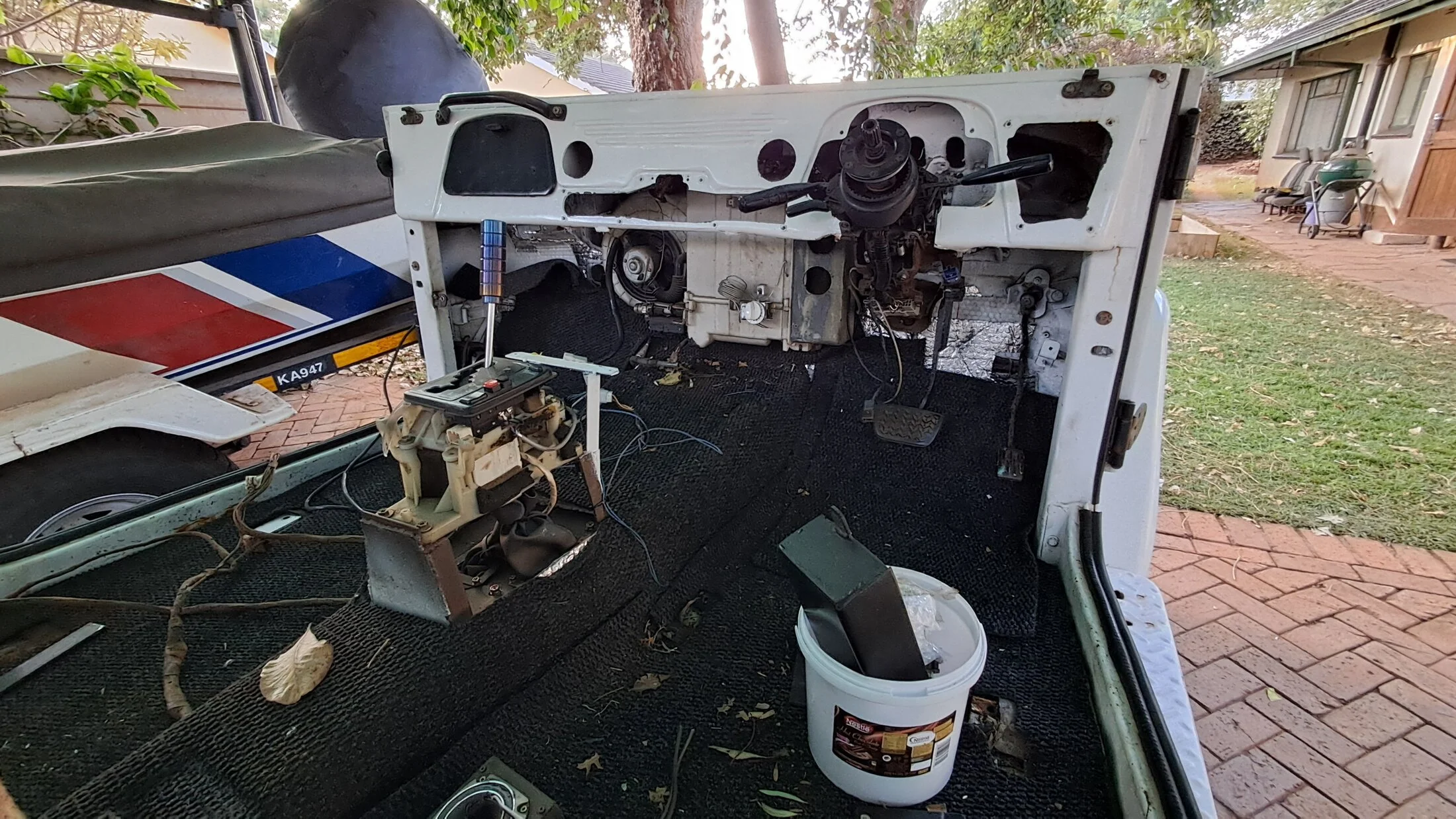

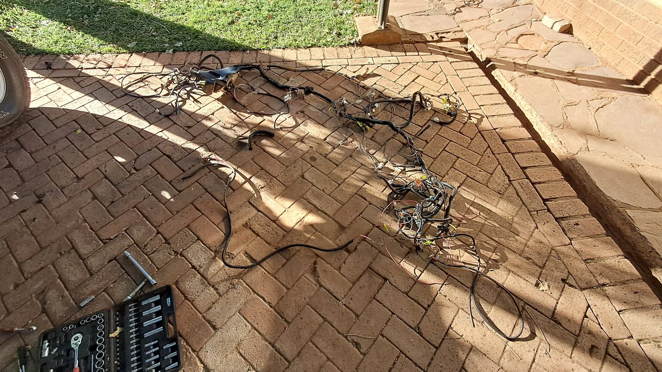

Finally got my loom out. Boy what a mess. When I first built the rig, I paid alot of attention to keeping the loom neat and tidy. But I guess 2 years worth of adding, taking out some stuff, adding more, changing this and splicing that makes for a real mess now.
Going to be simplifying this down a lot
Only a few things left in the tub now like the AC and the carpets.
Going to be cleaning up the dash as well. All the facial plates will get powder coated this time around.
And also changing out the ECUs. Don't need the 2nd one anymore for the auto trans, and taking the opportunity to upgrade to a newer unit while I'm at it.
So don't need these anymore

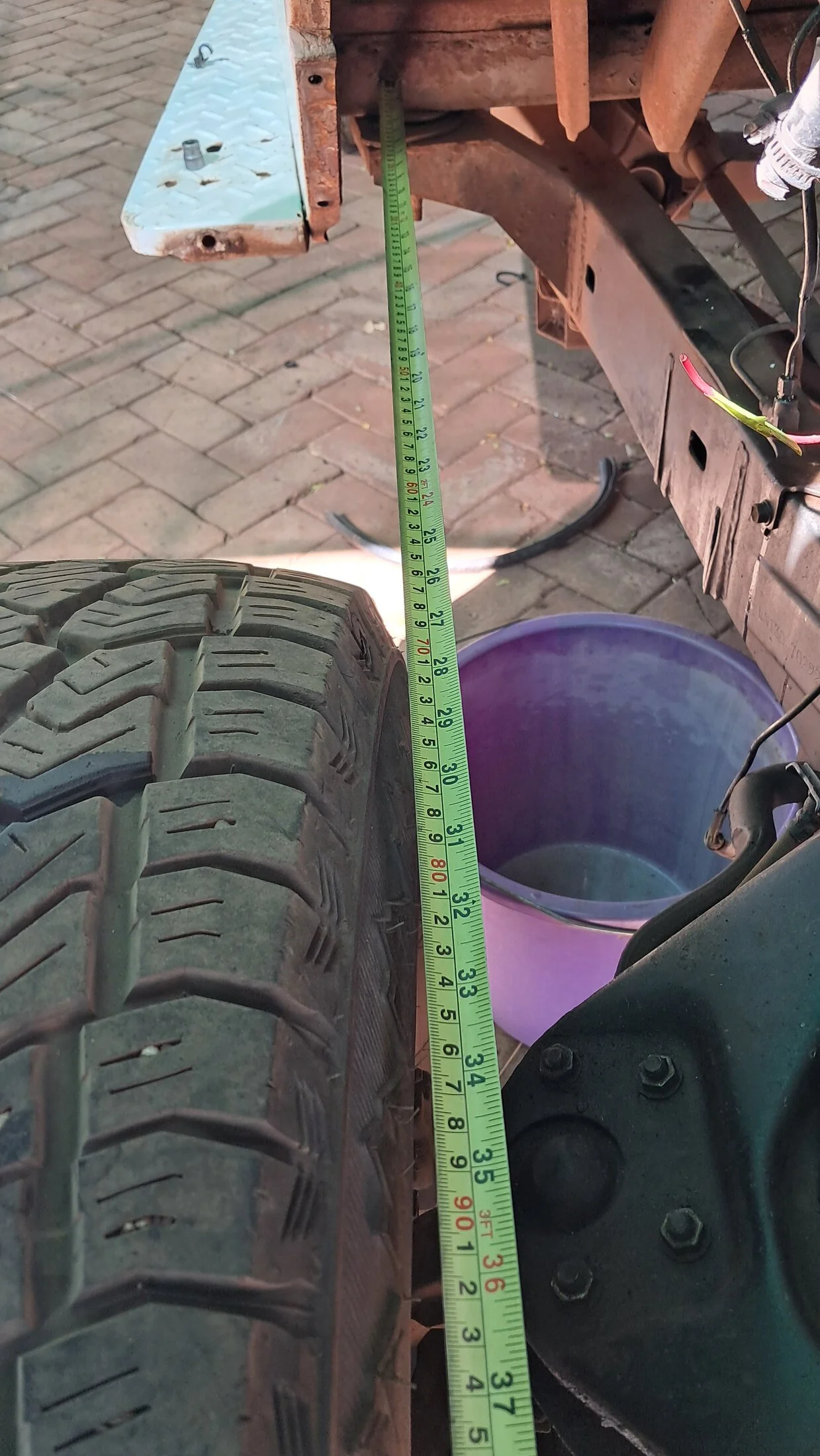

One thing I paid a lot of attention to when I first did the IFS build was getting the front wheels correctly placed in the front arches. Nothing ruins a build more than messing that up in my opinion.
And I think I nailed it. So, going to transfer those same measurements across to the new 80 chassis.
In my case, it's 850mm from the front tun mount to the center of the wheel.

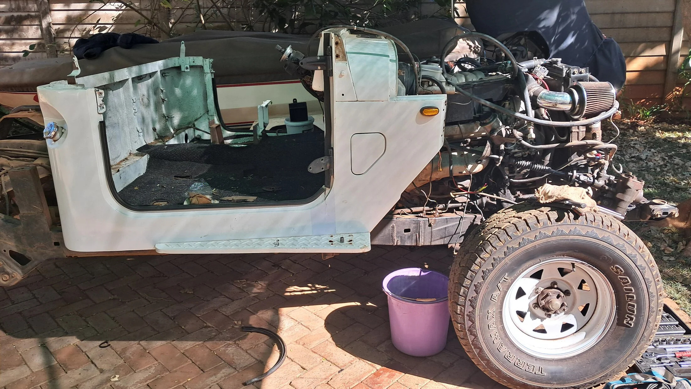

Then we ripped the tub off and set it on the new chassis.
Have a few things to take care of before we get the engine moved across. Plus, I'm still waiting for the new flywheel to mount the H150 to the 1uz .

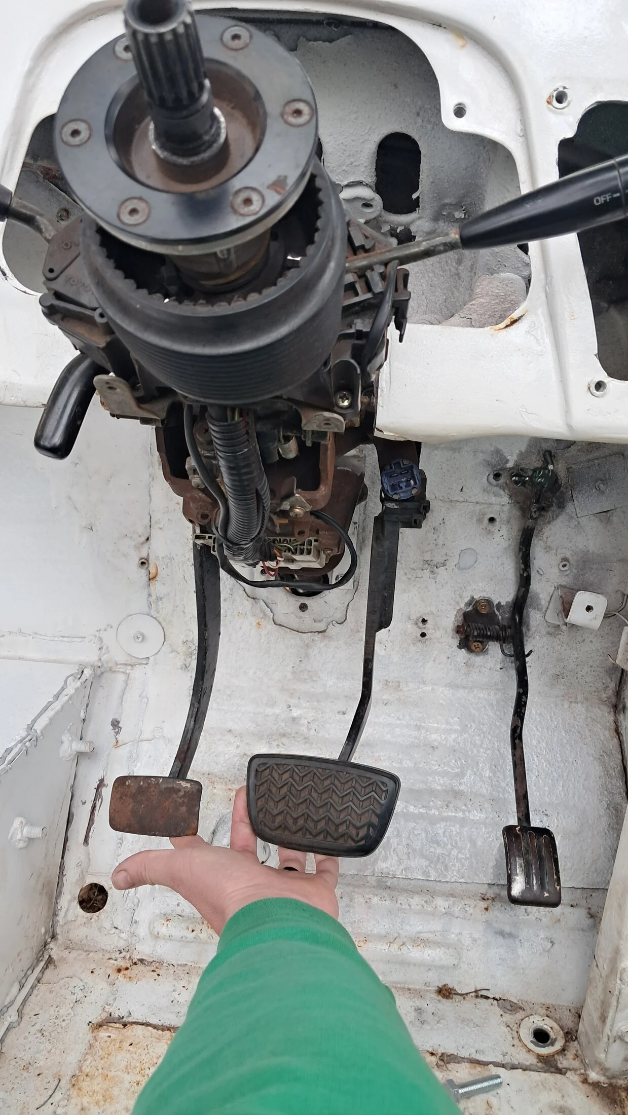

Guess I need a third pedal again.

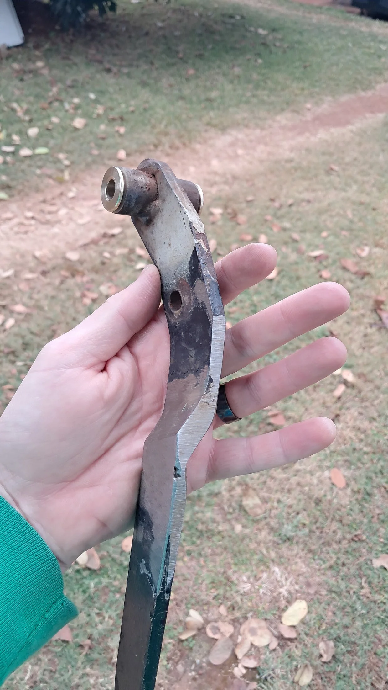

Im keeping the surf steering column as it's already in place and does everything I need it to do, but it does get in the way a bit of where the clutch pedal wants to go. So I had to adjust the way the pedal routes.

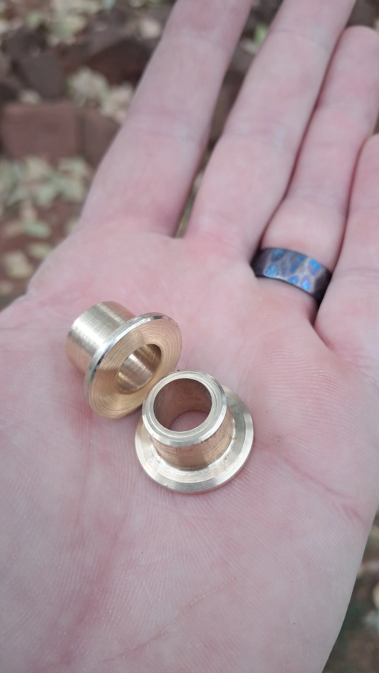

Then i noticed there was a huge amount of side to side play on the pedal, so turned up some bushings.
Adjustments to pedal and bushings in
Just a little more clean up, some paint and then to get and attach a master cylinder to the other end
Will also move the brake pedal more to the right as well. May even move the clutch more right as well to allow my boot to fit between it and the trans hump when I'm not shifting.
Always the small things that get you

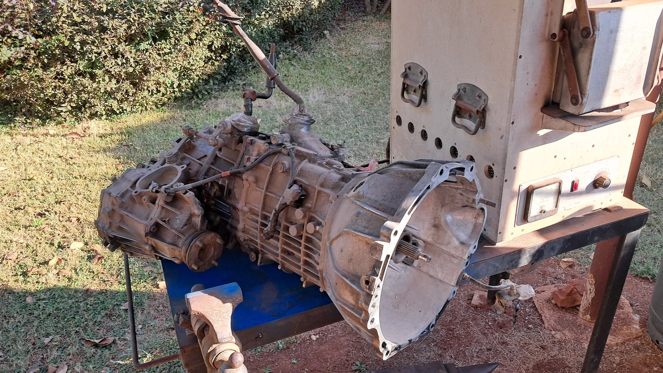

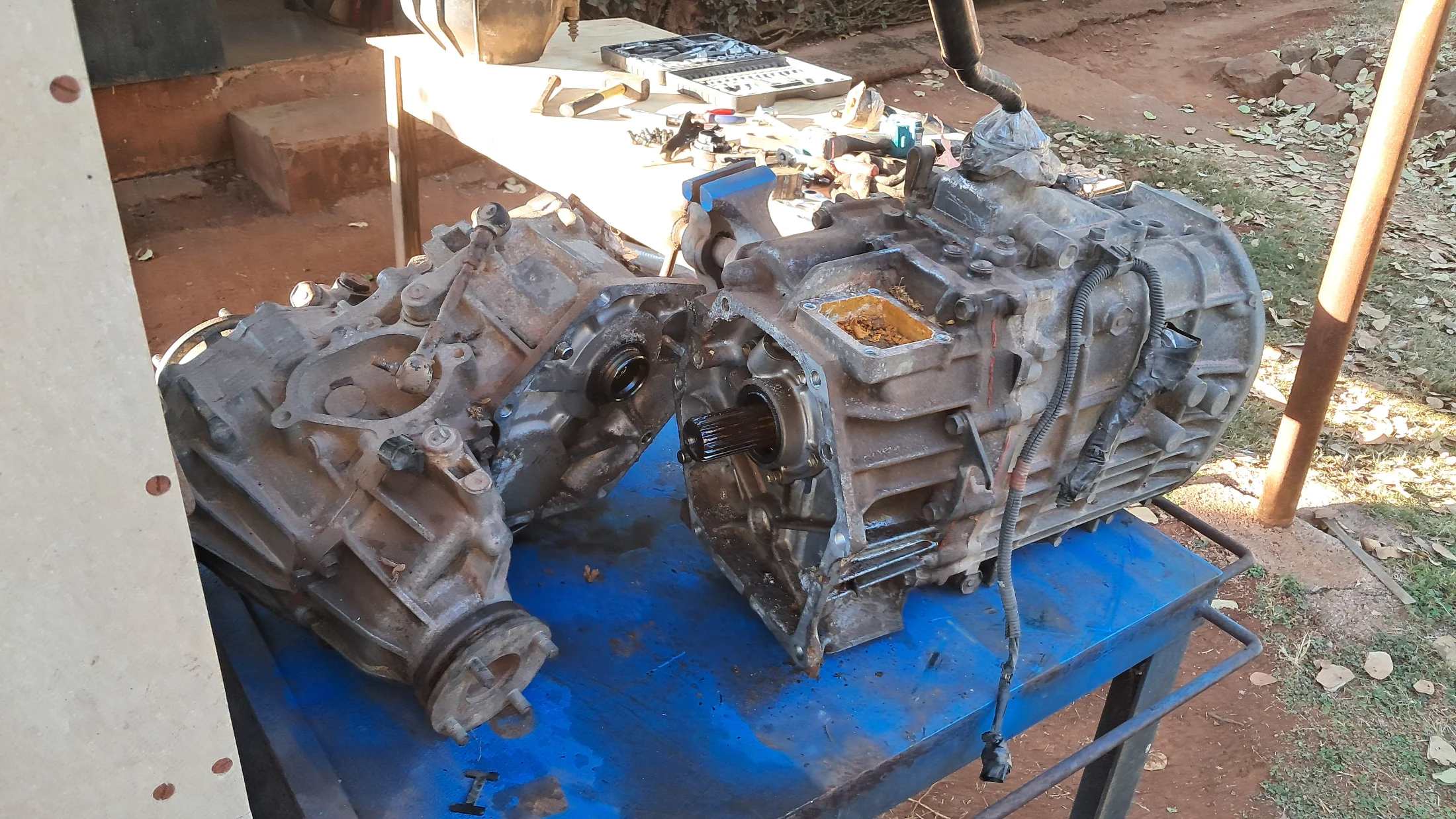

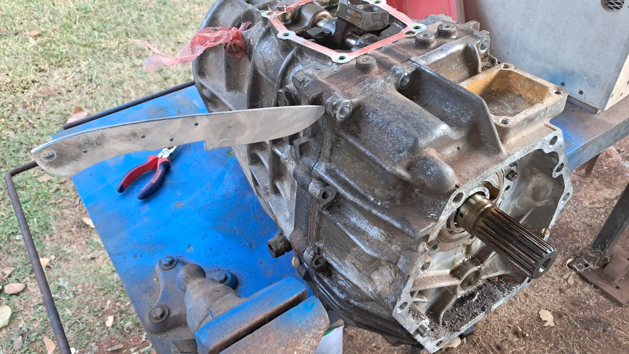

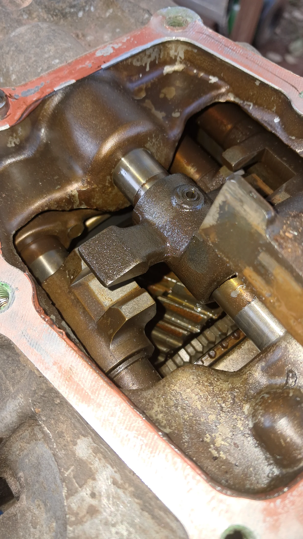

STILL waiting for my new flywheel. Might as well start tearing down the gearbox.

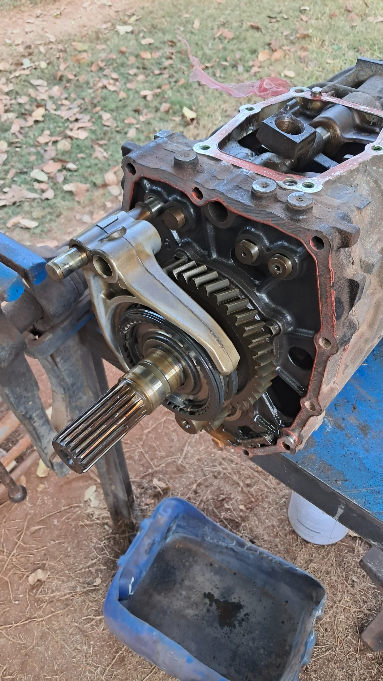

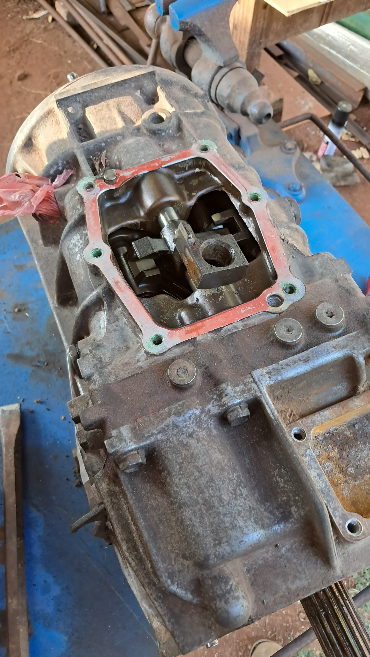

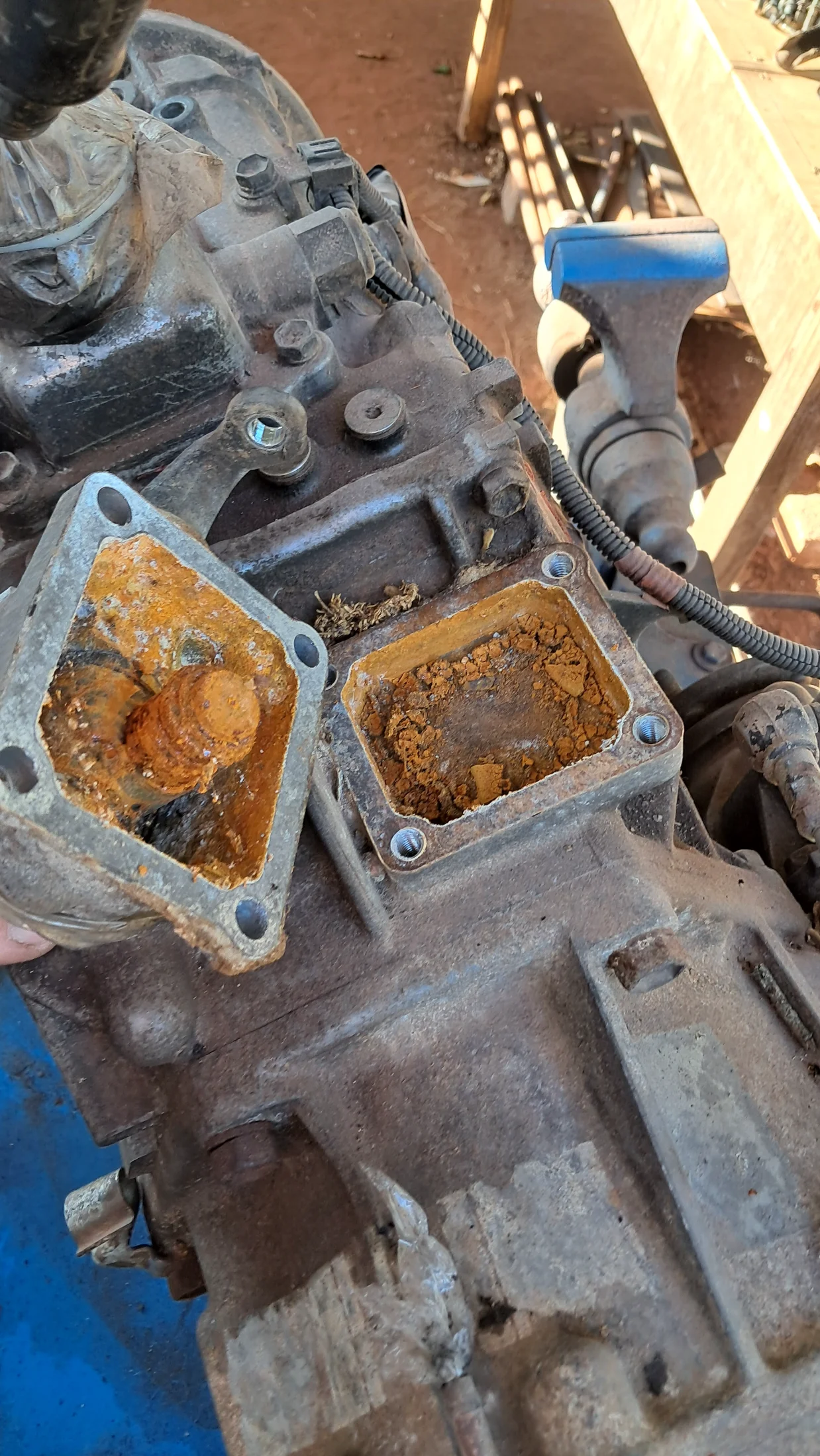

This box stood out in the rain for who knows how long with no rubber boot, so I'm expecting there to be some rust. Let's see how bad it is...
Transfer shifter off and this isn't promising...
Transfer case off. Output shaft looks ok....
Shifter assembly off next.
First view into the box itself... pleasantly surprised
Looks like there's some rust down there, but I honestly was expecting way worse.
Input shaft cover off next. Bearings look good.

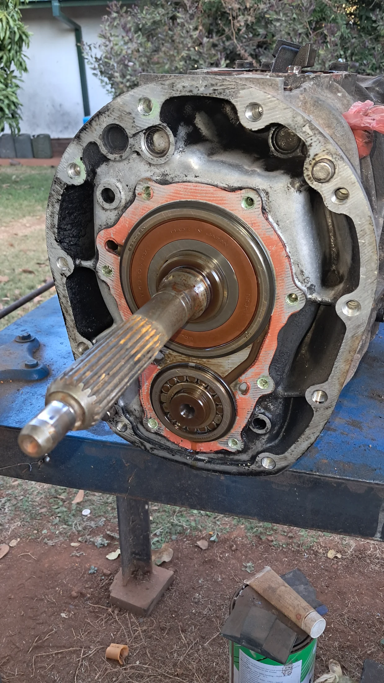

Next is to split the transfer case adapter.
I guess this is where being a knife maker comes in handy!
Looking alright here too

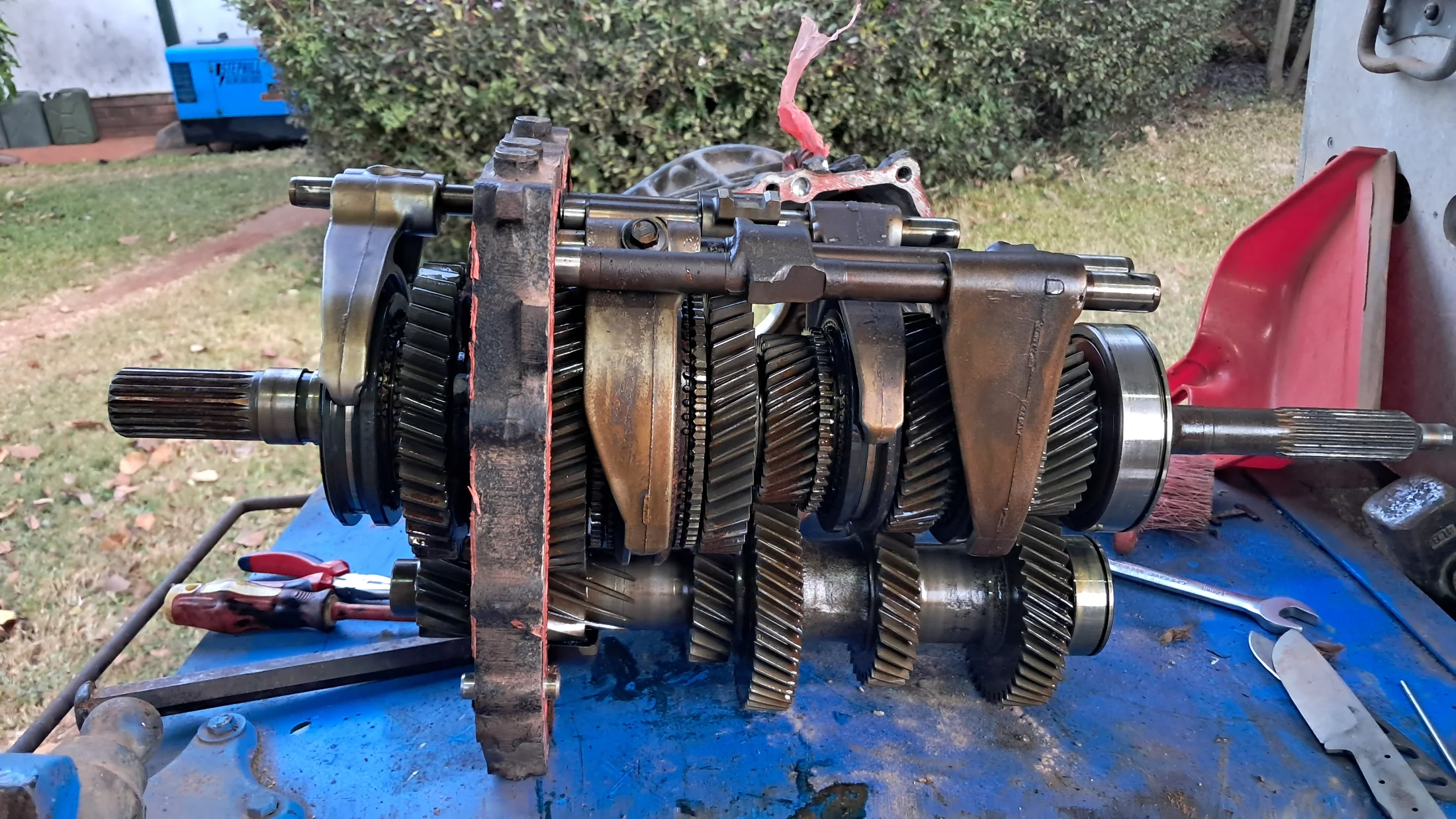

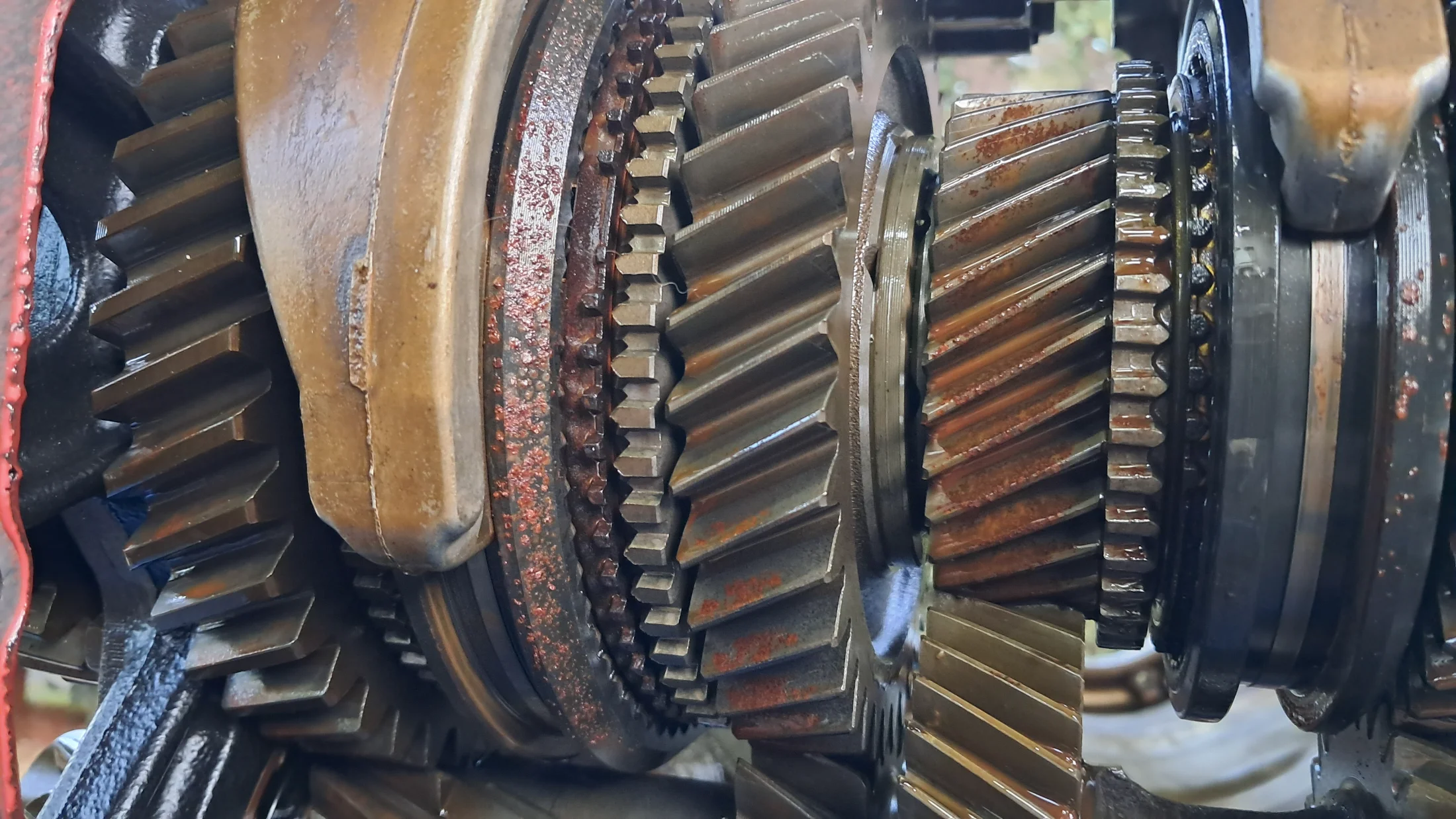

And finally, the whole thing apart
There's the rust.
Im honestly not sure what to think. I thought it would be a lot worse. This is pretty much just surface rust as far as I can tell.
Part of me wants to slap it all back together, put fresh oil, send it for a couple hundred kms and then refresh the oil.
But the other side of me wants to make it all new.
Thoughts anyone?

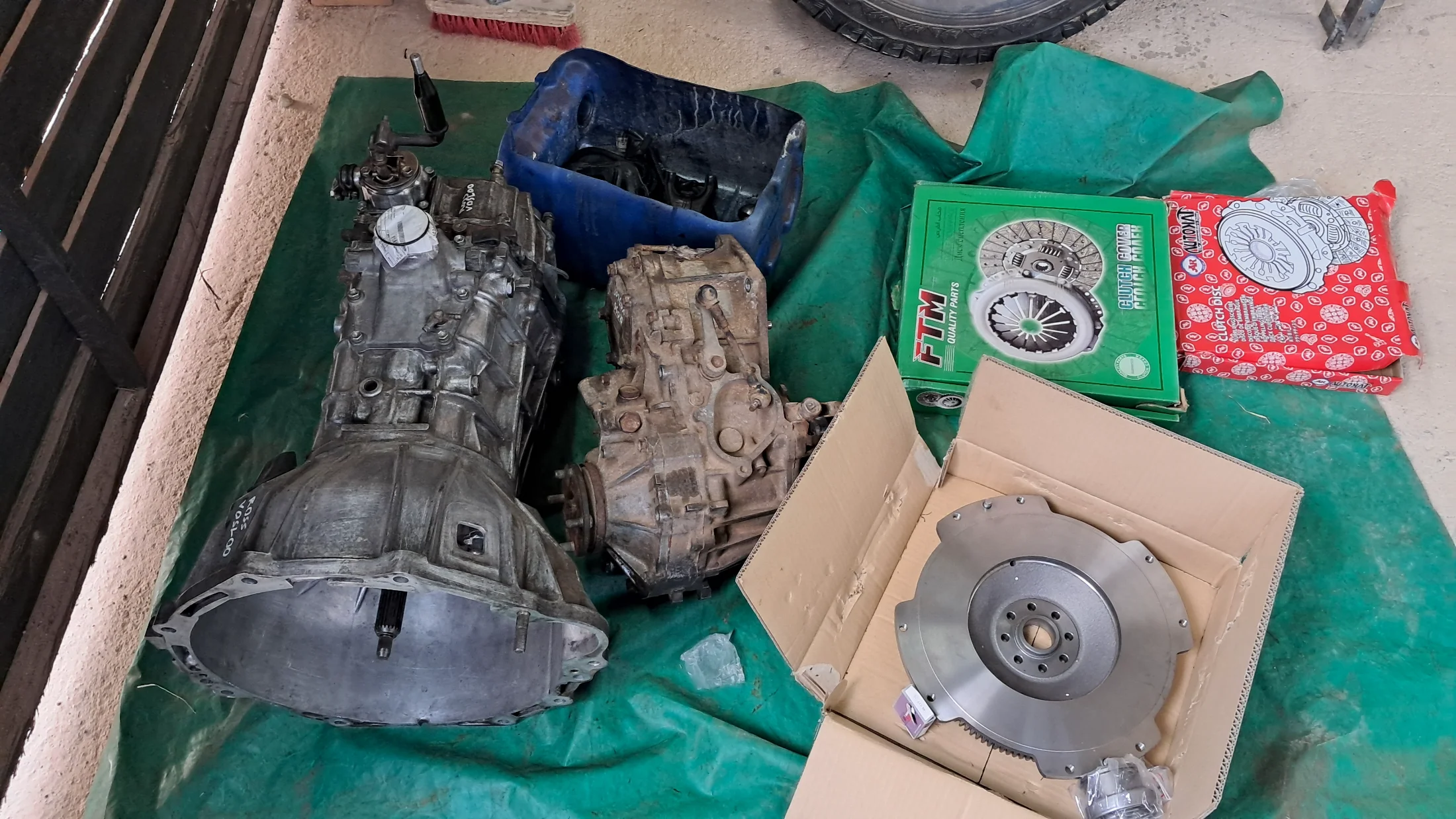

Well, finally have all the bits to get this done, barring the custom bell housing i need to make.
Its a weird combination, flywheel from a 2uz, clutch plate from a dyna, pressure plate from a 1hdt 100 series and throw out ans pilot bearings from a 1hz 80 series.

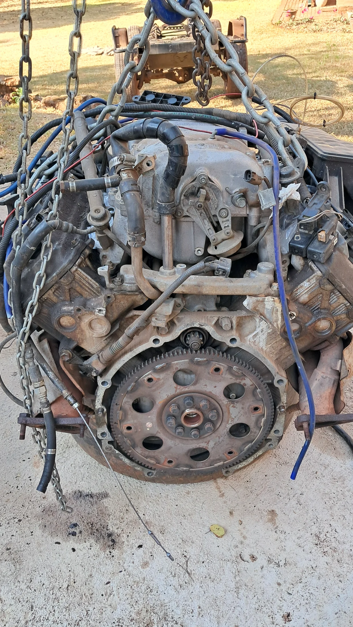

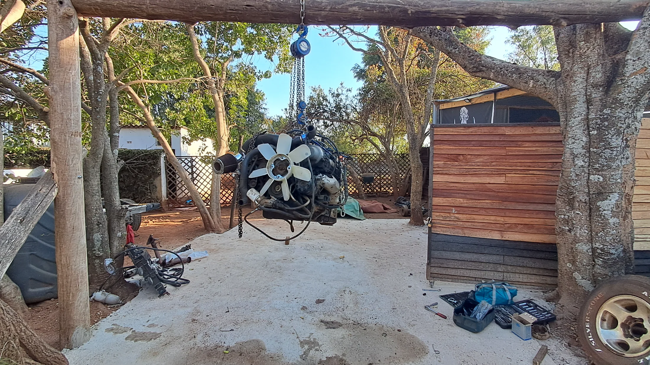

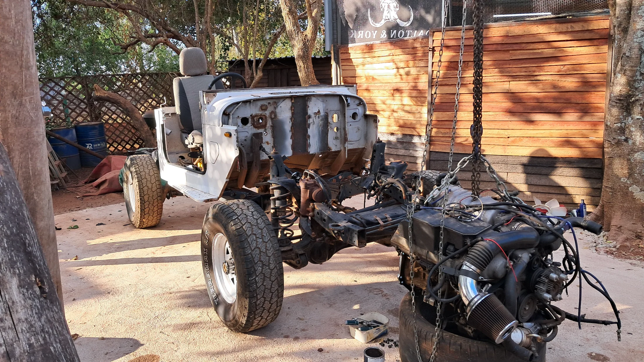

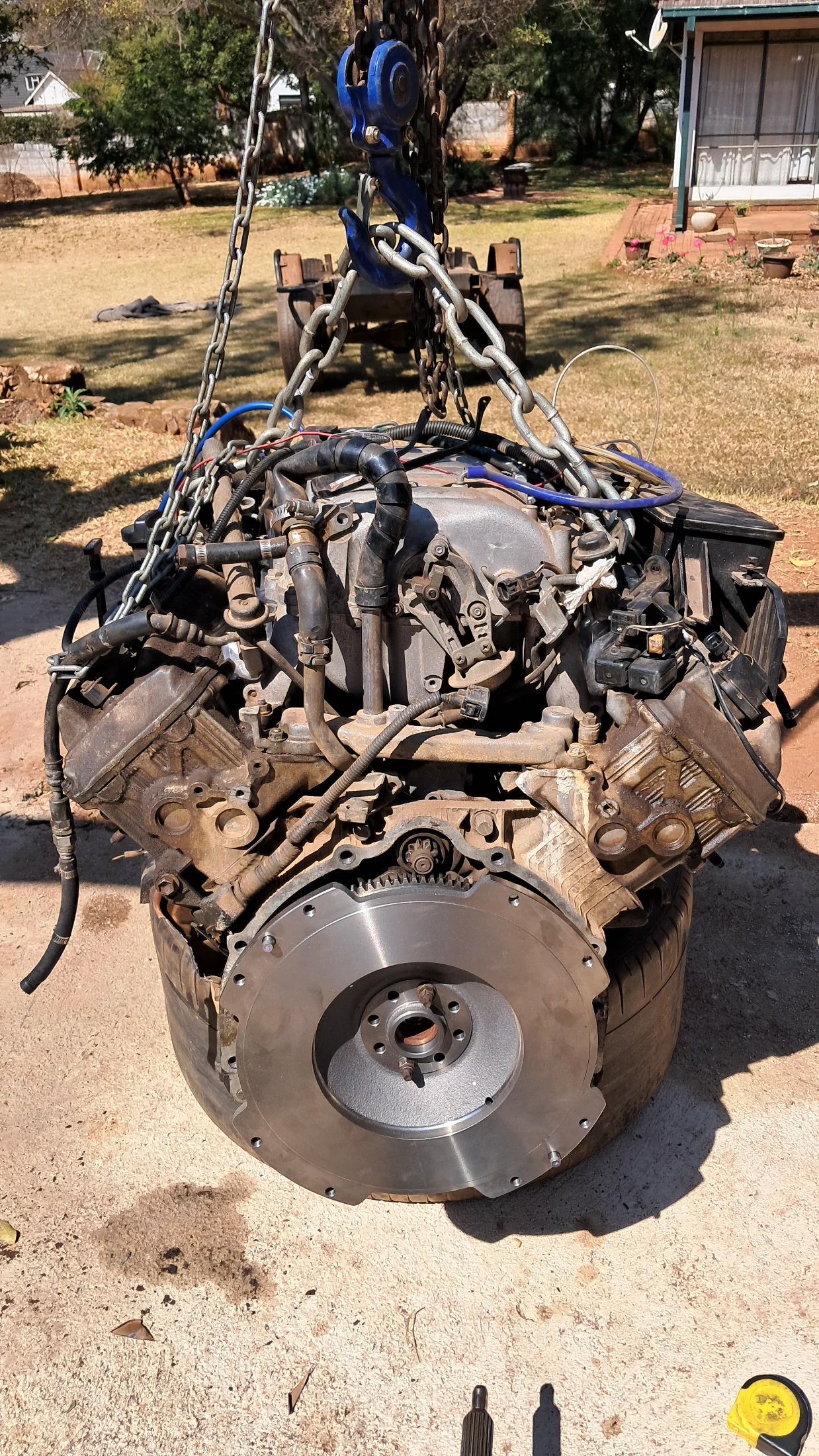

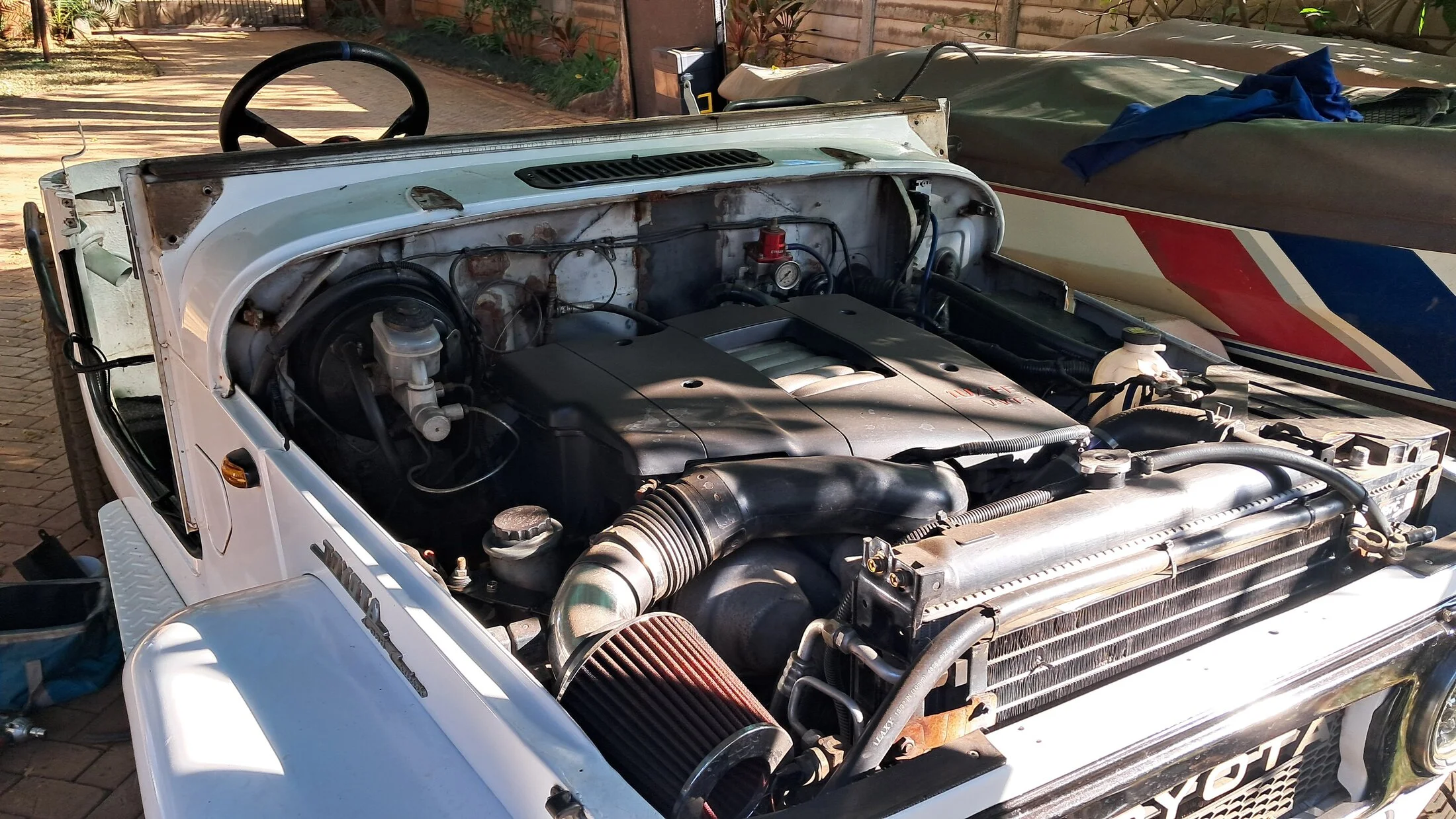

So now it's finally time to pull the engine from my old chassis. Wheeled it up to the workshop to start getting it done.
Say what you want to about IFS vehicles, but they have great ground clearance.
And this is on 31s, not even the 33s I ran on it normally.

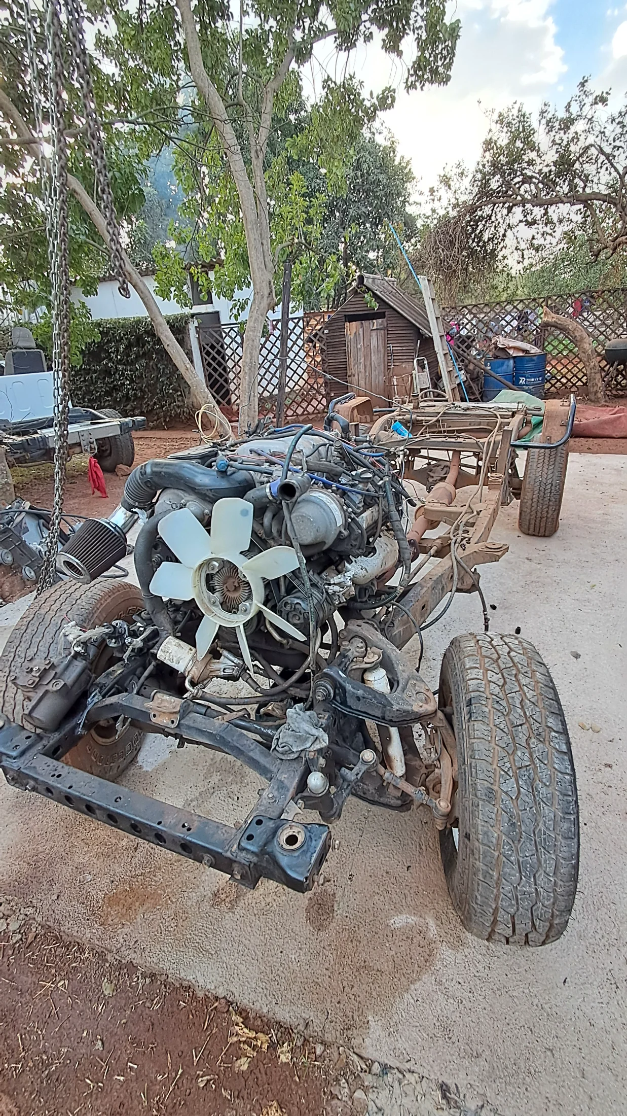

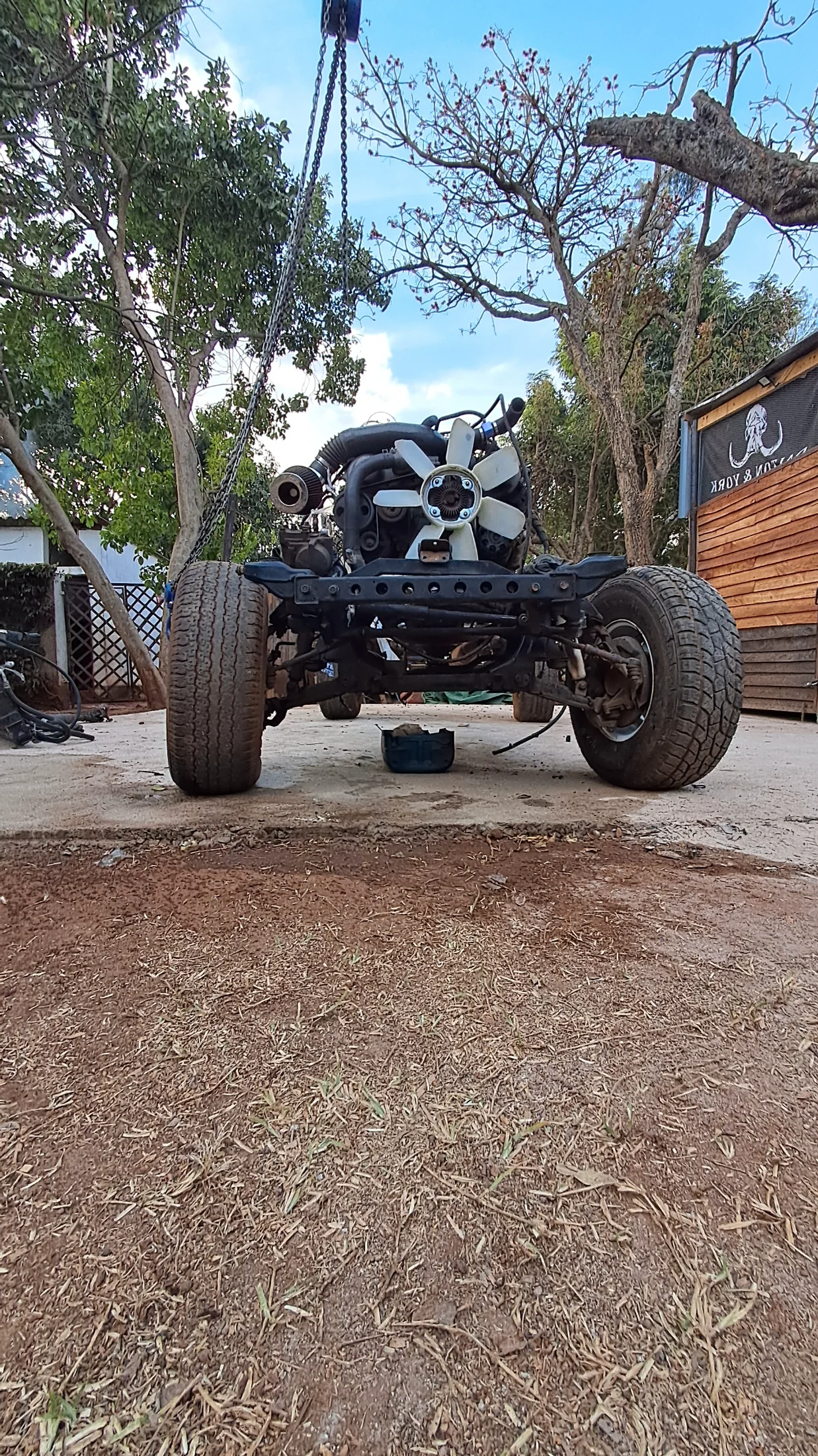

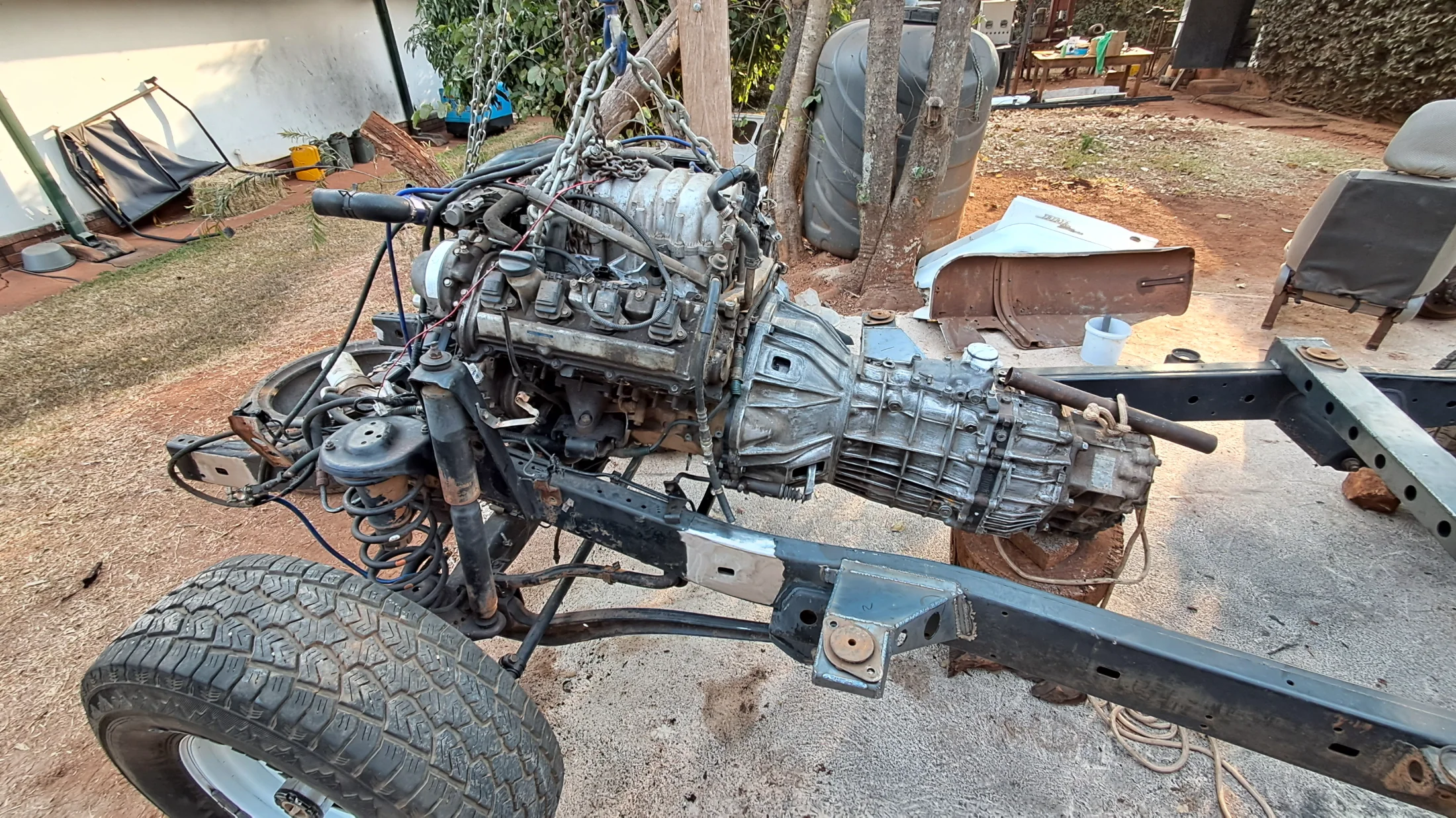

Engine and gearbox out of the chassis

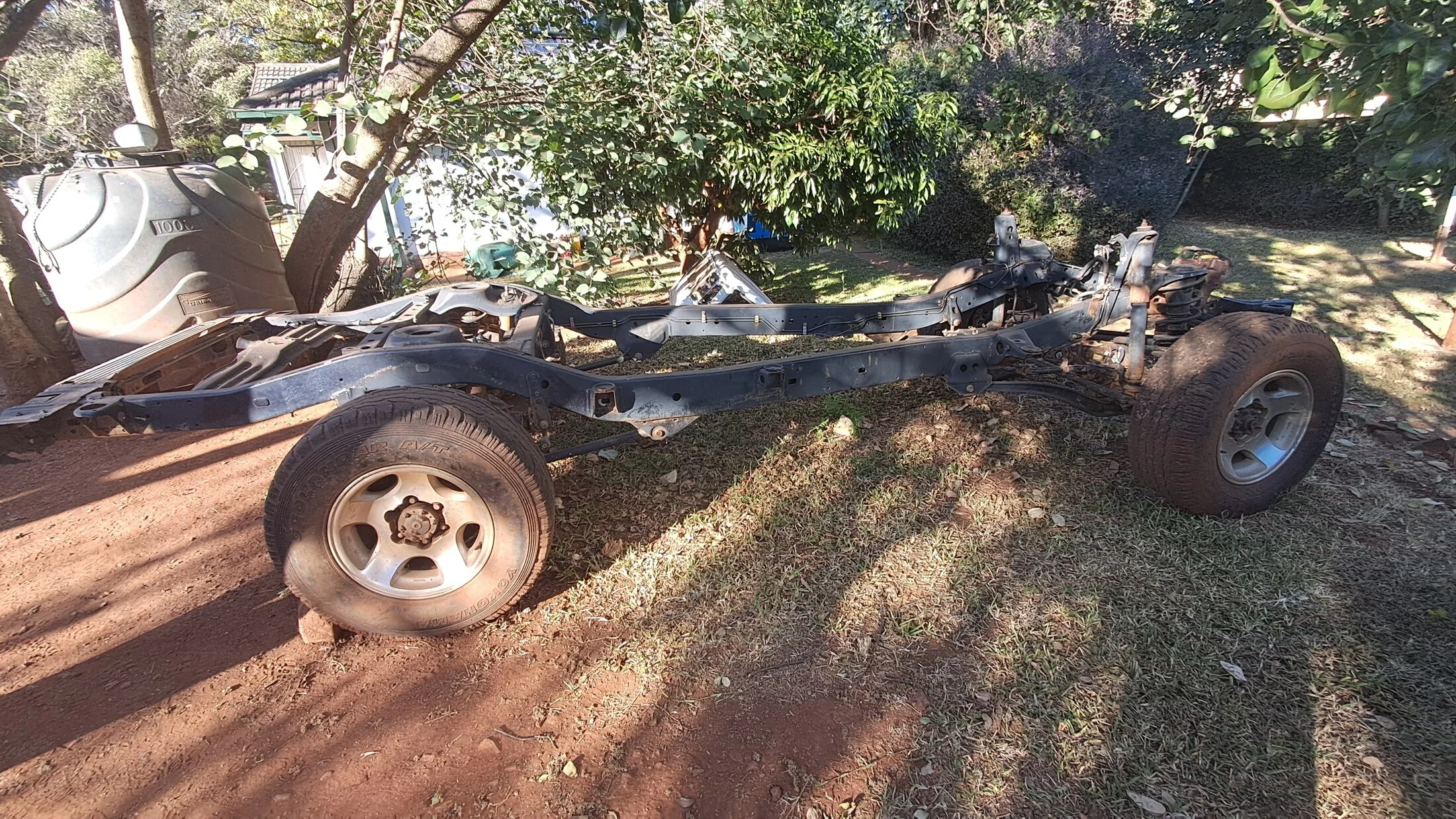

And chassis back down the hill

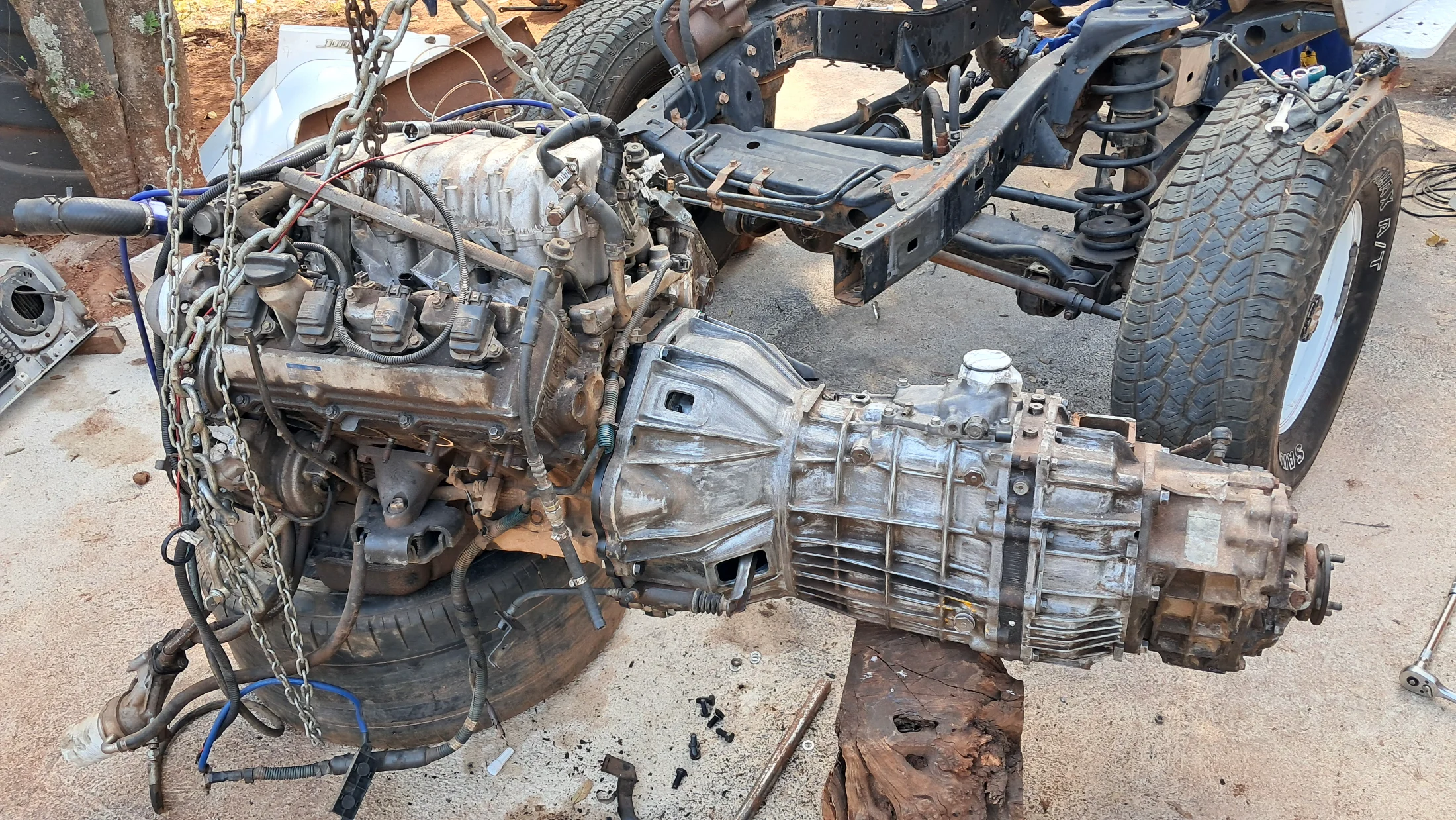

Still a few things to pull from it like the fuel tank, but otherwise, that's pretty much it done on the good old hilux surf chassis. It did good. It did really good.
Gearbox off and it's now apparent that yes, in fact, we are going to need to make new exhaust headers, or at least modify these ones to give clearance around the gearbox and bell housing.

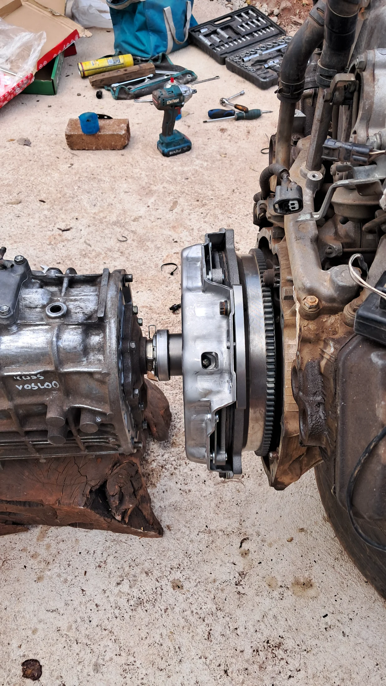

Time to start getting this gearbox onto the back of the engine.

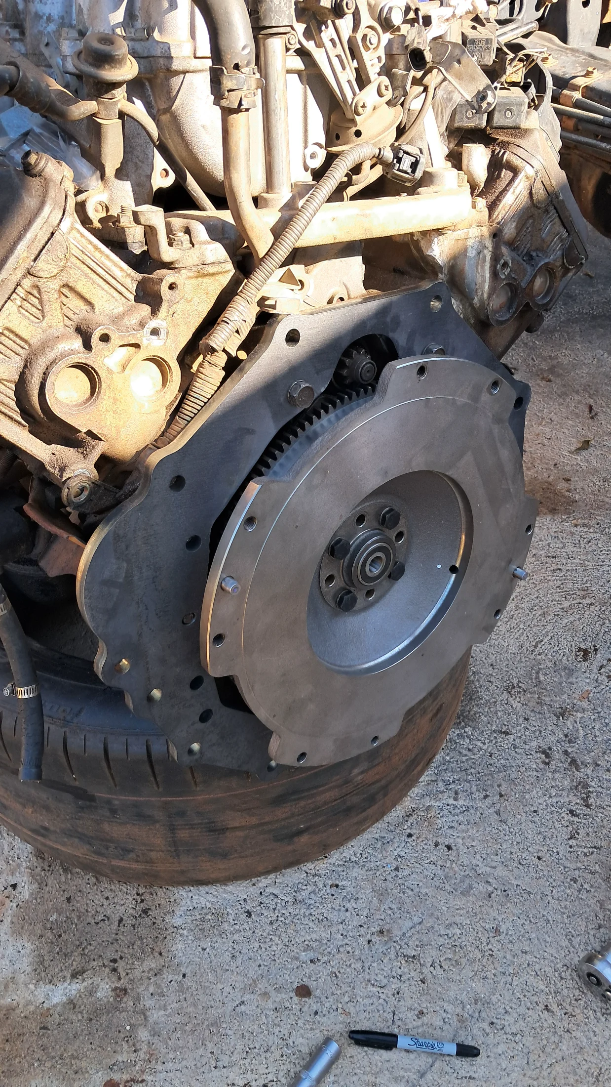

New flywheel on. Isn't it pretty

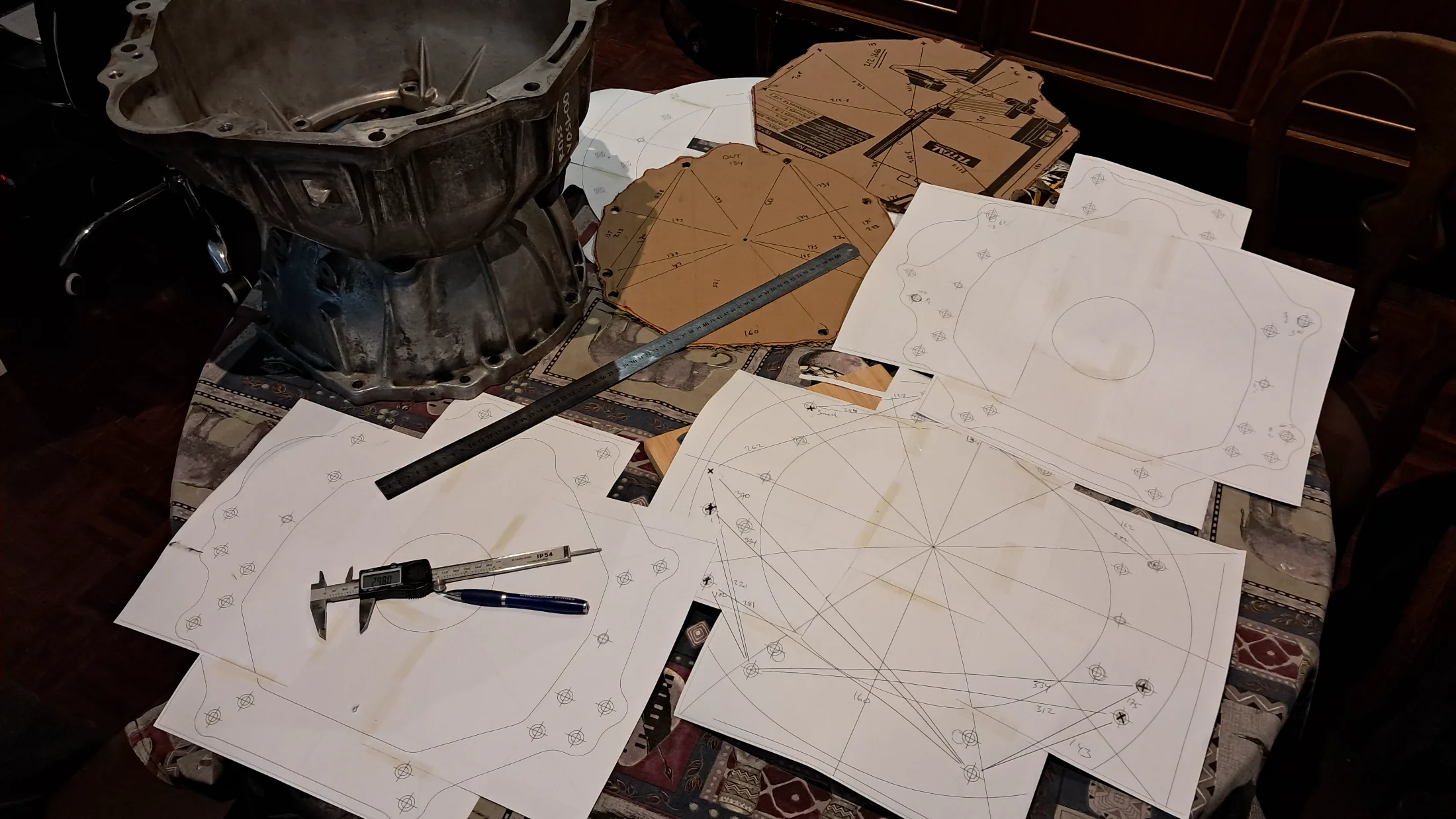

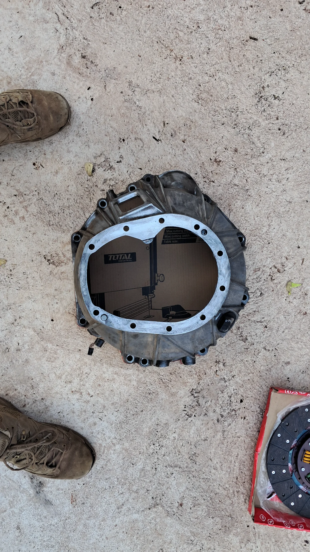

Then the clutch went on so we could see what sort of gap we are looking at for the bell housing.

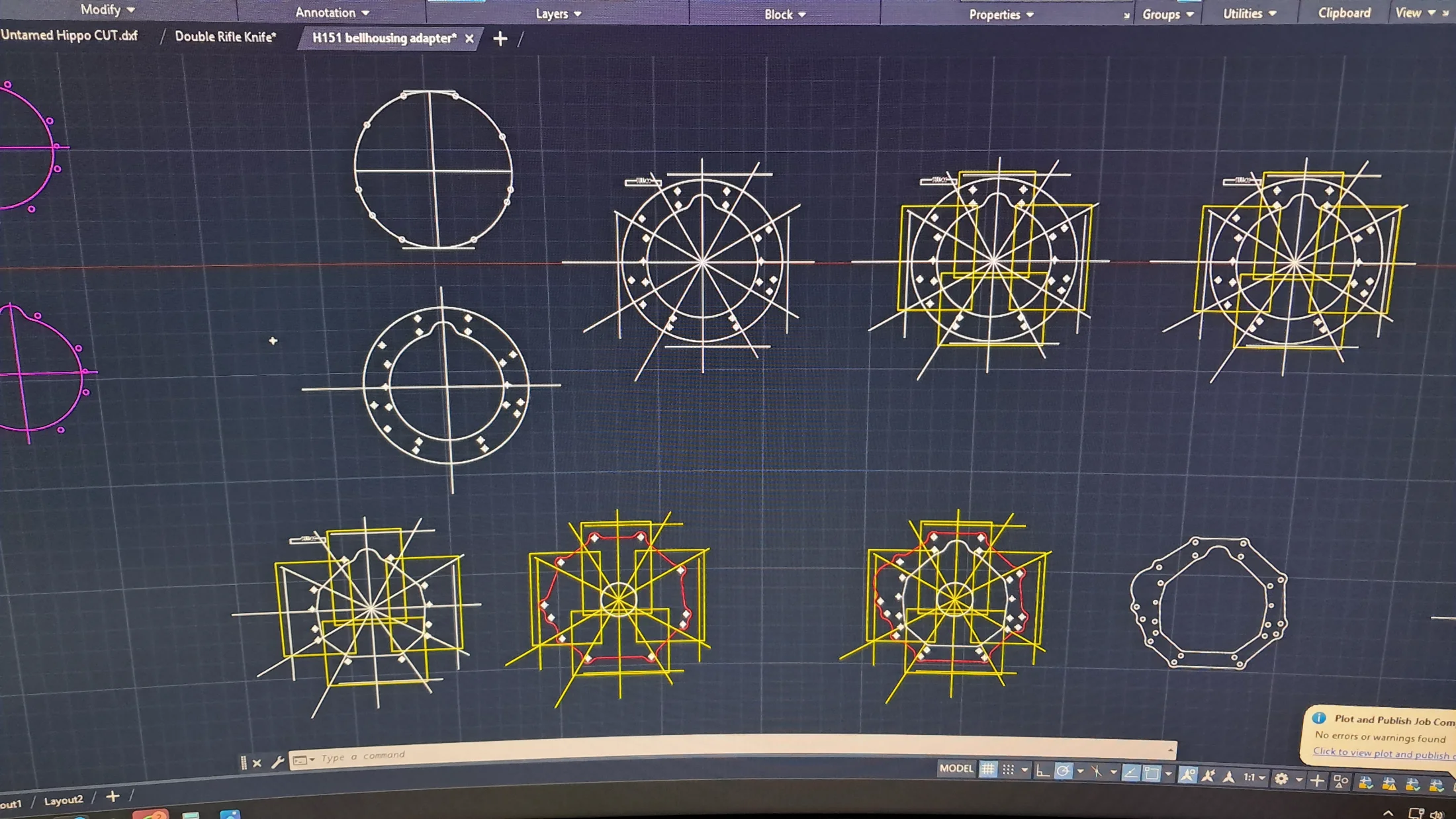

Measured out at various points around it, and we have it sitting nice and straight at 204mm between gearbox and engine faces. This measurement was taken with the throwout bearing resting against the clutch fingers and about 5mm of space behind it. Ideally we want some extra room for the throwout bearing to move into as the clutch disc wears and the pressure fingers push back.
The great thing is that the 1HZ bell housing comes in at 198mm tall. And what that means is all I need to do is make an adapter plate that bolts to the back of the engine, which the 1hz bell housing then bolts to, out of say 12mm steel for rigidity and to give me that extra bit of room I need for the throwout bearing to occupy.

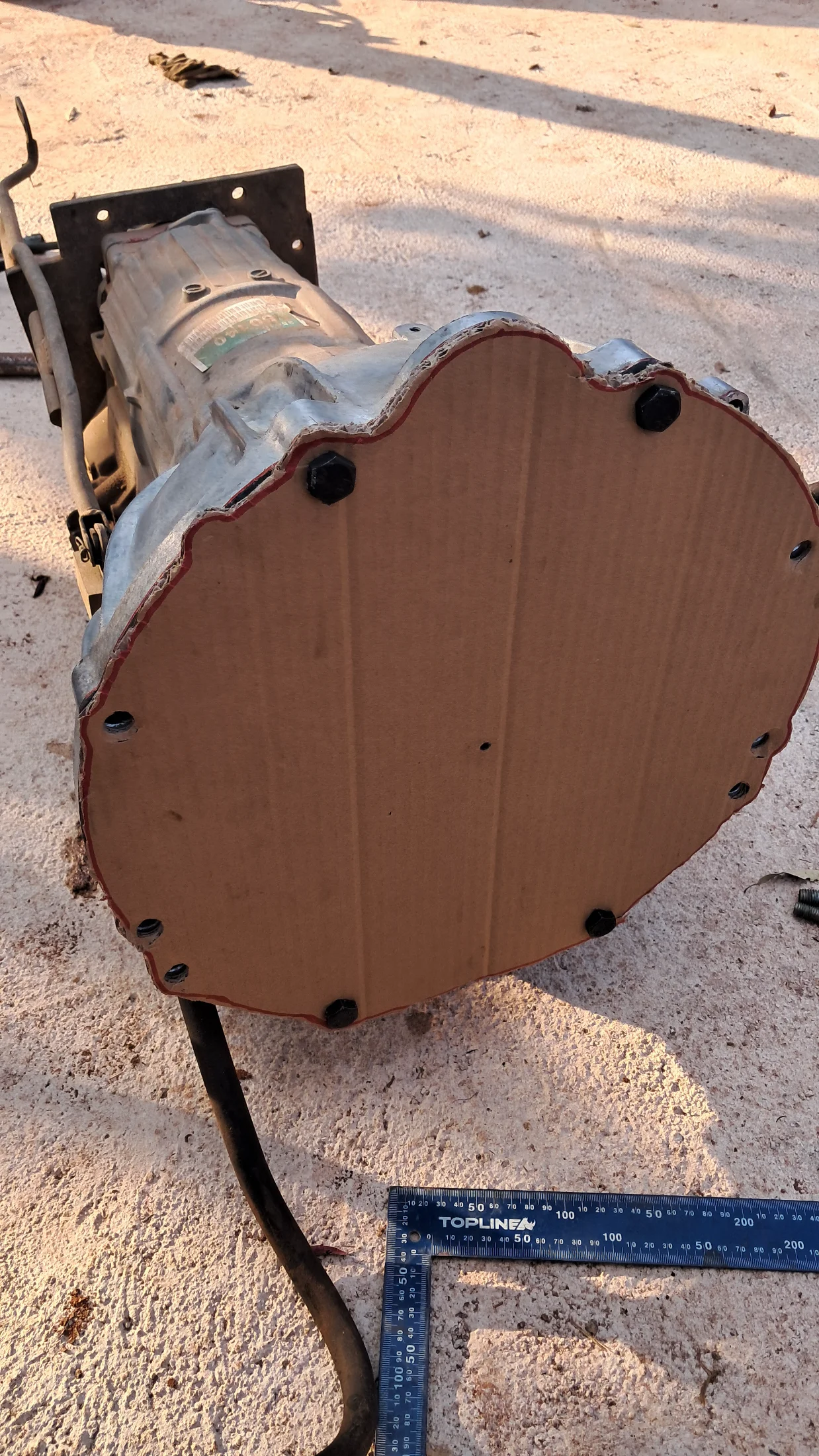

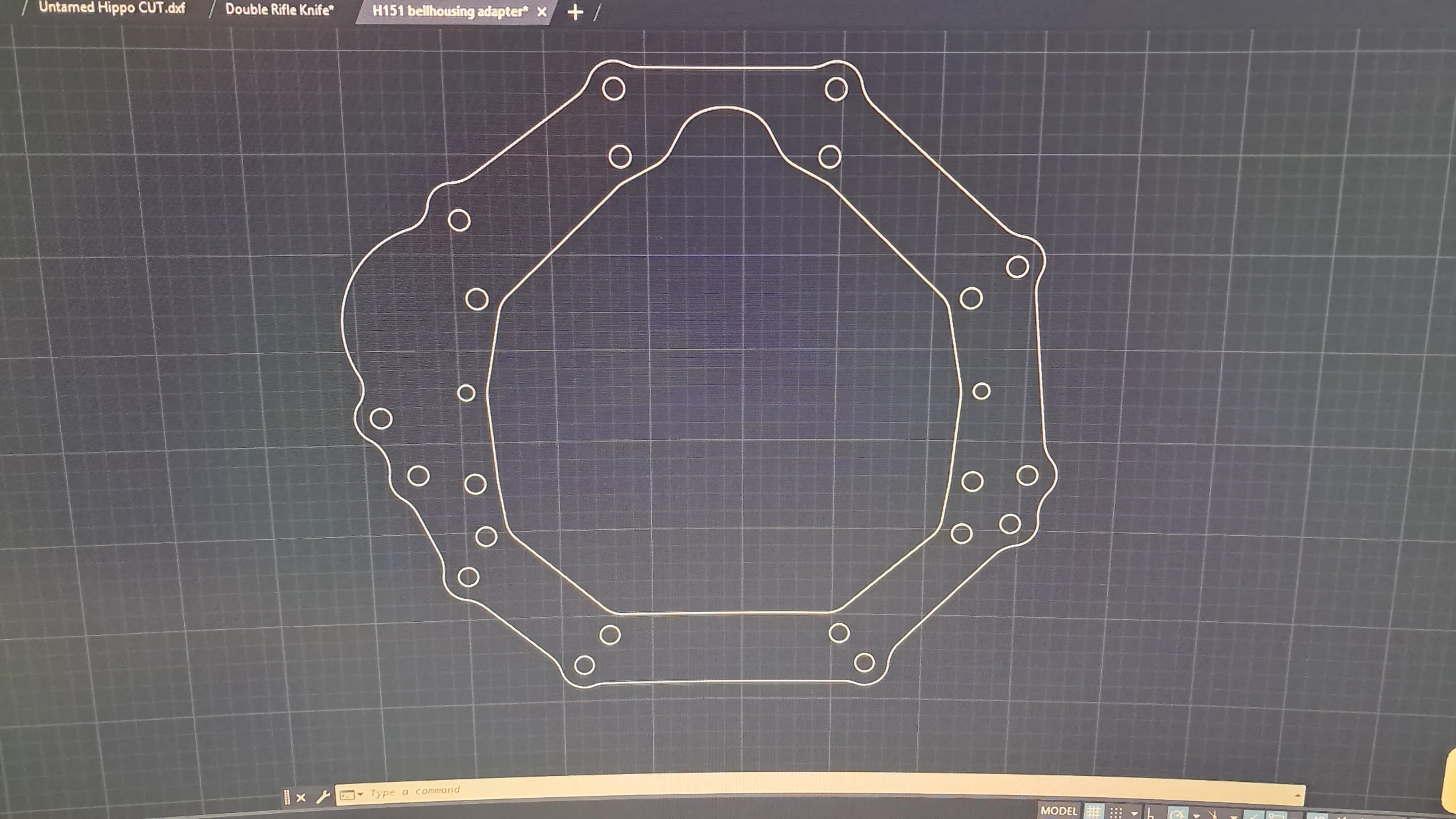

So now all I have to do is find the centers of both bellhousings, mark up the bolts holes, and then make a plate. Cue the CAD. Both the old and new school versions...

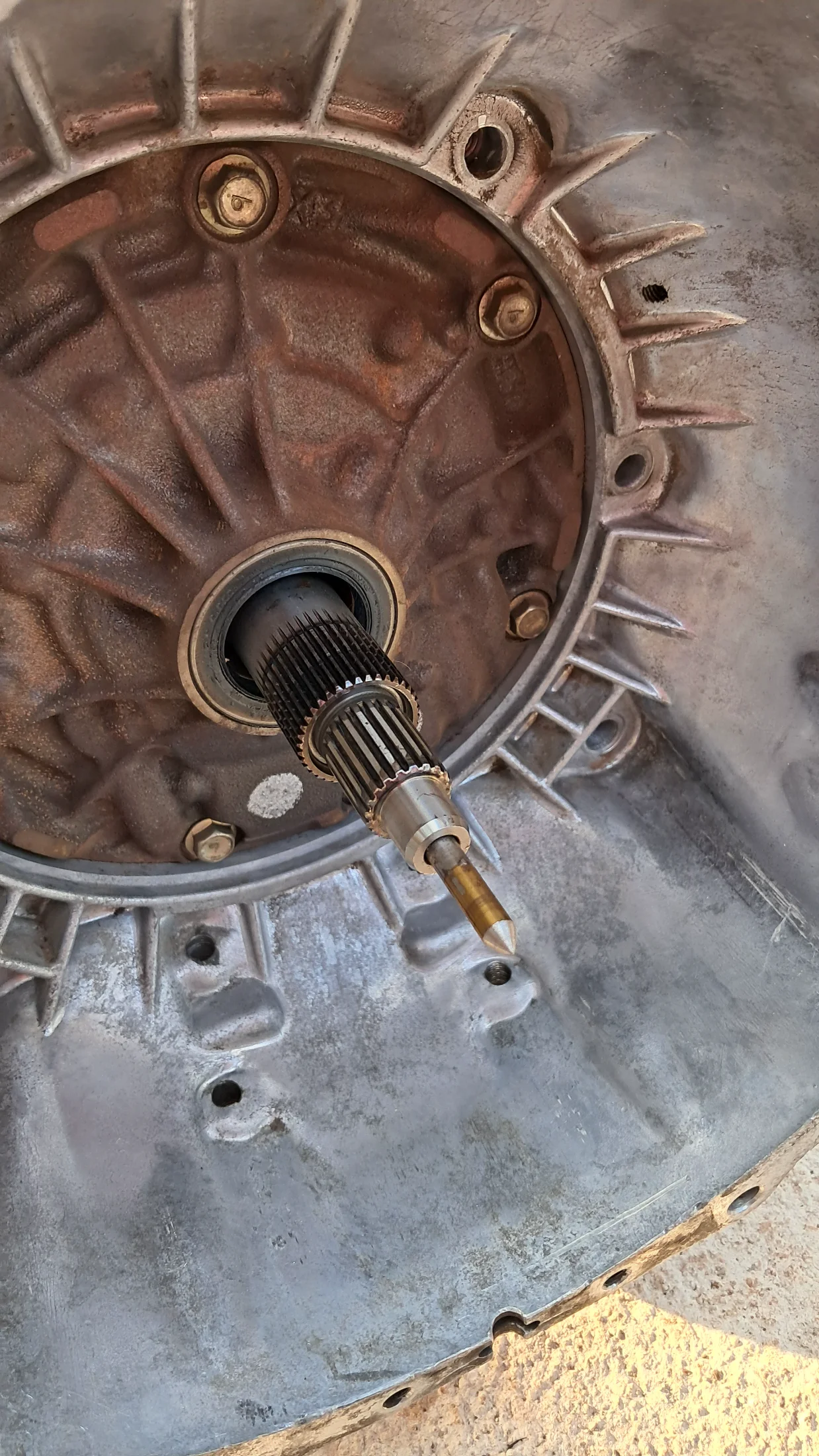

First I made a tool to fit into the input shafts of the gear box to mark the centers.
Then a cardboard template that bolts on and i can press onto the center finder bit.
Do this for both gear boxes.
Then cross measure all the bolt holes, throw it on the computer into CAD, print templates, check, adjust, print, check, adjust... you get the idea.
This is how many revisions I went through.
And here's all the paper work to back it up.
To finally arrive at this design
All things being equal, this will do the job. There may need to be a slight massaging on a few holes, but the top and bottom 2 on both sides are 100% perfect, and as far as I'm able to measure and verify, the centers are running true as well.

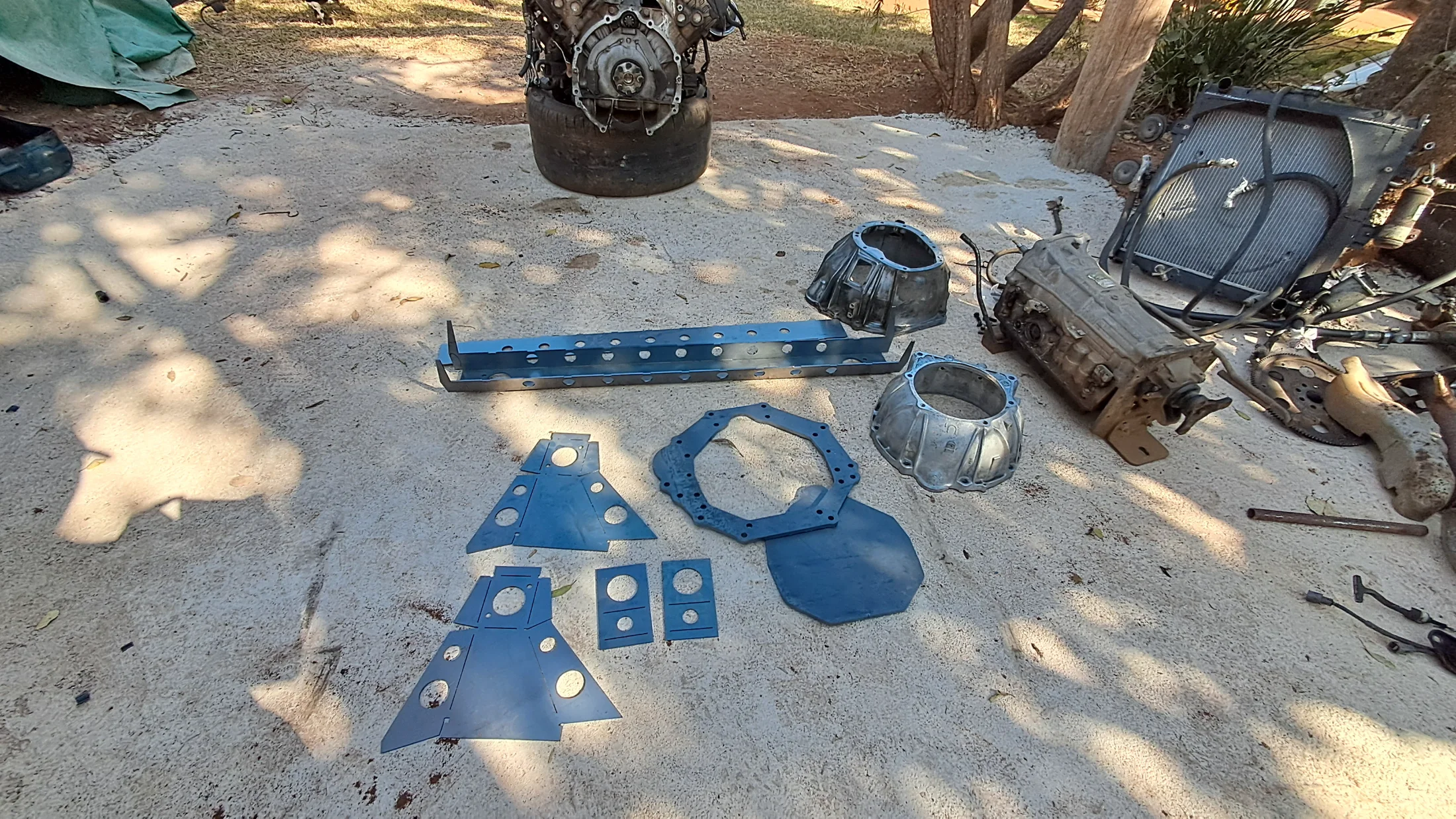

Now to get it laser cut
Got my adaptor plate cut, as well as new body mounts.
Went to bolt the adaptor on, and, although it fits, I need bolts to do it. And it's a public holiday, so no dice today.

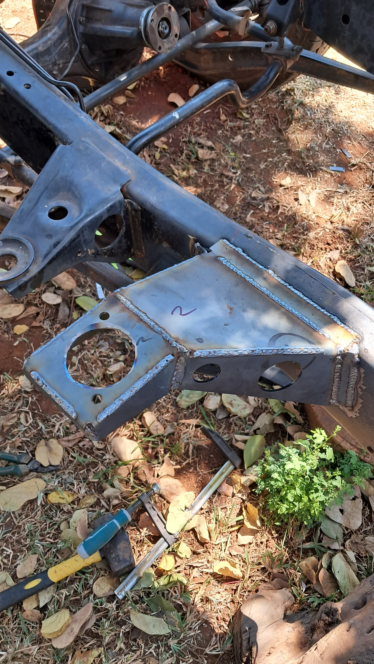

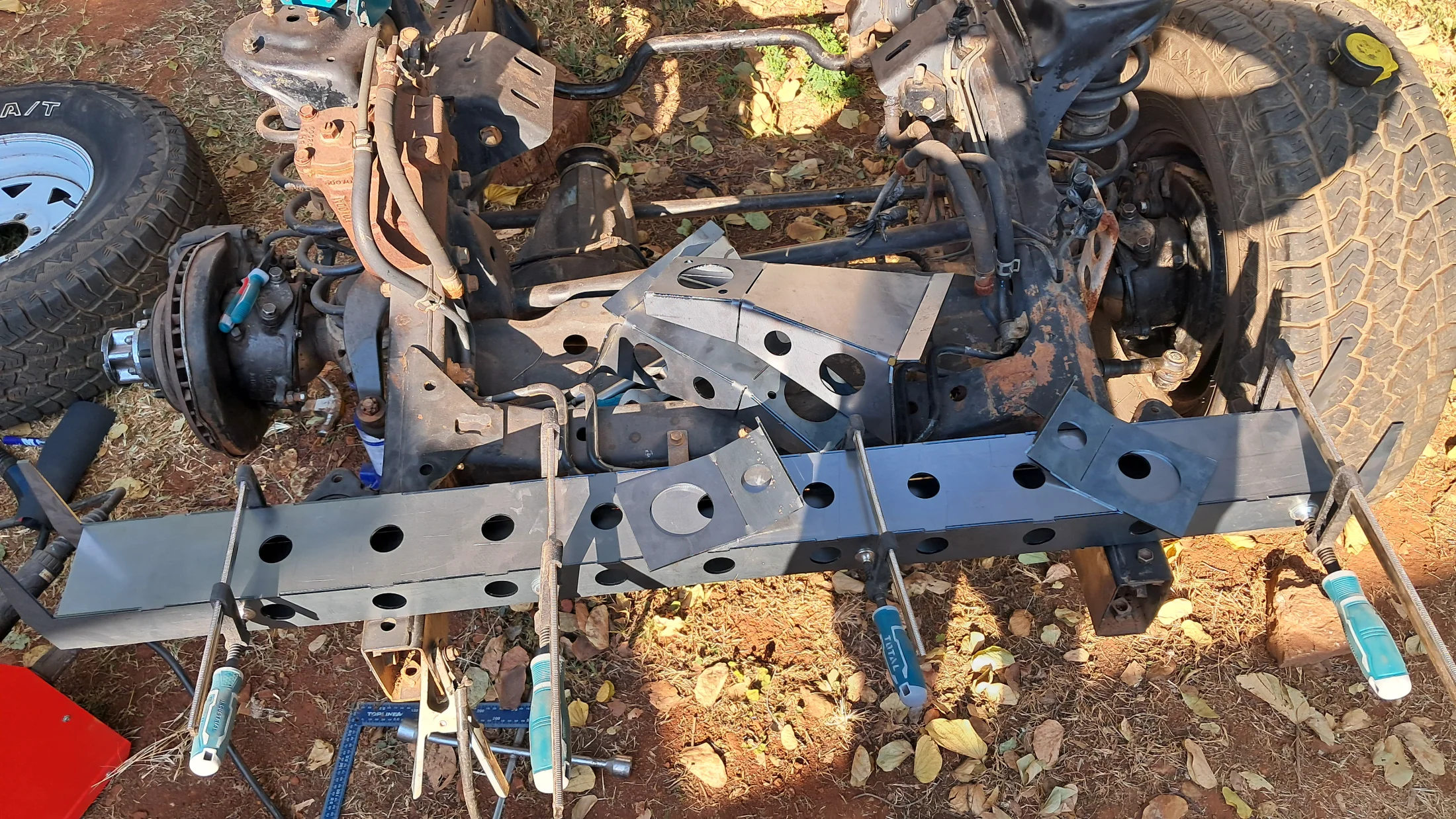

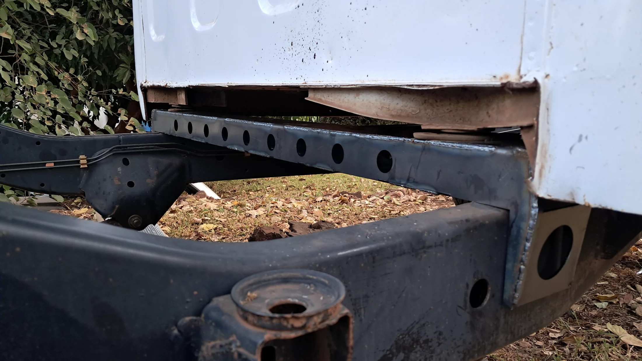

So let's do something else constructive. Body mount time.
Bending up and taking the mounts.
Decided to go with a cross member to pick up the rear mounts. Will add a bunch of strength, and also give me options to mount to for future plans.
Then it's just a case of burning them in.
Front passenger mount.
Then the rest
Now I just need to cut the old body mounts off. But at least that's another big job done.

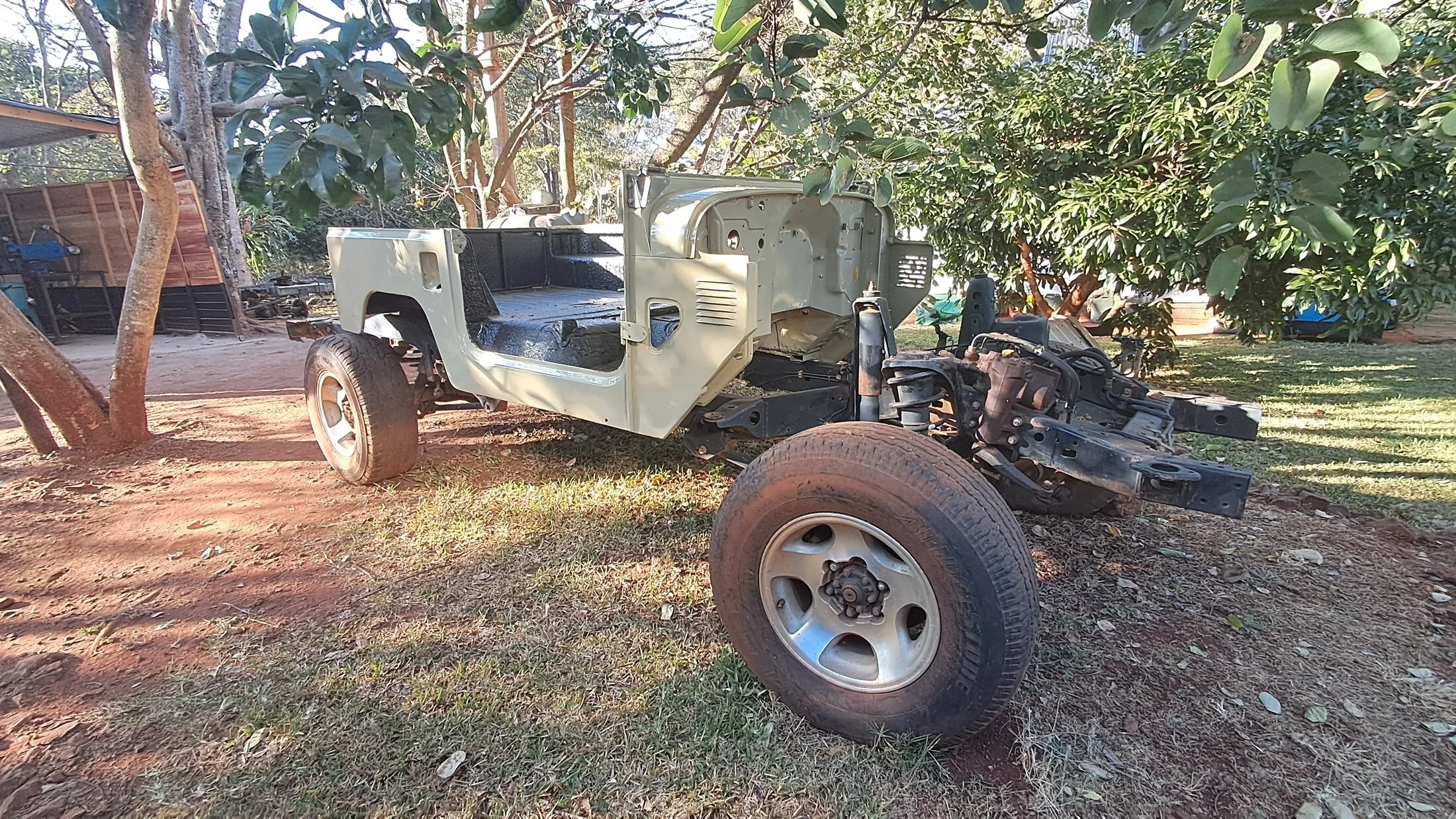

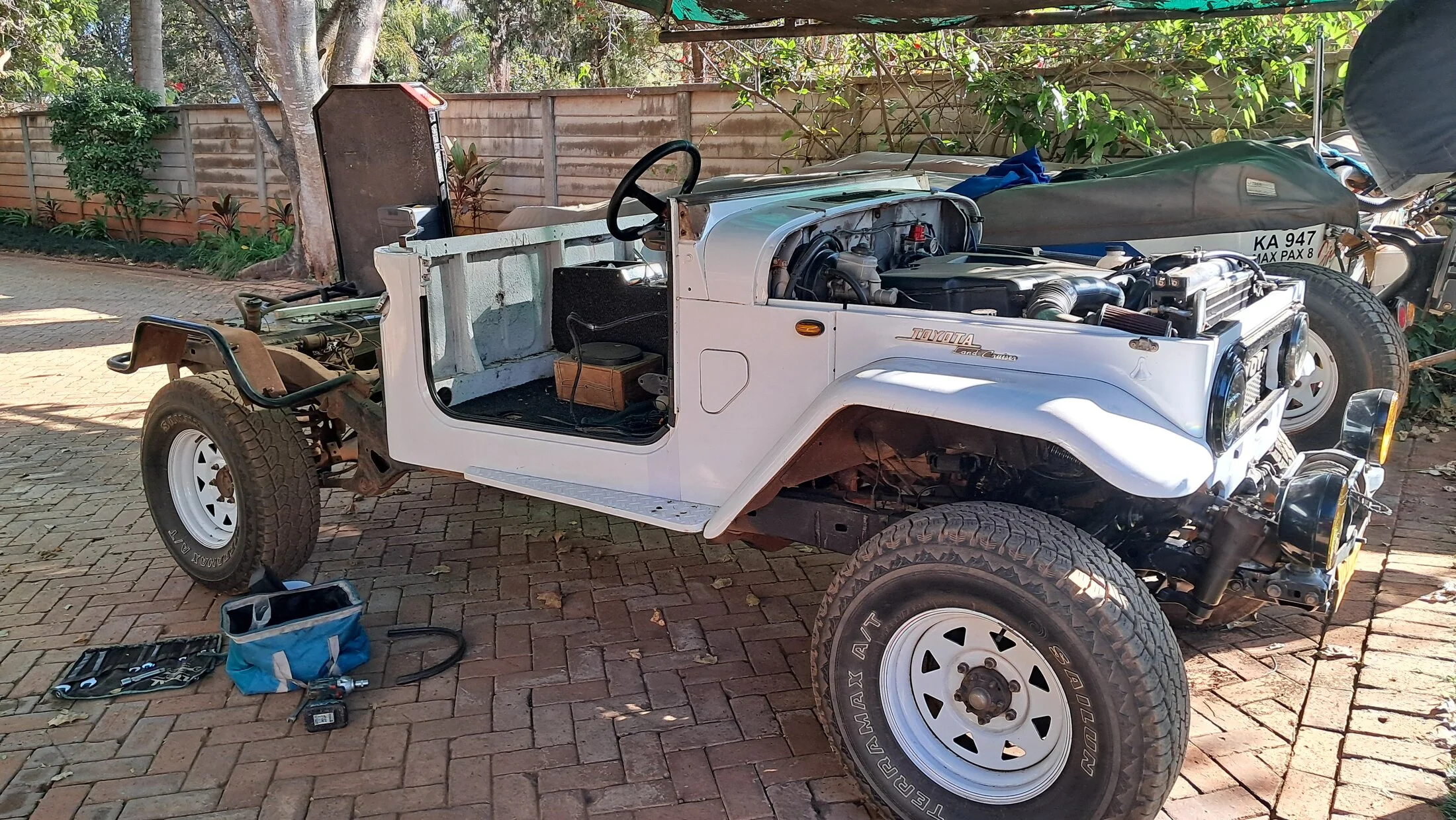

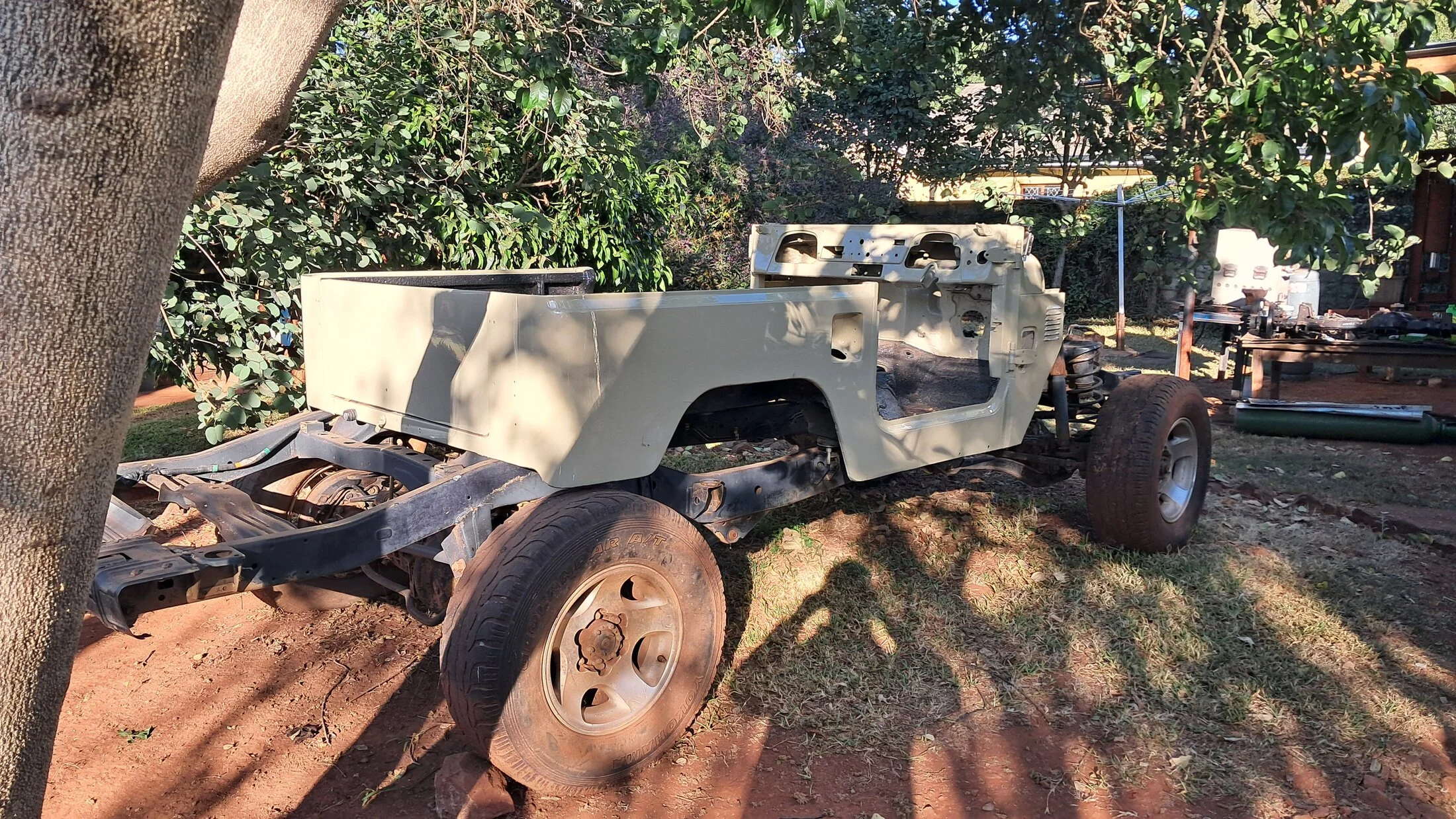

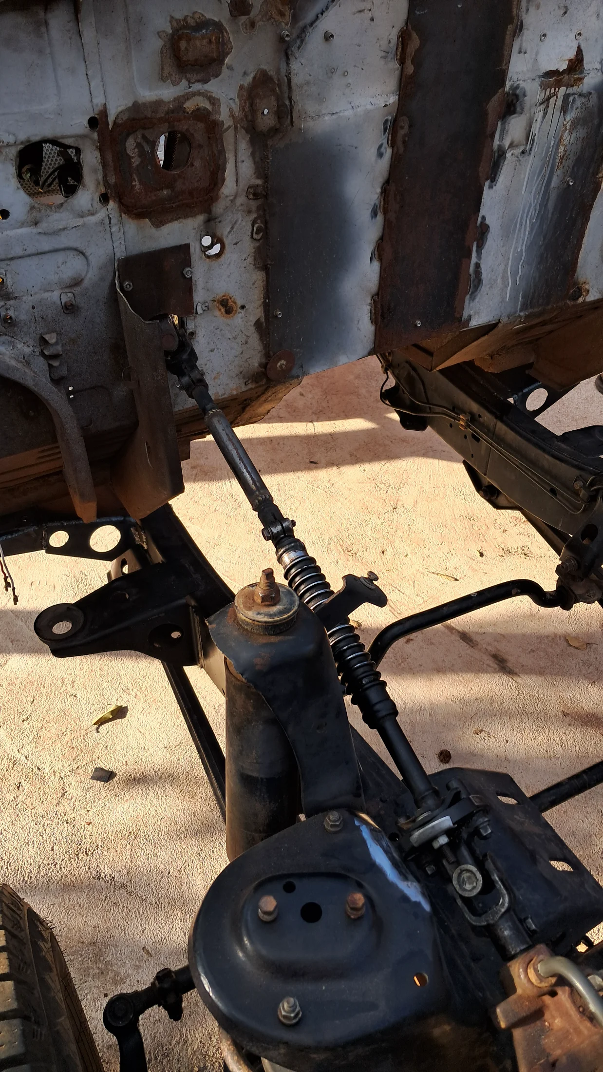

Well now that the body is in its place, all we need to do to move it workshop is sort the steering shaft out.

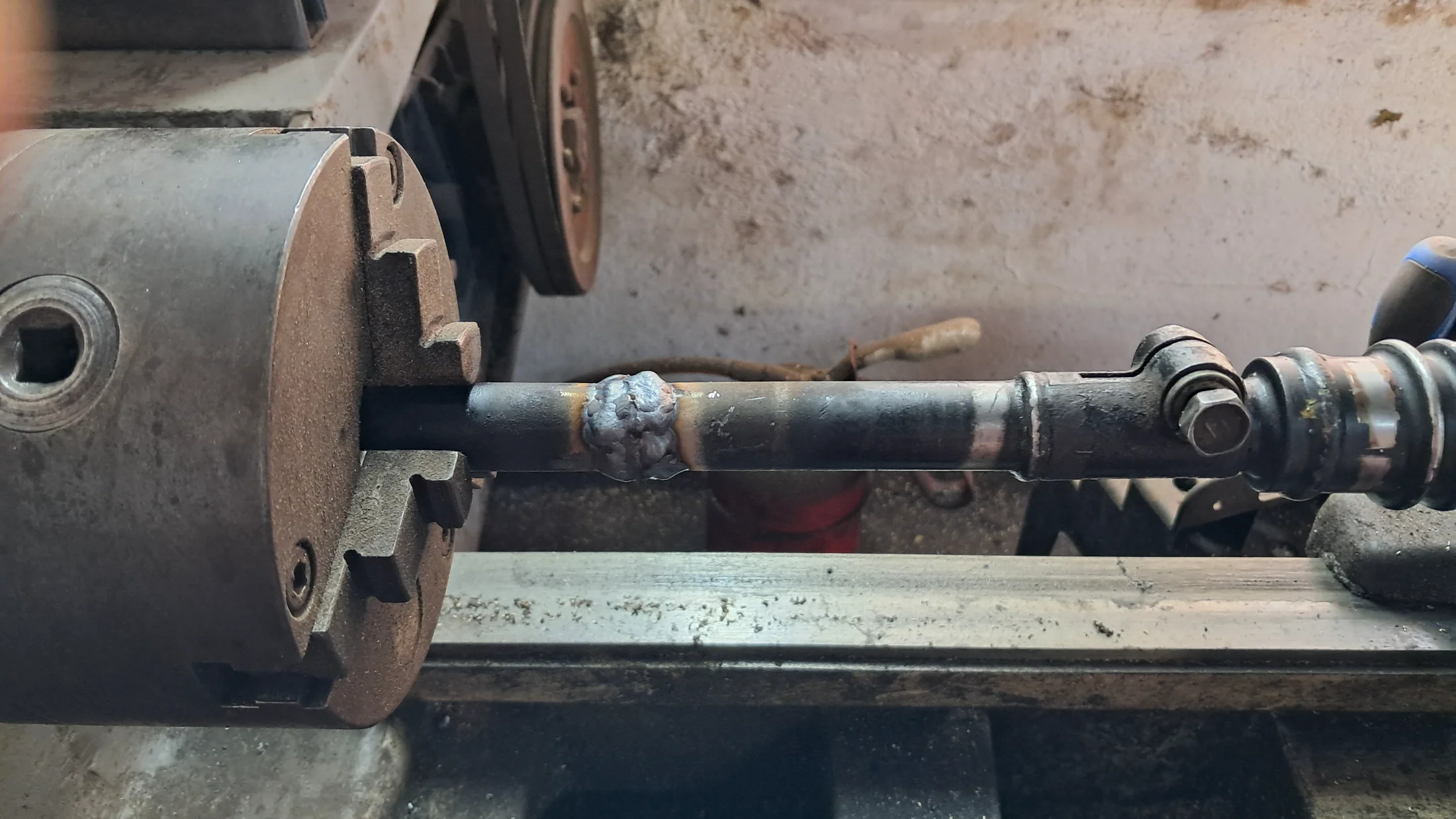

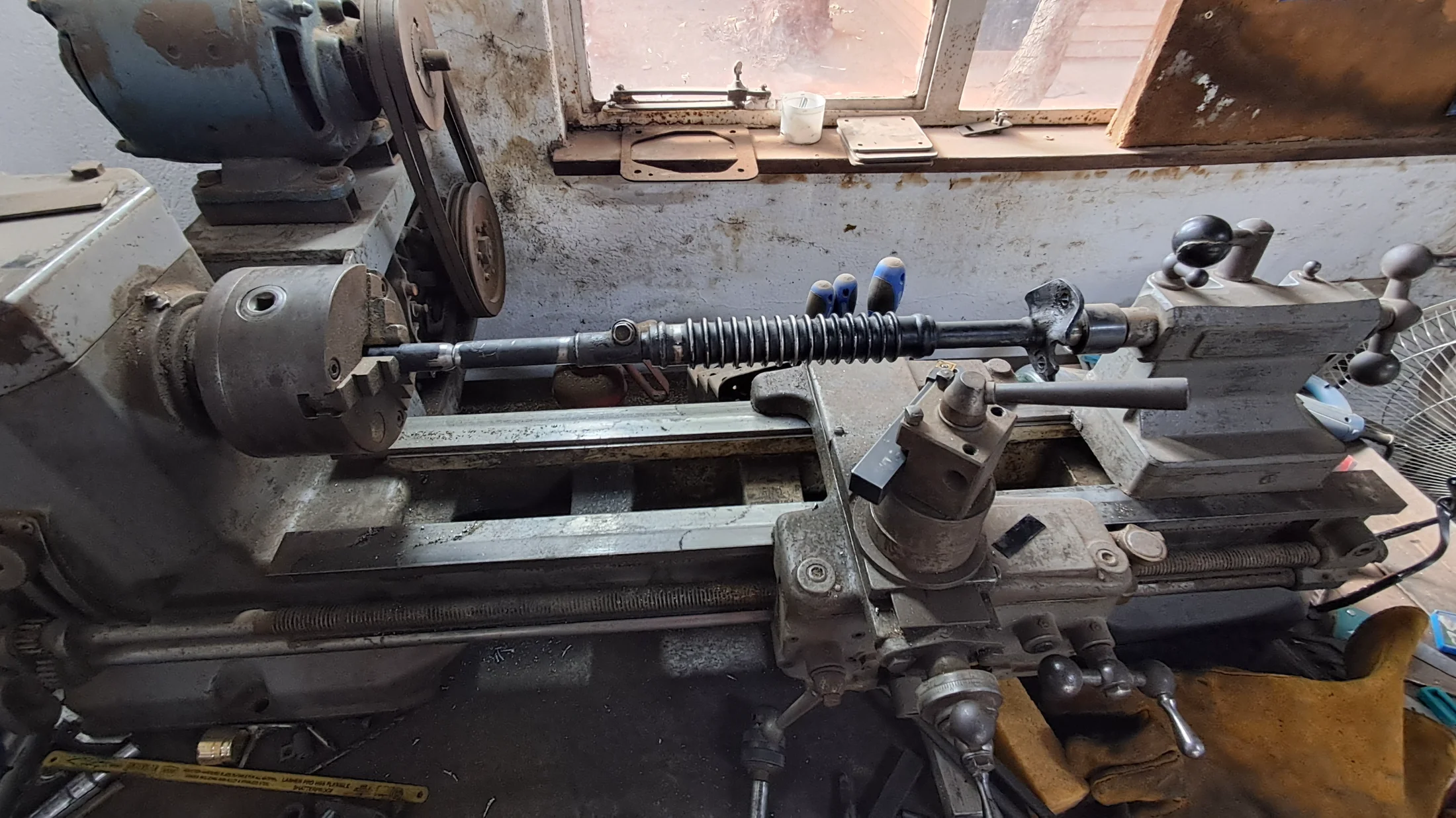

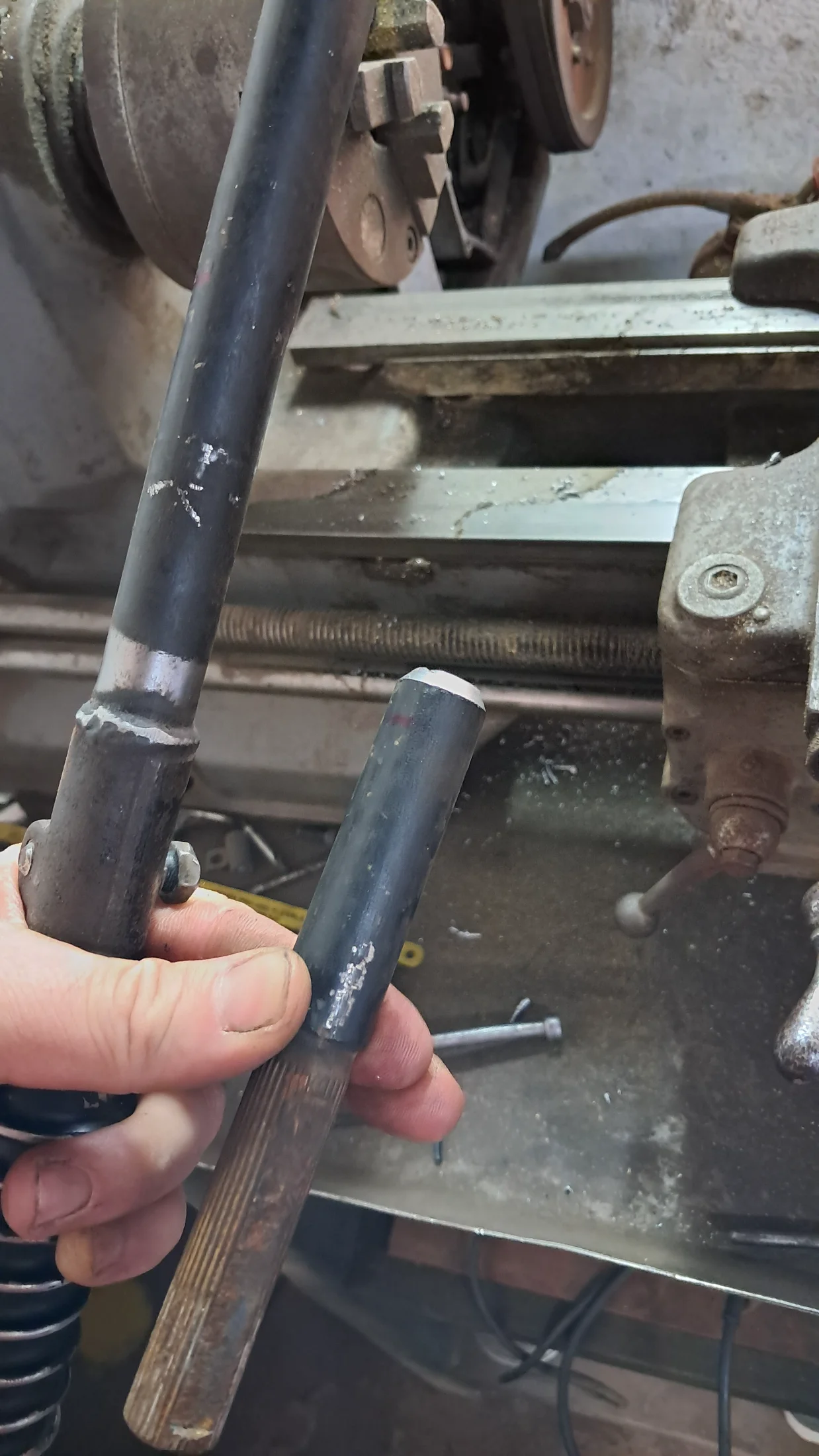

On the previous version of the build, I had to lengthen the shaft, so it had 2 welded joints in it. Now, I did these properly, and there is zero evidence of wear and tear.
But you know when your driving, and a thought pops into your head, like, "i wonder how well those welds on my steering shaft are doing?"
Ja, I've had that thought a few times. And I've given a lot of thought as to how I would make it stronger. So nows my chance.
First things first, let's trim the shaft to the length that's needed and chamber the ends.
Now let's get it all trued up in the lathe
Time to weld. Maximum penetration and multiple passes to ensure no porosity. Did this while turning the shaft very slowly in the lathe.
Then turn it all back to nice and even.
Now it's time for my plan to strengthen it...

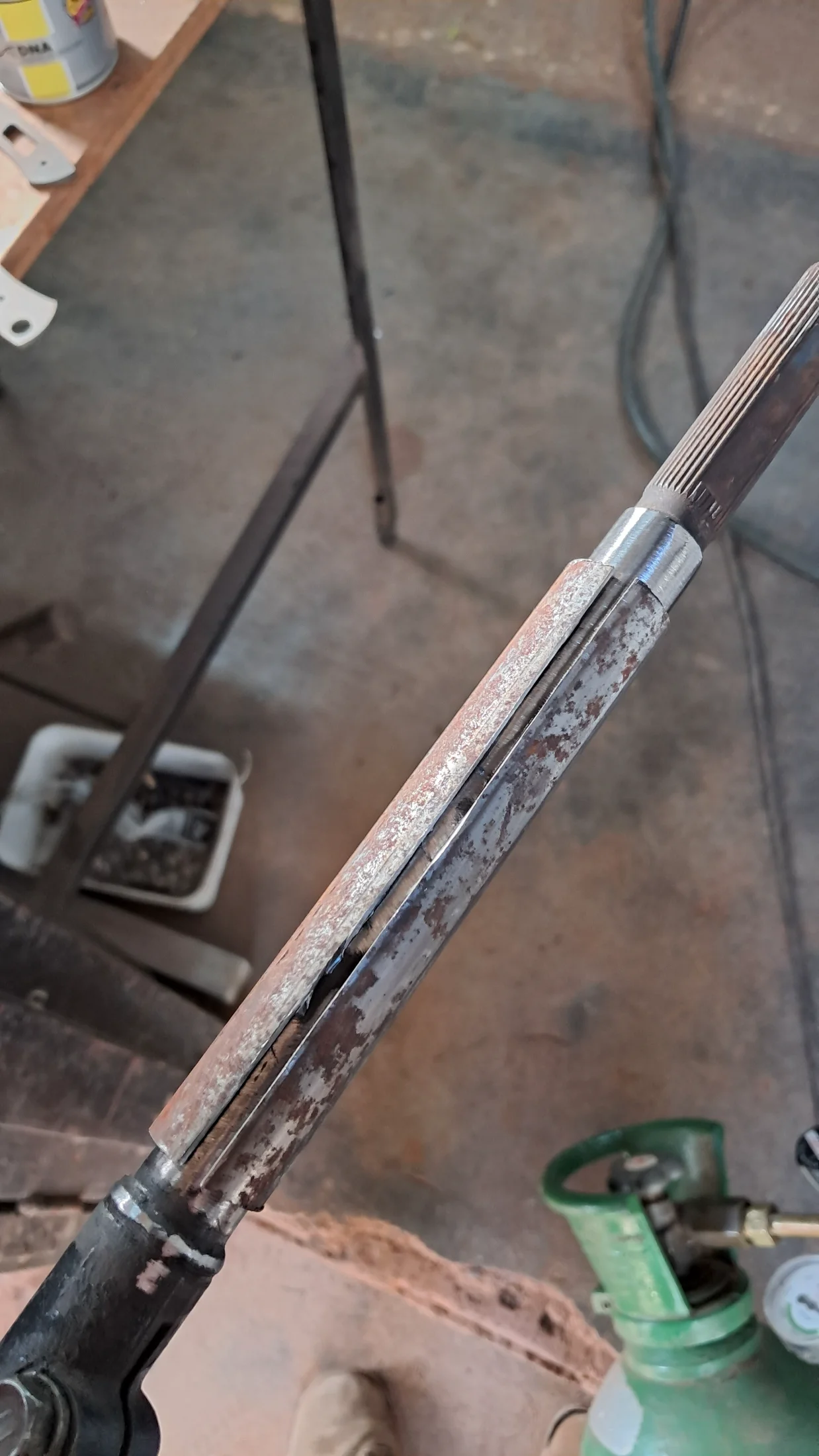

I cut a sleeve out of 2mm tubing, and slit down the middle of that.

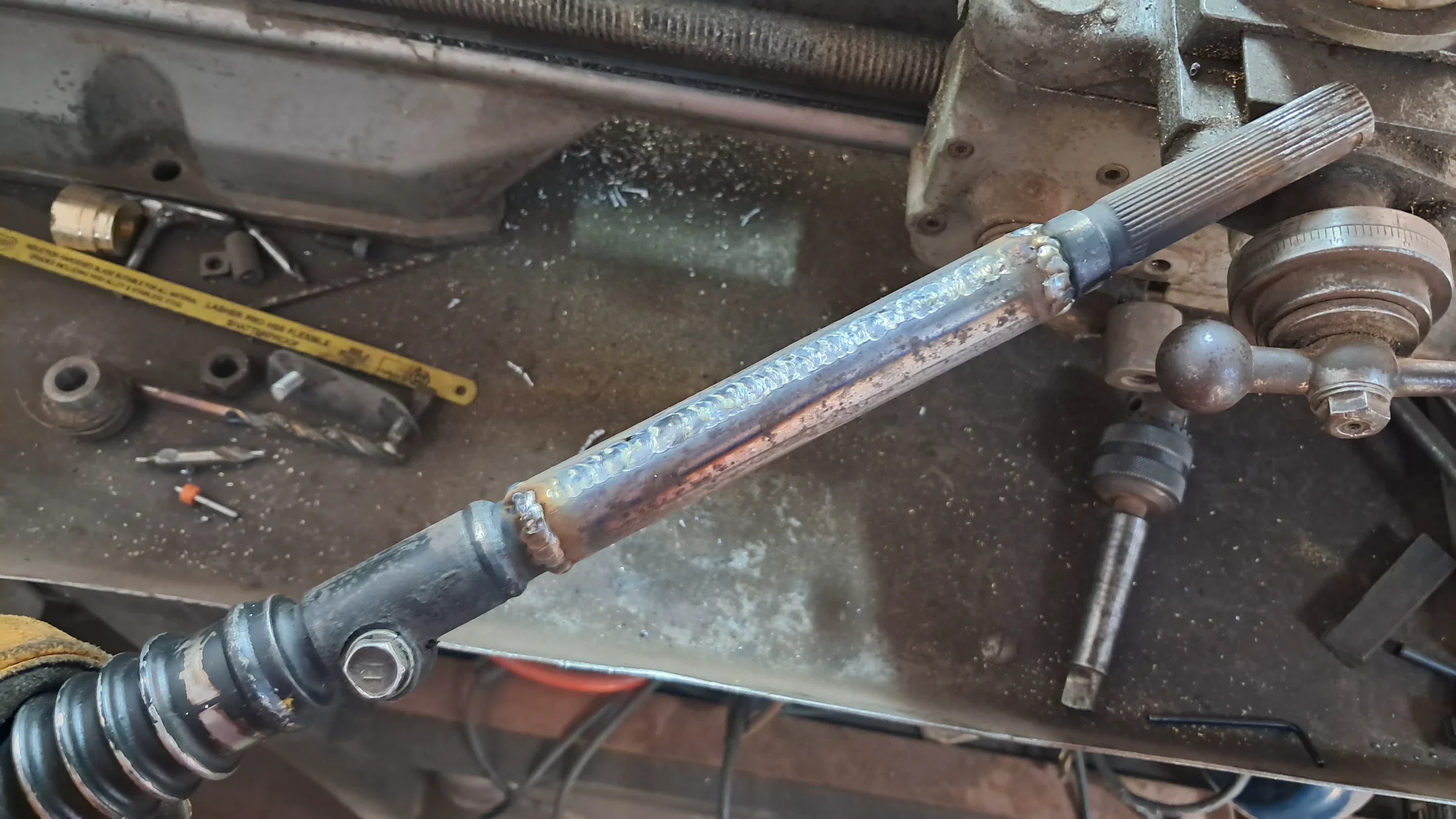

Now to weld it all back again.
Ain't no way on earth that's ever moving!
And in the vehicle.
Very happy with that now. Now other errant thoughts can distract me whilst driving!
And finally, the rig on the slab by the workshop. All ready for the next phase in the build.

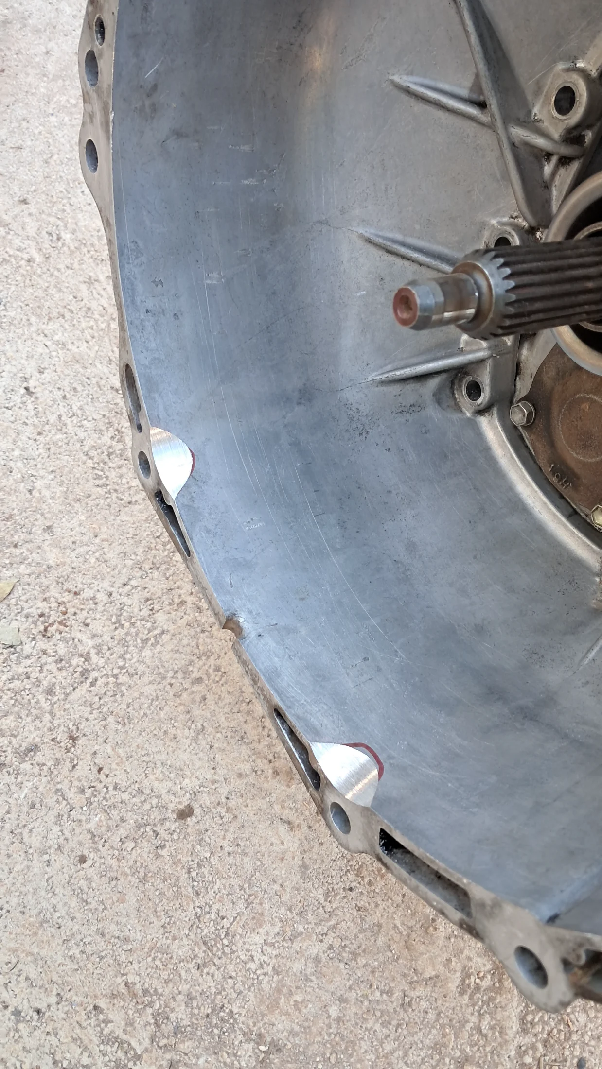

Had to clearance the bell housing just a bit on the bottom 2 bolts for the adapter plate, but other than that, went straight on
Then clutch pack, then gearbox.

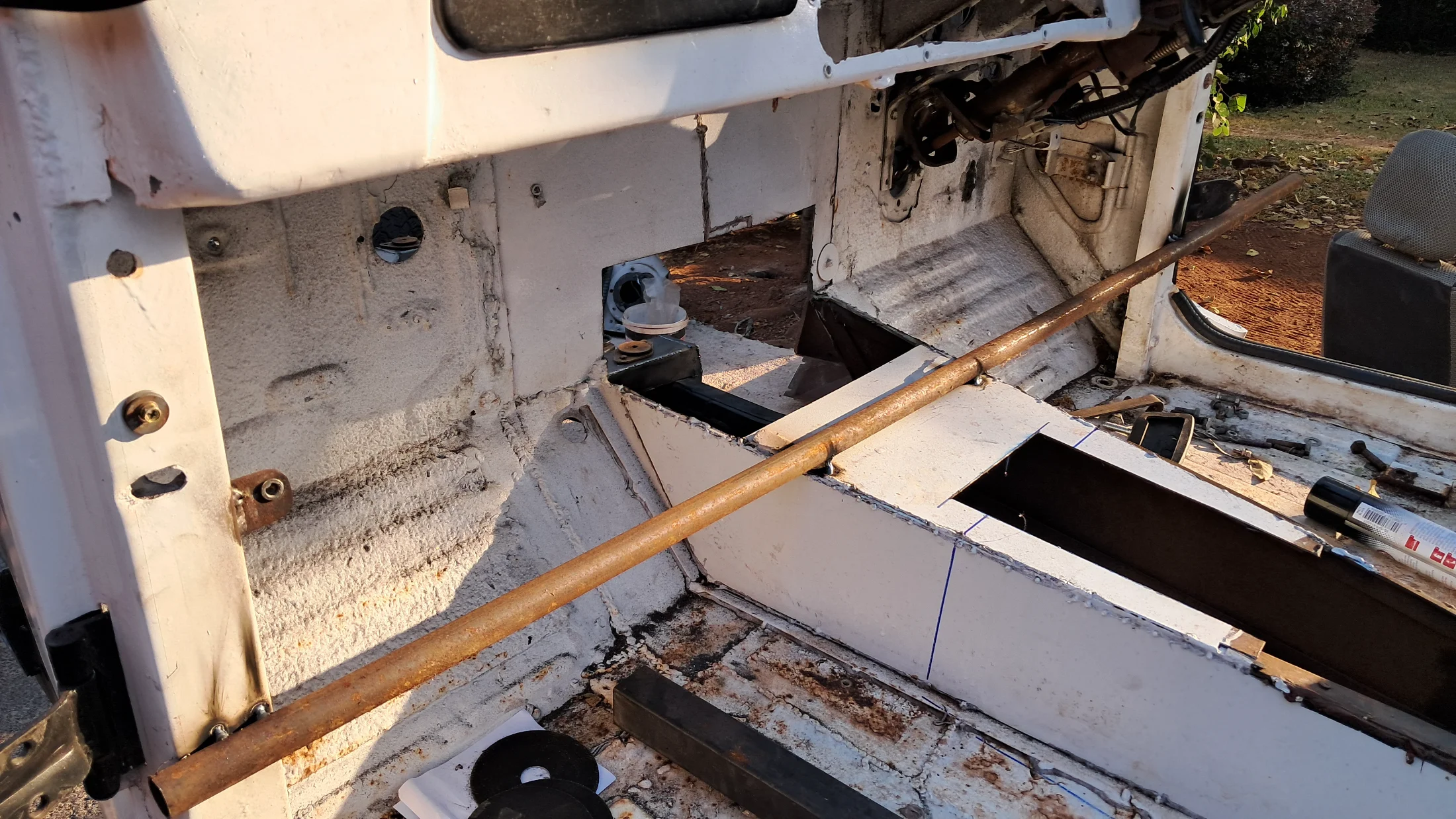

Looks like it going to be able to use the stock 80 transmission cross member and mount, which is great.
I do have to remake the trans tunnel though. Oh well. Where's the grinder at? :hillbilly:
