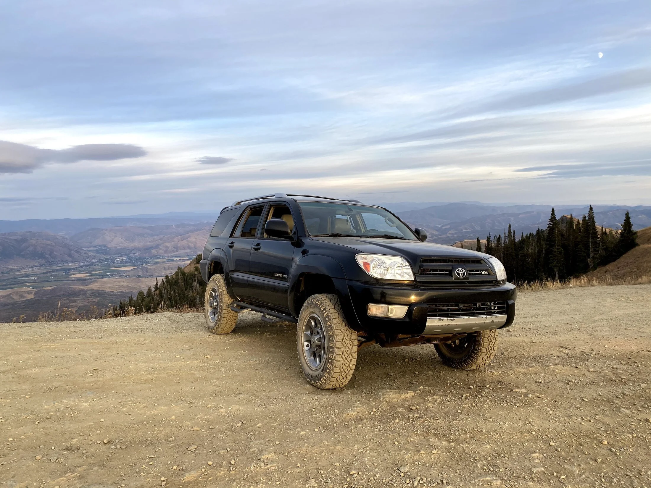

If your springs are still in good shape, you may want to look at Bilstein 5100's. They have an adjustable spring perch on the front that allows for a 2" lift on stock springs. Pair that with a set of Dobinsons or OME rear springs, you should have a decent setup.
For tires, I've run 255/75/17 Duratracs (~32"), and 285/70/17 (~33") Wildpeak AT's with good success.
-Rob
-Rob
I've been really happy with the duratracs in 255/75r17 as well. Also running wheels spacers for a little bit wider stance. They do get pretty noisy when worn down in my experience, but I've always had excellent traction in all weather on and off road.
The Bilstein 6112/5160 setup is also a really good option in my experience, and not that much more than the 5100's.
