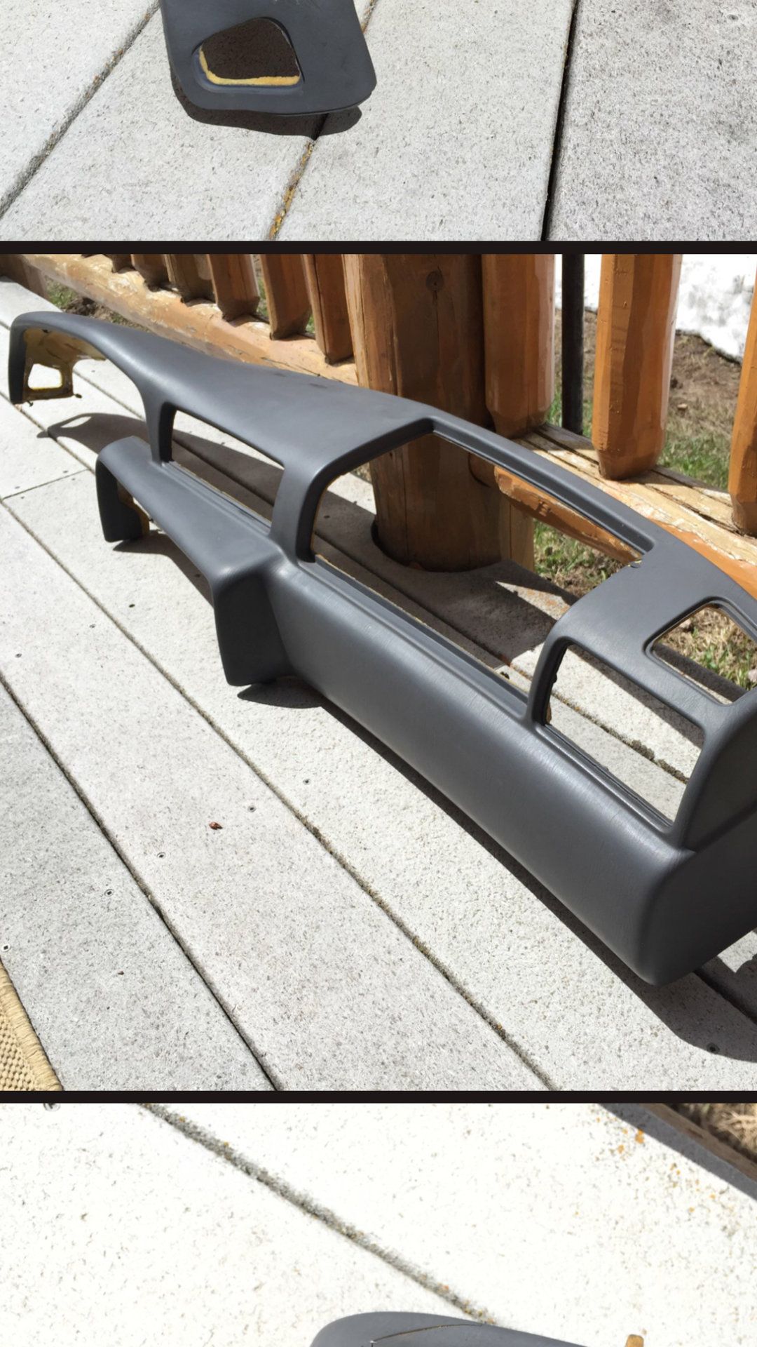

Looking for gray.
A side note, didn’t realize the pad portion could just be replaced. Up to just doing that if anyone knows a source for a gray one.
Looking for gray.
What does that mean?
Referring to this
