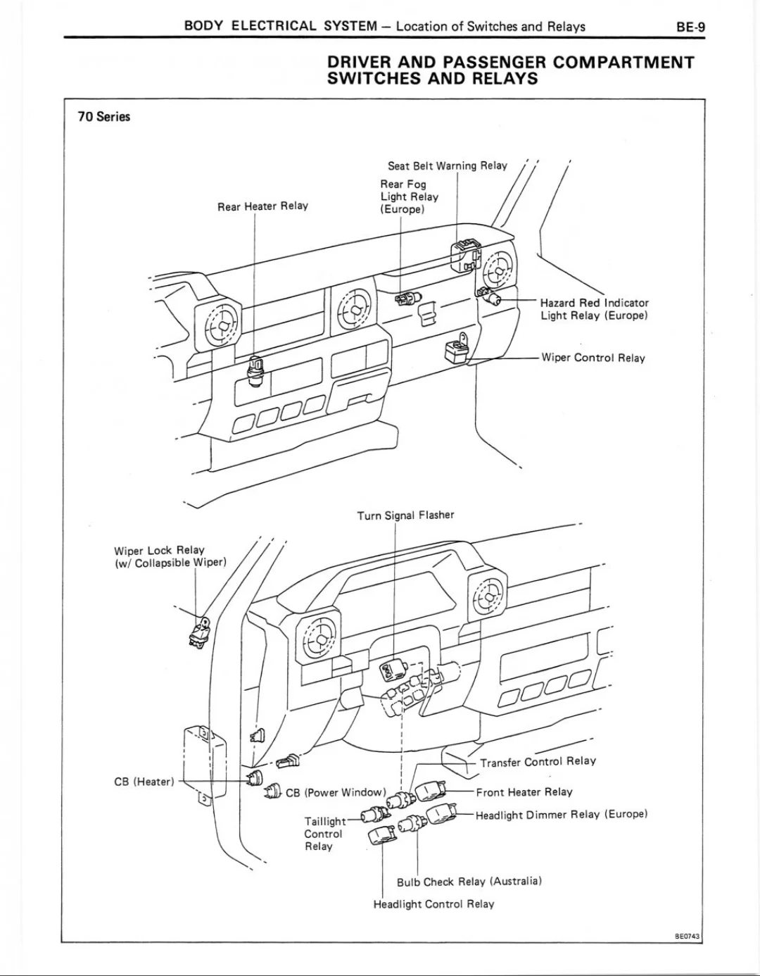

Mine just started doing this also. I haven't dug into it yet but I believe it is the charge relay, which also has the function of turning on the lights as a bulb check before starting.
Any idea where this relay is?
Mine has been doing this for more than a year!
On a 70 series it may be the one called Bulb Check Relay. Someday I plan to diagnose but haven't yet.
I should add that mine are flickering and charging as normal which is why I suspect a relay.
But for solid on, I'd be verifying the alternator, plugs, fusible links, and all grounds are solid.
