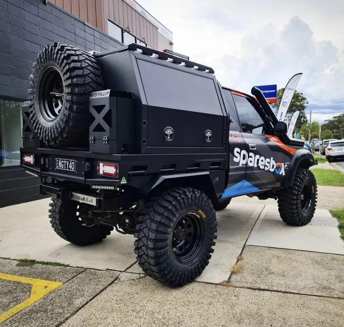

That truck is from Austtalia and it is Sparesbox Naughty 40. That build can be found on YT:
It can also be seen on 4WD 24/7 on YT,
Yea, I’ve drooled over the Sparesbox 80.
I was inquiring about the 80 I saw here in Idaho. I was hoping someone here on Mud knew about it or has the build posted on here cause I haven’t seen anything like Aussies have here in NA.

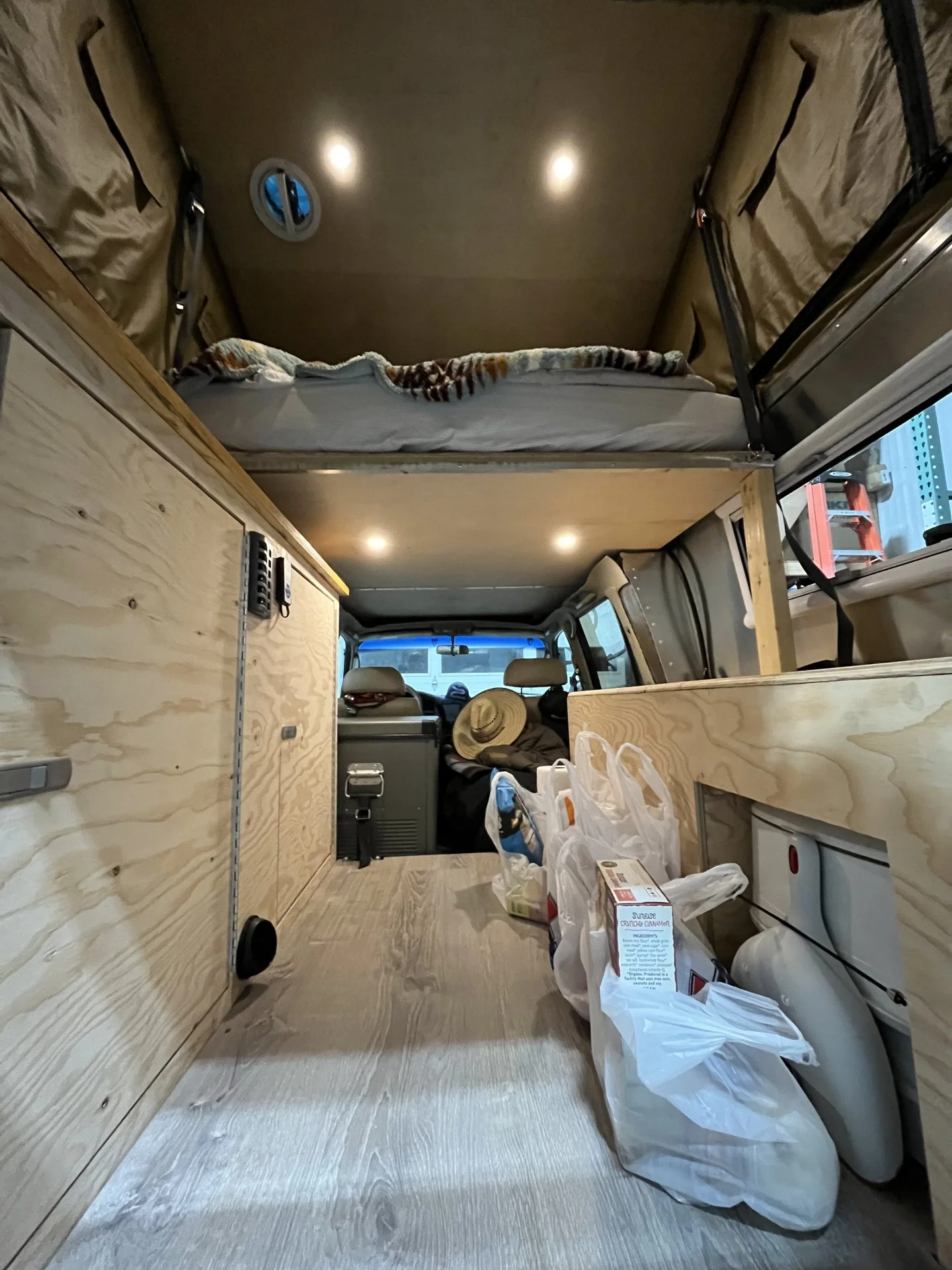

Hey Gents, yes that is my rig that you saw! The body is not wider than a factory 80 at any point but instead of following the curved wall contours the wall of the camper is vertical from the floor to around 19” and then is bent 10 degrees in for another 29” or so. Clear as mud right? So at the floor level it’s the same width but at the top level it’s roughly 20” (10” both sides)wider. The extra wall space and above roof space houses a 6” thick queen sized mattress. It is a bit taller, I cut the roof out and added a bed that hinges out of the way creating sort of a living space with ample head space. I built a hinged roof that pops up with tent sides. The standing height at the rear most is just under 8’. Also, the rear of the camper extends about 16” off of the rear cross member (the one under your bumper) but the body is cut at a 45 degree to look better and for the departure angle. I apologize if this is confusing as I’m a couple beers deep and camping out in Utah atm. Any questions let me know! My IG @rigoverland has most of the build specs.

Hey Gents, yes that is my rig that you saw! The body is not wider than a factory 80 at any point but instead of following the curved wall contours the wall of the camper is vertical from the floor to around 19” and then is bent 10 degrees in for another 29” or so. Clear as mud right? So at the floor level it’s the same width but at the top level it’s roughly 20” (10” both sides)wider. The extra wall space and above roof space houses a 6” thick queen sized mattress. It is a bit taller, I cut the roof out and added a bed that hinges out of the way creating sort of a living space with ample head space. I built a hinged roof that pops up with tent sides. The standing height at the rear most is just under 8’. Also, the rear of the camper extends about 16” off of the rear cross member (the one under your bumper) but the body is cut at a 45 degree to look better and for the departure angle. I apologize if this is confusing as I’m a couple beers deep and camping out in Utah atm. Any questions let me know! My IG @rigoverland has most of the build specs. View attachment 2909101

You’re more than welcome to come check it out when I get back! I would say the initial cut is definitely a little frightening, it would be more so if your rig was nice. I specifically bought a beater because I really didn’t know if I could pull it off, I didn’t want to buy something nice, cut the rear off and end up with a 80 that was worthless lol. The truck has some rot and the motor was shot. The problem was, when I started to get to the point with the camper that I was pretty sure I could finish it I had to do something about the motor, so I did an LS swap! Not as easy and cheap as people make it out to be! The whole build took me around a year and a half but if I didn’t have to do the motor swap it would definitely be a lot faster obviously. I know a guy from Bozeman is about to start a chop as well, his will be a bit different sounds like. You should do it!
