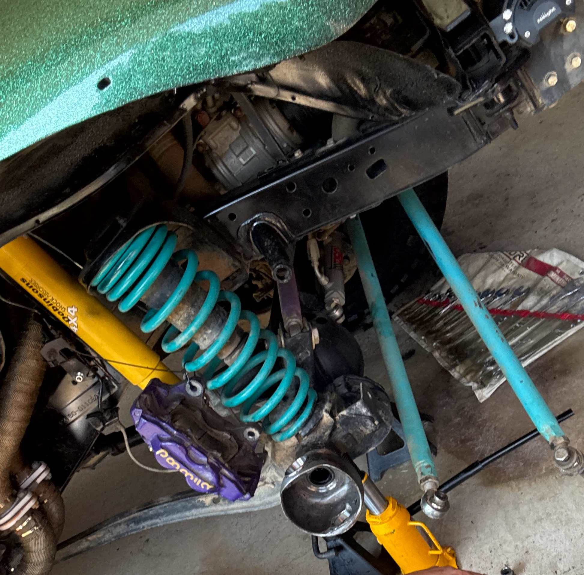

3. I replaced all seals, gaskets, bearings and races in the front and rear axles. I also installed brand new spindles on the front axle.
5. Lastly I moved all my overlanding gear onto the truck.
- I did not replace axle seals on the rear as it was not needed.
- The front axle I rebuilt without removing the entire birfeild housing and put it back together but when I went to change the front diff fluid, to my horror it was filled with grease. So i re disassembled the axle and did the birfeilds too with axle seals. I saw no diff fluid in the birfs and there seems to be less grease in the diff after flushing it again. I will note the front right cv joint and axle need replacing next time in there. I pushed the axle seal in to its second slot in hopes of preventing another leak where the axle was worn.
- I also had new hubs to install but had the wrong seal puller. This needs done next time I am in there as well.
