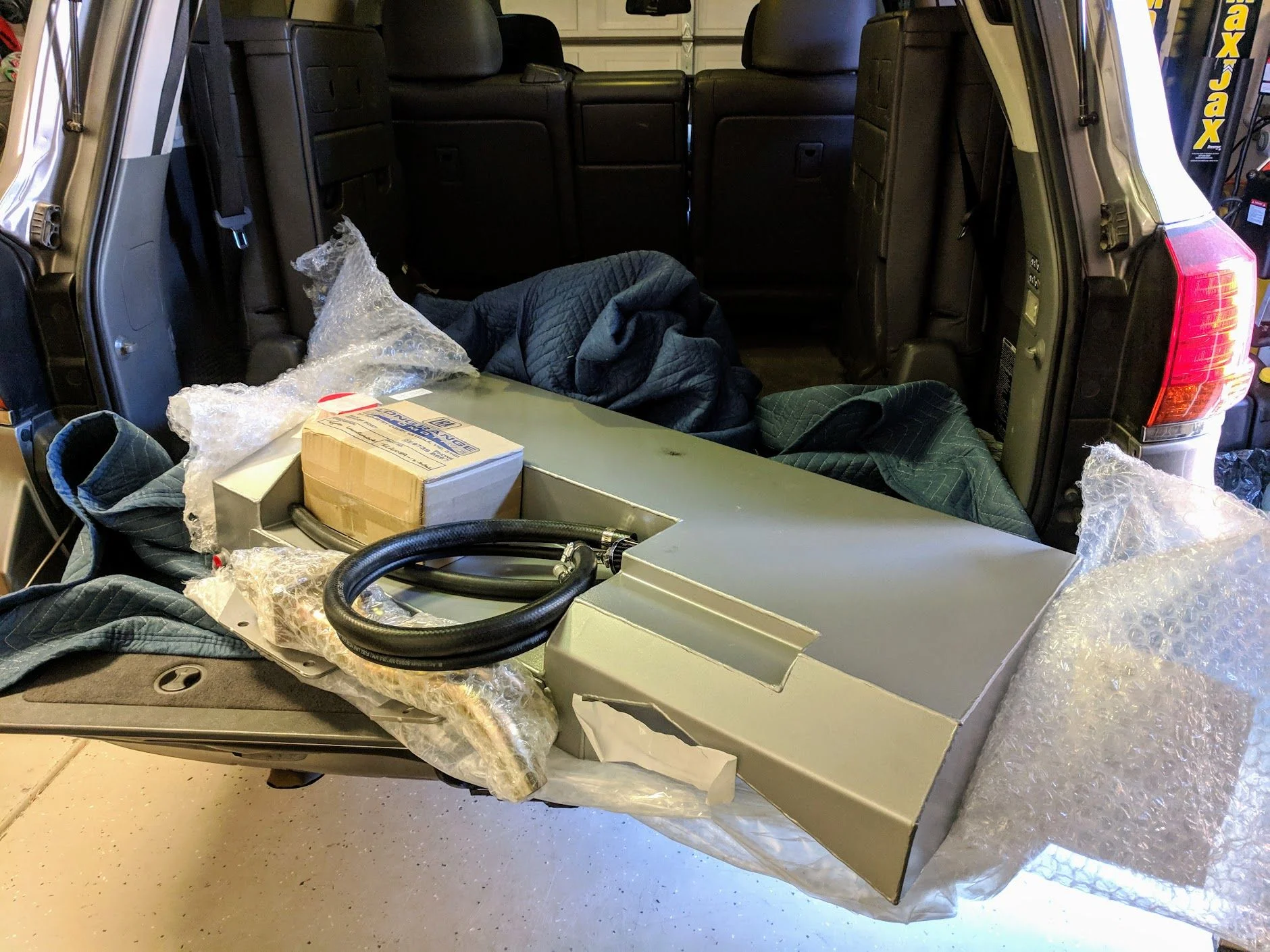

Onto the baseline pics. 12.5 gallon tank:

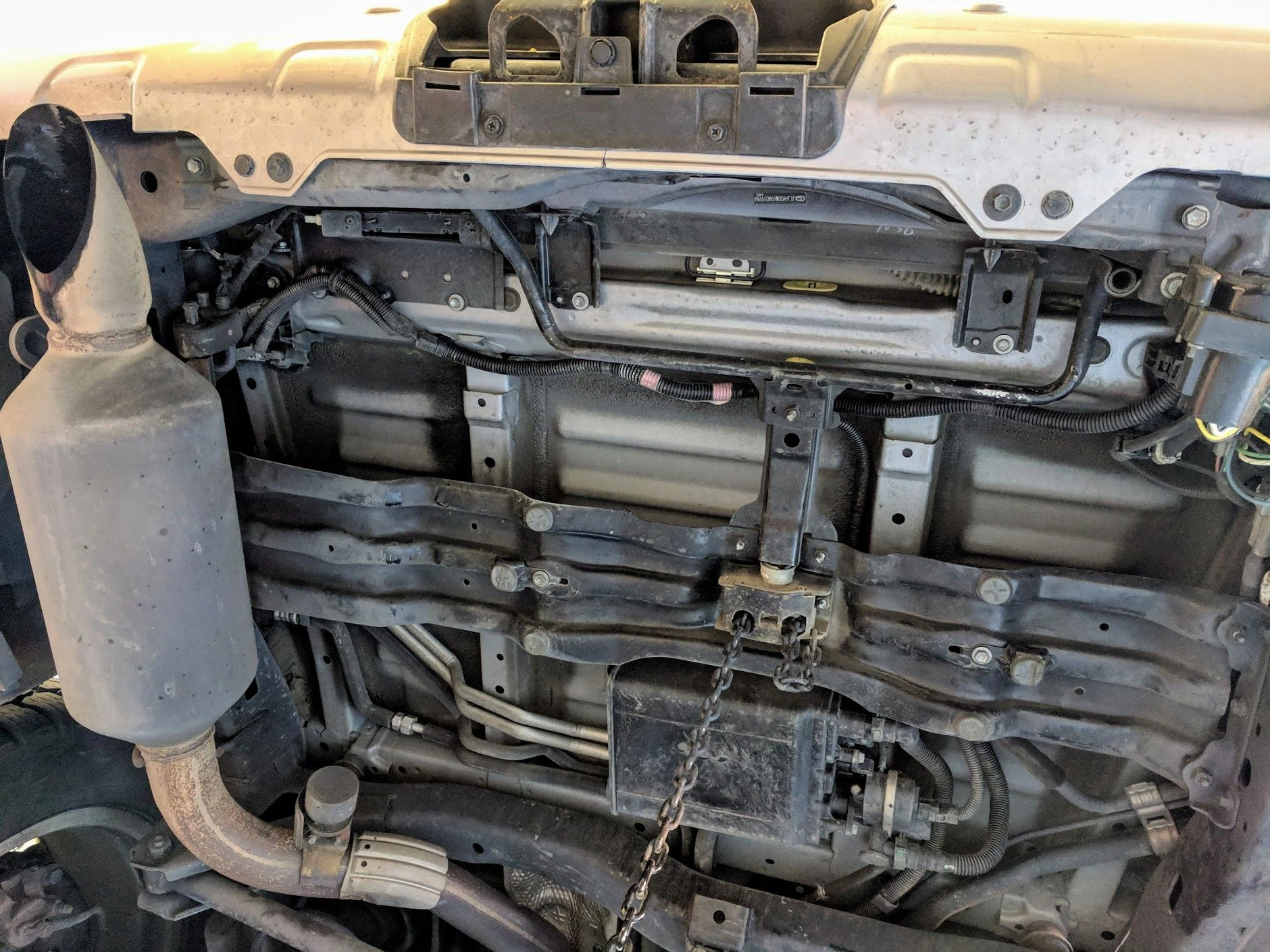

Spare Tire void
Filler neck, AHC pump/resevoir area

From underneath. The LX mechanical's, at least where the aux tank location is concerned, is identical to the LC. The only extra wiring loom that may need to be unclipped for some extra room is where the tow harness receiver is located at the very passenger rear of the frame. This loom goes to the AHC tank/pump under the rear fender.

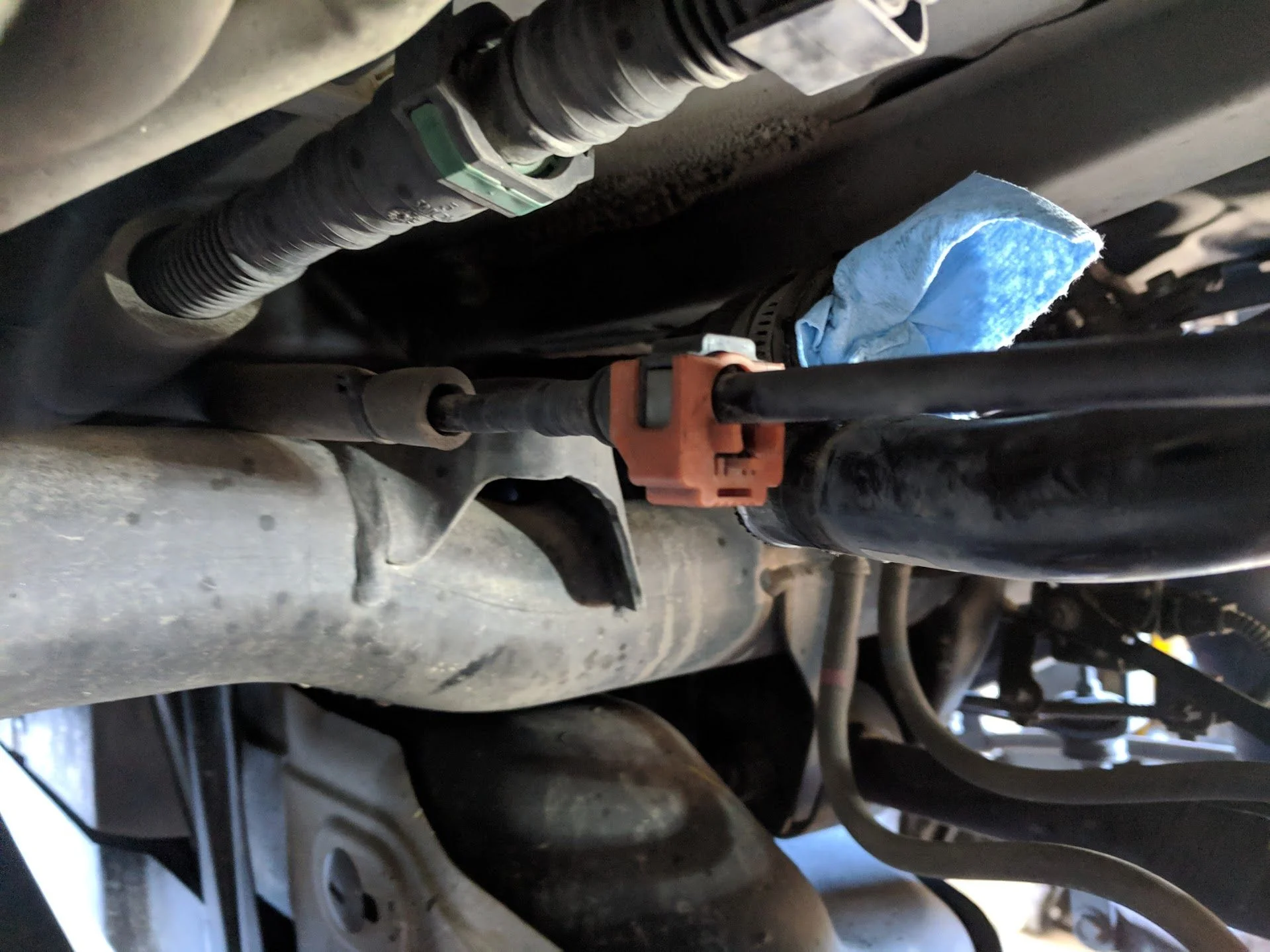

This brown clip for the 1/4" breather line from the filler neck was a bit sneaky. For the next person. The clip is really just a safety cage. Slide it downwards. It exposes the gray buttons at the either side which is the real release. The brown cage masquerades a common vacuum type fitting underneath.
The piece-de-resistance fits. With very minor adjustments that is. Whew!
Slight interference at the two marked spots.
EDIT: Just rotate the stock mounting bracket counterclockwise a few degrees.
