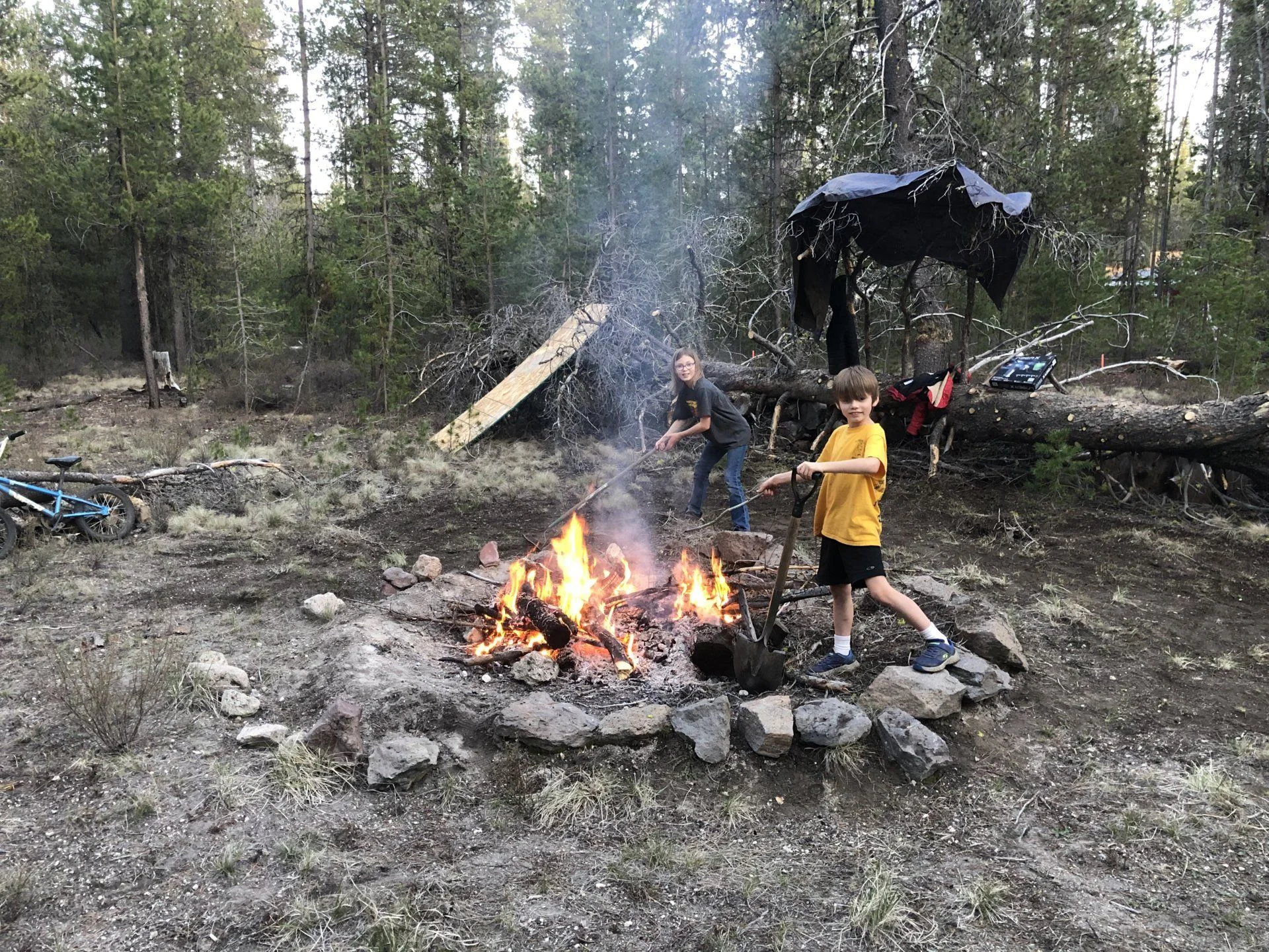

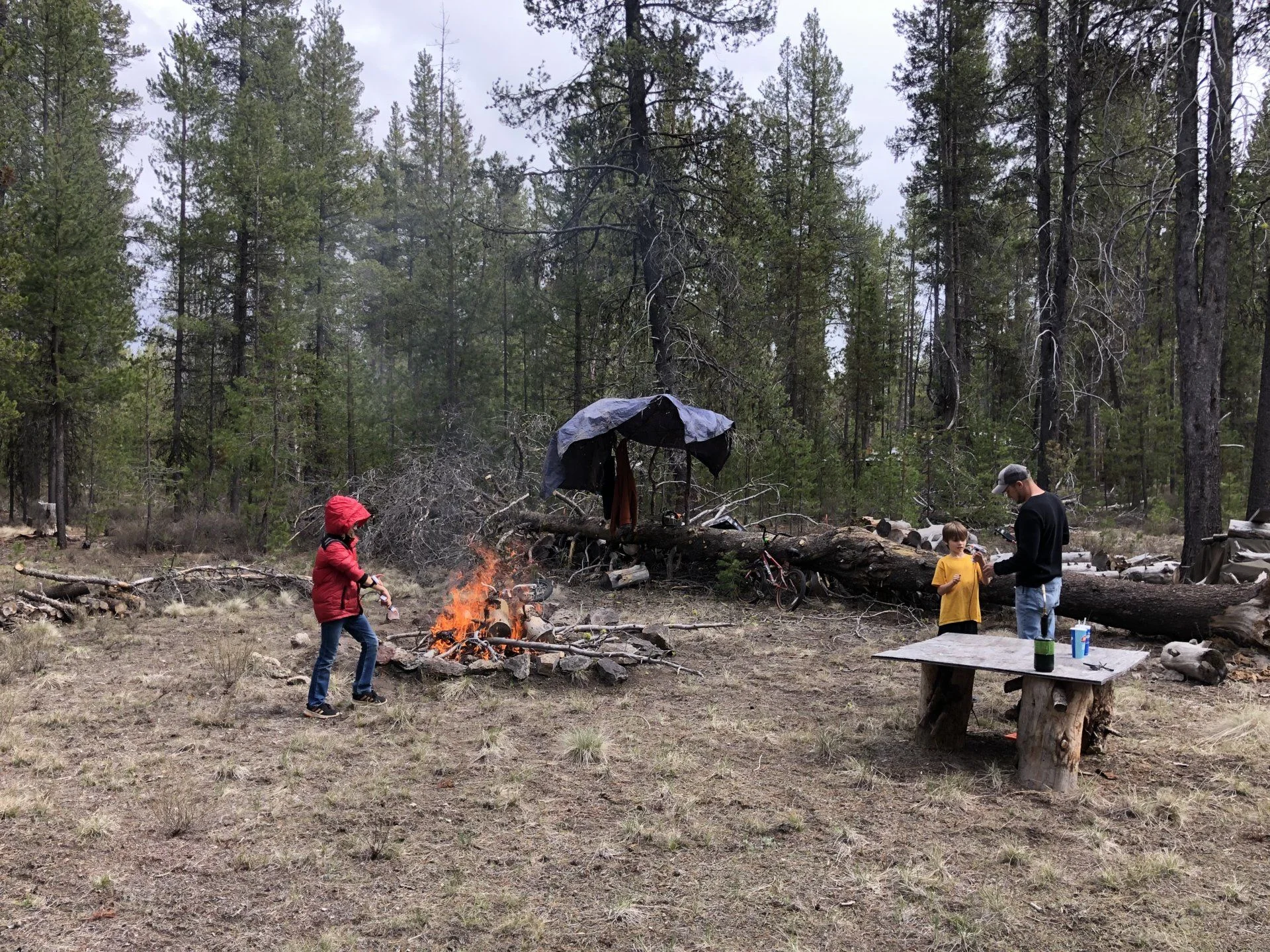

There’s already a nice open campfire area.

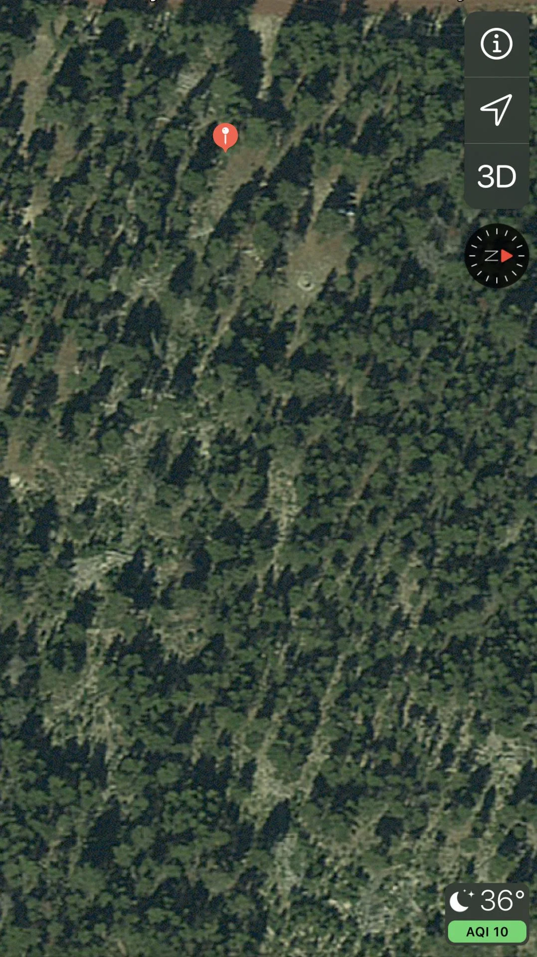

This whole picture is the property.

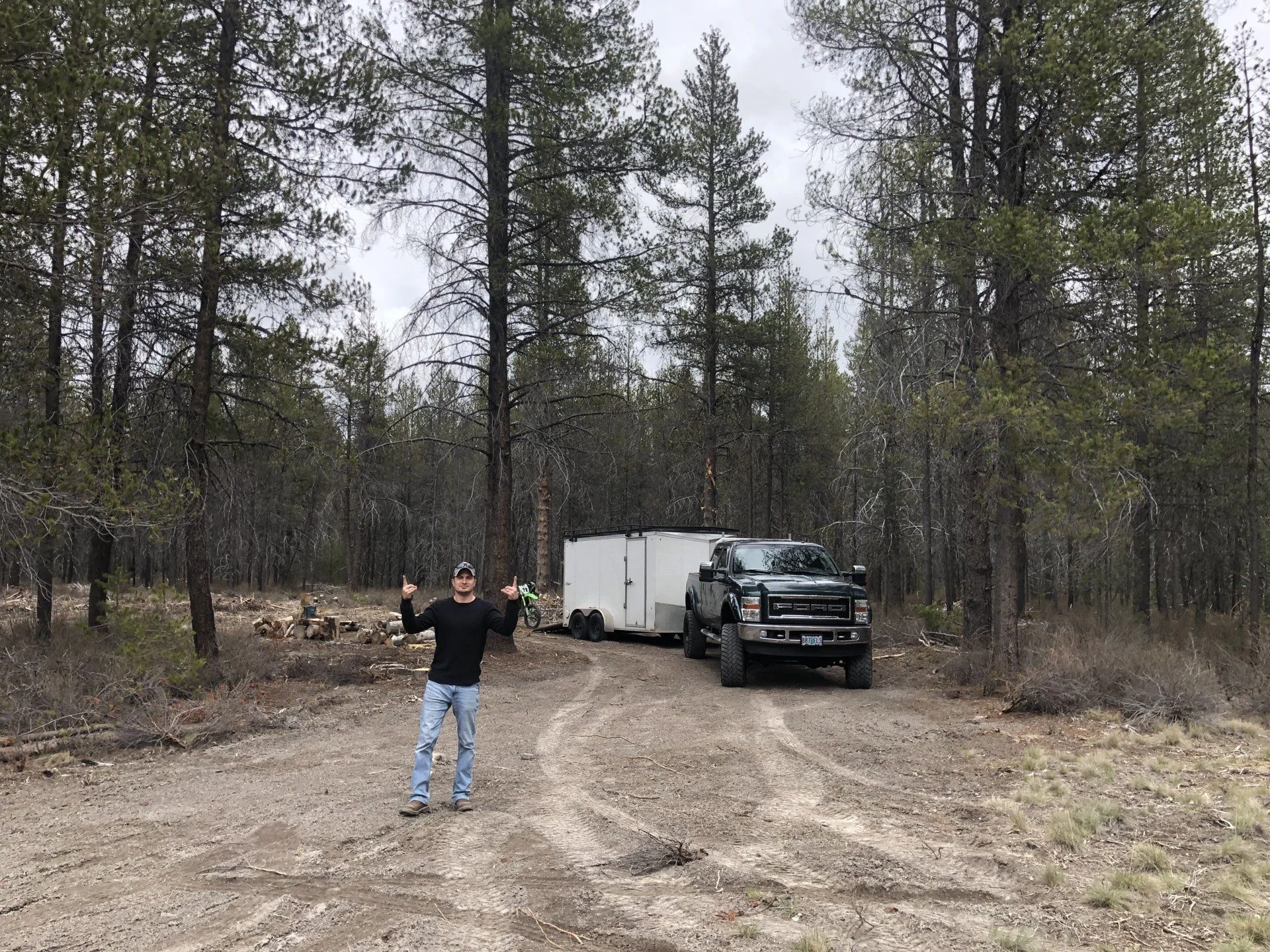

Made it to the Crater Lake property
My buddy Travis at his lot
The new lot with the well

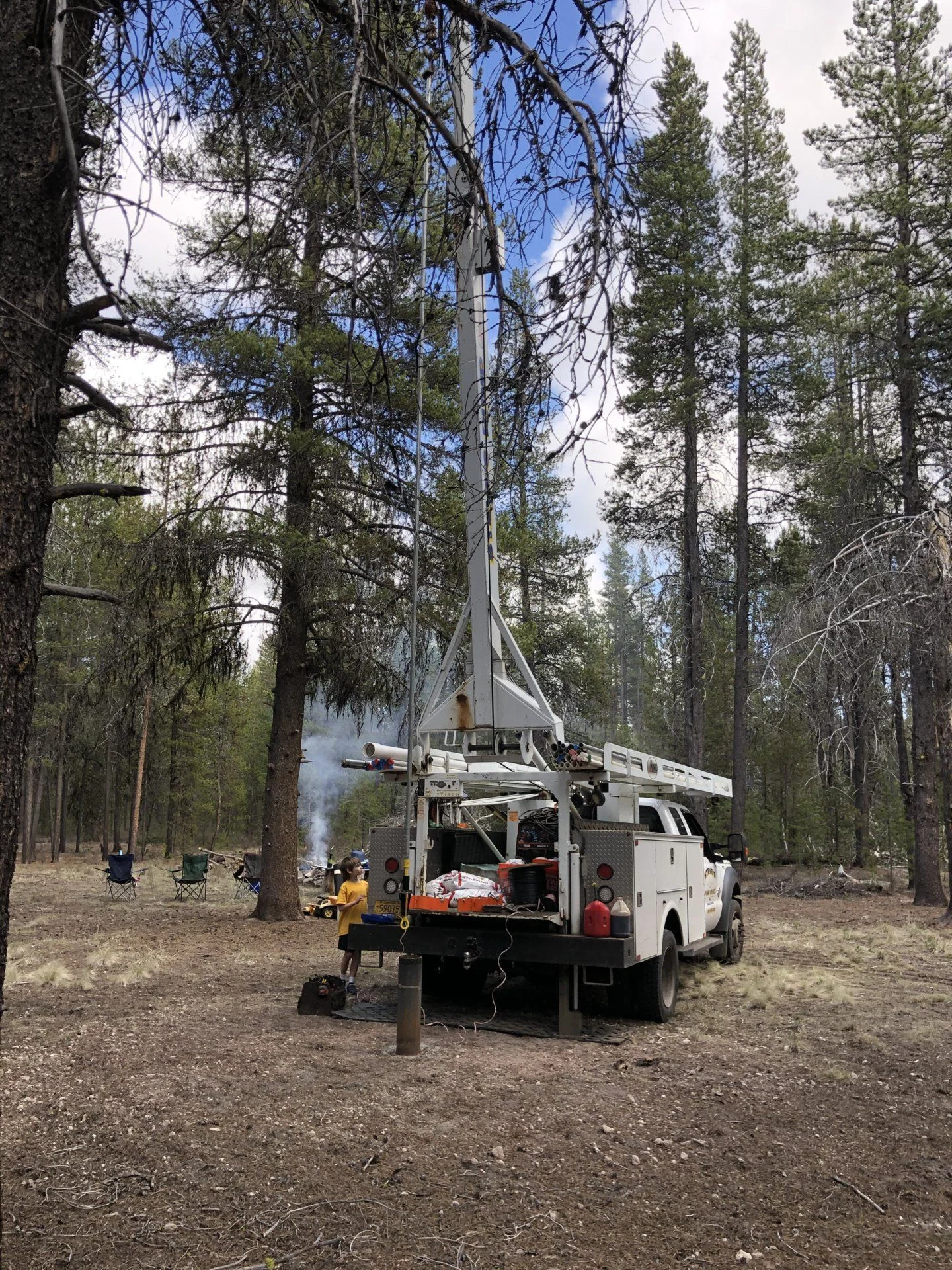

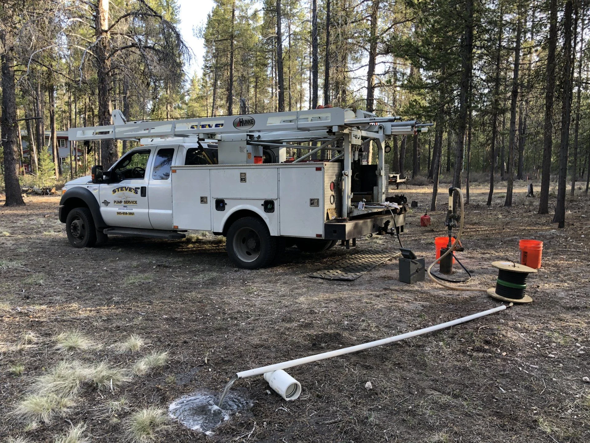

Setting up and pump hoist on the well.

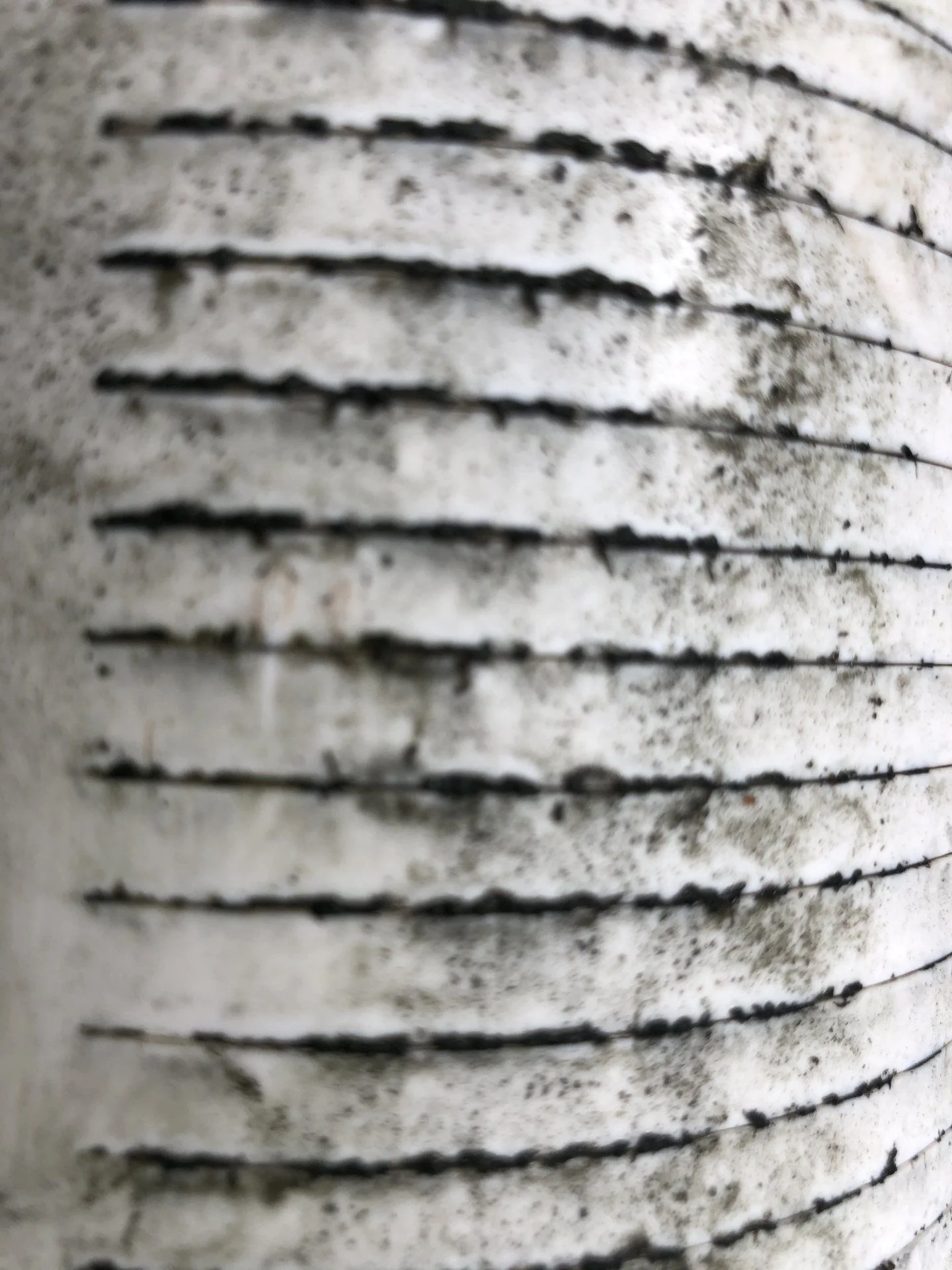

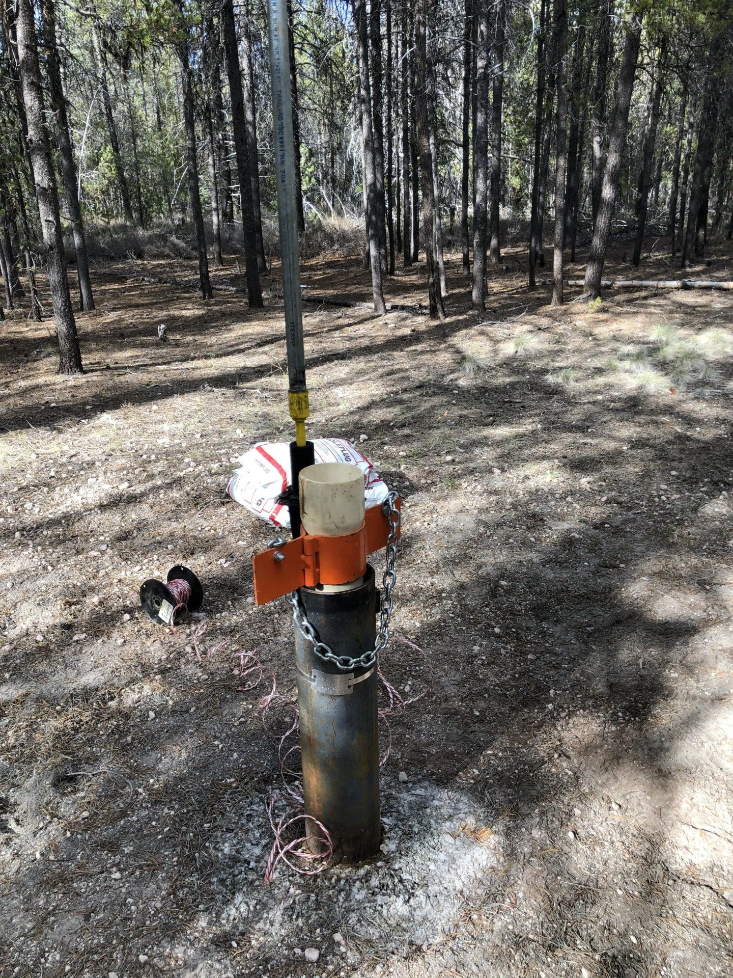

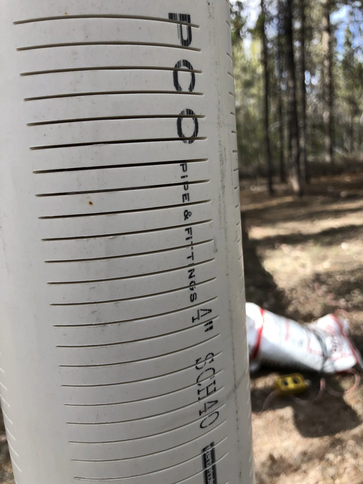

The well driller set the PVC liner at ground level. I wanted the well outside of a building so needed to cut the liner lower for a pitless adapter. Decided to lift the liner and check the PVC screen.
Here’s the 10 slot screen
I brought 30 slot screen for better flow rate so decided to replace the screen while I was there.

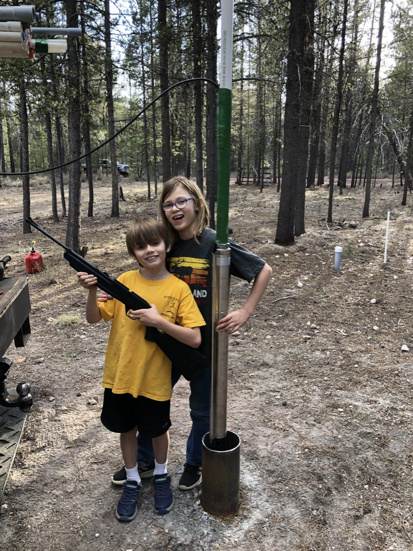

Set the PVC liner and installed the submersible well pump with the kids.

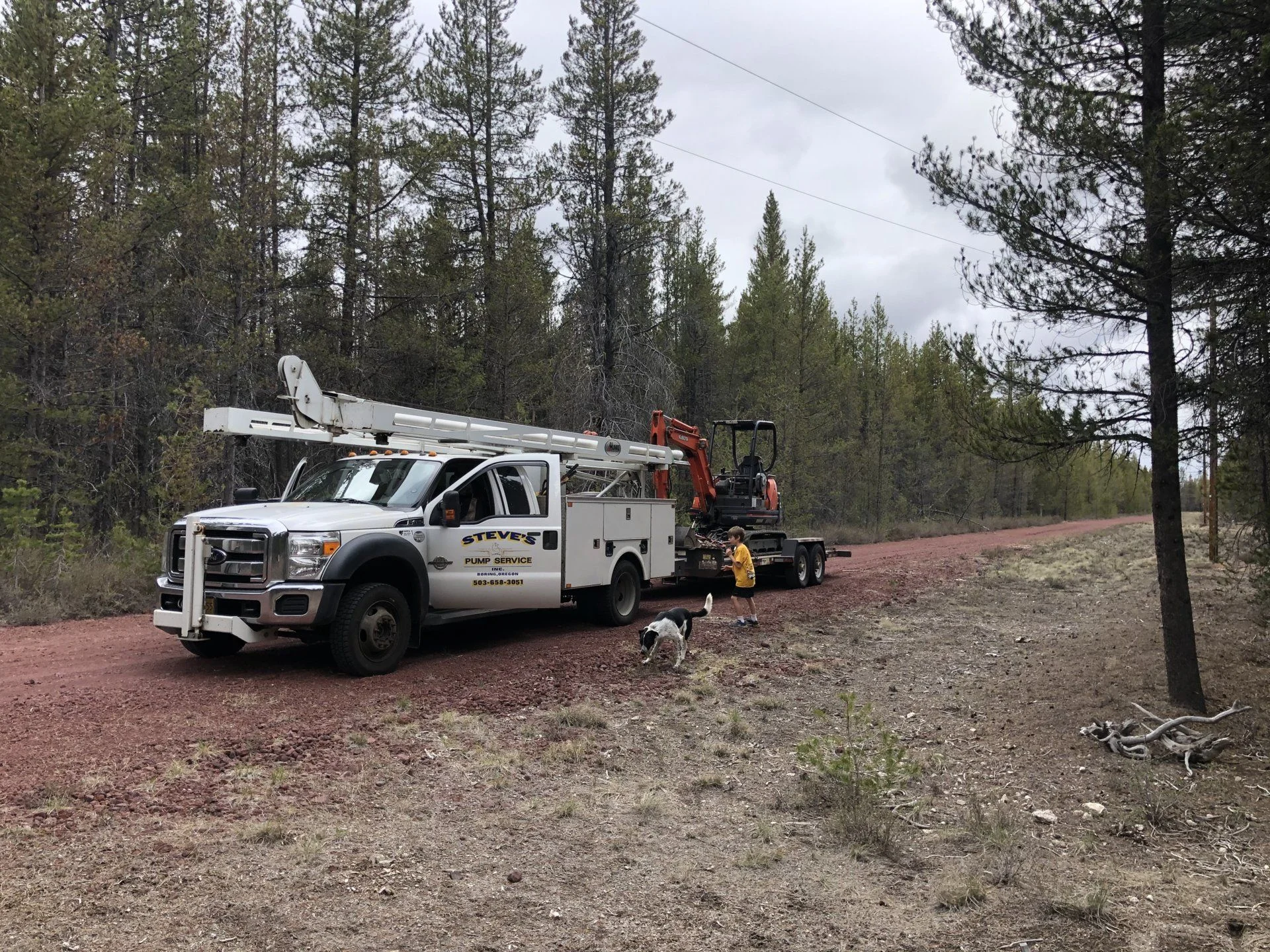

After testing well, pulled the submersible pump. Dug home with trackhoe and cut in pitless adapter holes for submersible and hand pump.
My dog Reload hard at work
Looking down the well with both pitless adapters installed.

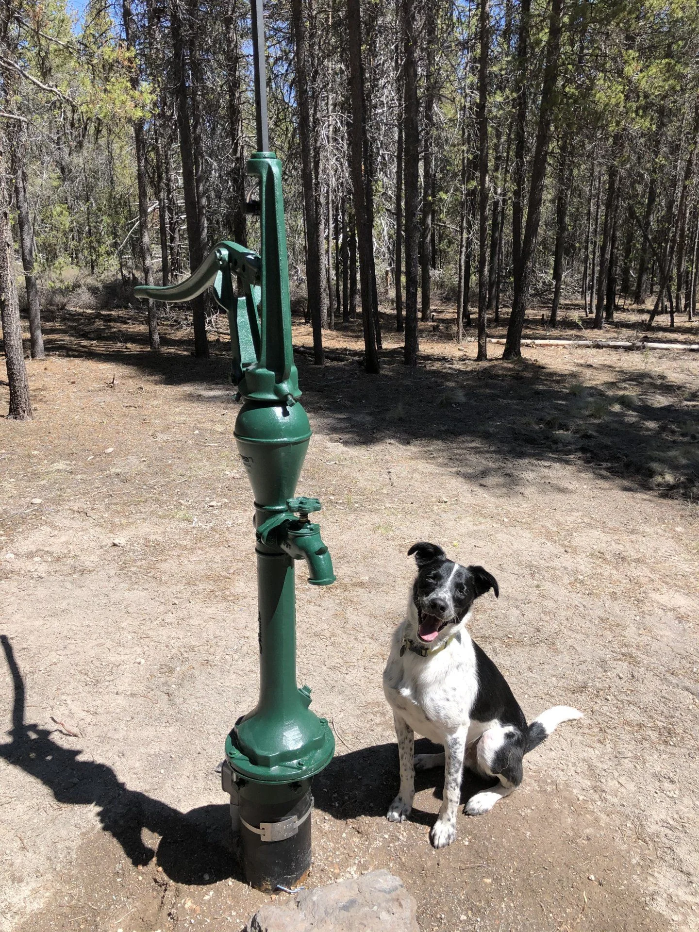

Stainless steel tee with 1” rubber bleedback to drain water from hand pump stand to prevent it from freezing. When the hand pumps stops pumping the water drains back down the well.
Getting measurements for how much pipe to cut between bleedback tee and top of hand pump stand on top of well.
Installed hand pump stand.

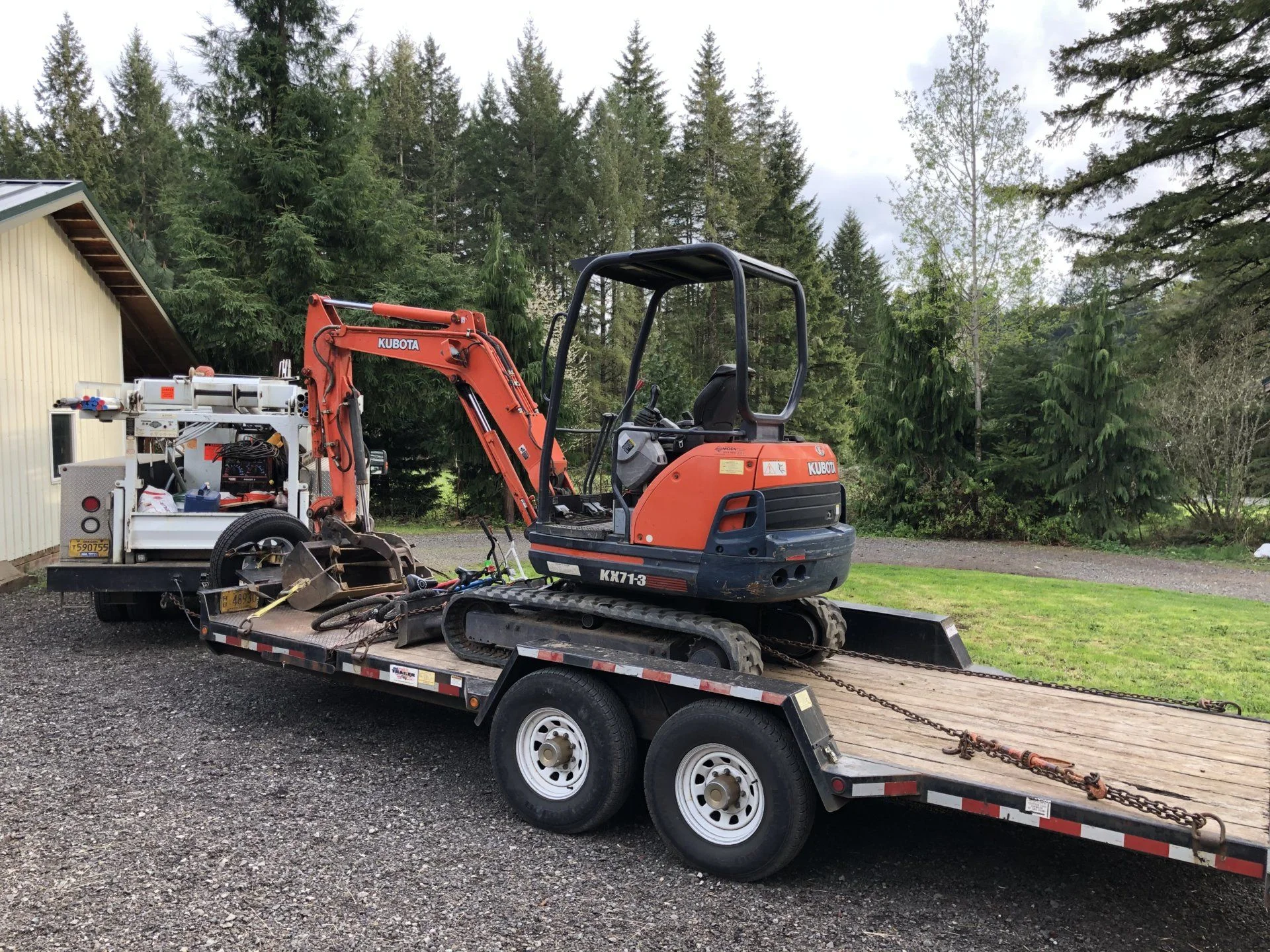

Cleaning upmy buddy Travis’s lot with the mini excavator.
More and more slash piles...
Travis enjoying some time in the saddle

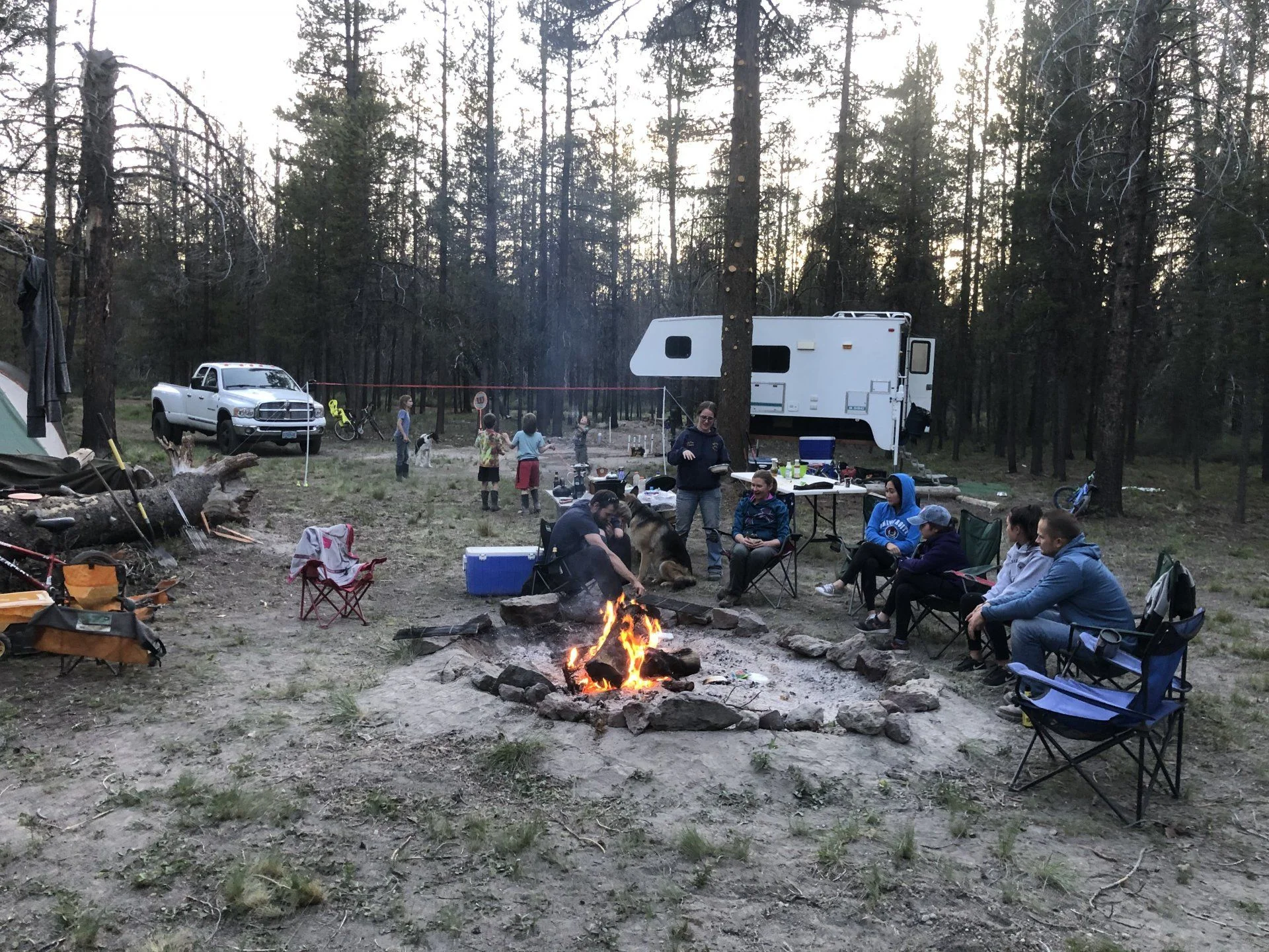

We did a family campout in June.
Took my 04 Dodge 3500 and camper. Friends tent camped and my buddy Travis and family bought a newer trailer and camped in their lot was a kick in the pants time, no work, all play. I did setup a horseshoe pit. Found a nice rock climbing spot above the Williamson River.
