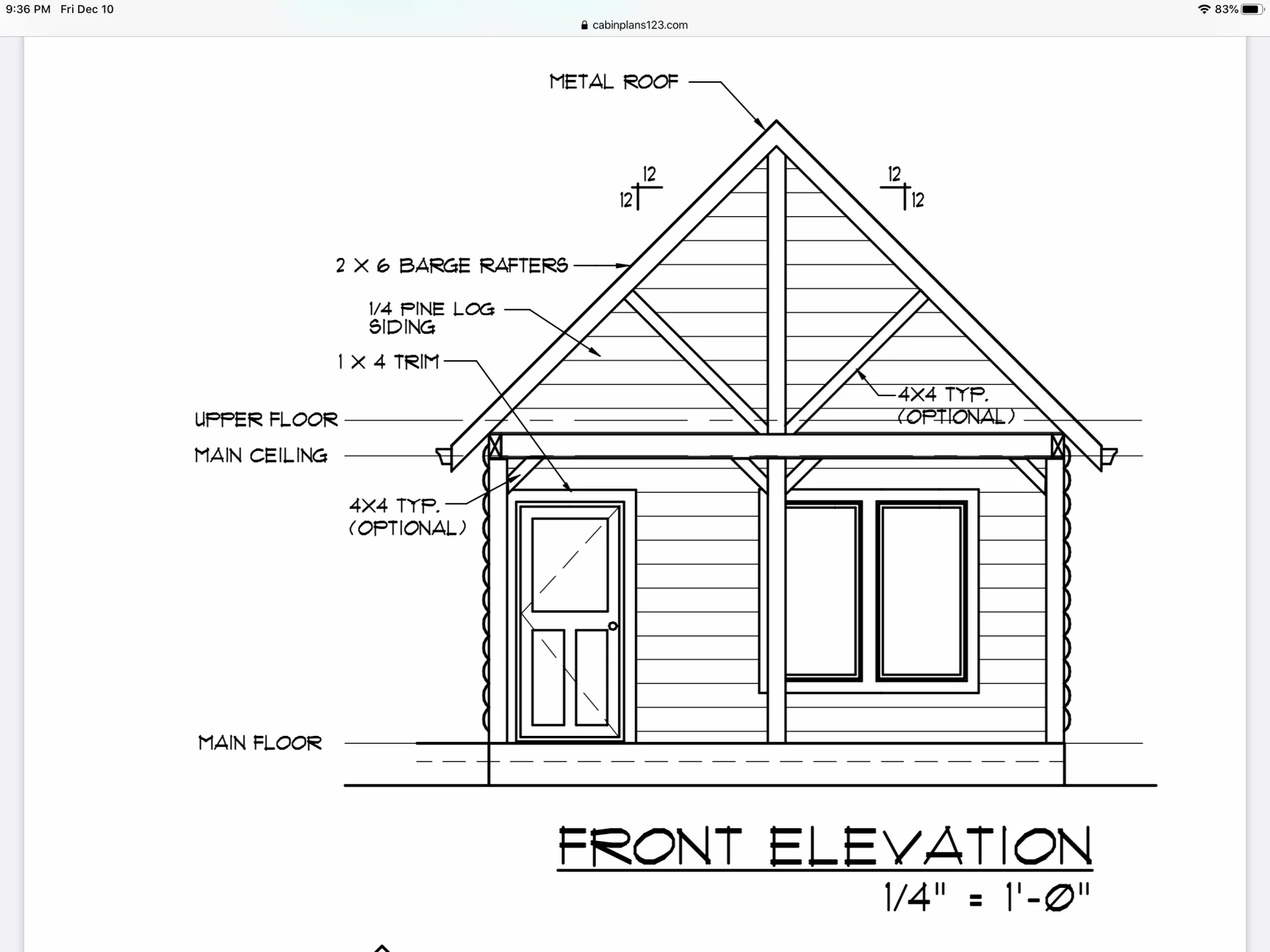

I was just looking at their free plans.
Once I have a building permit and done the county allows buildings up to 400 sq ft without a building permit. I’d like to build a couple of these for people… mud members on here to stay in😆. This whole dilemma started due to pot growers finding vacant land and getting power to the site and starting pot grows. Klamath County is a large county so even though our area is too cold they changed the rules that affected the entire county. Only 100 sq ft buildings and 100 amps unless you get a building permit.

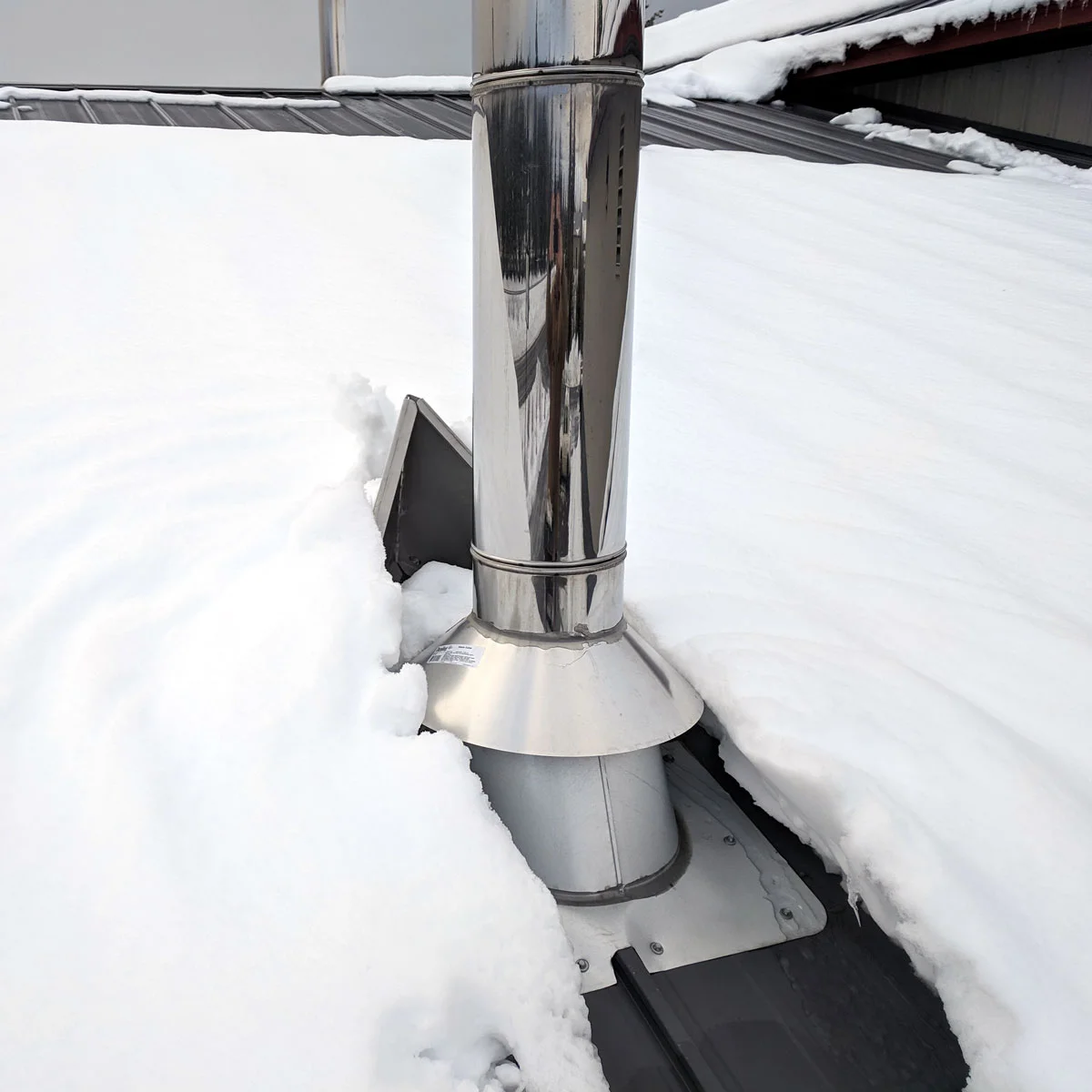

Our installer told us to put the stove near an outside wall to reduce the amount of very expensive pipe needed.
It gets expensive when the snow sliding off the roof wipes off the expensive pipe. Put the stove in the middle!!!!! And even with 2 crickets my pipe still got wiped off.

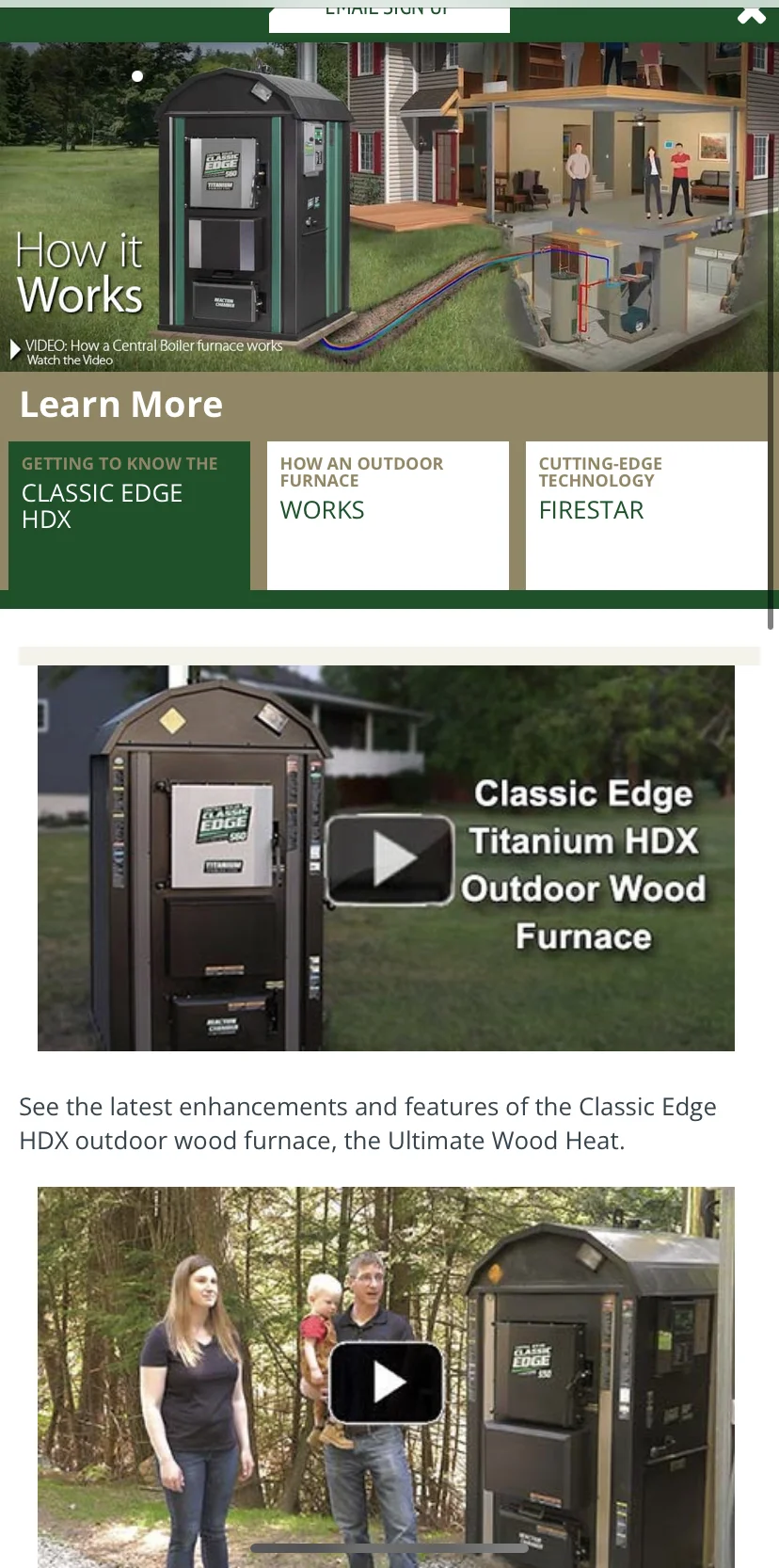

This system has really grabbed my attention!

My buddy Matt does HVAC in Central Oregon and said these work amazingly and with all the wood I’ve got that would be awesome. If you watch the video you can see how efficiently it burns wood. I’d still keep a wood stove but this could be a great main heat source. Not only does it heat the house but also heat your water.

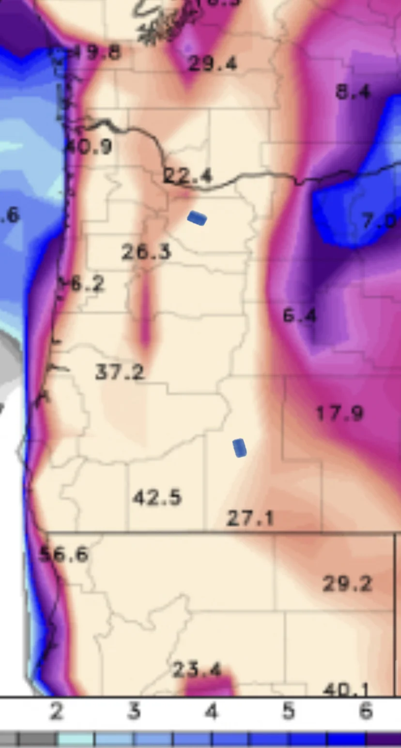

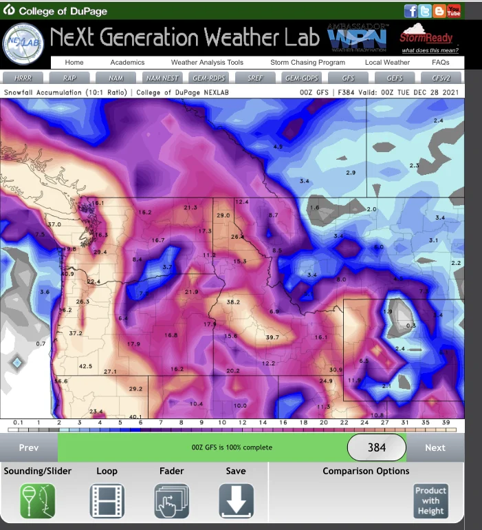

Latest 00Z GFS weather model snowfall map, a snow lovers dream!!! The Crater Lake property and my house near Mt. Hood get buried. This is a computer model but even the European model is showing this trend.
Approximate locations of my house and property.

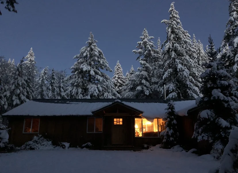

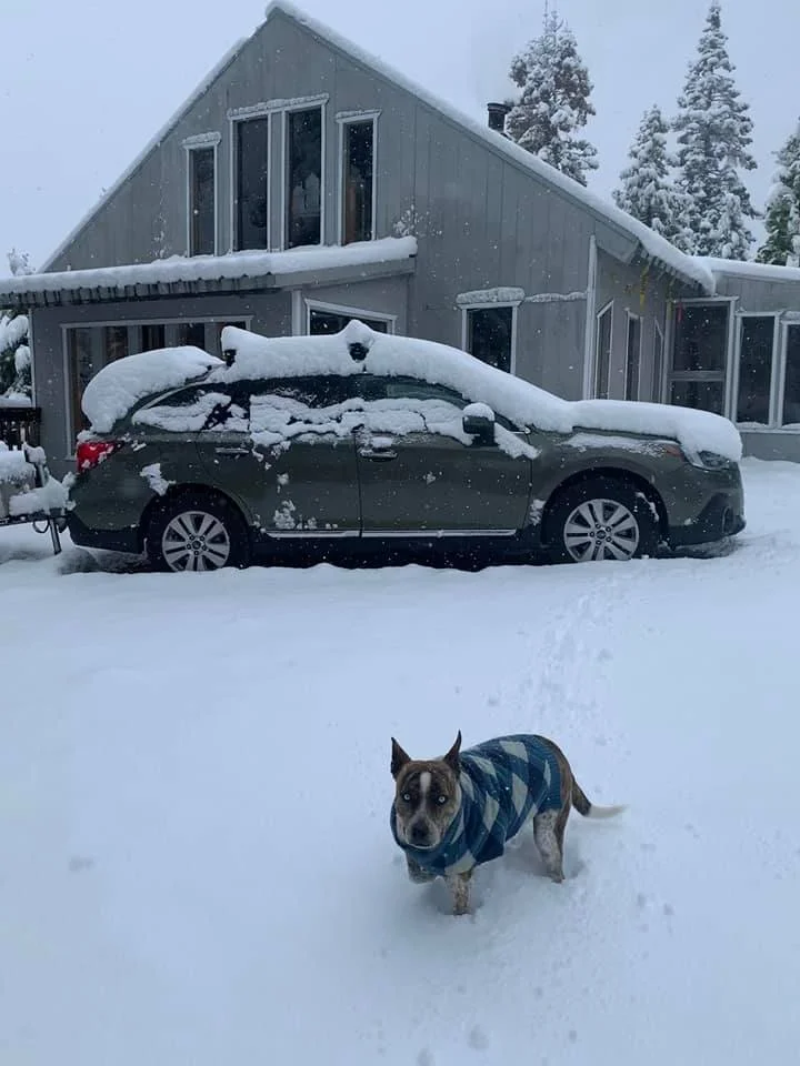

My wood stove at my house is near the center with Chinmey pipe close to the ridge so there’s literally no snow that can build up above it to take out the stove pipe. This is my favorite picture of my house in its winter wonderland. My little cabin in the woods.

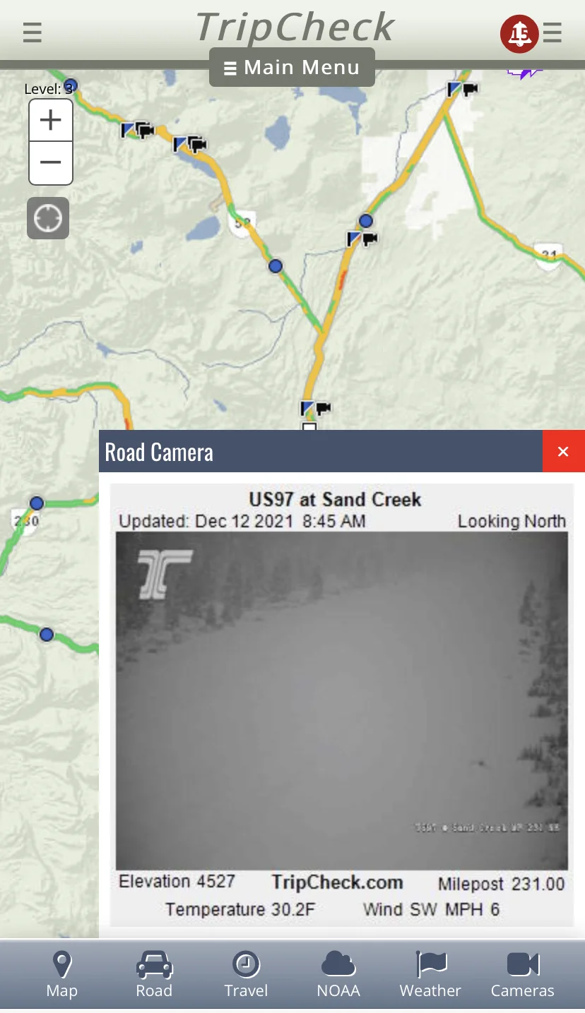

A mountain neighbor took this two days ago, he’s up the hill from our place. So we’re in similar situations. I won’t try to get anything done in those conditions, except burning piles.
