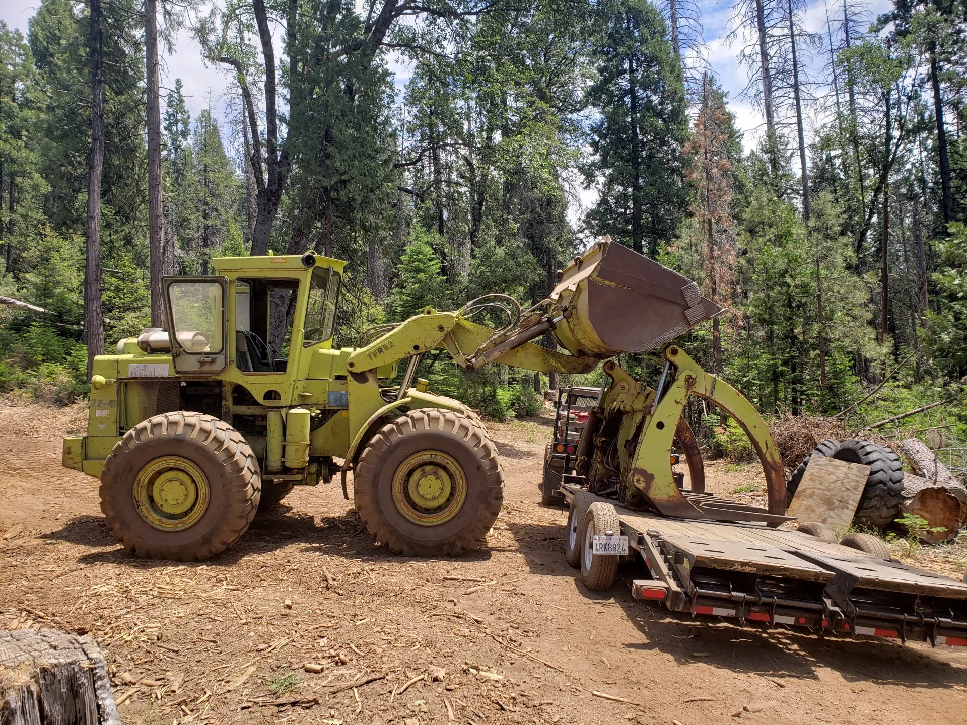

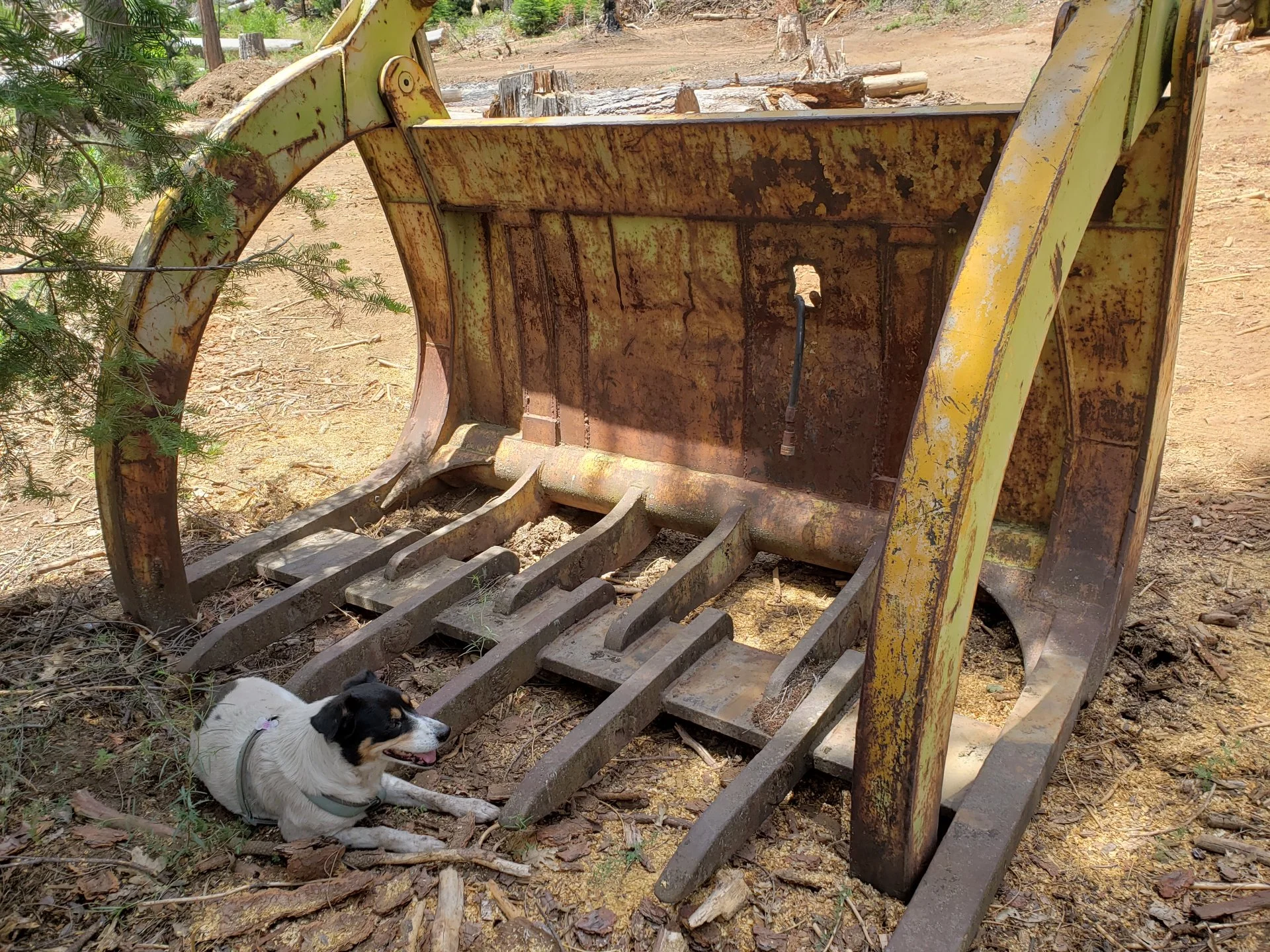

20 acres. It’s about thirteen hundred and twenty feet one way, and almost seven hundred feet the other way. That’s why I opted for the loader. I could have made more progress on the trees by now if that’s all I did, instead of working on the loader. But in the long run the loader will be well worth it. I’ve got this attachment for it too.

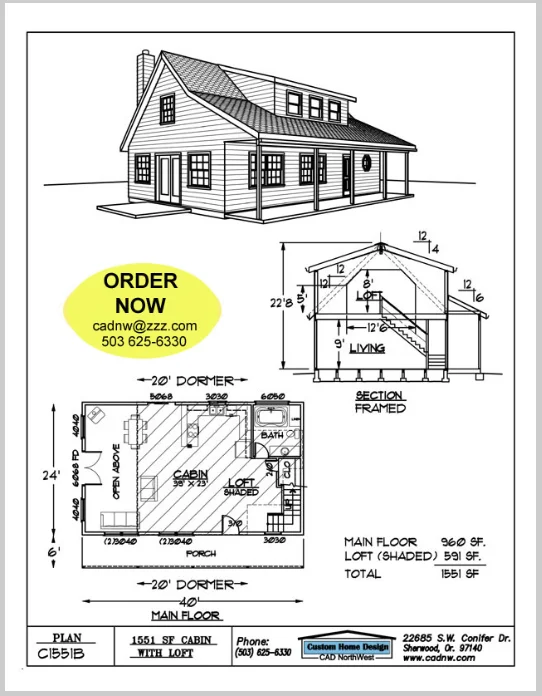

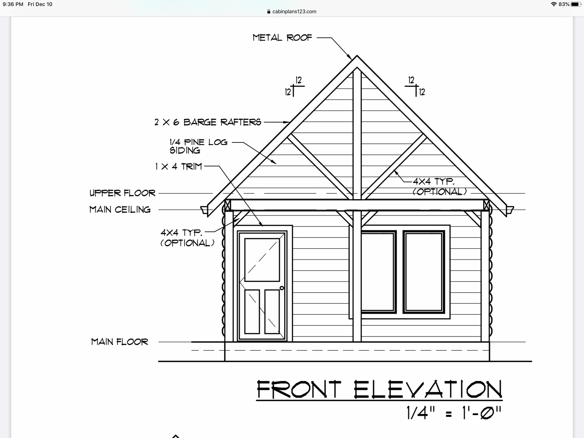

Picking a cabin design is not easy. I thought I made up my mind but now think this cabin design is what seems best. They can customize as I’d like a downstairs bedroom and have the stairway moved.
Make sure the design meets the snow load requirements for the location before submitting to the county.
Also like I mentioned before get the wood stove closer to the middle of the house instead of on the edge.
I already got my snow load.
104#SF per the county building engineer.
On the plan above I’d remove the patio doors and put the wood stove there.

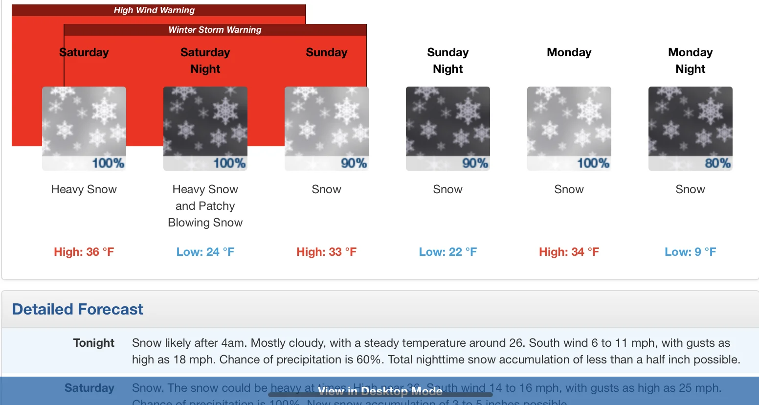

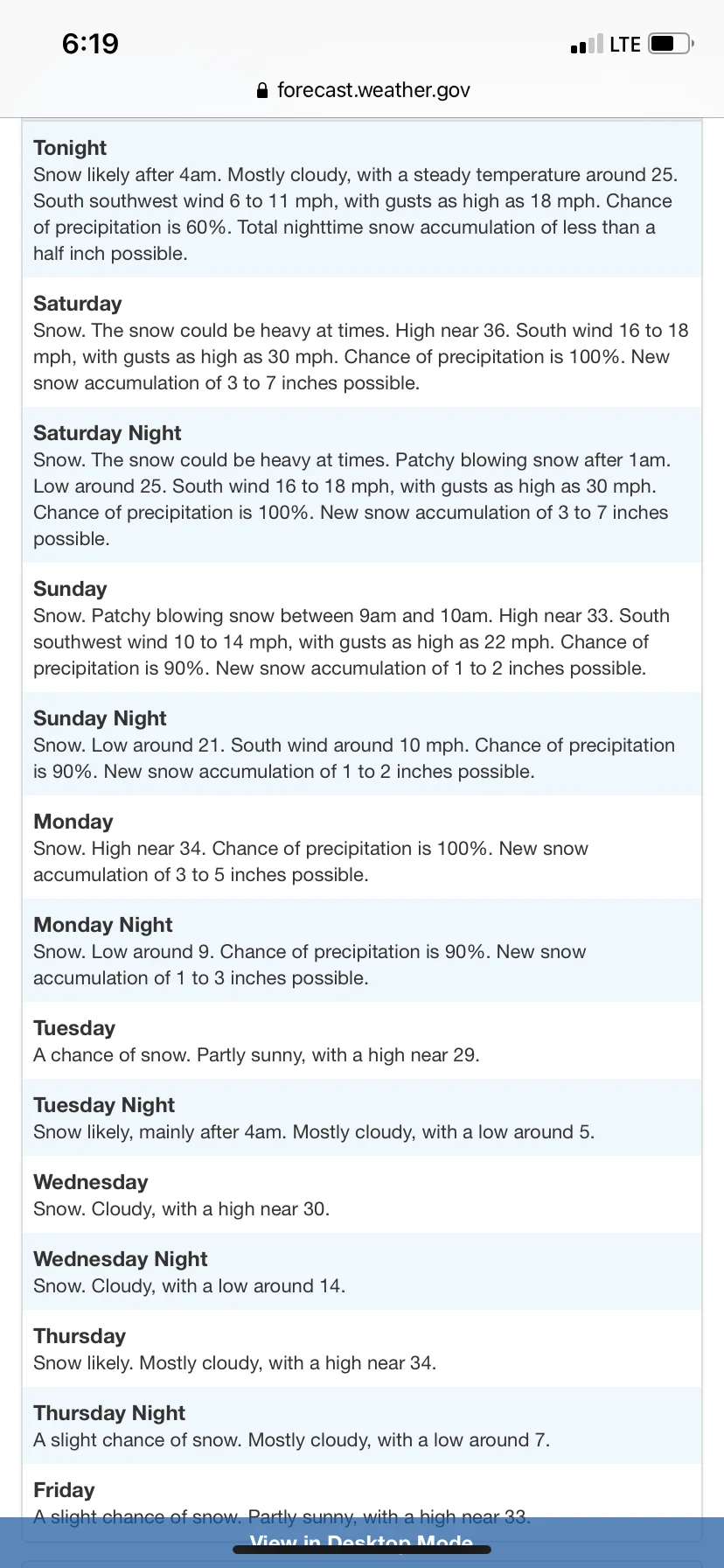

The snow is in the forecast at the property!!!

Cost without any changes are affordable. That 1500 sq ft cabin was $395. With my snow load and adding open loft and having a bedroom where the stairway is is ~$1400.

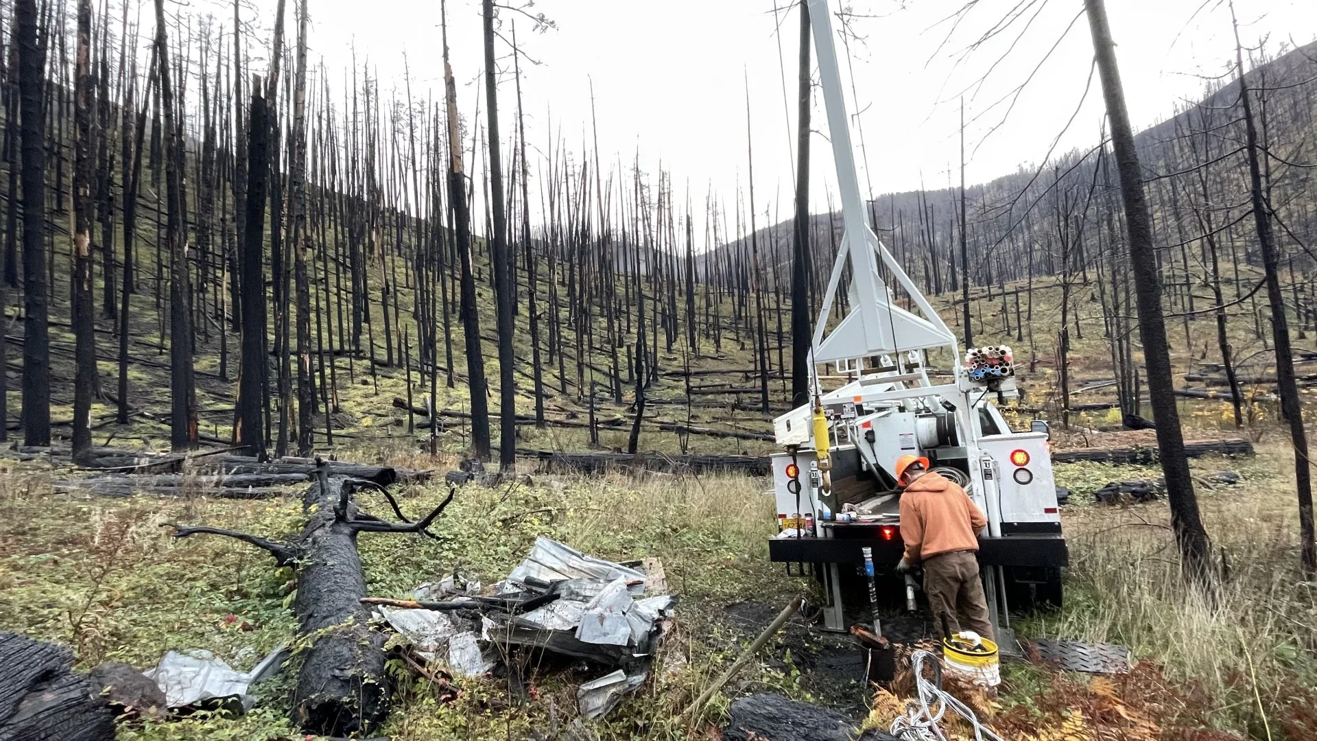

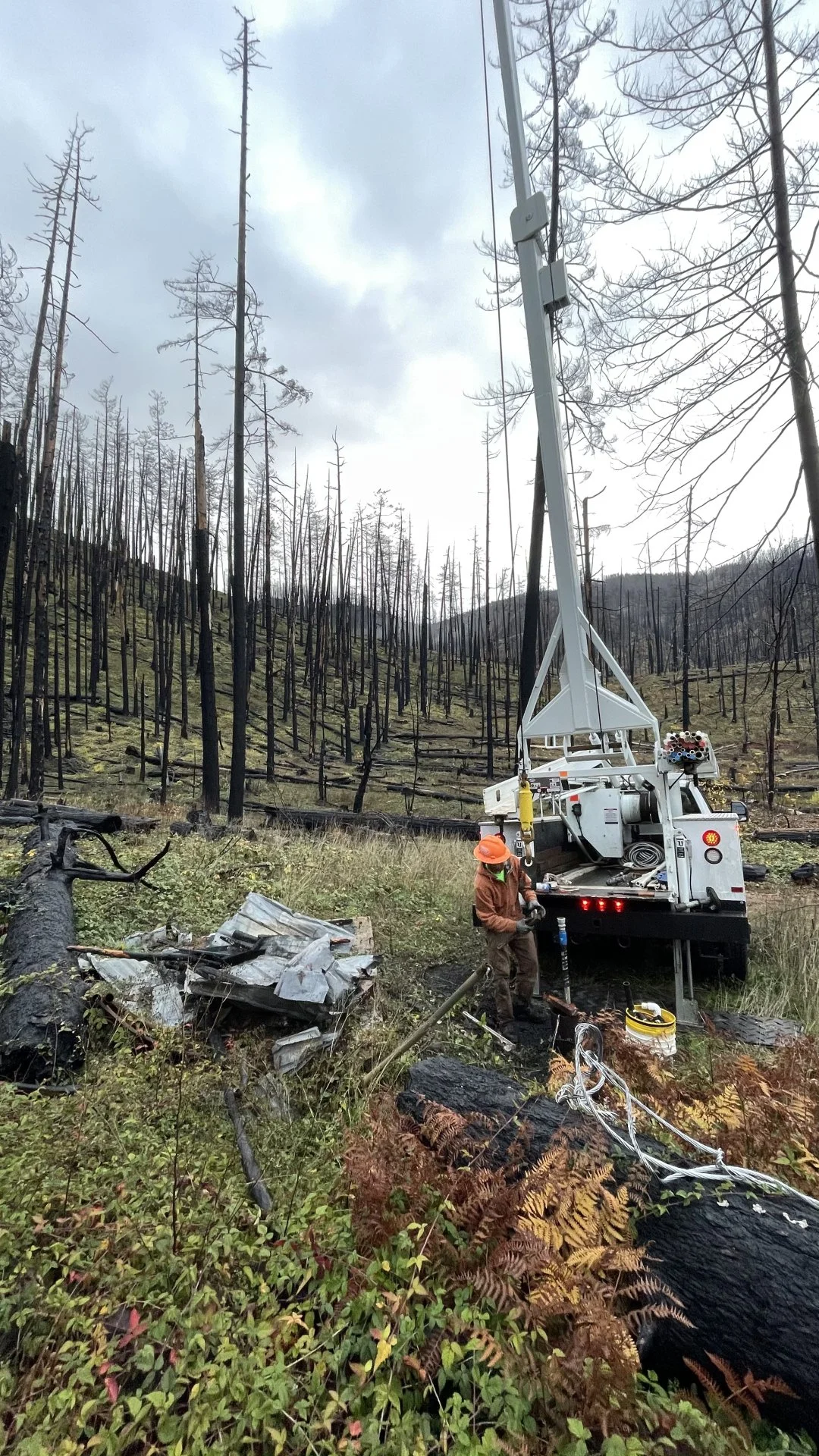

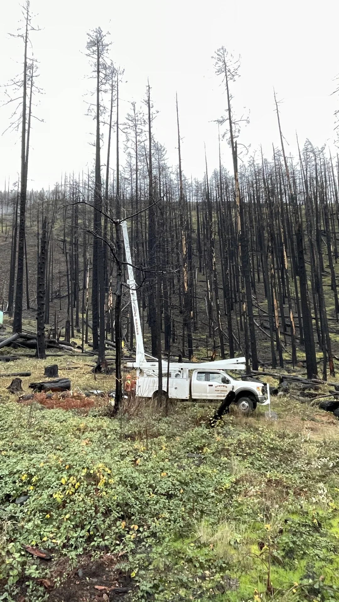

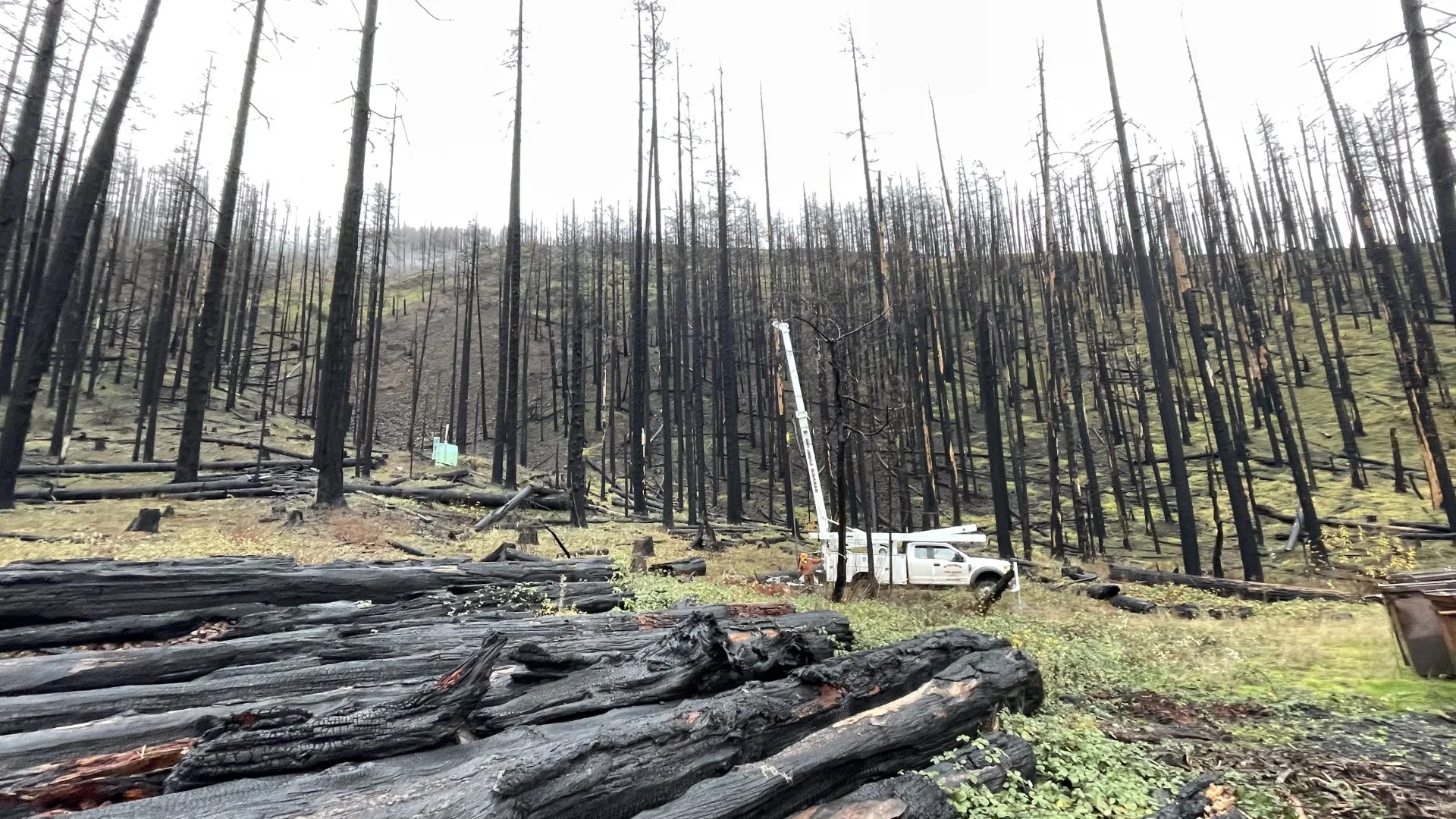

Worked up the Clackamas River which burned during September 2020. This was my favorite stomping grounds. It’s been closed to public entry since. I’ve worked on many of the wells up the canyon for forest service campgrounds and facilities. The fire burned down their maintenance building which this well served as well as a campground along the river. The Forest Service wanted the well pump to be pulled so the well could be temporary abandoned until they decide what to do with it. The guy overseeing the work shot these awesome pictures and sent them to me. Sad that pictures don’t do justice to the devastation left behind.
