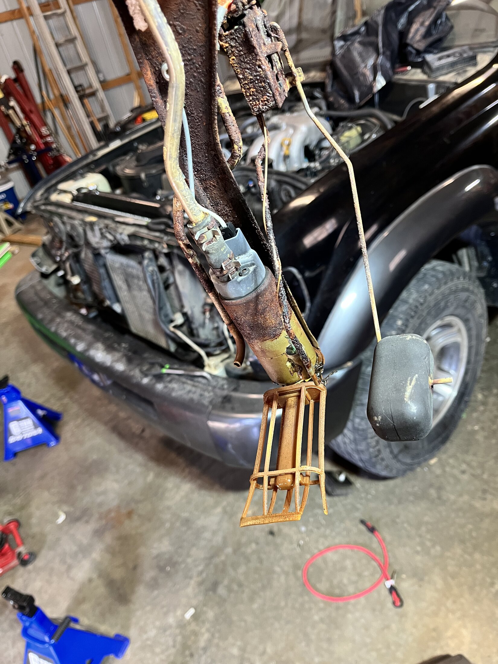

Put 12V to the fuel pump per the FSM, and got nothing. Pulled the pump and found this. Yikes.
No surprise; that was going to be my guess.
I'd guess the engine was running on the fuel in the supply line and when that was exhausted, it quit.

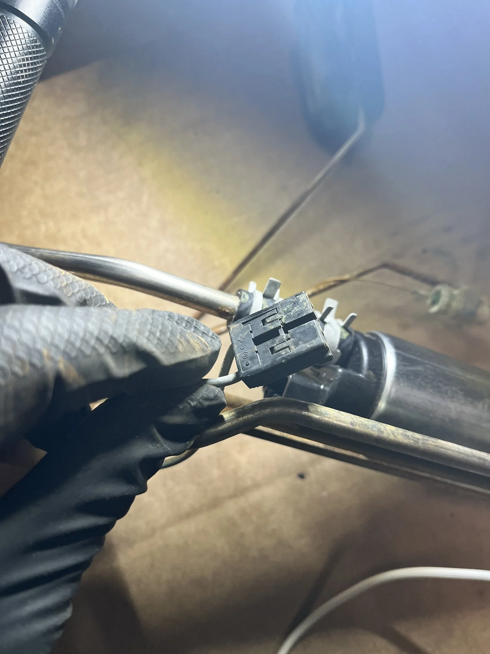

Got it all back together. Same problem. Again, I removed the return from the FPR and no fuel.
I put 12V to the connector on top of the sending unit that serves the fuel pump and got nothing. Brand new Toyota pump on.
Hooked up 12 V directly to the old nasty pump and it runs.
Seems to me that the pins in the connector that attaches directly to the fuel pump maybe just need a cleaning. Pretty rusty and nasty looking in it. Had to scrub off the male pins on the old pump to get a good connection to get it to run.
Question though, does anybody know how to de-pin this connector? I’ve done most of them on the main engine harness and replaced with new, however, this one is a bit different and looks like it may be hard to source if I destroy it.
Or maybe I should be looking elsewhere for my issues?
yea that little piece of plastic with the "5" on it pops out and then you unlocks the tabs to de-pin it. i think your on the right track.

Put 12V to the fuel pump per the FSM, and got nothing. Pulled the pump and found this. Yikes. View attachment 3823488
This pic is making me ask why did that bracket get so corroded? The tank was empty but it's a closed system so the AR humidity shouldn't have been a huge factor. So, does this mean there was/is water in the tank?
I’m pretty sure this truck sat for a long time at one point in its life. Maybe had just a few gallons of gas in the tank while it sat and condensation occurred
1) Missed ground connection maybe?
2) What Nagrom said about old fuel.... I had to flush my boat tank twice after it sat for three years. The first flush wasn't enough and It plugged up the newly rebuilt carbs again. (yes, carbs.)
couple of years is a long time, and I can see how the rust occurred.
Okay, that fuel pump is straight out of a horror movie. You gotta warn us before you put up a photo like that! Yikes!
The problem was that connector. Got the pins cleaned up, tested it prior to installing back into the truck, and then installed the pump back in the truck and it fired up. Ran it for half hour so I’m confident that problem is solved.
