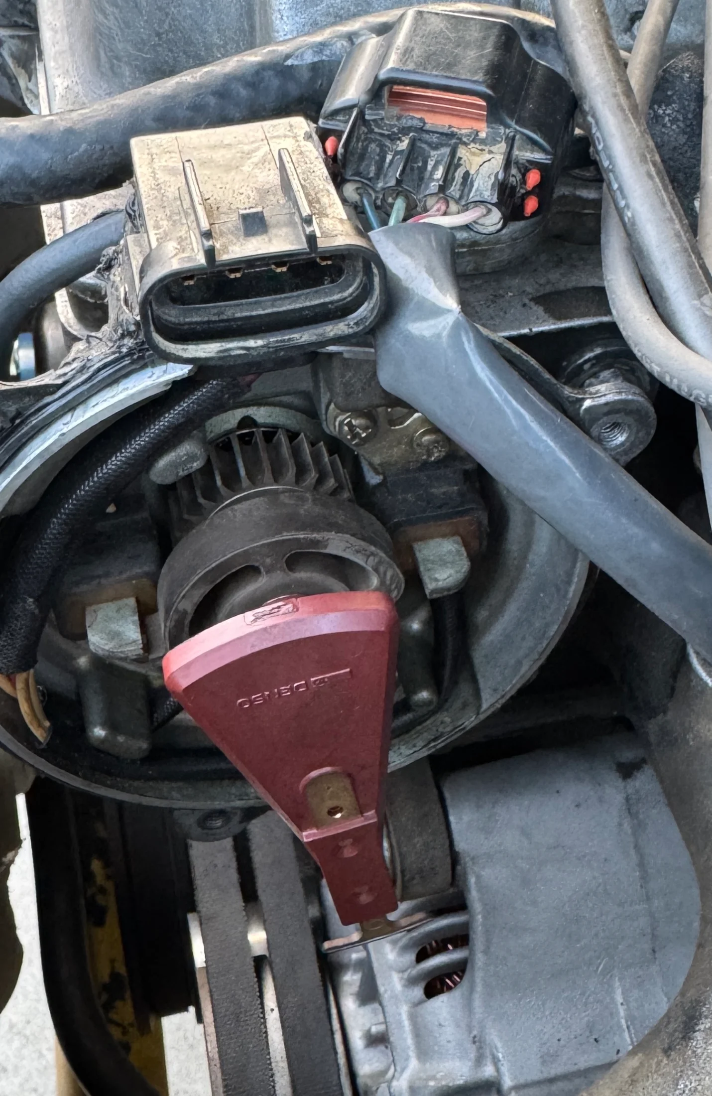

Last weekend, I set the crankshaft to 0, ensuring piston was at the top of the stroke. I then checked the distributor, timing was off because the rotor was pointing to the 6 o clock position. I reset the rotor, but still did not start. I am going repeat setting the crankshaft to 0 and re-check the distributor rotor again. If it's pointing south again, I may need to replace the distributor. What do you think? Thanks in advance.

I have not messed with the timing. Only that in the process of troubleshooting the crank no start, I removed the dissy cap and noticed that the rotor was pointing to the 6 o clock position with the #1 cylinder at the top of the stroke and the crank set at 0 degrees.

Did you confirm that #1 TDC was on the compression stroke and not the exhaust stroke when you checked? There are two TDC's with every disty rotation.
It sounds like it ran before you rotated the disty 180deg(and whatever funky is happening), so start with putting it back along with un-doing whatever else you have done.

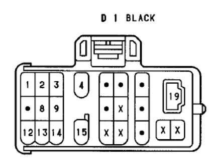

Are you getting fuel? You can bypass fuel pump logic by jumping pin 1 (FP) to pin 12 (B+) on the diagnostic connector on the firewall. The FP will fire with the key in the ON/RUN position. Only use for diagnostic purposes.

I will be clear, I have not changed or modified the timing, I currently have the #1 piston at the top of the stroke. The crank shaft pulley is at 0 and the rotor is pointing south.
My questions are:
Would a bad dissy cause this?
Should I take the dissy out and realign it to the mark in the correct setting for TDC?

I am confirmed fuel in the return hose. I jumped the FP and B+ pins as well to bypass the fuel relay and COR, crank bu no start.

I am leaning toward a dissy timing issue since the coil was disconnected from the dissy.

Why would disconnecting the coil output to the distributor rotor cause any issue whatsoever?
How would this effect ignition timing??? You said you didn't adjust ignition timing and that the engine was running.
