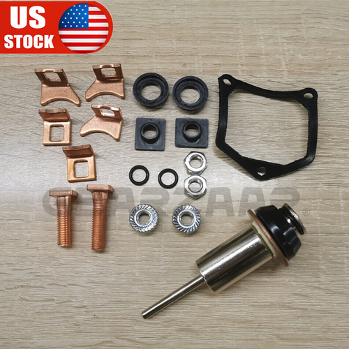

One of my front wheels started squeaking after a water crossing, so this weekend I repacked my wheel bearings. I also replaced my starter contacts to remedy an intermittent click/no start condition.
I was just searching for the contact kit part number and couldn’t find it. Could you post it?
28226-66060 battery terminal kit
28226-72010 motor terminal kit
28235-54380 plunger
Thanks. I was under the impression there was a single part number that included all those parts.
