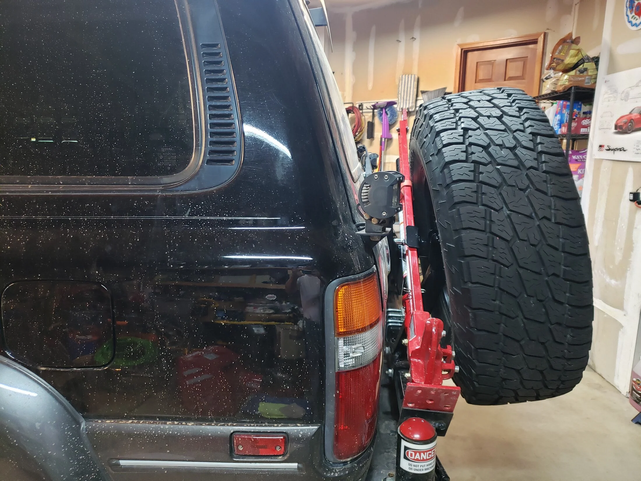

In a spur of the moment proposal, my friend @Goslow helped me fix my tire swingout. It was -4degrees, and is now +10 degrees. It looks so much better!
Before (as purchased)
After
The jack no longer digs into the tire, either, so now I don't have to make sure it gets removed immediately after every trail ride.

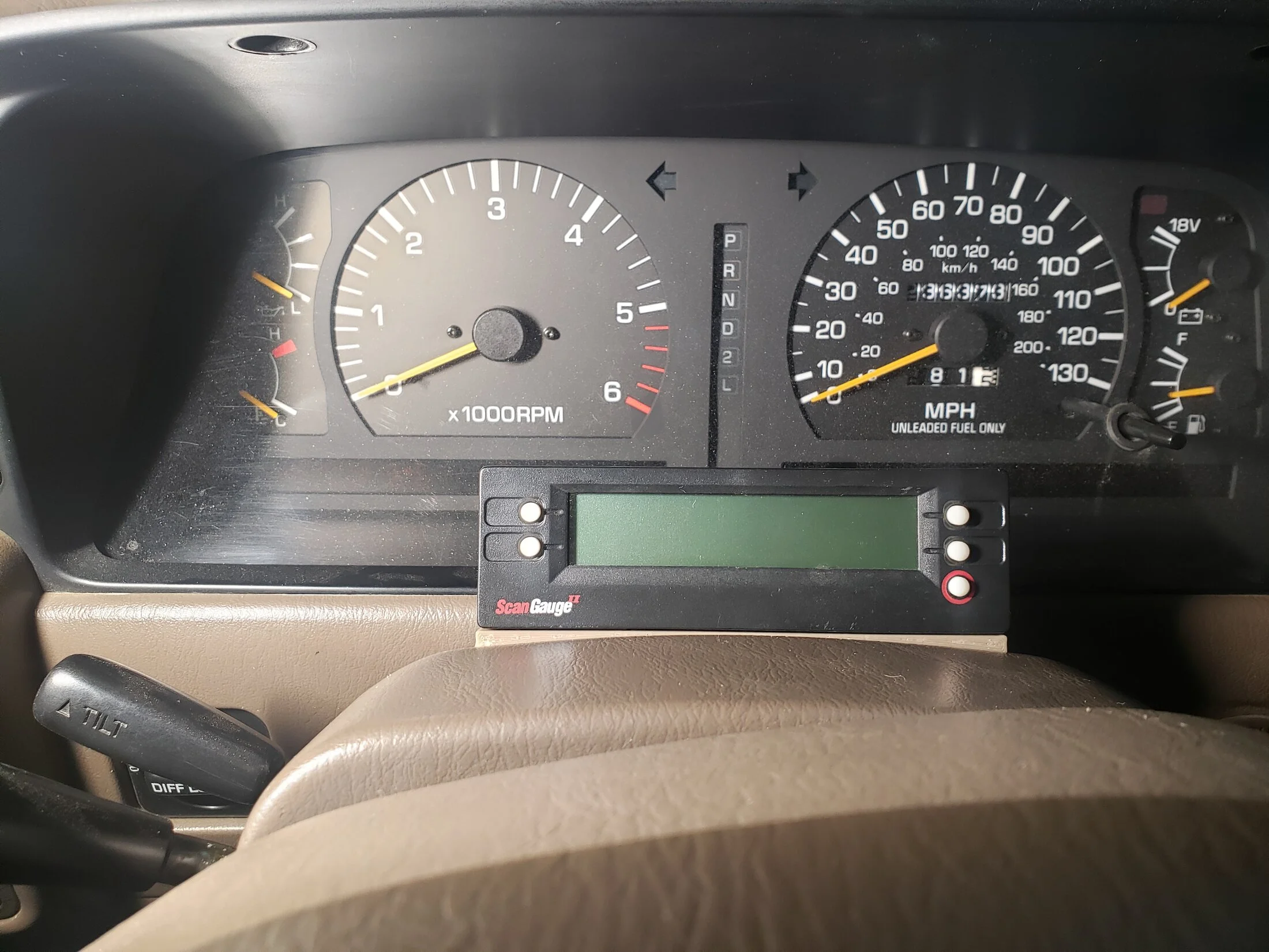

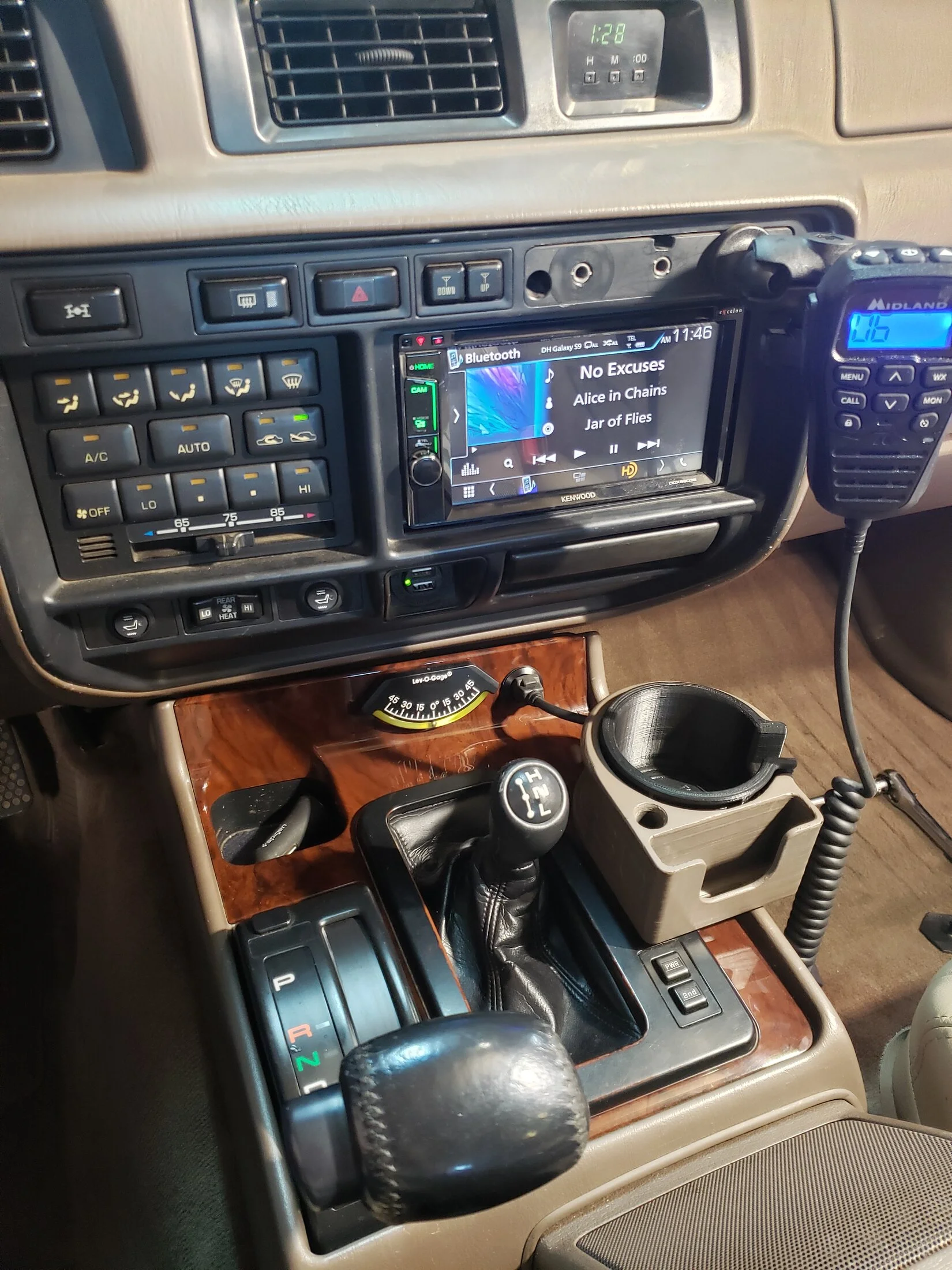

Moved my Scangauge II from the shifter console, where it was hard to read, to the steering column, where it couldn't be easier.
Mine quit on me a bit ago, so I sent it in for a free repair, which is how this all got started. The little adapter/stand is from SolveFunction.
I have a terrific solution for the cable hole on the console. More on that soon.

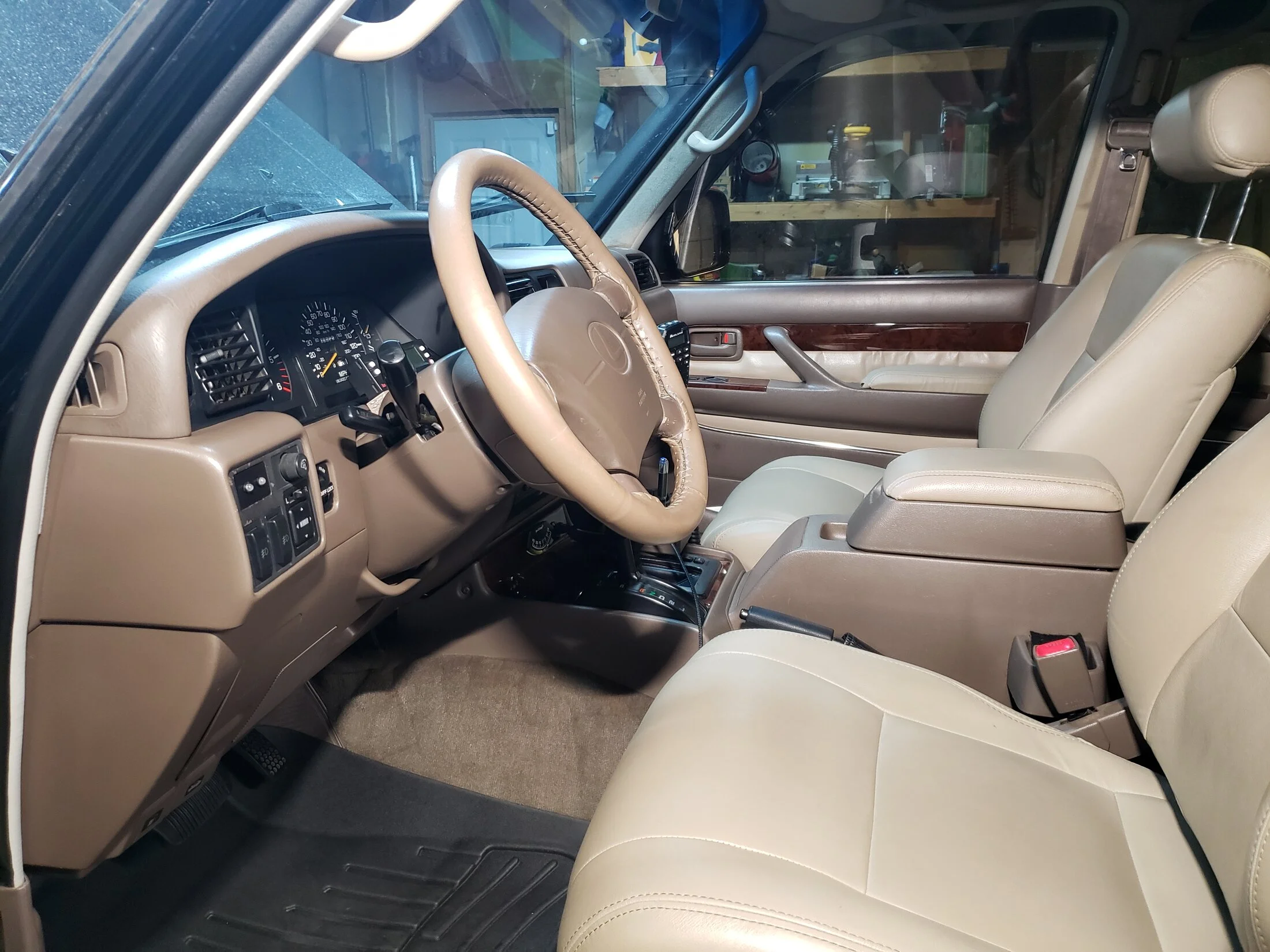

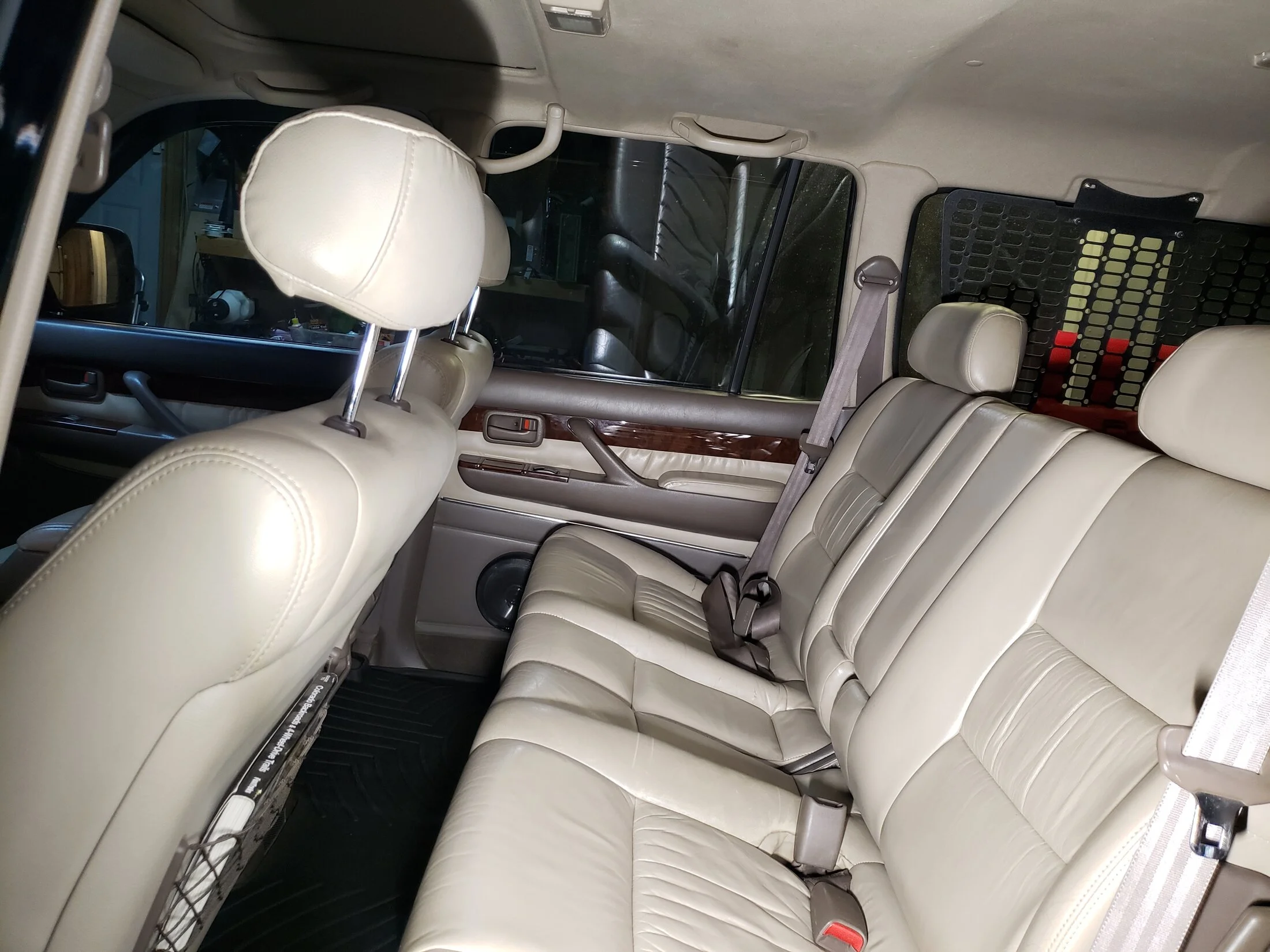

Full interior recon almost wrapped up. I just need to buff down all the leather and vinyl after it drinks in all the conditioner it can swallow (might take a few days and a few coats).
  1. Full clean & vac
  2. Dressed all door seals with Nextzett Gummi Pflege
  3. Washed all smooth surfaces with Meguiar's leather cleaner
  4. Conditioned all smooth surfaces with Colourlock Elephant Leather Preserver
  5. Shampooed carpets and pedals
  6. Cleaned crud out of vents with one of those goop balls
  7. Washed and treated floor mats with WeatherTech cleaner and protector
  8. Greased door hinges
I hereby dedicate this full interior recon job to @LCPilot . ;)

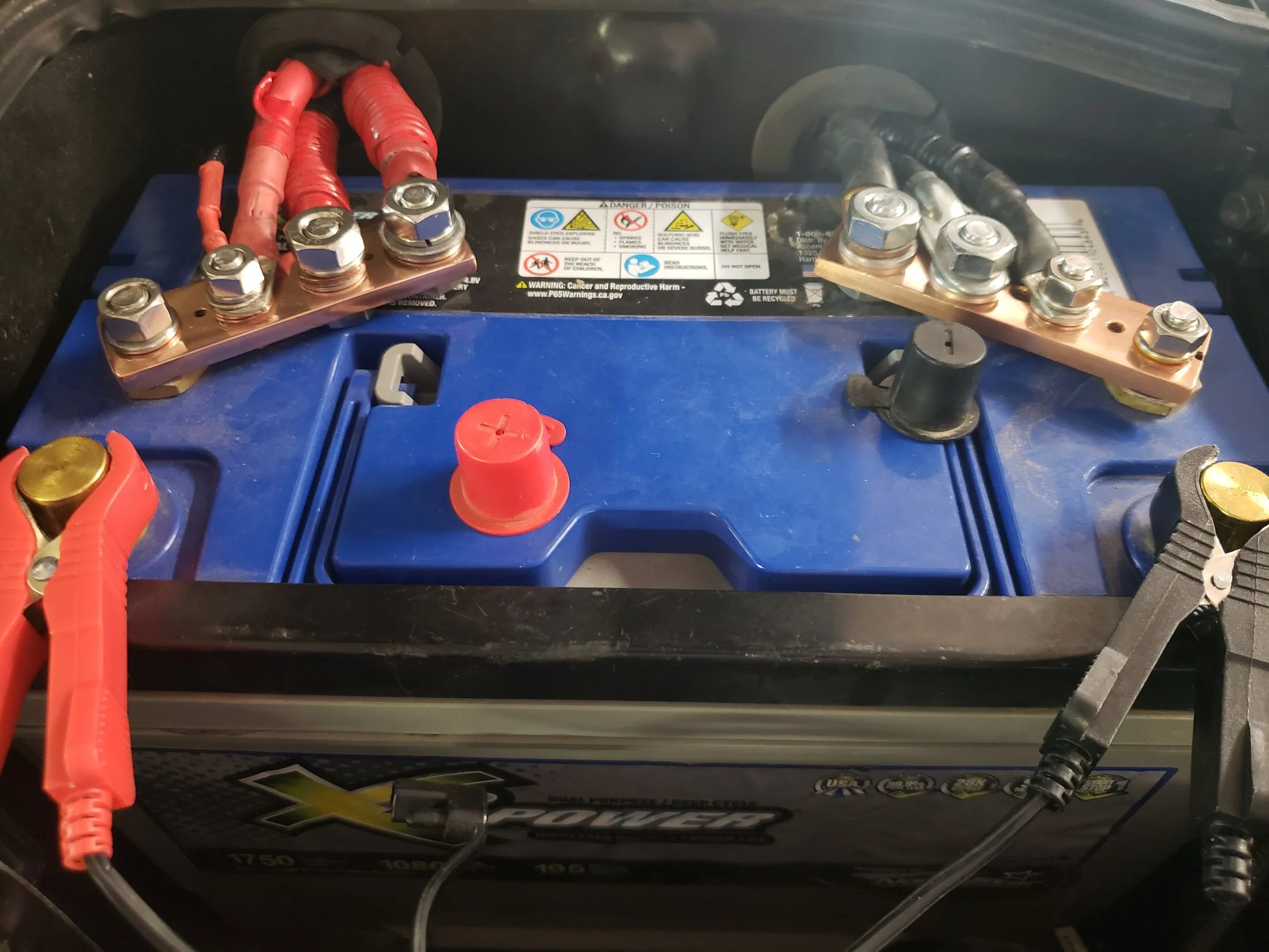

I like my new negative battery terminal so much, I made a positive to match. It looks great, but now I'm just a dropped wrench away from an "event", so I'll need to devise some sort of cover(s). I thought about melting some thin thermoplastic sheet over each side with a heat gun... other ideas?
Assume this is the actual terminal connection (haven’t seen this particular battery)?
If so, what do you do with the other terminal posts (where the alligators are attached in the photo)?
Correct. I keep those covered with the plastic caps lying toward the middle. I bought with this battery already installed, and undoing it will require several new cables on the negative side.
I bought the same battery in 2021…. Maybe you could devise a cover for the entire battery top. Myself, I wouldn’t worry about it though because simply covering the battery with a rag while you are under the hood will stop any fireworks from happening due to a dropped tool.
